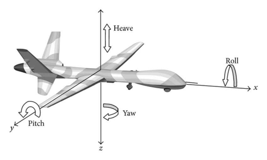

    Hi Guys and Girls, Jerry here.
    I’d like to build a 4 DOF similar to this image
    So all I’ve done in the past few months is Read, Read and Read; suffice to say too much information is leading me to confusion!

    Unfortunately you can't really forget about the design, it will influence what motors, boards and PSU is needed to drive it.
    While the sim type is currently 2DOF have a play with SimCalc to get an idea of the physics involved in terms of motors, levers and angles: https://www.xsimulator.net/communit...e-linear-speed-and-forces-of-your-design.270/
    Batteries are useful re back current for some hardware configurations and boards such as the Sabretooth 2X60.
    Some boards like the clone MMs do have quality control issues, there is occasional faults with quality boards like JRKs, but keep in mind a lot of issues are operator error, as first time round most of us were newbies when building or sims.
    Pots and Hall sensors are pretty easy to configure if you are using the SMC3 code or JRK config utility, basically they are used for motor positioning on a motion simulator: https://www.xsimulator.net/community/faq/how-to-choose-potentiometer.238/
