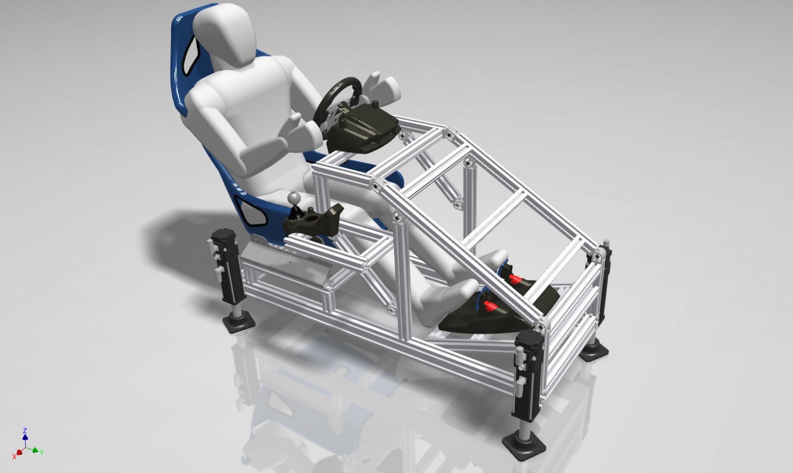

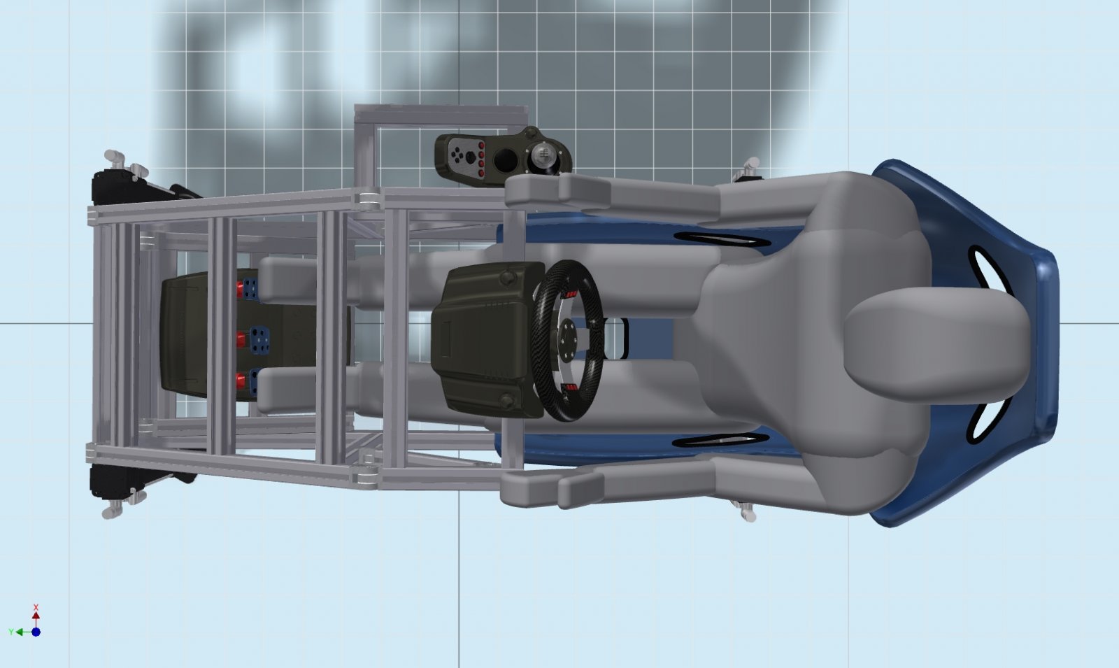

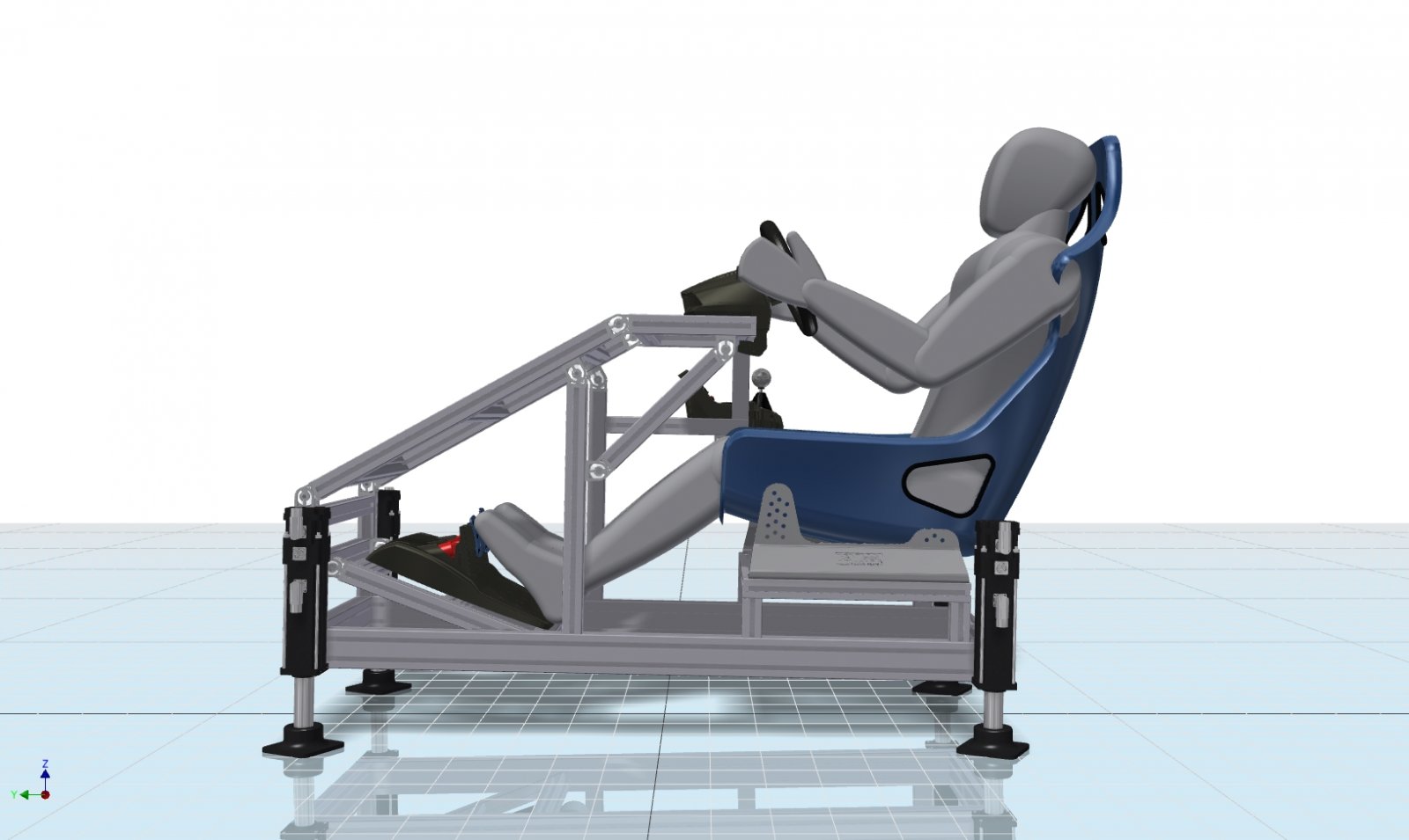

    Right, I have decided to just jump in and get cracking with a sample layout just for sizing and scheming...general layout and stuff.
    I know it looks horrible and all boxy, but hey some extrusion allows for fast and simple sizing, and also gives great flexibiltiy for adjustments.
    Once the position is nailed down and dynamics sorted, then tubular framework with brackets is all very easy to add in down the line.
    So here we go.... I can add dimensions if anybody wants to check it out.
    Game Rig v1.0 - Iso View.jpg Game Rig v1.0 - Side View.jpg Game Rig v1.0 - Plan View.jpg

    This actuator low chassis can do!
    Will there have to perform and drive information?

    The wheel in that 1st picture (in fzxj520 post) is waaay too low...

    Yeah, I have been in touch with them...and commerically you do need an initial quantity order - I can't seem to lay my hands on any units as a individual set. So as this is just going to be a test bed for my own little play room, then I am looking at alternatives for now. As I am pretty sure the SimTools app will allow me to talk to other actuators - it is just finding the right ones now - somehwere between 100-200mm stoke, with enough grunt to take the payload, and speed for them to be effective. Hey, this is still a DIY rig...so I am going to still need lots of help. Just because I can operate a bit of shonky 3D CAD shoftware does not mean I know what I am doing here!!
    So far I have ordered and received all Fanatec kit, so have the BMW Wheel, cabron black F1 wheel, H and SQ shifter. I was hoping that by now I could of gotten my hands on the V2 wheel base and pedals...but no such luck. I have had to reach out into the digital universe and grab a set of V1 pedals for now - ProtoSimTech ones will be here in the coming months if Chris can grow another few arms and ramp up production. Still on the lookout for the V2 wheel base as all the DD ones are just a tad on the expensive side right now, especially as everything else has been bought at the same time. Upgrades or replacements will happen as and when, and of course if needed.
    The screen has been ordered, manufactured and just needs to be shipped and built...so slowly it is all coming together nicely.
    I will update a bit more in the next few weeks when the actual real life build gets underway!

    well the idea is that with the 3 DOF system, I can then raise the base up a little and put in a 4th DOF for the traction loss (oversteer/understeer)... I am not looking for any additional movements...but I am interested in building it up slowly and seeing what part of the visual/vestibular systems are triggered the most. As with having such a large immsersive screen (it is also 3D capable - but don't plan on using that part for a driving sim) some of the motion cues will be able to fool your brain whether you are sat on a motion rig or not... example being the Oculus rift stuff sat on a chair.
    Slowly slowly....one step at a time. But I will give feedback along the way.

    Just be aware that actuators that have both the load capacity and necessary speed for a simulator are also likely to be very expensive.

    For starters I have been looking at the SCN6's...as these are tried and tested thanks to the community here...or maybe the SCN5's? A cheaper starting alternative than D-Box or industrial suppliers like Beckhoff or Bosche Rexroth..
    No doubt about it I am going to need to lean you your collective experiences to get this working.

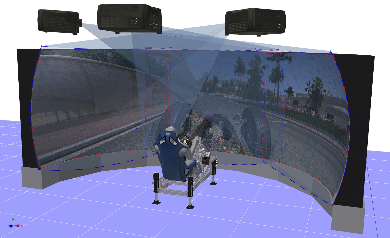

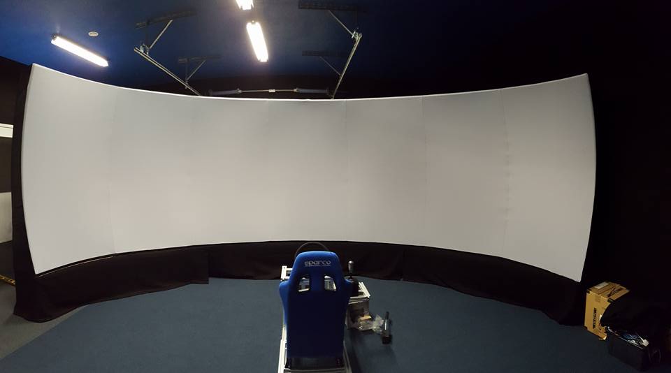

    I haven't had much time to progress the seat rig - so it is still static for now. I have finished the visuals (apart from a minor graphics correction) so at least I can share that with you all...
    Now the focus is back on the seat, and I am torn between which way to go. Seat shaker or full rig mover? I am also torn between how many DOF I would like. My optimum is, pitch, roll and yaw (traction loss)....but I would also like heave for the jumps. But add those up and I would need 5 actuators...so why not buy 1 more and do a full 6 DOF stweart platofrm? Or get rid of heave and go with just 3 actuators as a starting point?
    Any tips on which way or any body tried both to advise which one feels more realistic? I am skeptical of the seat shaker, just because the other parts of the rig don't move...but some of the set ups look very nice indeed.
    Onto the bit that is done, the visuals.

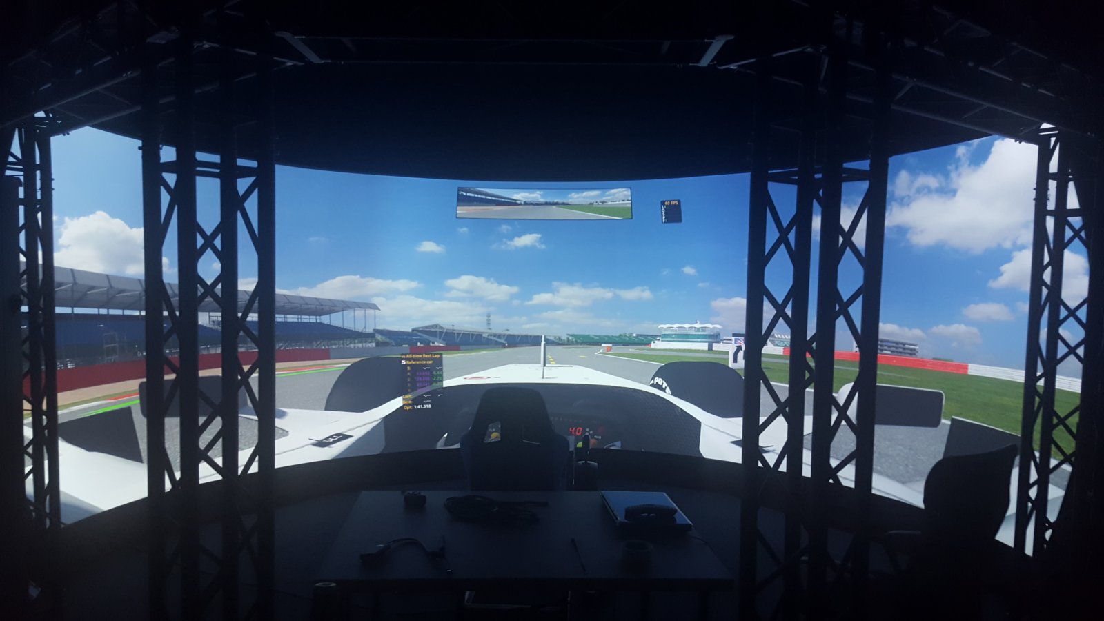

    It is a triple projection curved screen - curved in both H and V axis - so it is 180x45 degree section of a pure sphere. 3x WU projectors running at 120Hz. Currently only set up for iRacing and it isn't meant as a pure racing sim...it just so happen I can use it for that so yes I know it is a little larger than normal...but only just. My other systems for racing teams are about this size but they have full blown hexapods under the cockpit so need the space.
    Original CAD design....
    Real life build - Pic 1
    Pic 2 - Content needs a tweak but is in the hands of tech support to help correct the viewing frustums....the desktop warp is all good so I know it is not that.
  17. SBDESIGN
    SBDESIGN some knowledge
    May 25, 2016
    56
    director
    UK
    125Coins
    +7 / 0 / -0
    2DOF, SCN5
    Nice, IMPRESSIVE SCREEN!
    Makes my single 120" screen poo now!
    I wouldn't be put off by a seat shaker, a lot of professionals prefer this design other full frame.
    I am currently about to build my 2dof seat mover. I have the scn5's x 2 and the simxperience rear damper kit to hold them. I went for this solution after reading for at least a year on these forums.
    If you read up on how a seat mover effects the body and your muscle tension, it all starts sounding like the better option, and is perhaps different to how you think it works in your head (or at least my head). I have too often read people confused thinking the seat is supposed to mimic the car seat, and often they don't understand why your seat and pedals would change/move independently.
    I realised a long time ago that you can not create anything realistic and got over it. Now i understand its about having as many things to worry about, feel, and engage with as with the real world, and dial those senses in to your brain to give you the ultimate trick and pleasure of real racing in your home!
    I see it as a foreign language to learn if you like, Hello / Bonjour - its the same but different ;)
