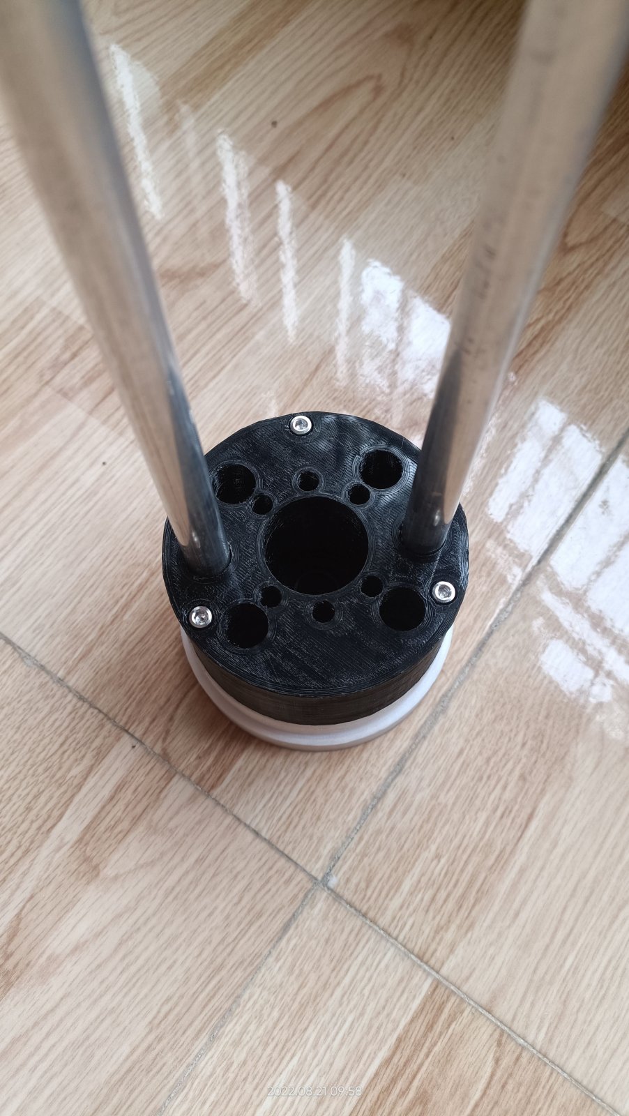

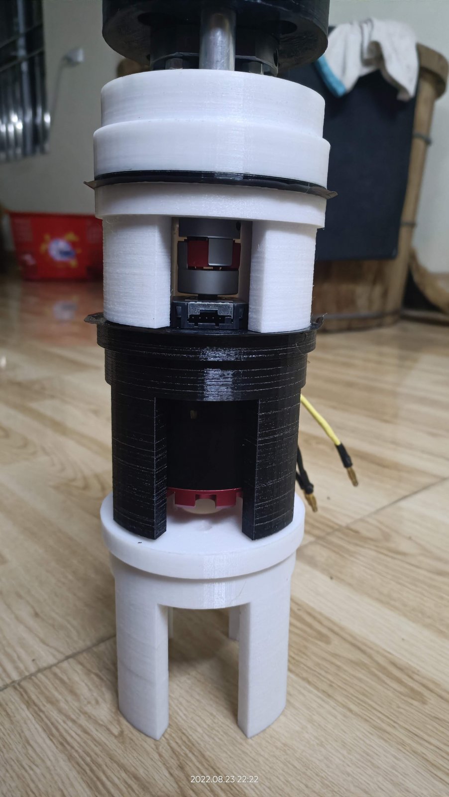

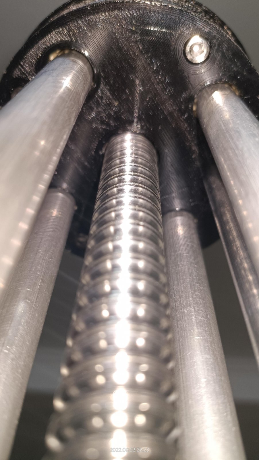

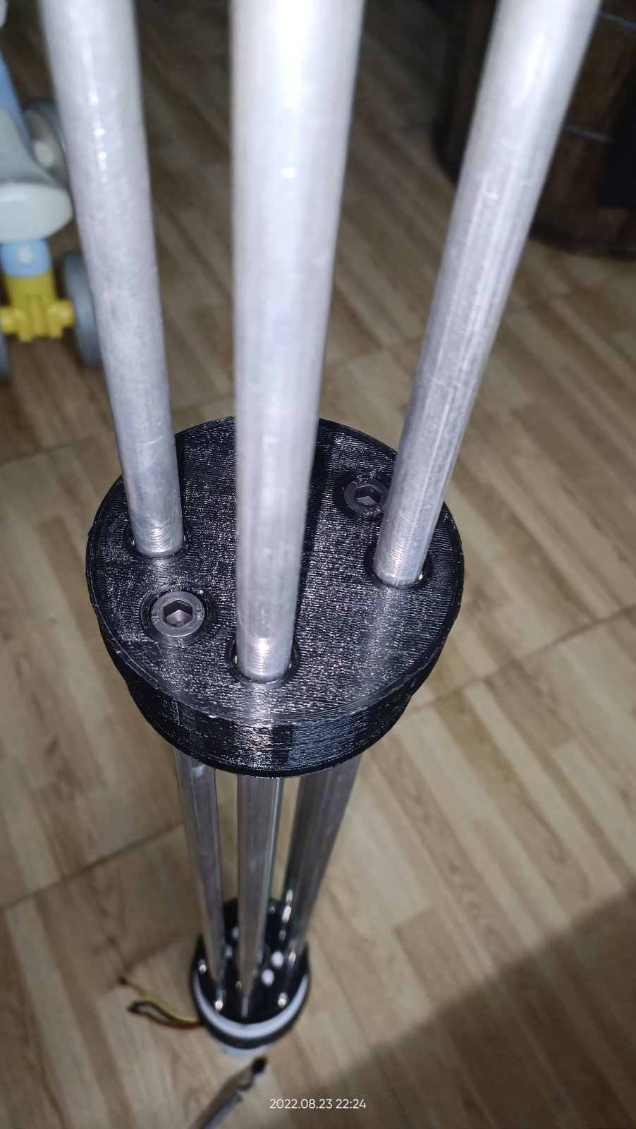

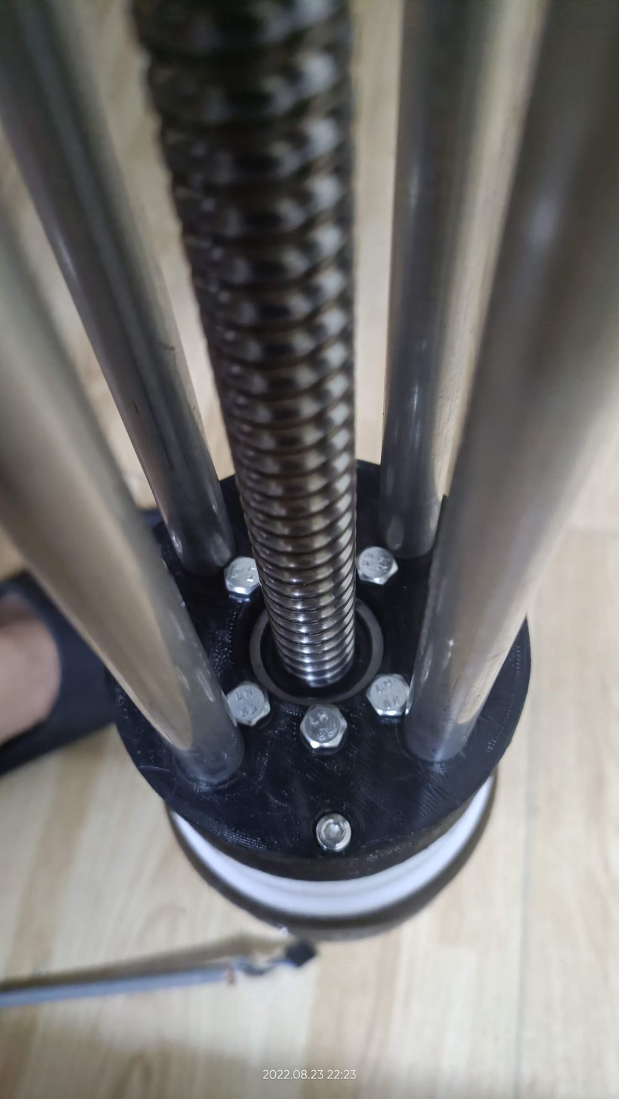

    Hi every body.
    This my new thread building 6 dof motion simulator using Odrive
    my design is combine from @SilentChill and @Peacemaker105 design. Thanks for your sharing
    Parts for 1 actuator:
    Motor 6364 200kv x1
    MKS Odrive V3.6 x1
    Ballscrew 1605 600mm x1
    Aluminum tube 12x2mm x6.
    FK12 x1
    RJMP 01-12
    uPVC tube 90x2.7mm
    Ball bearing 6000z 26x8x10mm x
    Lots of screw m4, m5, m8...
    PETG filament
    PSU 36v 16.7A (run but i thing need to change Cisco 6000W psu for all actuator)
    Here some pics and running test video:
