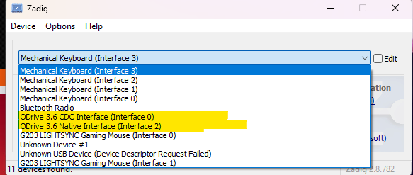

    I bought an Odesc V4.2 board, and it's not entering DFU mode.
    In normal mode, my computer detects two entries with the name ODRIVE 3.6 Native Interface and one serial port.
    When I switch to DFU mode, the computer makes the sound as if something is being disconnected from the USB, and it doesn't connect anymore.(softlock, resets when pressing reset again, and goes backto normal mode)

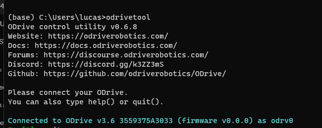

    What could be the issue? When I try to connect through onedrivetool, it connects and shows the firmware (v0.0.0), but I can't give the DFU activation command through the program. Does anyone know what can be done?

    This boards do not have dedicated switch or jumper but have special button:
    • Connect board to PC via USB cable.
    • Connect external power. Controller will boot in normal mode.
    • Press and hold BOOT button.
    • Press RESET button - controller will reboot in DFU mode.
    • Flash firmware
    • Press RESET button - controller will boot in normal mode.

    sometimes I am testing new actuator- concepts with the Odesc 4.2 board.
    You can Flash the firmware Super easy with a cheap st-link v2 and the stm32-stlink- Utility Software. Youtube will show you how to do.
    By the way: the Odesc 4.2is a great piece of Hardware!
    And in the Odrivetool you have to call it dev0 instead of odrv0

    I have same problem, someone find a solution about DFU mode? Or StLink2 is a must?
  8. m50b20
    m50b20 Member
    Jan 4, 2024
    87
    112Coins
    +60 / 1 / -0
    I have no problems with DFU, but Stlink is much easier
  9. William Fanelli
    William Fanelli New Member
    Nov 20, 2024
    28Coins
    DC motor, Arduino
    Not so easy. I bought a st-link v2, upgraded and connected to odesc, but don't work. Do you have suggest?

    Ok, I soved. at first, I used STM32CubeProg, ant it DON'T WORK.
    I tried old STLink utility, an this tools work but don't load .elf firmware (need to be HEX or BIN).
    But after some search, I discovered that with STM32CubeProg i can load .elf and save .hex, so, after this passage I was able to flash my firmware.
