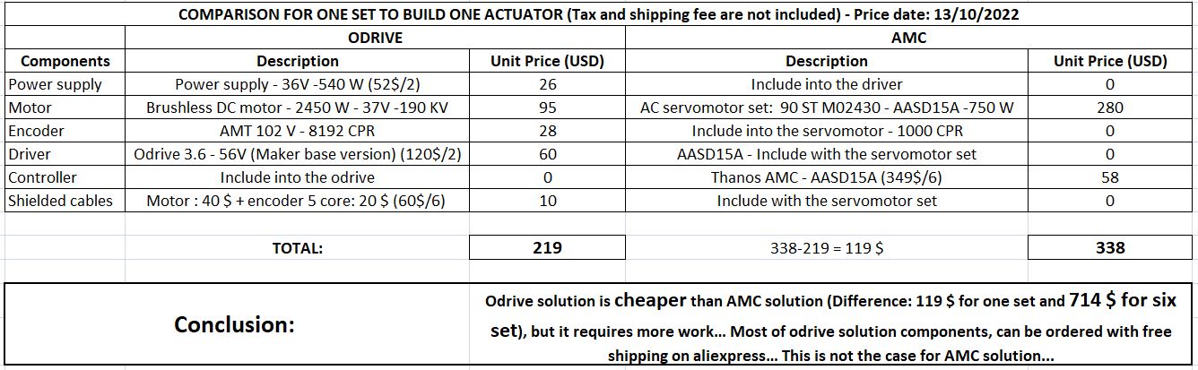

    Looking forward to seeing this come together. How do you anticipate the final cost will compare to the SFX actuators?

    It's a good question that i wanted to answer since a long time. To answer your question, i make a table to compare only, the motor set between odrive solution and AMC solution... I don't want to discuss about this subject.... The conclusion is enough clear on the table i think.... Thanks :)

    You forgot to mention that the AASD servos are available from small sizes and power (flange 60mm 400watt) to huge power and flange size (flange 130mm 5KW)...
    And don't forget the safeties included in these industrial servos, STALL protection, Over Torque protection, Overspeed protection, Automatic detection of faulty encoders or cabling, lower currents running through cabling compared to DC solutions... in short, everything to not worry if something catches fire!

    As i said, on another thread, this table is an answer of peope who asked me the difference price between the two solution. So i make a comparison with the price criteria only.... As i said, the amc solution is easiest than odrive solution. I don't want to discuss about who is the best..... Both solutions deserve to exist ;-)
    Another thing, you know that it's not adviced to build a rig with a 60ST ac motor because , torque is too low.....That's why , 100 % people use 90 ST or 80 ST motor....
    In odrive firmware that i use, there's also several security about speed, current , torque etc.....
    I repeat, there's no competition.....Both solutions deserve to exist....People make their choice ;-)

    Sure. But another item not included in the cost math in that table, the high quality shielded wiring for the servomotor power and encoders that is included in the servo drive and servomotors kits.
    In DIY BLDC, you could spend lots of money and time having to gather the really thick AWG wiring, manufacture your own cables, add shielding, and also build the shielded wiring for the encoder.
    It's very easy for someone without experience in making such wiring, to make mistakes that can cause problems, happened to me even with experience in the matter. I try to use systems where you don't need to make any wiring or cables, and use what is available off the shelve, already build!
    Again, pointing out what really matters, not competing, and that users should educate for themselves before take on something because its a few $ cheaper. Almost every time there's a catch.

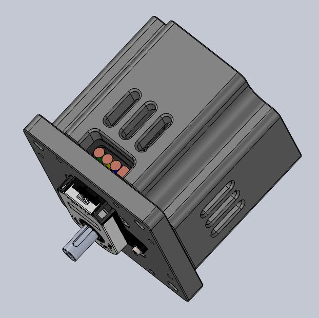

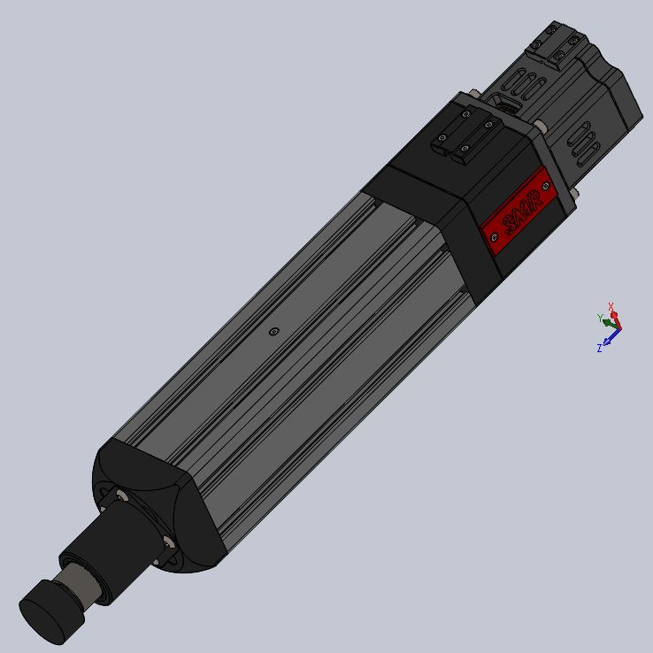

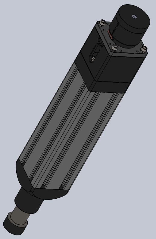

    Work is progressing....
    The actuator is fully designed ....
    Stroke is : 200 mm (+ 20 mm security stroke)
    The actuator uses a custom sevo brushless motor with integrated fan :)
    The actuator can be used in real push/pull mode with u-joint on each side if needed.
    If needed for fun , the actuator can work without motor cover ( but it's not secured to do that :) )
    It's time to print the different parts in PETG ....

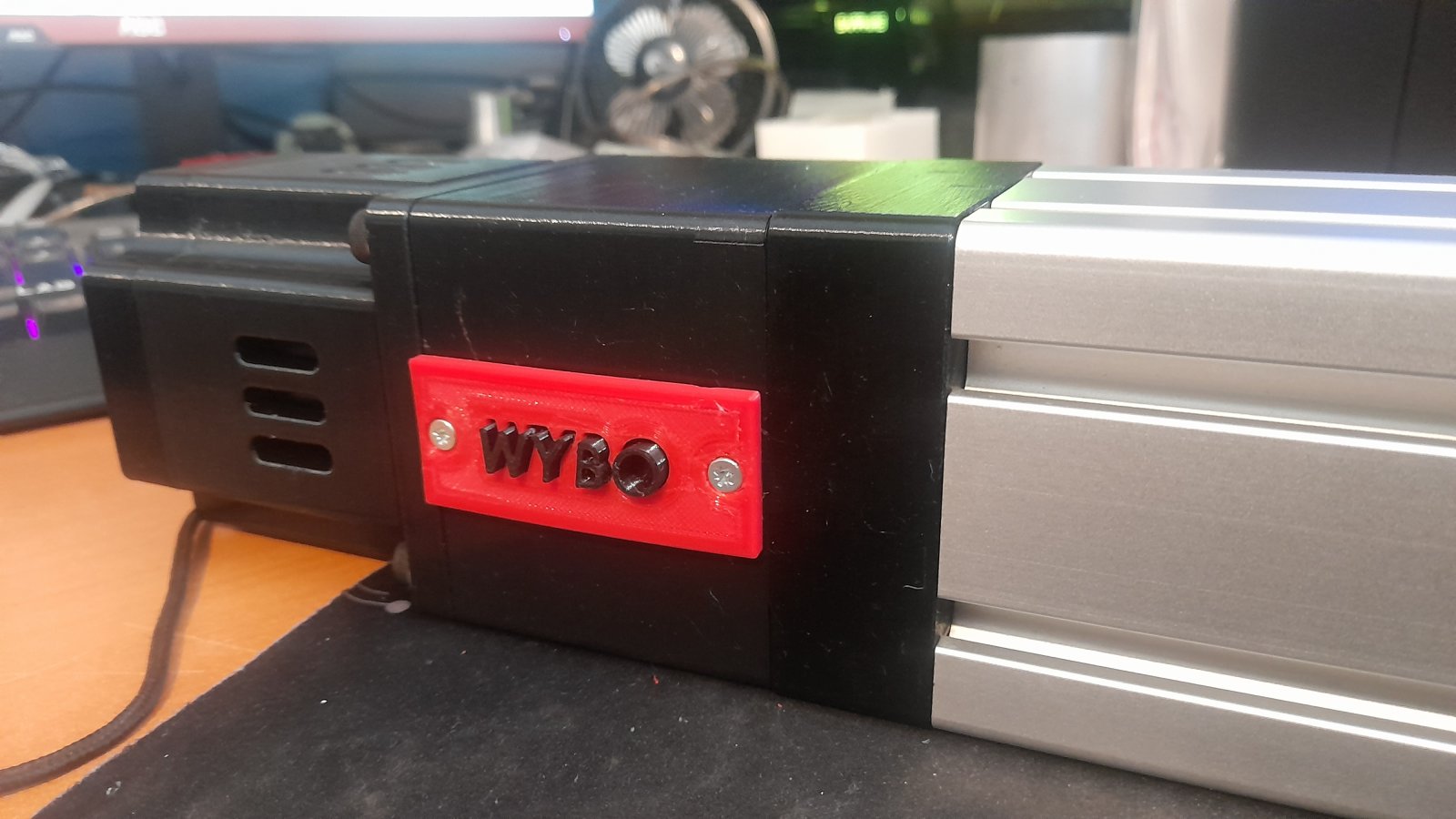

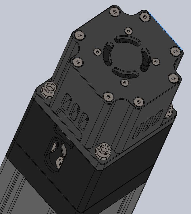

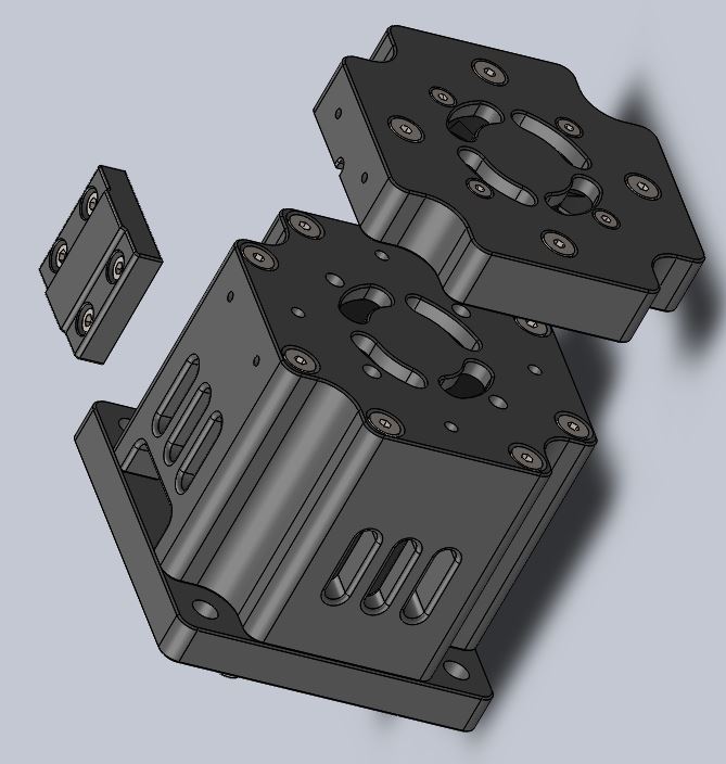

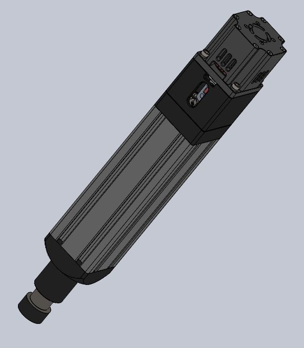

    There' s some news about the development of the actuator. I made some improvements as you can see on photos.... The fan is now a separate module that you can add in option. Power cable and encoder cable is now securised by a cover... To finish, i added a plate to secure the access of the coupling.
    It gives a nice actuator :) Evo 1.jpg Evo 3.jpg

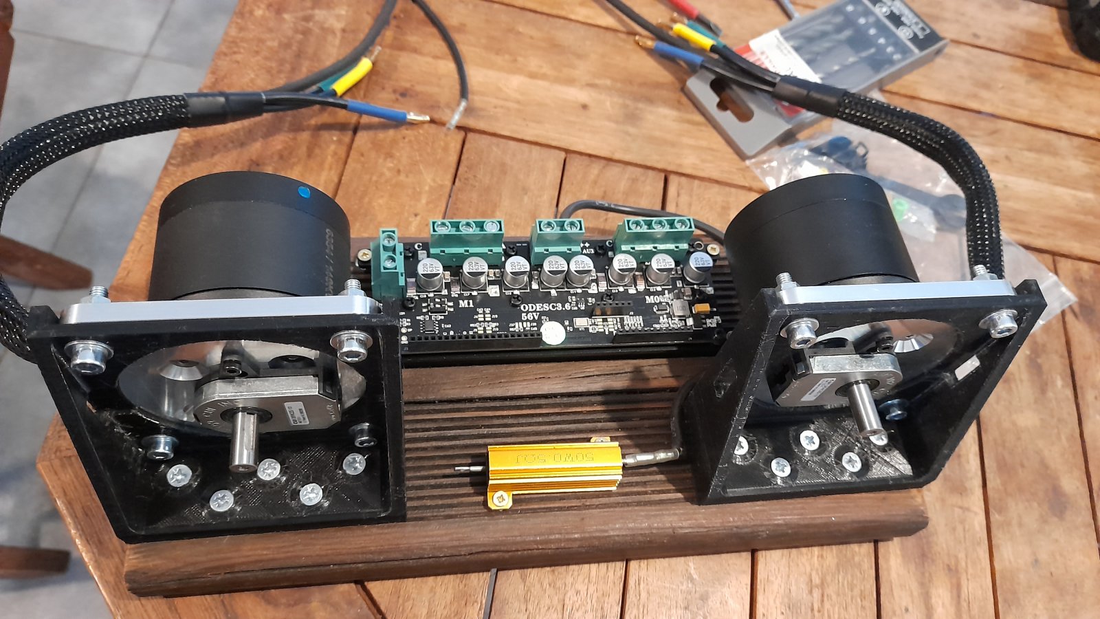

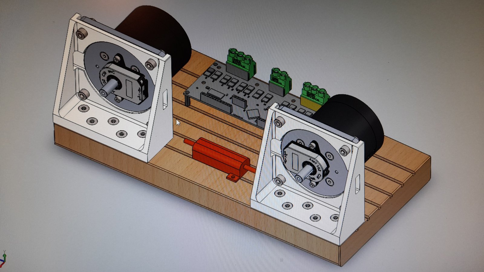

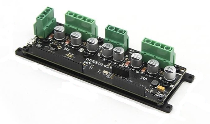

    About the ODESC, i made a test bench to develop and set correctly the board.... The final will be a good surprise !!! It's for soon :thumbs 20230524_123051.jpg
    And the real :o:

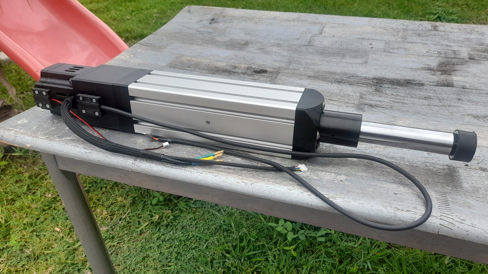

    The first real actuator looks very cool !!! hug:
