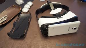

    Already good hello to all Then here I have just made a house simulator!
    I have a samsung note 4 and I also have the helmet compatible oculus!
    I know that I can stream games pc on my phone, but suddenly I think to use it with the simulator. My questions: are the compatible games simulator also compatible with oculus? Has anyone ever done this method? Thank you for your answers ;)

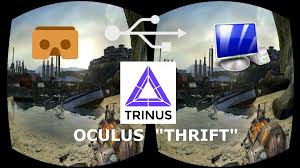

    Then super cool thank you very much the system nolo never seen but it looks nice For streaming oculus and pc if it works by usb also a priori have the right to put links so I use trinus vr and I get a streamer gta5 for example in 3d but it takes a good pc. I will find a link and put it on my post In any case thank you very much for your help

    I have just done some test on gta and dirt it works quite well but the quality of image remains very mediocre!
    I do my streaming in usb what remains best to use.
    The wifi, even not the trouble I try because my Internet connection is slow
    It's still a nice thing to try anyway. But it will never be worth the htc alive or others!

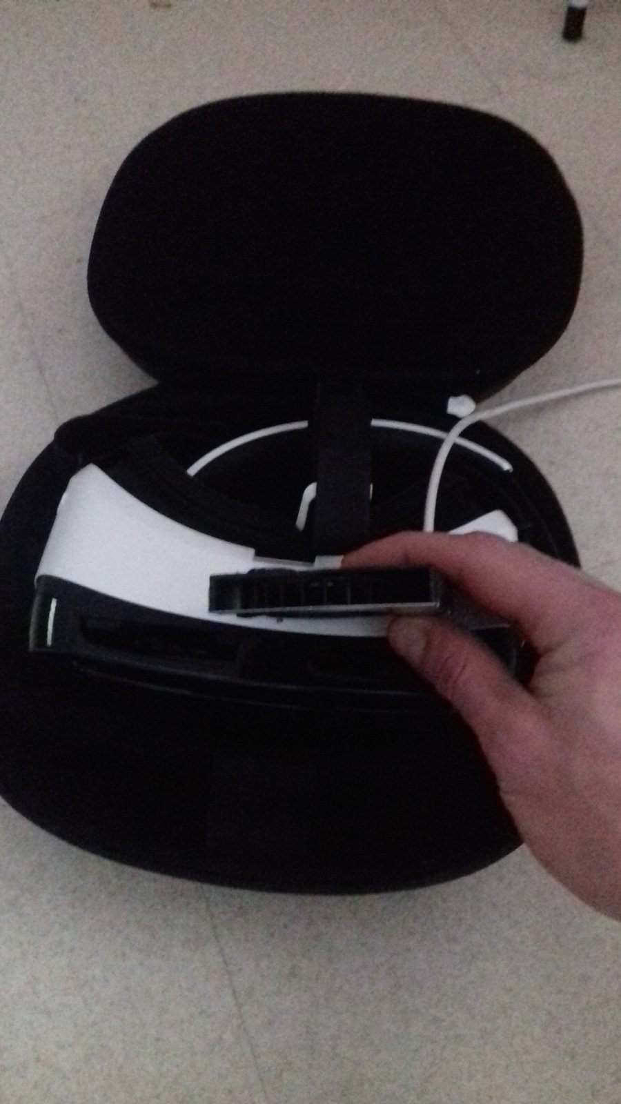

    Another thing I want to point out! If you want to try: The note 4 heats very quickly and cuts even after 5 minutes of use! The trick this make a small fan to cool the chipsets To slide between the phone and the helmet cache it allows to play non stop! And I advise you also to invest in a battery zerolemon 10000mah and the is happiness ;)
