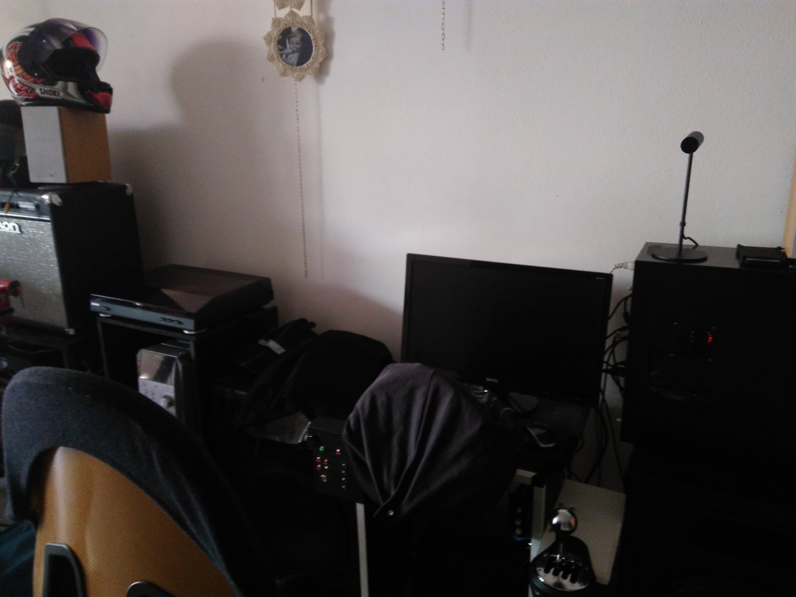

  10. SilentChill
    2,645
    20,598Coins
    +3,570 / 34 / -0
    I don't really get any issues, I get thrown around quite a bit and the vibrations are pretty intense which you can't actually see. I think mounting the camera closer has always seemed to work for me.
    You can see I have mounted the rift camera just above the steering wheel.

  11. Trip Rodriguez
    Trip Rodriguez VR Pilot
    May 8, 2016
    683
    Lake Ariel, Pennsylvania
    3,977Coins
    +331 / 7 / -0
    So that's two of you not having problems and not having to use a gimbal. That motivates me to try to figure out how/why that is so I can try to get the same results.
    I tried mounting my camera on the front of my right side console the other day and it didn't seem to improve it any. Mounted there it was maybe 2 feet from my face, about a foot below the headset, but off to the side at maybe a 30 degree angle.
    I will try to experiment and see what I can learn.
