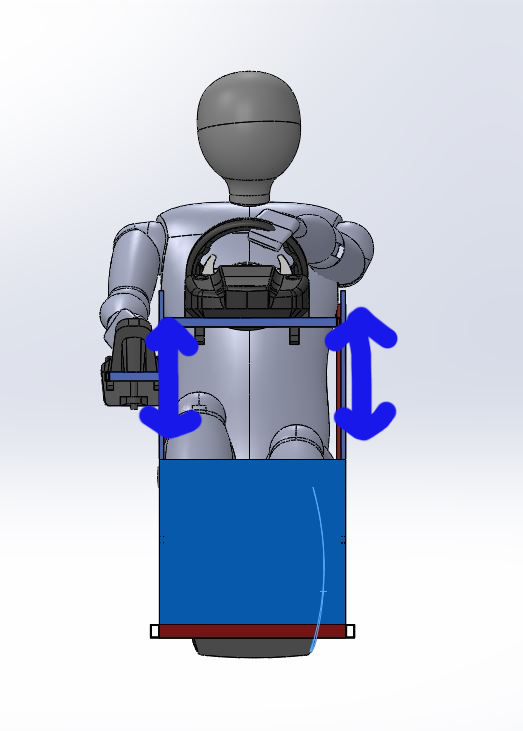

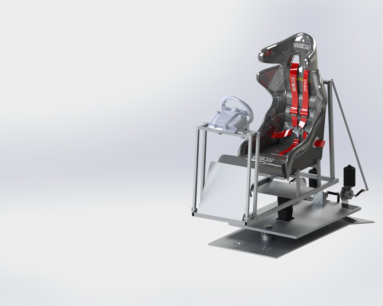

    Hi everybody!
    In behalf of my association I would like to present the project we have been working for a while.
    It is basically based on RacingMat concept, with some minor improvements related to allow movements for wheel, pedals and shifter (our association is involved in social activities with children and elderly people) and the addition of traction loss.
    As this is the first ever built for everyone working on this project, we spent lots of time in designing how the whole structure should eventually be.
    Here is a render we made after weeks burning our brains out: rendering.JPG .
    Please do note that every part in this image is in perfect scale (what an over thinking..:eek:).
    Despite this, the structure appeared to be too heavy, so this design has been slightly abandoned over time, resulting in a simpler and lighter structure that we are just starting to build. Hopefully our weak wiper motors should last longer.

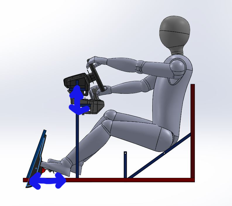

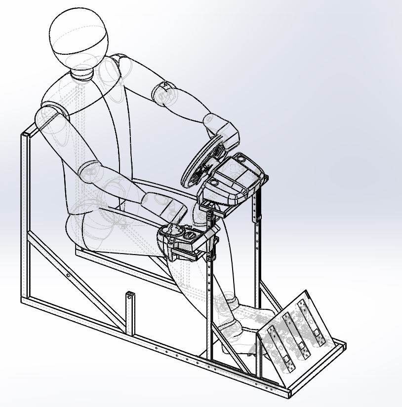

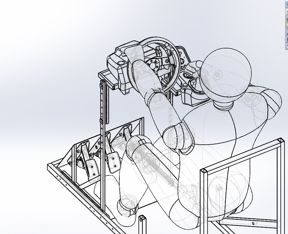

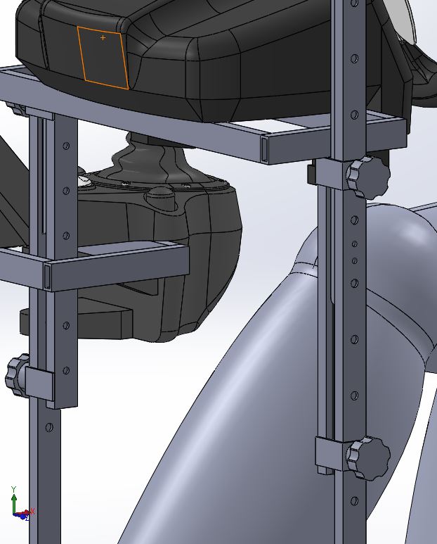

    Here are some sketches of the top part we are working on in these days:
    Cattura.JPG Cattura121.JPG lato_pattino.jpg fronte_pattino.jpg Catturablocco.JPG .
    Some others modifications will be surely needed and I will keep up to date this thread as they will be implemented in reality. When the project will be finally ready, I will also post quoted drawings, hoping to do something useful for the community.
