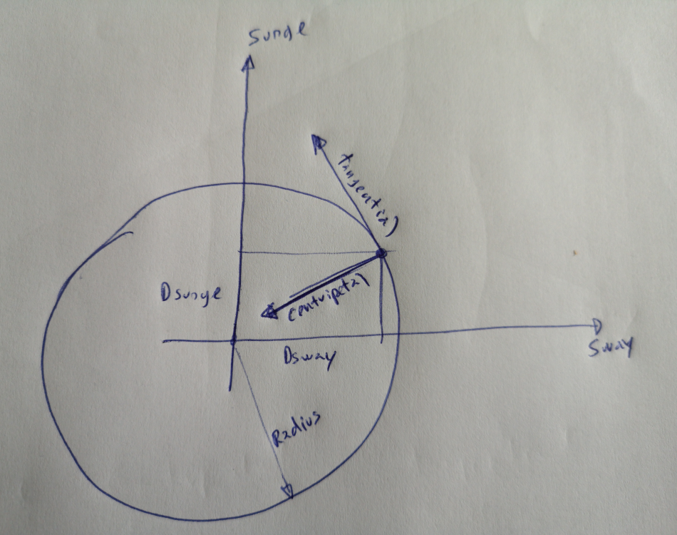

    OK, so what I do in Mover to solve this?
    I allow the user to set the COR (center of rotation of the rig).
    When the rig rotates, she rotates around the center of the moving platform by default.
    Keeping the default, is like saying that the game COG is on that location.
    You can change it and say where you want that COR to be in relation to your seating position.
    Aircraft's are extreme in this problem. The COG can be far from the pilot, while in cars it's close and easier to just adjust it in the COR of the rig.
    But you can do it for aircraft's also.
    Now you say that the tangential and centripetal forces are not present...
    Yes they are. Because if I move the COR far from the rig, and ask for the same rotation, I will get the same effect in forces felt. A far COR will produce an almost linear movement and the tangential force is there, but at a big scale.
    TangentialAcceleration(m/ss) = Radius(m) x RotationAcceleration(rad/ss)
    And centripetal?
    She's also there, we are rotating at the correct radius and speed, the force should be generated (but we have a small range)
    CentripetalAcceleration(m/ss) = Radius(m) x RotationSpeed(rad/s) x RotationSpeed(rad/s)
    And since we are at it:
    Tangential speed(m/s) = Radius(m) x RotationSpeed(rad/s)
    We have those equations for 2D.
    We have to add the effect of other rotations and add the components.
    So:
    - Yaw generates accelerations in the Sway/Surge plane/directions
    - Roll generates accelerations in the Sway/Heave plane/directions
    - Pitch generates accelerations in the Surge/Heave plane/directions
    But depending on the direction is the distance used.
    So consider that:
    - DSway = Distance in sway direction to the center we want
    -DSurge = Distance in surge direction to the center we want
    - DHeave = Distance in heave direction to the center we want
    We are going to use:
    - Sway component of tangential acceleration generated by yaw uses DSurge
    - Surge component of tangential acceleration generated by yaw uses DSway
    - Sway component of centripetal acceleration generated by yaw uses DSway
    - Surge component of centripetal acceleration generated by yaw uses DSurge
    - Sway component of tangential acceleration generated by roll uses DHeave
    - Heave component of tangential acceleration generated by roll uses DSway
    - Sway component of centripetal acceleration generated by roll uses DSway
    - Heave component of centripetal acceleration generated by roll uses DHeave
    The acceleration in the sway direction generated by yaw would be:
    SwayAccelerationByYaw = DSurge x YawAcceleration + DSway x YawSpeed x YawSpeed
    The acceleration in the sway direction generated by roll would be:
    SwayAccelerationByRoll = DHeave x RollAcceleration + DSway x RollSpeed x RollSpeed
    Adding everything:
    SwayAcceleration = ReceivedSwayAccelerationFromGame + DSurge x YawAcceleration + DHeave x RollAcceleration + DSway x (YawSpeed x YawSpeed + RollSpeed x RollSpeed)
    OK, now do it for other rotations and directions...

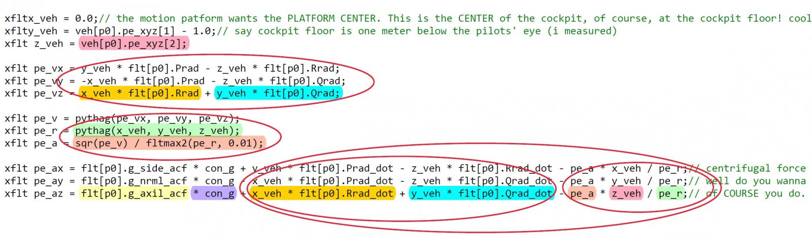

    nice to see this boil up again, since I think this is a feature that is important (at least for flightsims) and super easy to implement. I have a sneaking' suspicion this post will get kinda technical, but none the less: It is relatively easy to implement and I already have code running, tested and found to work nicely in Nutkicker.
    Fully agree! This sums it up completely! THIS is the problem and the solution at the same time.
    All we gotta do, is...
    1. Calculate those accelerations resulting from the pilot/ driver having an XYZ offset to the C.G.
    2. Add them to the accelerations that are acting on the C.G.
    ...and we have the total accelerations present at the pilot position. Those will then go into the motion cueing algorithm and are henceforth the only accelerations to be considered.
    I posted those pics before, but just to be on the same page:
    Bildschirmfoto 2020-04-27 um 18.23.19.png Bildschirmfoto 2020-04-27 um 18.23.27.png Bildschirmfoto 2020-04-27 um 18.23.36.png Bildschirmfoto 2020-04-27 um 18.23.51.png

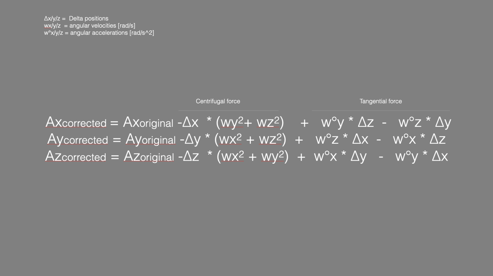

    How do we calculate those accelerations?
    In essence, this is it! Doesn't matter which direction x/y/z represents in your reference system. You can use them anyway you like, as long as you use them the same everywhere.
    ∆x, ∆y, ∆z are the offsets. So, if your fwd direction is x and your pilot is sitting 4m fwd of the CG, then ∆x = 4.
    wx,wy,wz are the angular rates [rad/s] around the vehicle x/y/z axis.
    w°x, w°y, w°z are the angular accelerations [rad/s^2] around the respective axis. I haven't seen them exported directly on any simulator other then X-Plane. They are available there as Datafrefs "P_dot", Q_dot" and "R_dot". They can be calculated relatively easy.
    If by "rotation still" you mean a constant angular rate, then I (and with me Sir Isaac Newton) disagree. Centripetal force is generated from the square of the angular rate[rad/s] while tangential force is calculated from the angular acceleration [rad/s^2]. So while having a constant angular rate, you will have centripetal accelerations, but will not have tangential accelerations.
    --> Constant angular rate will generate constant centripetal acceleration. And because the square of the angular rate is used, its sign is always in the direction towards the CG.
    Of course, if by "rotation still" you mean an angular rate [rad/s] of zero, then yes, they are all zero then! :)

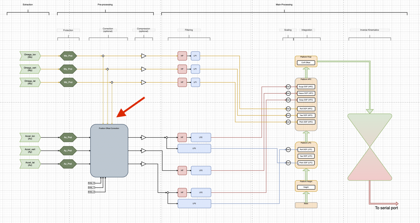

    This is also where I have to respectfully disagree. Here's why:
    The formula is correct. Just like all other formulae you use are correct. It's just that he angular rate you're using there is highpass filtered already! That means that the continuously present centripetal force in a turn during taxi or while spinning an aircraft was filtered out as well. It is simply not present in the signal for any period longer than ~500ms.
    Correcting the data stream at the source would transfer the long term effect of this angular rate [rad/s] over to the accelerations channel, where it would still be present, because that channel - at least the part that goes on to the low frequency content - is only filtered with a (hopefully 3rd order) lowpass filter. It can pass the LP filter completely unharmed :thumbs
    Here's the processing flowchart of my software.
    The red arrow indicates where the angular rates are transferred over. They will show up in the two tilt-coordinated channels as pitch DOF and roll DOF.
    Here is where we agree:
    AFAIK, Mover as it is right now is completely able to implement these effects if the user knows how to set it up properly. It would require to create 6 additional poses from motion and a little creativity, but it is possible! E.g. Instead of specifying an offset directly, you would have to (ab-)use the gain to "symbolize" the amount of offset.
    Actually, it was @hexpod 's idea who showed it to me in March. Initially I thought "hmmm, that could be a nice workaround" but now after looking into Mover a little, I realized that the softwares modular design is so incredibly flexible already that it can be implemented fully and correctly. :thumbs

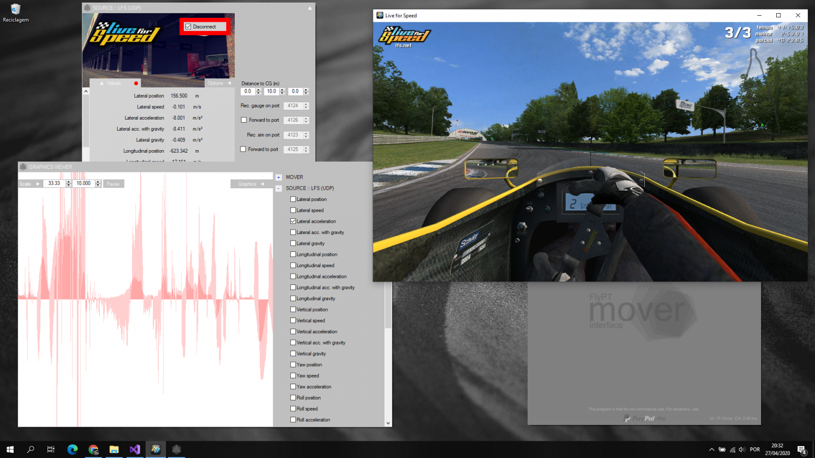

    @hexpod ,
    It's going to be in all sources.
    Making changes in some that miss the accelerations:
    You can see lateral acceleration with and without correction, simulating the driver 10 m ahead of the CG.

    We can easily call it “Top Gun feature“ following the Austin’s comments for centrifugal component in the code above which are, I was told, most probably related to the famous movie.
    // centrifugal force at the end
    // well do you wanna do the spin in top gun or not?!??!
    // of COURSE you do. of COURSE you do.
    If you like the flavor of the Hollywood style from the 80s, go for a short sequence :
