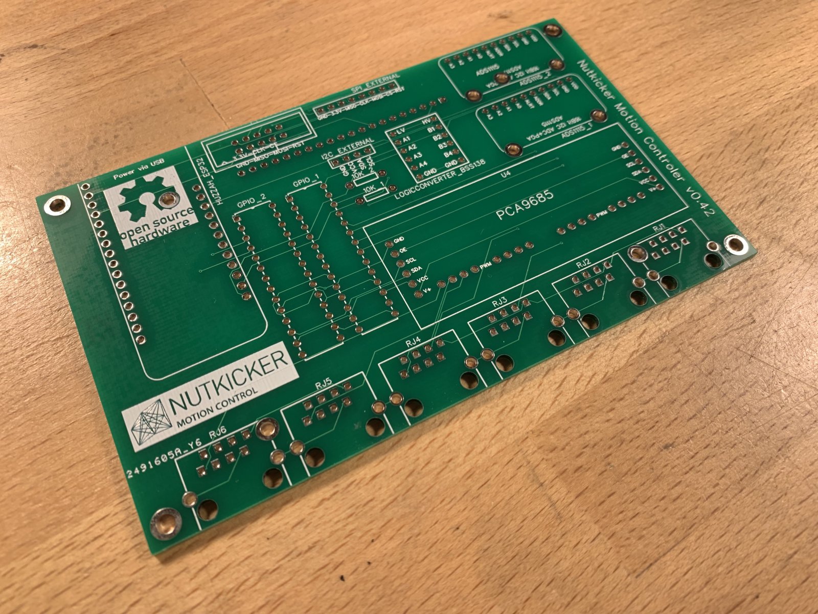

    After working on my software for the past ~9 months straight, I had to take a little time off from coding. Instead I started to work on the hardware controller that runs the PID loop for the actuators :)
    Initially I thought I could throw an Arduino onto a breadboard, plug a few wires in here and there and that would be about it. Boy, was I wrong!!! I found out to drive the PID loops for 6 actuators (with sufficient precision) I needed...
    1. Two general purpose In/Out chips (MCP23017)
    2. Two 16bit analog/digital converters (ADS1115)
    3. One PWM driver (PCA9685)
    4. One logic level shifter (BSS138)
    5. One I2C bus to read/write all the data from/to the breakout boards
    6. One SPI bus to display some basic status-info on...
    7. One OLED screen
    8. Lots of processing power (ESP32 Feather, 2 cores @ 240MHz)
    ...phew.....!!!!!
    With me being a total noob, who literally never held a soldering iron in his hands, it became quite obvious that aside from having to write a firmware for the controller, the real challenge would be to keep overview of the circuitry and the 150+ wires required to build it. Not to mention the nightmare it would be trying to find a loose connection in this spaghetti-mess of wires.

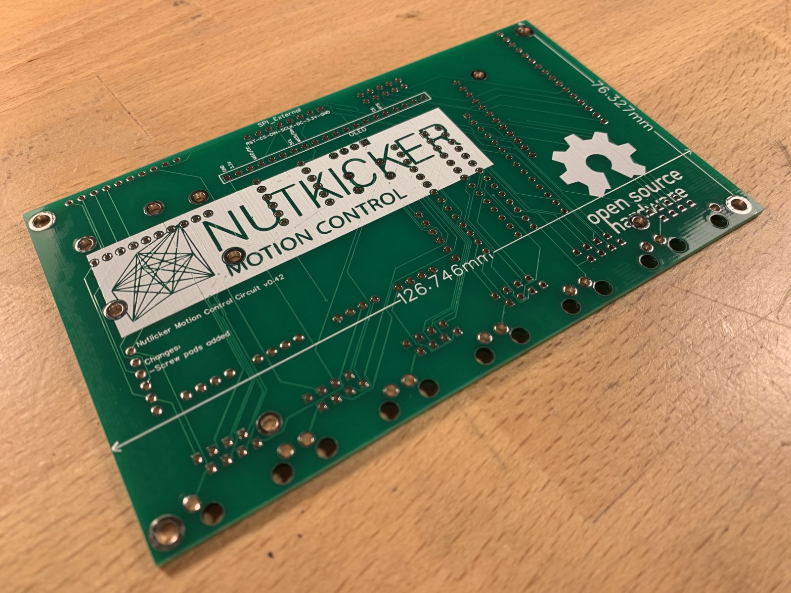

    I looked around and found www.easyeda.com. A program to create electronic circuits and have them printed onto a PCB (printed circuit board). I can't go into too much detail here, there are plenty of tutorials on YouTube, but let me tell you: IT'S GREAT!!! I can TOTALLY reccomend it.
    Tutorial part 1
    Tutorial part 2
    I created the entire circuit for the controller of the rig in the editor, placed all parts onto a PCB, let the autorouter do the routing for me, paid 7$ plus shipping and got 5 squeaky-clean PCBs a few days later in the mail:

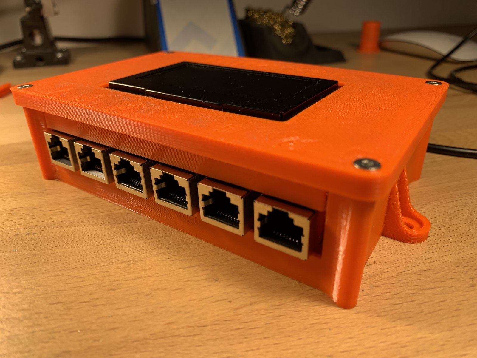

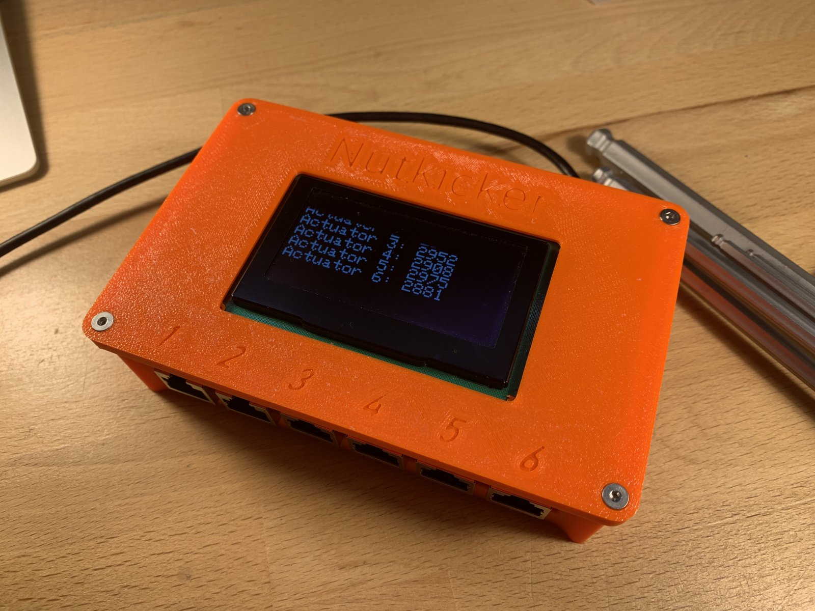

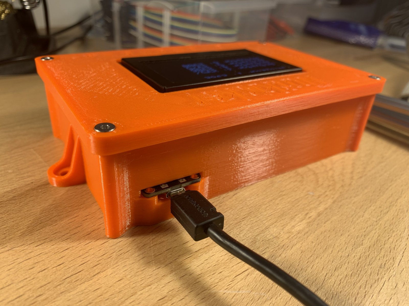

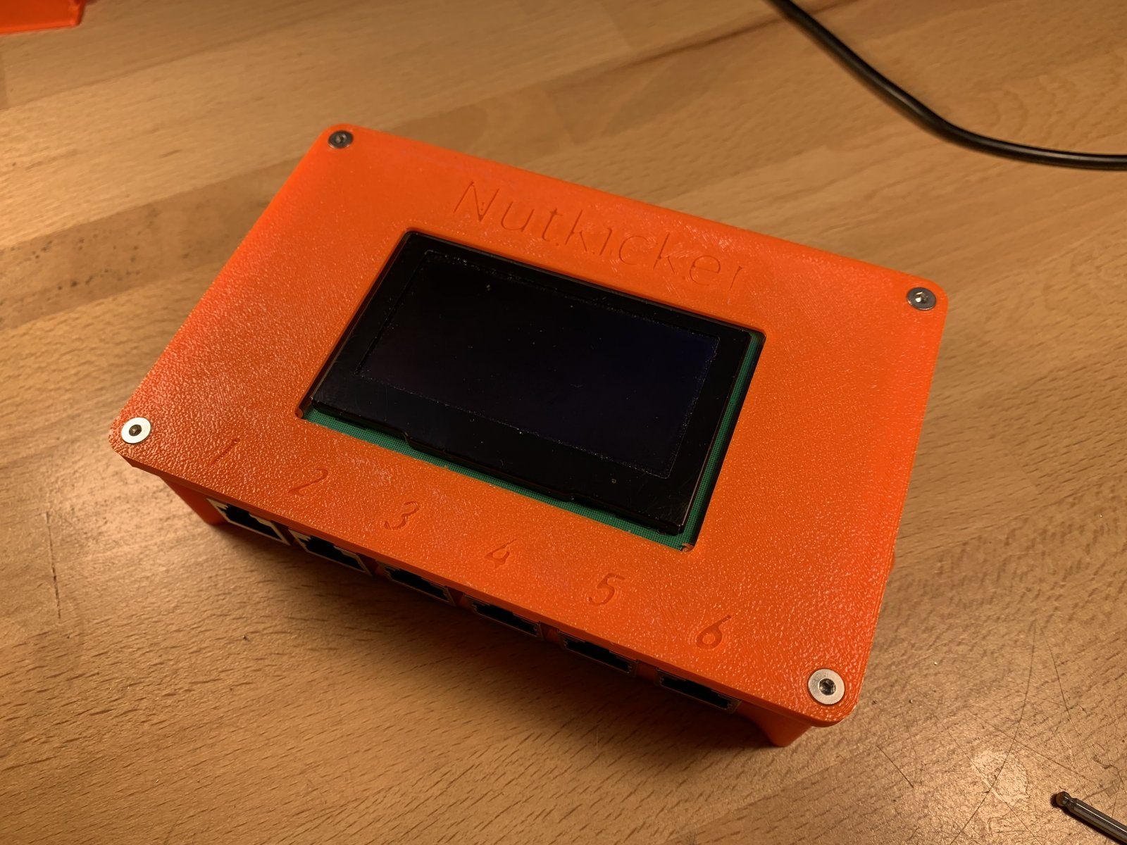

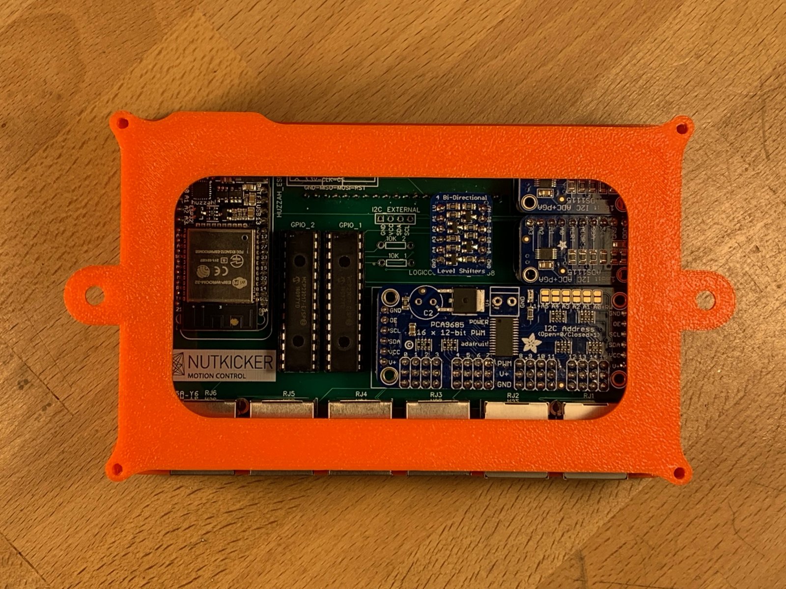

    Soldered the components (breakout boards from Adafruit) on, printed a nice enclosure for it and out came this:
    I wanted a screen to display some basic info:
    So, what I have now is a little orange box. One cable goes in (USB), six cables go out (Cat5 network cable to the actuators). Thats it. I won't have to spend time crawling under the rig trying to find that loose connection, but can instead spend more time here sippin' coffey :)
