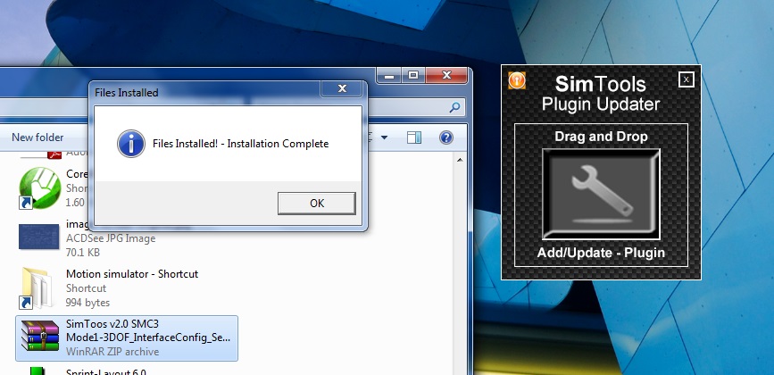

    @ne02005 ... For the new SimTools v2.1 the main plugin updater will accept all kind of zipped files " 2.1 Game plugins / interface preset / axis assignments preset /... " and will sort them accordingly .
    If you're sure that the interface preset is for the new Simtools 2.x so it will be accepted and work perfectly .
    Let me know if you still have issues ... :cheers
