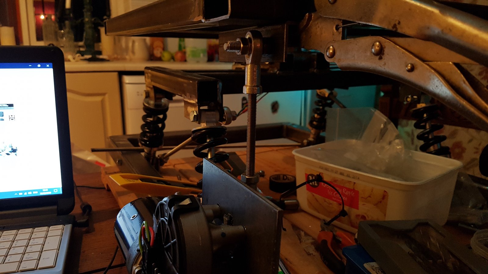

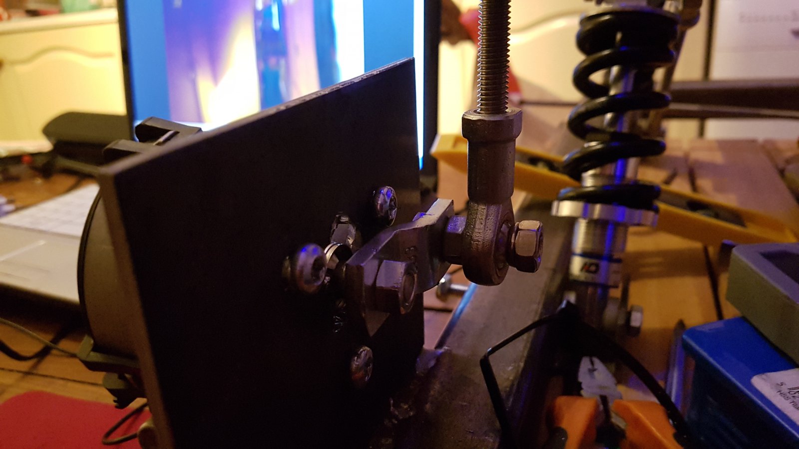

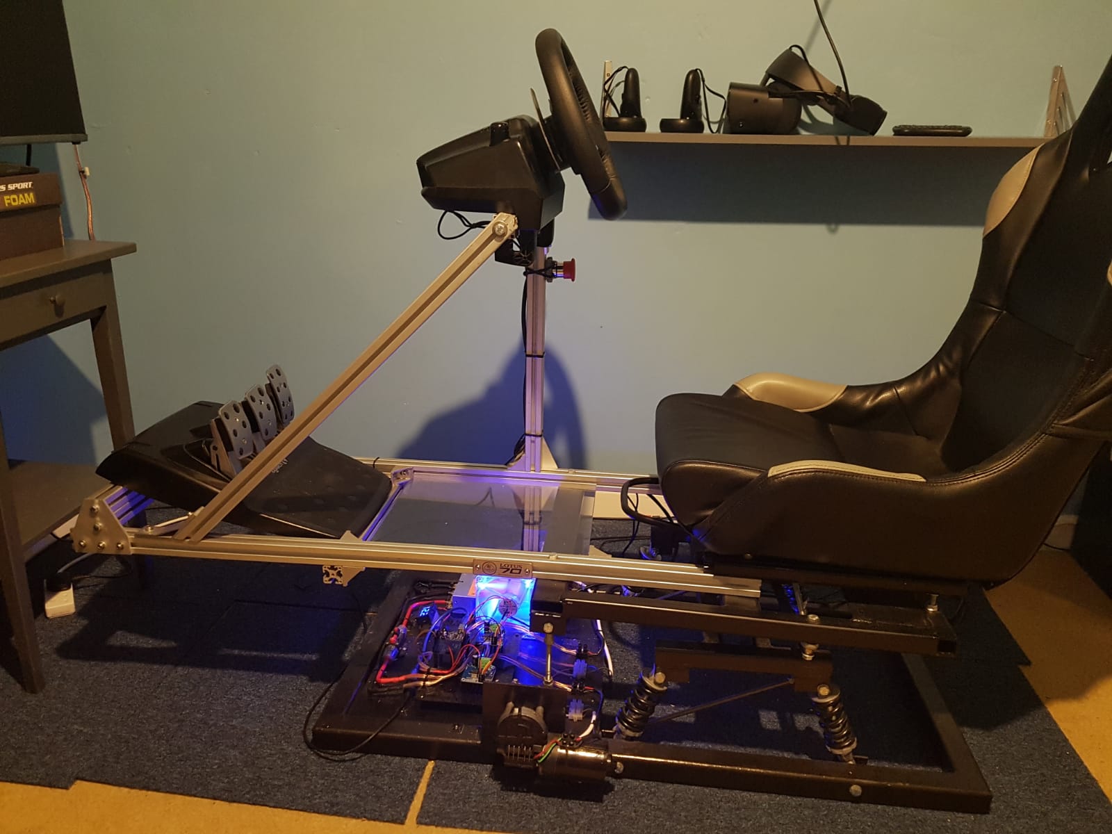

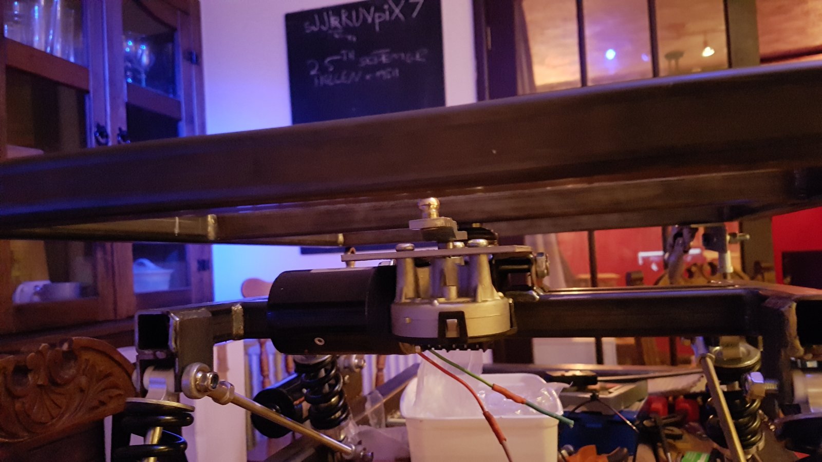

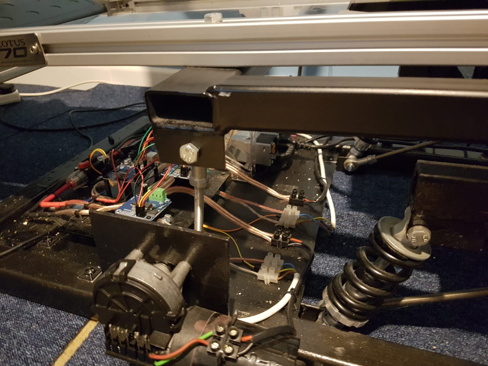

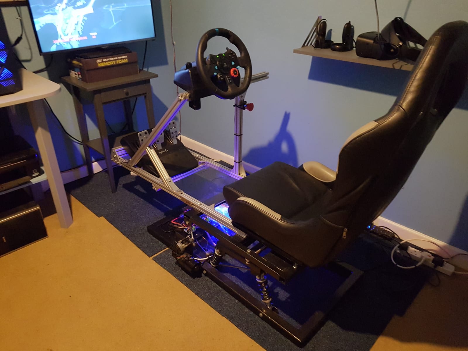

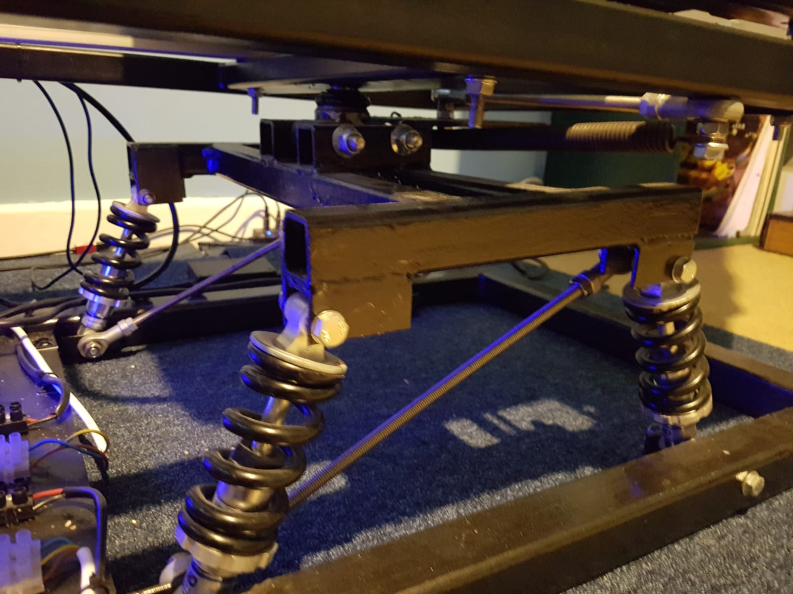

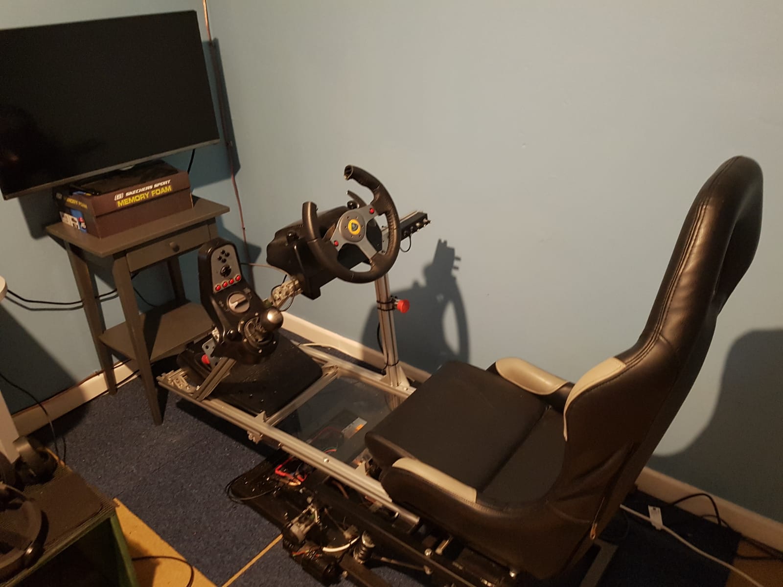

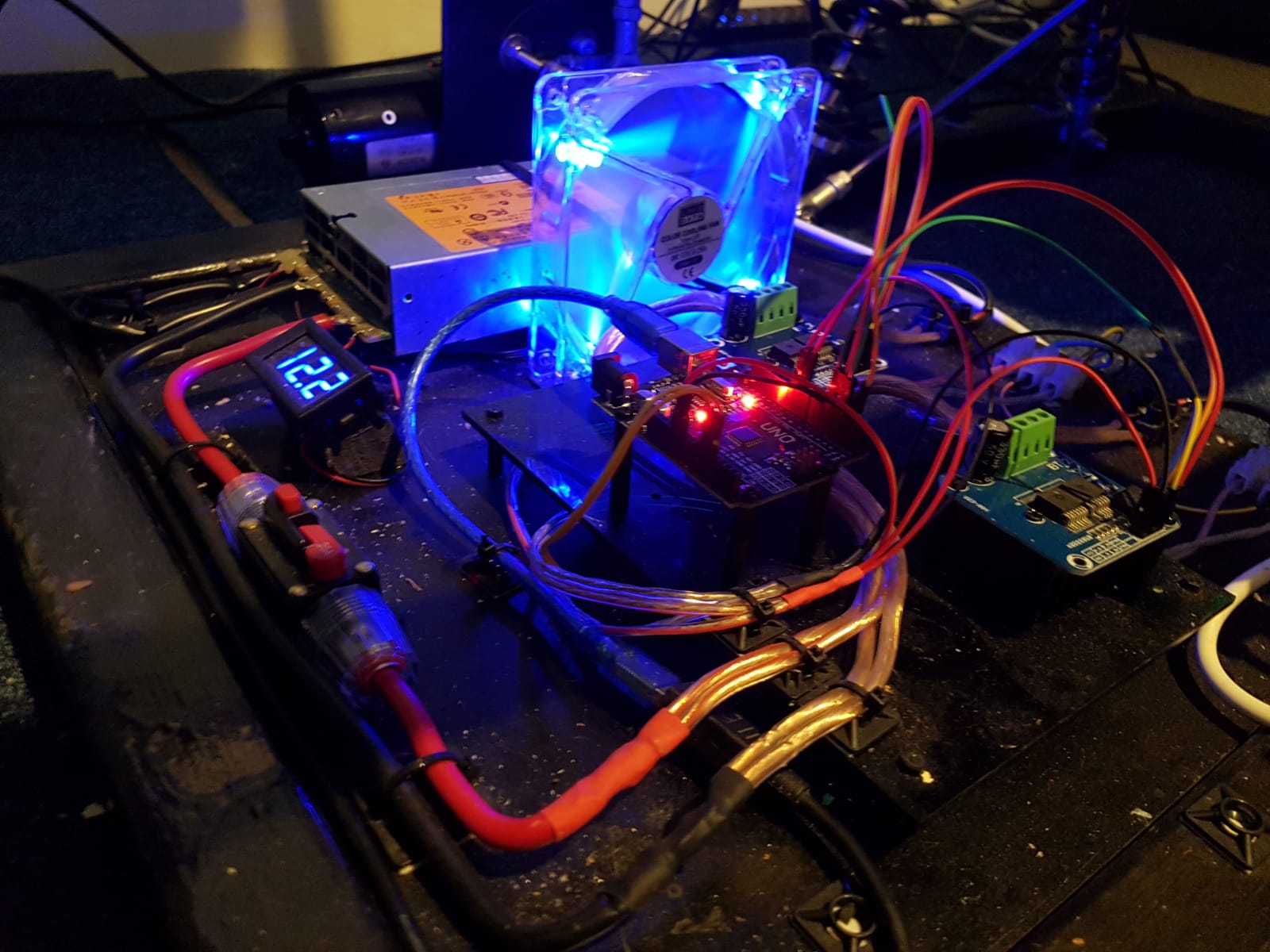

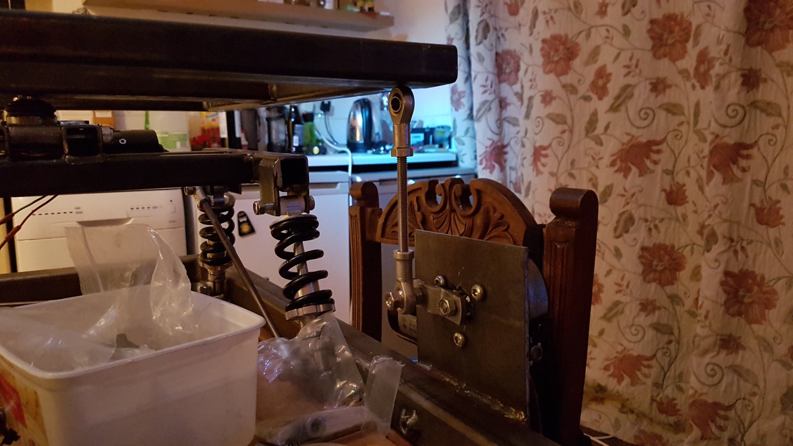

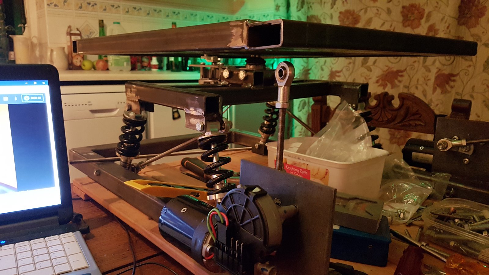

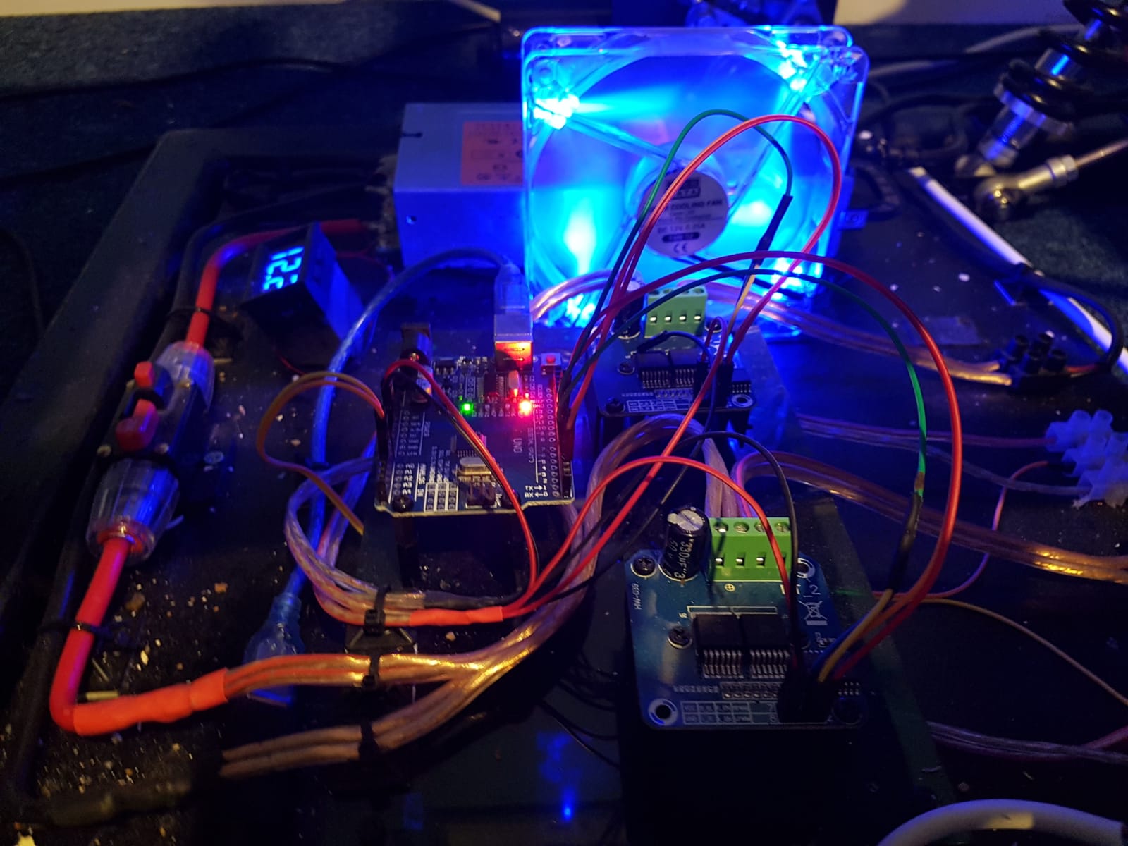

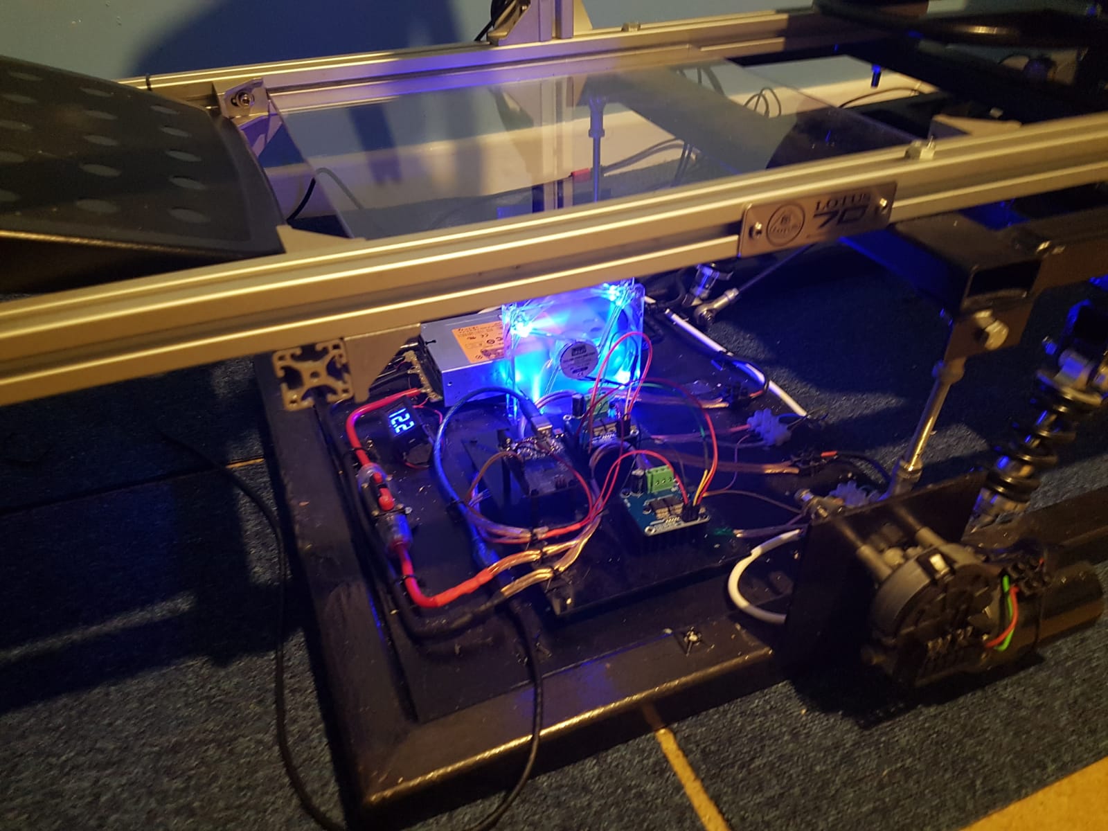

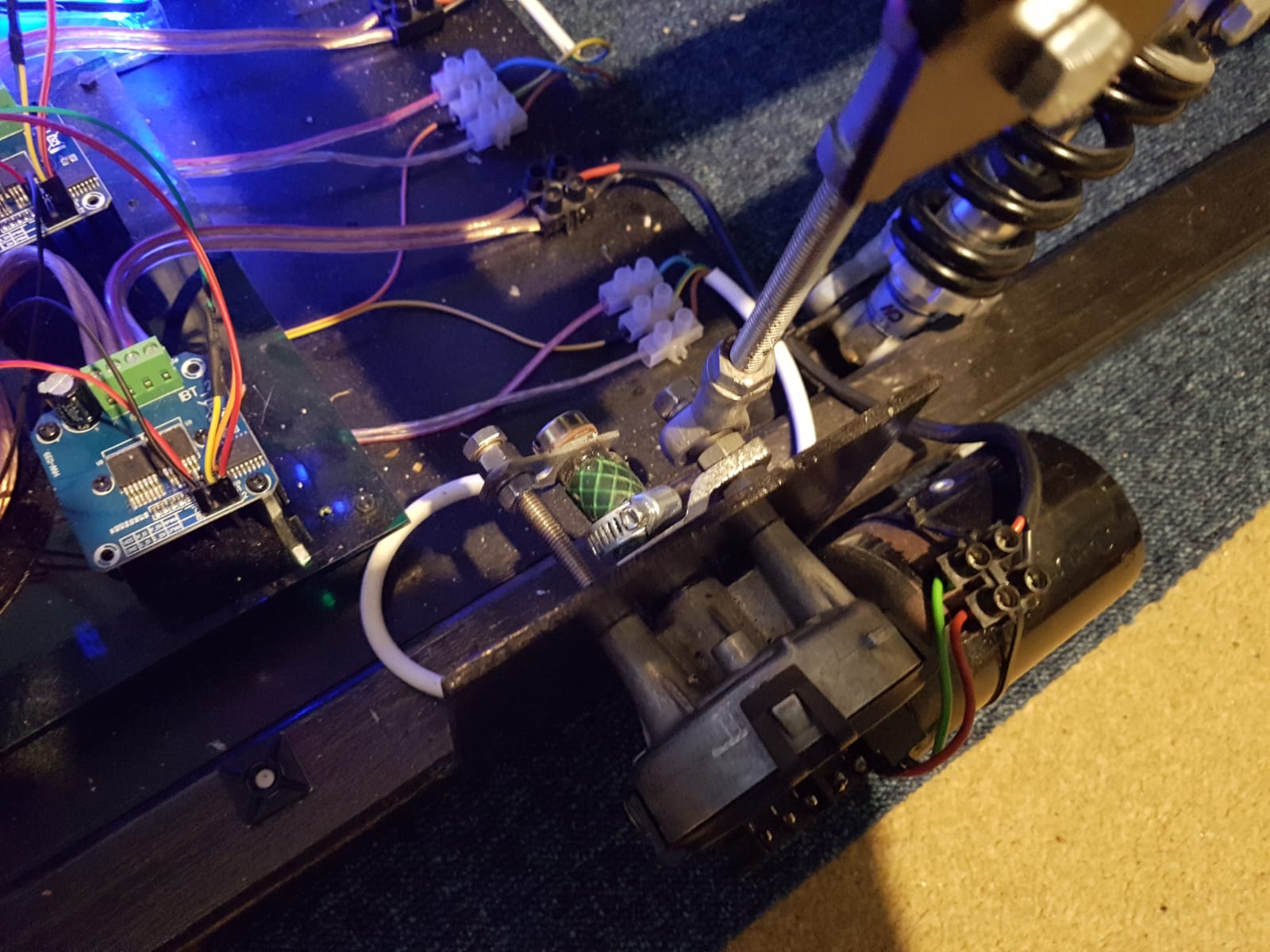

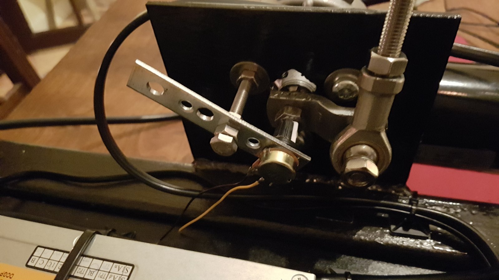

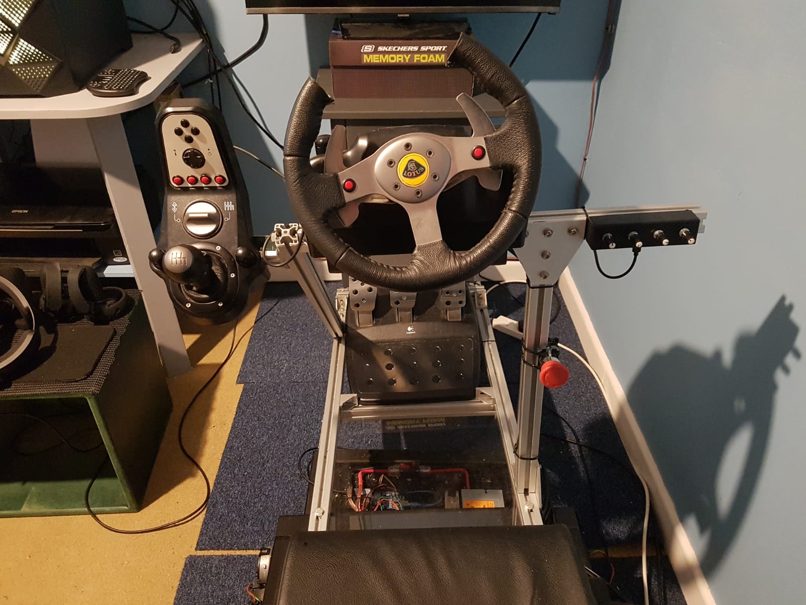

    Three years on since i started the sim seat project. now its all come togeather and working fine.
    ive swapped out the monster motor bords with 43A IBT-2 output boards.

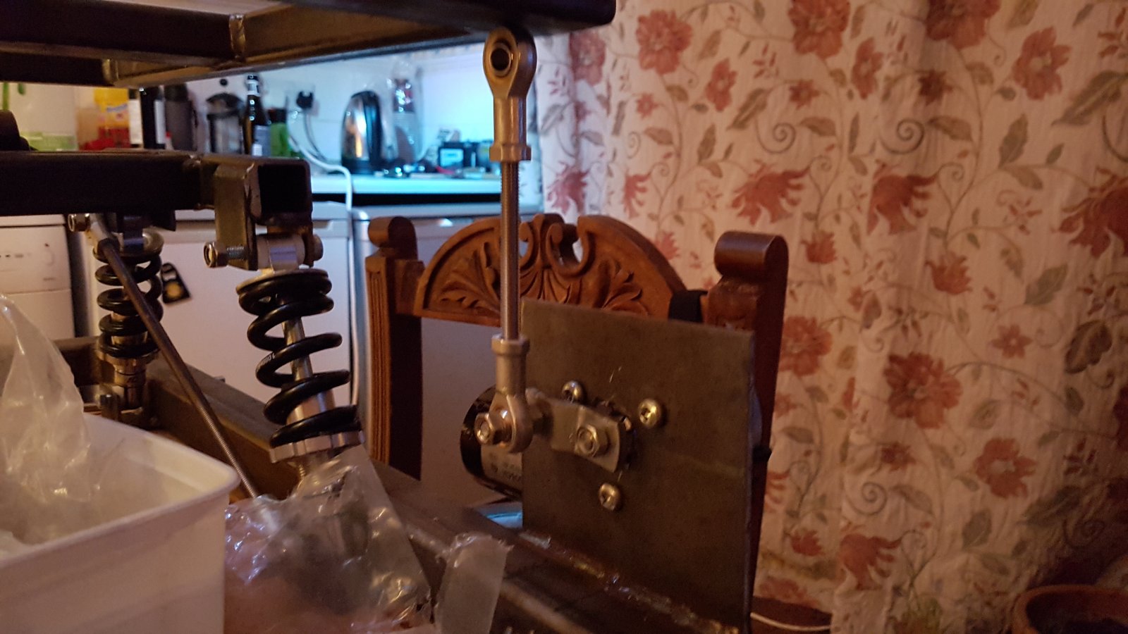

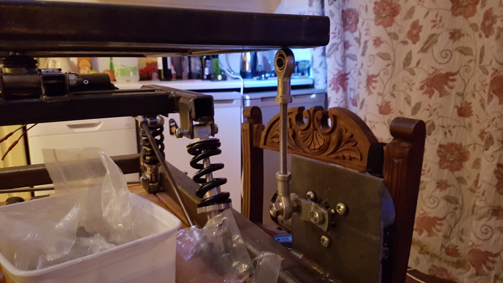

    due to the machanics of the rig i was unable to use the 3rd board and motor for the sway/slide motion..

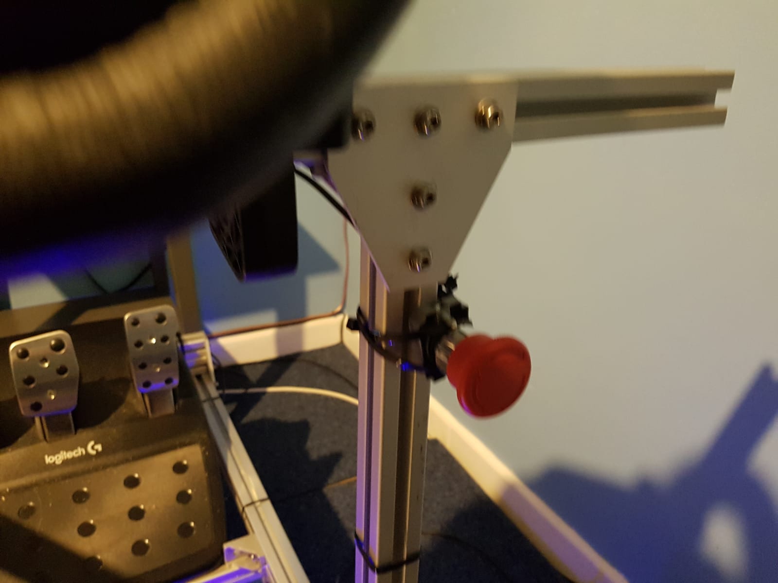

    theres big red stop button, just in case..!

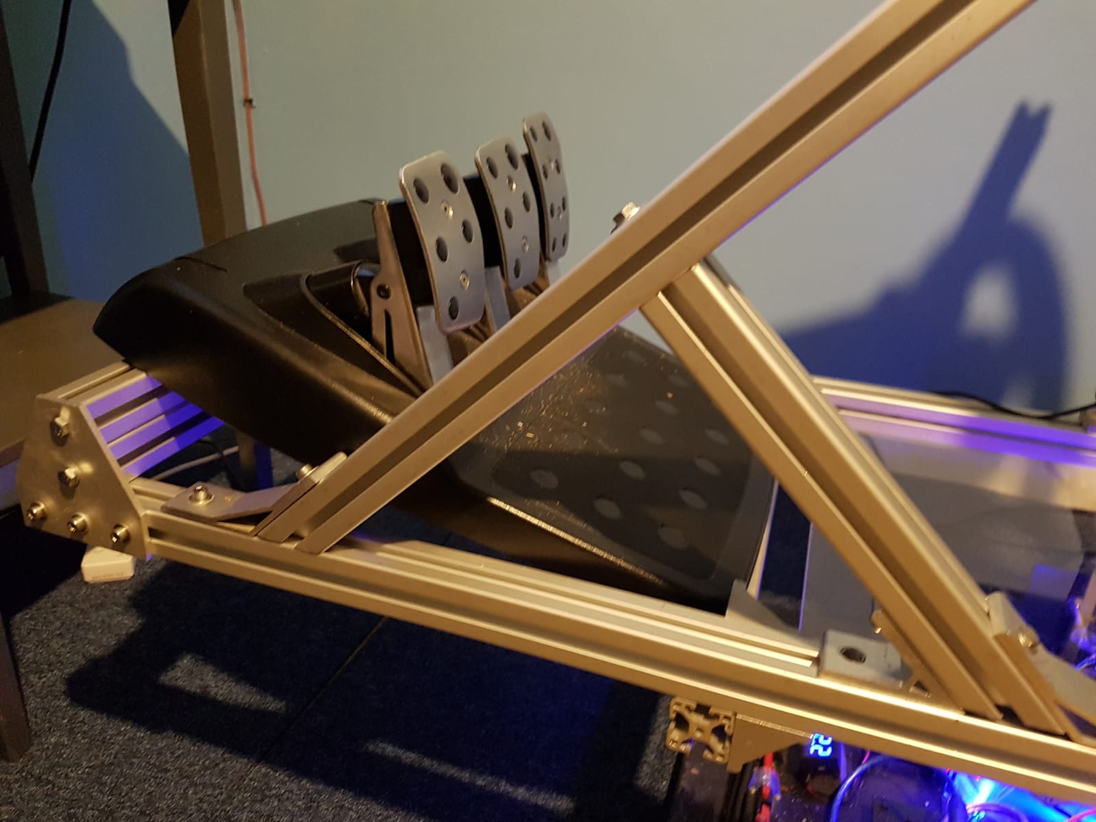

    as you can see ive made a box section sub frame and the usesd aluminum extrusion to make a top frame for the wheel and peddles.
    the drive motor are windscreen motors 4456dfgh.jpg 20200318_210045.jpg 20200320_184034.jpg WhatsApp Image 2022-12-18 at 15.06.15.jpg WhatsApp Image 2022-12-18 at 15.06.16.jpg WhatsApp Image 2022-12-18 at 15.06.17.jpg WhatsApp Image 2022-12-18 at 15.06.17222.jpg WhatsApp Image 2022-12-18 at 15.06.171111.jpg WhatsApp Image 2022-12-18 at 15.06.172222.jpg WhatsApp Image 2022-12-18 at 15.11.47 cdfgfg.jpg WhatsApp Image 2022-12-18 at 15.11.47.jpg WhatsApp Image 2022-12-18 at 15.11.48retertert.jpg WhatsApp Image 2022-12-18 at 15.11.49rte4t.jpg WhatsApp Image 2022-12-18 at 15.11.49tert35t.jpg WhatsApp Image 2022-12-18 at 15.11.49werwe.jpg WhatsApp Image 2022-12-18 at 15.11.4866789789.jpg from lotus cars.
    im also using a oculus rift s VR head set.
    the motion from the sim seat rig with VR really dose give another dimension to the experience of sim racing.
