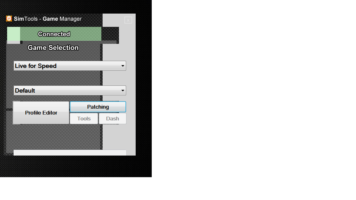

    Hi all, i'm testing with simtools and not i get connect to the game. I'm testing with two SCN5, i move this with the mouse, but then do not connect with LFS.
    Something must be missing me, I've been seeing in tutorials and my game manager will not let me click on tools or dash (like in the picture), so it should not be well patched and therefore does not make me anything LFS.
    What I need or i'm not doing well?
    My idea is to test the current base of two SCN5 I have with simtools and when I do well I make a base with 4 SCN6 or HyperAxis by Frex, as 4 D-Box
    Thank you very much in advance

    Lol im stupid hahhaha, lot of thanks noorbeast, now i can click on tools and dash, them im tried this to patched the game and see if works correctly. :thumbs

    Not at all stupid, it is a bug that @yobuddy is aware of.

    Yess! now run with LFS. If i need to invert the Axis where is this? In the guide says "You can invert the motor wiring … or invert the DOF in the “Axis Assignments”
    but.....where?
    20,463
    144,614Coins
    +10,741 / 52 / -2
    Checking or unchecking the small square box determines the direction.

    FYI, This GUI problem is fixed in SimTools 2.0!
