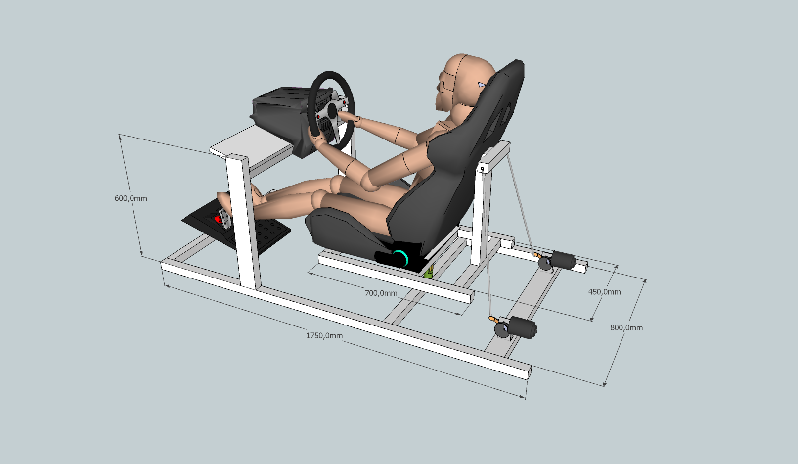

    After building two non-moving rigs I thought it would be time to go a step further and go for a 3DOF racing-rig.
    My plan is to move the whole cockpit part of the rig, which includes the seat, wheel and pedals.
    I don't like those 2DOF builds where the distance to the wheel reduces while breaking ... :thbd:
    Update 2011-01-23:
    Well well, after some responses to my 3DOF sketches I think I need to trust the old guys here. More power isn't a real option currently, so I reduced the planned rig and start with a 2DOF-seatmover. It's easier to realize and an upgrade to 3DOF is still possible at a later time. :highfive:

    Why don't you like 2DOF seatmovers? Have you even tried one before? Have you tried one with a good profile?
    A 3DOF platform like in your plan requires a lot more engineering, and a lot more money. 360W of power is not going to move a sim like that + a driver anywhere.
    I would reconsider those plans. :) You have to size up the power, or size down the platform.

    You won't get any kind of muscle tension or gravitation effect with your design ... and also no gravitation effect with a seat mover, just pure brutal racing feeling ... :yes:
    Bleco

    Rotating the platform around a stabilized center point with being able to have some movement up/down was the main idea and I thought/hoped the power would be sufficient to do that. As well as the effects resulting of that. ;)

    I hope our posts haven't dampened your spirits, but the above posters are on the money:
    1. - If you move the wheel and pedals too, you need to move quite a distance to get anything near the sensation of a seat mover.
    2. - If your stuck on this design anyway, Frakk is correct that you're going to need more power
    3. - Rotation from a center point feels good for flight, but is very unrealistic for racing IMHO.
    Just some things to consider while you're still in the design phase.

    Well, the responses made me rethink what I had in mind and how it would be possible to achive those ideas. Started to sketch a 2DOF solution. ;)
    I think I will give that a try and see how it works out.
    Thanks for the opinions, thats why i posted my plans here. ;)

    That is a wise decision. I rather see you succeed with a simple 2DOF seatmover project than get stuck and give up on a 3DOF sim after you invested tons of time and money.
