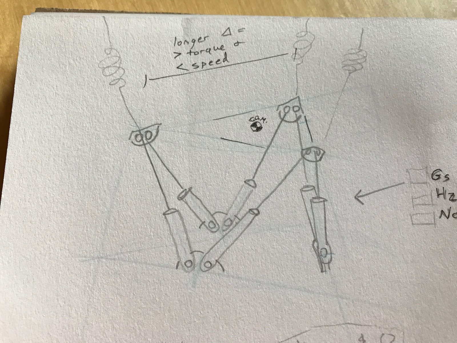

    Hey all, long time listener, first time caller :)
    Doing paper design for 6DOF flight sim and looking at all the member builds, I am missing something. I notice not a single one suspends the frame from above on springs, like a garage door does. I'd imagine doing this would reduce load on the motors in one direction and even out performance in both directions slightly.
    A quick sketch of proposed springs and a picture of the overhead door example attached.
    I'm thinking that hundreds of thousands of hours of community experience probably ruled this out. Can anyone confirm / explain? Thanks so much for creating this incredible community!

    Generally speaking a spring can take some load but it also requires power to extend or compress, it is a trade off greatly affected by design goals.

    Unfortunately it is like a cars suspension - all sorts of oscillations will be produced by the springs and the stored inertia as the sim moves. Like in a car, matched dampeners would be needed to tame these oscillations, but unlike a car in a sim we really don't want to dampen the fast movements. Best to not use them - or just expect and put up with the oscillations.

    Awesome explaination- thanks all! On to choosing control cables then... :)

    Instead of springs, add a counterweight like in an elevator...:)

    Haha- kind of goes against the weight limiting ideal tho...
    I imagine dramatically under-springing the load might be able to shave some of the effort off without introducing oscillations, but that will be easy enough to test once we have a build on :)
