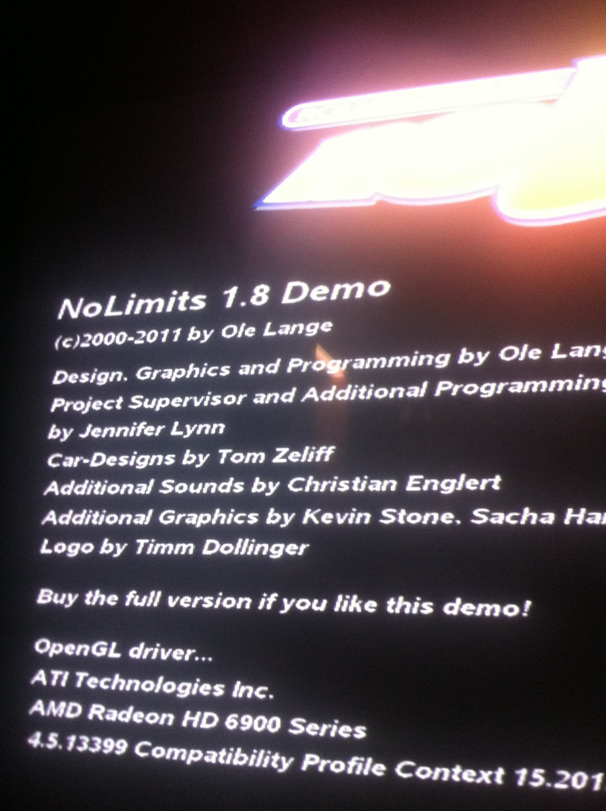

    i am now gone back to the original tread demo of nlrs 1 v1.8 thats the info the game tells me the version it is.

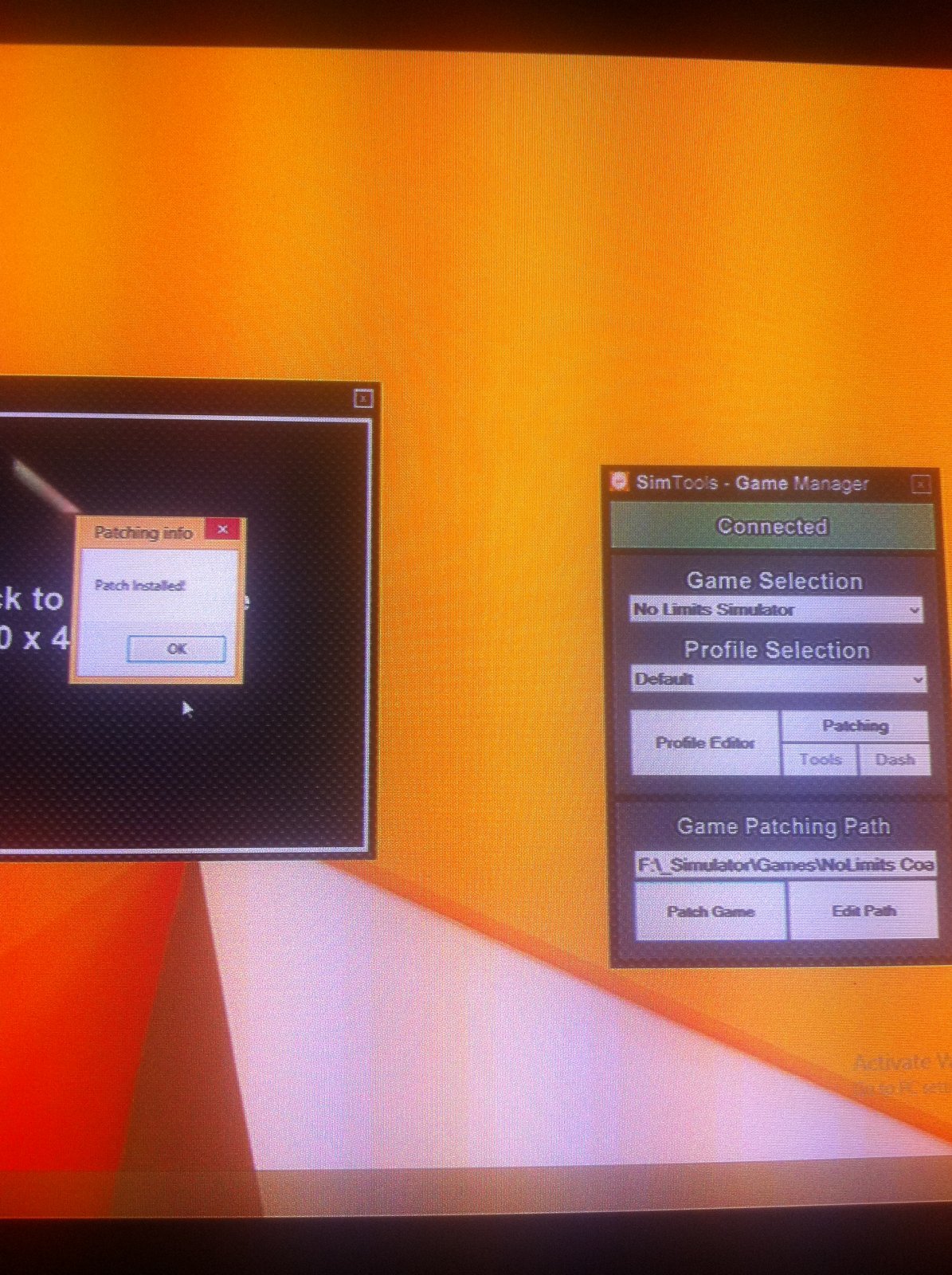

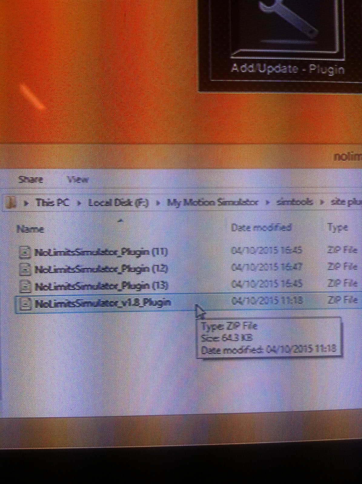

    this is the plugin i drop into updater which install correct and say so after dropping in ther updater. IMG_9565.JPG

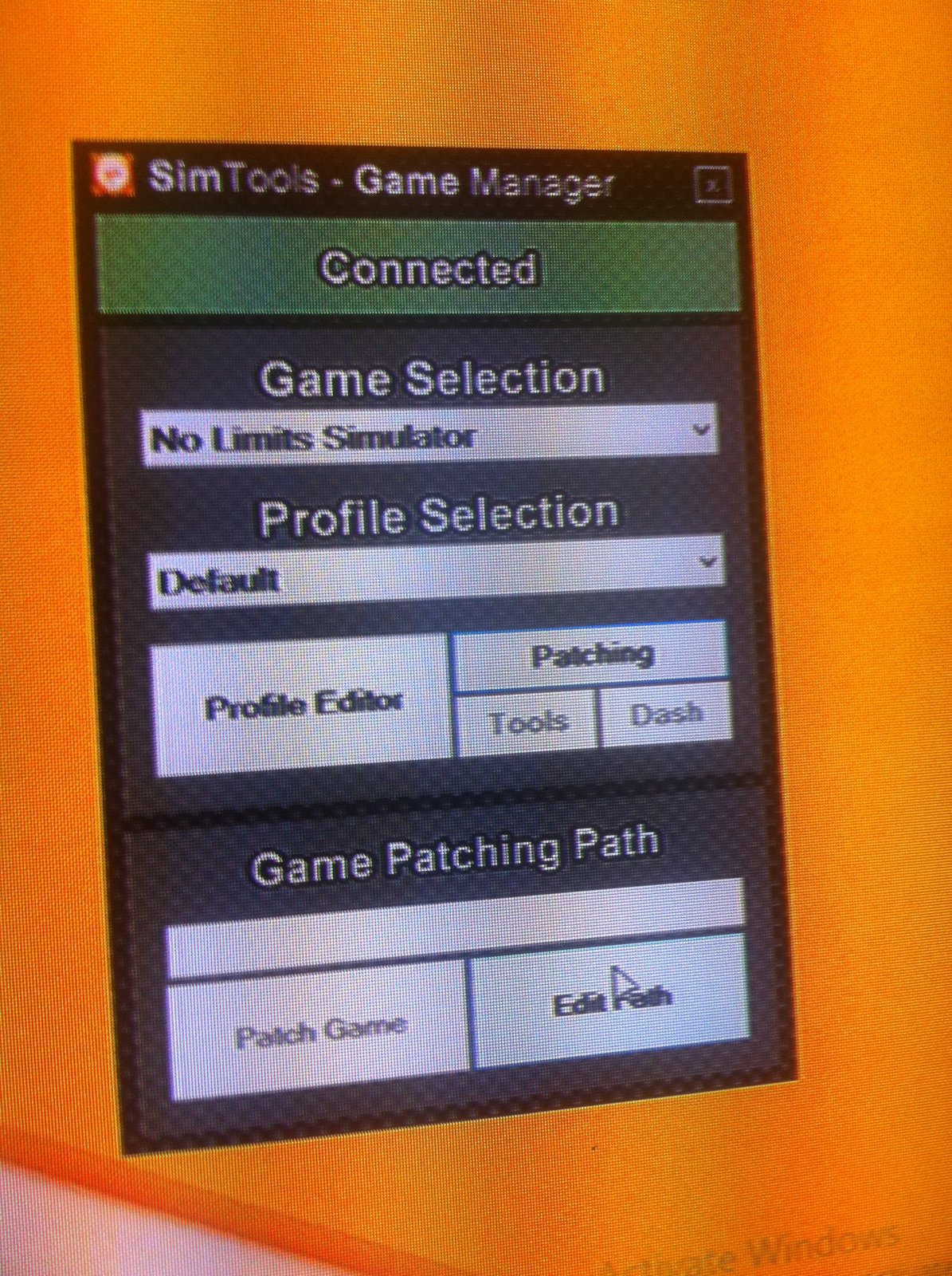

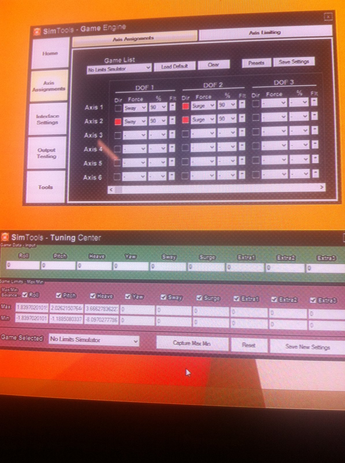

    select game engine tunning and set that to nolimits and bring up the wrong axis. IMG_9568.JPG

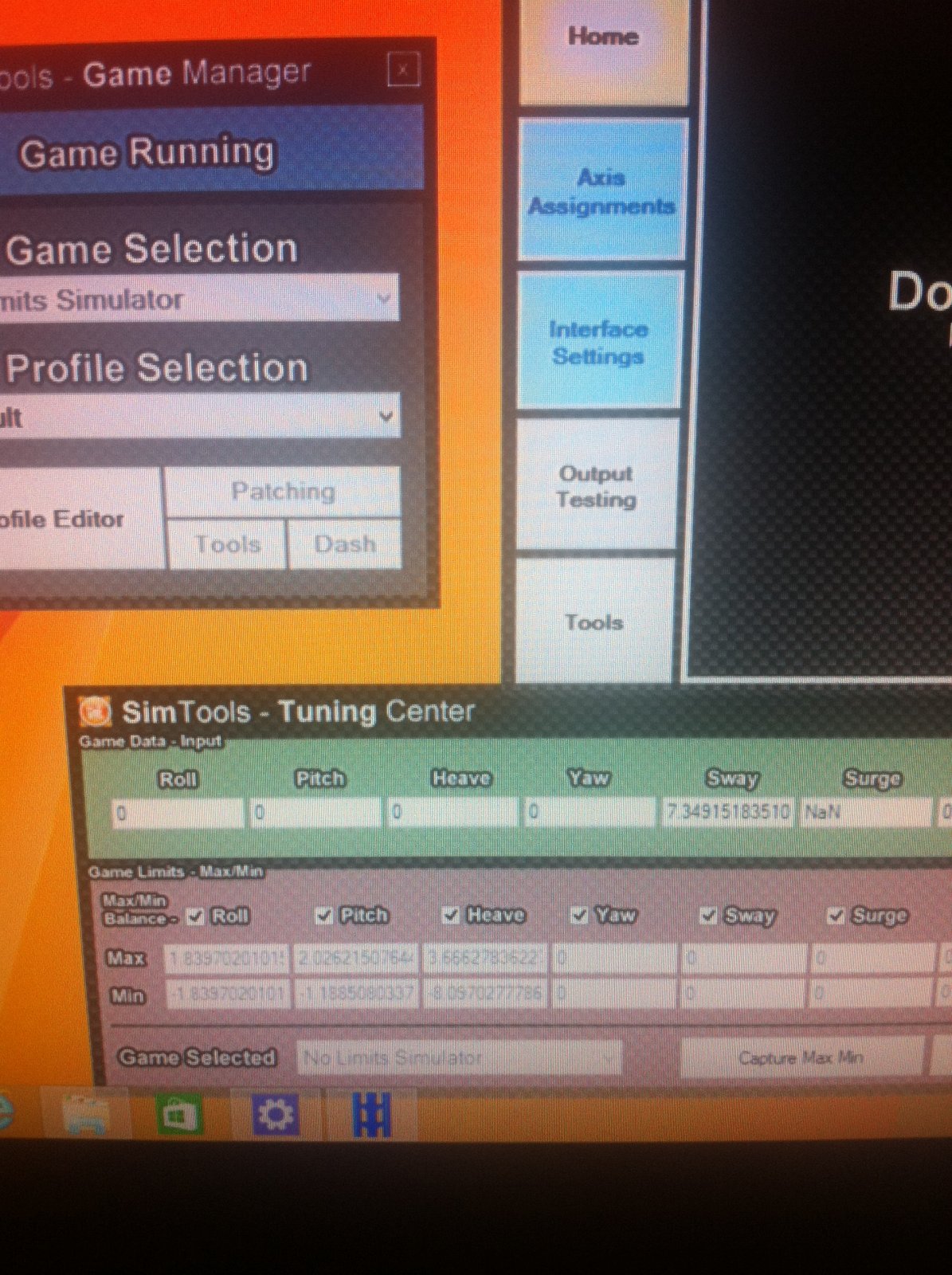

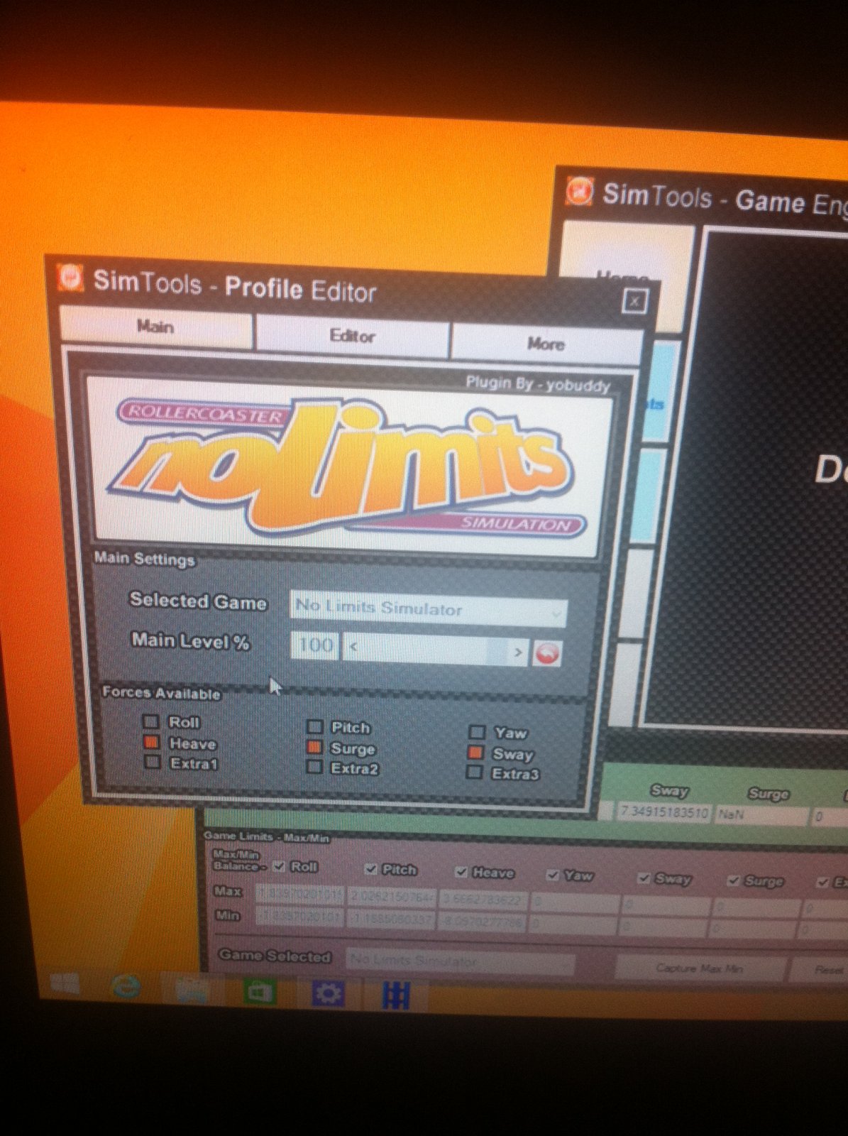

    this is the profile edittor saying what forces available.
    now if i use the other plugin i found it will show in the tunning as sway and surge and heave but will still not work and every thing is the same with how it installs like i have put here except it looks right from the v1.8 pluging that is used here which looks wrong. but either way neither work and ive tried about 4 other plugins and it still does not want to work.
    i have tried the capture but and reset ran game on both plugins and stop and saved after and still does not run.
    all this time the lights are on the usb adapters but does not flash with talking info when game starts.
    i do hope this help solve a mystery
  20. noorbeast
    21,520
    150,740Coins
    +11,018 / 55 / -2
    These are the different plugin versions: http://www.xsimulator.net/community/marketplace/nolimits-rollercoaster-simulation-plugin.31/updates
    This version only supports surge, sway and heave, so you need to have allocations in the Tuning Center for those forces and it can't find other forces as it does not support them: http://www.xsimulator.net/community...coaster-simulation-plugin.31/update?update=38
    I am guessing you have saved profiles from various things you have tried, hence why there are odd allocations in the Tuning Center. They are stored here: C:\Users\Your User Name\AppData\Local\SimTools\GameEngine\MaxMinProfiles
