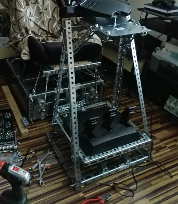

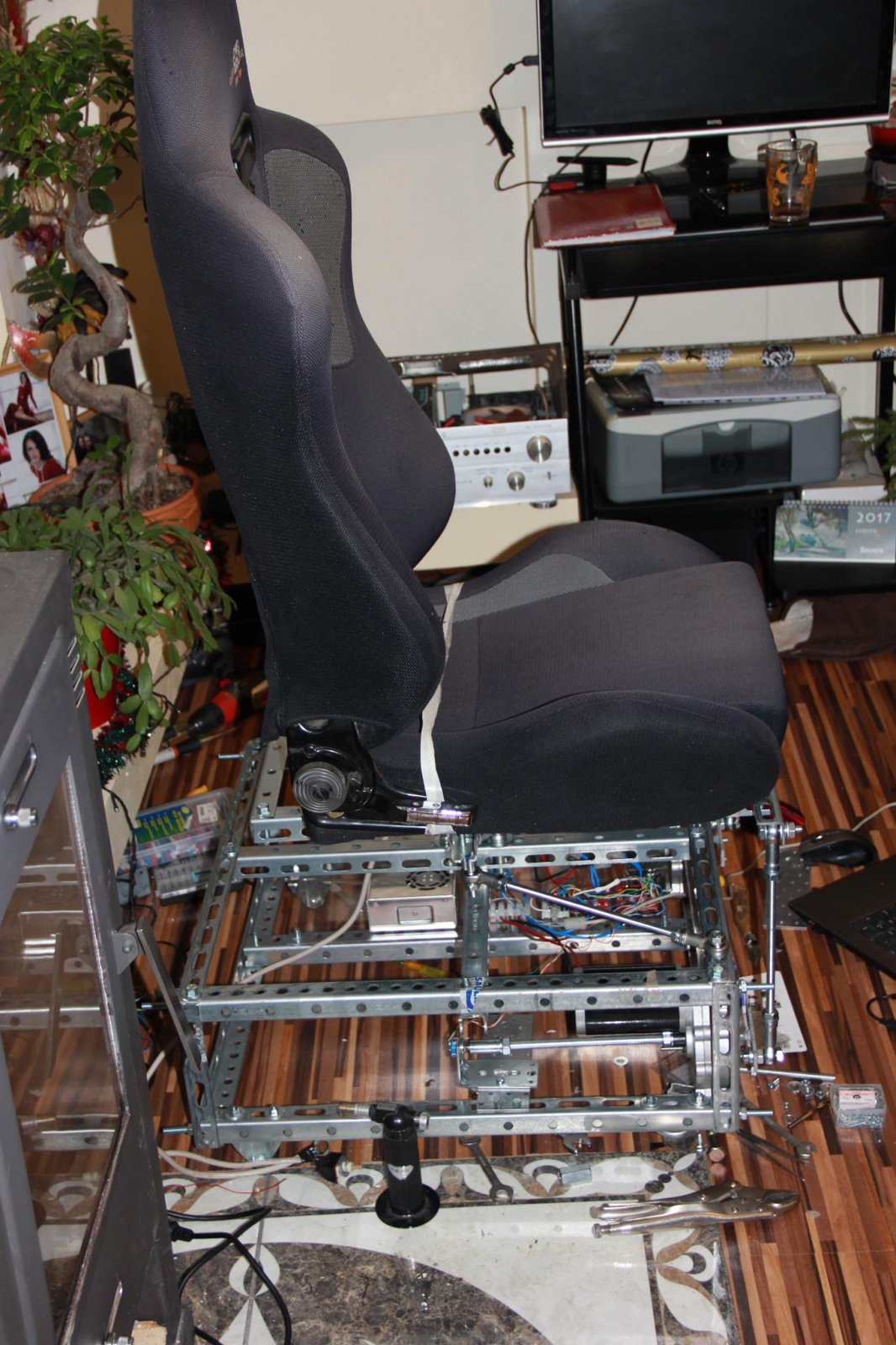

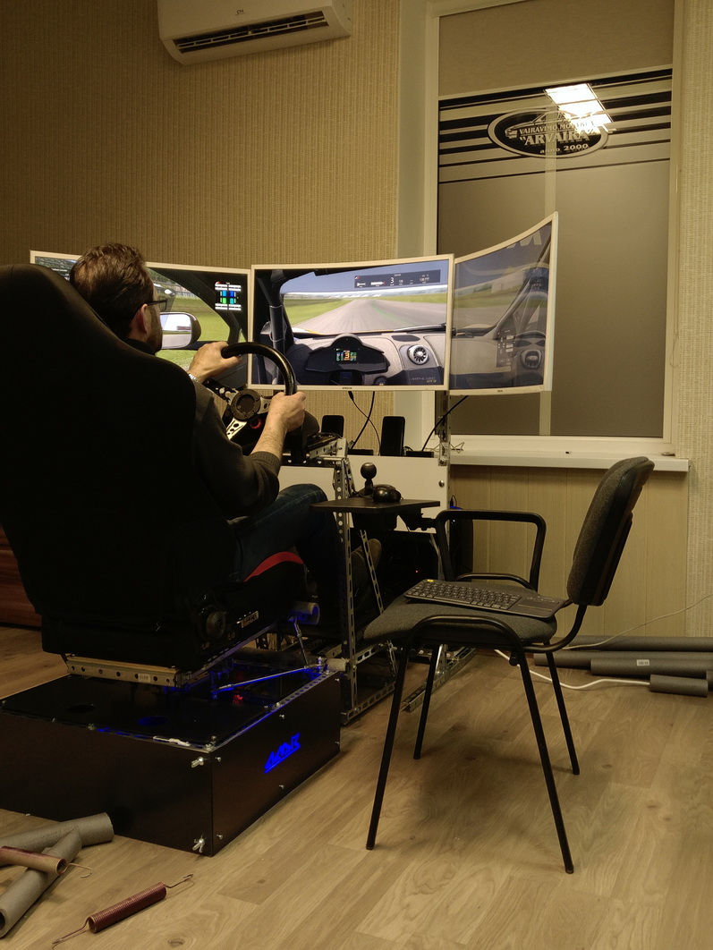

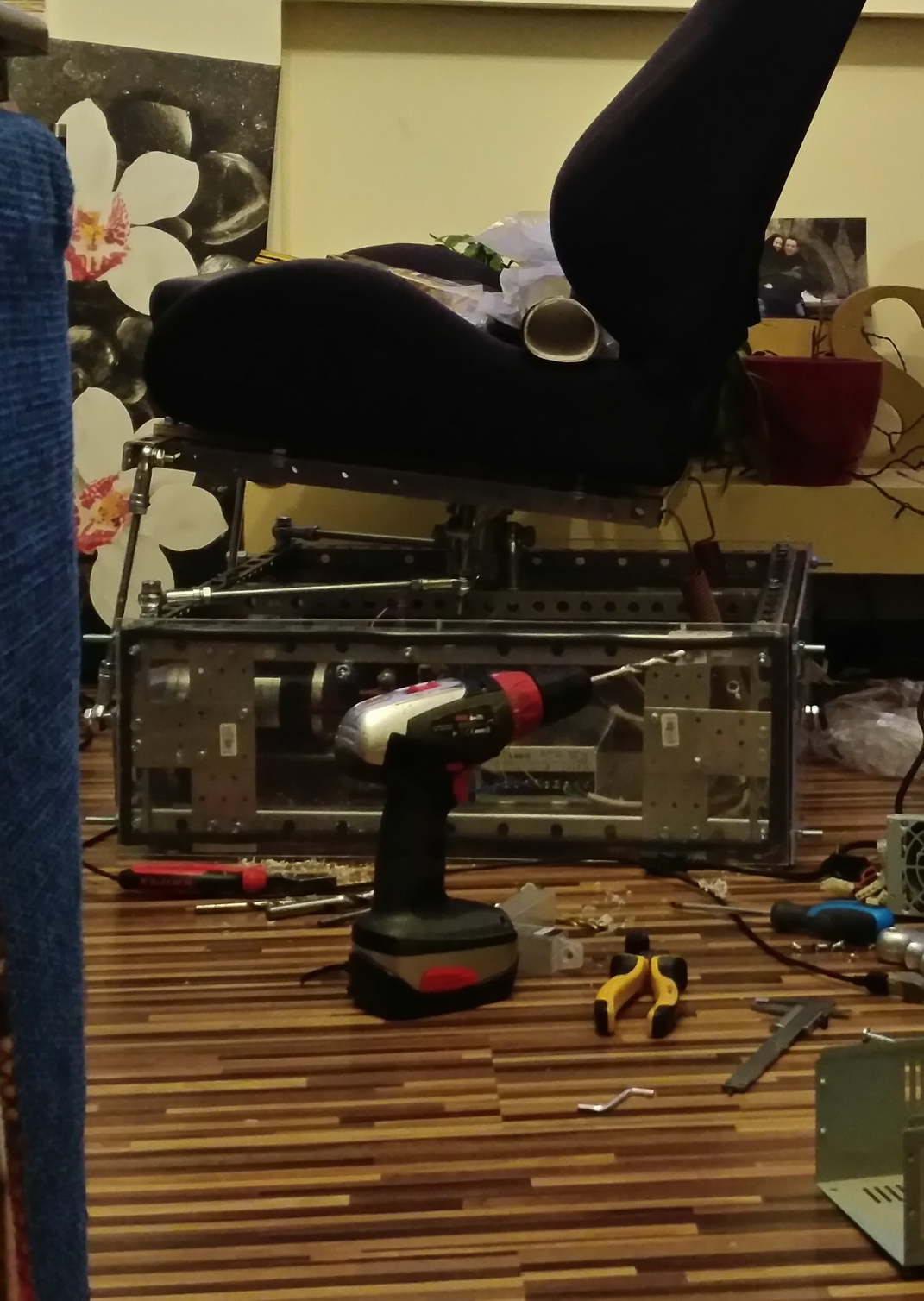

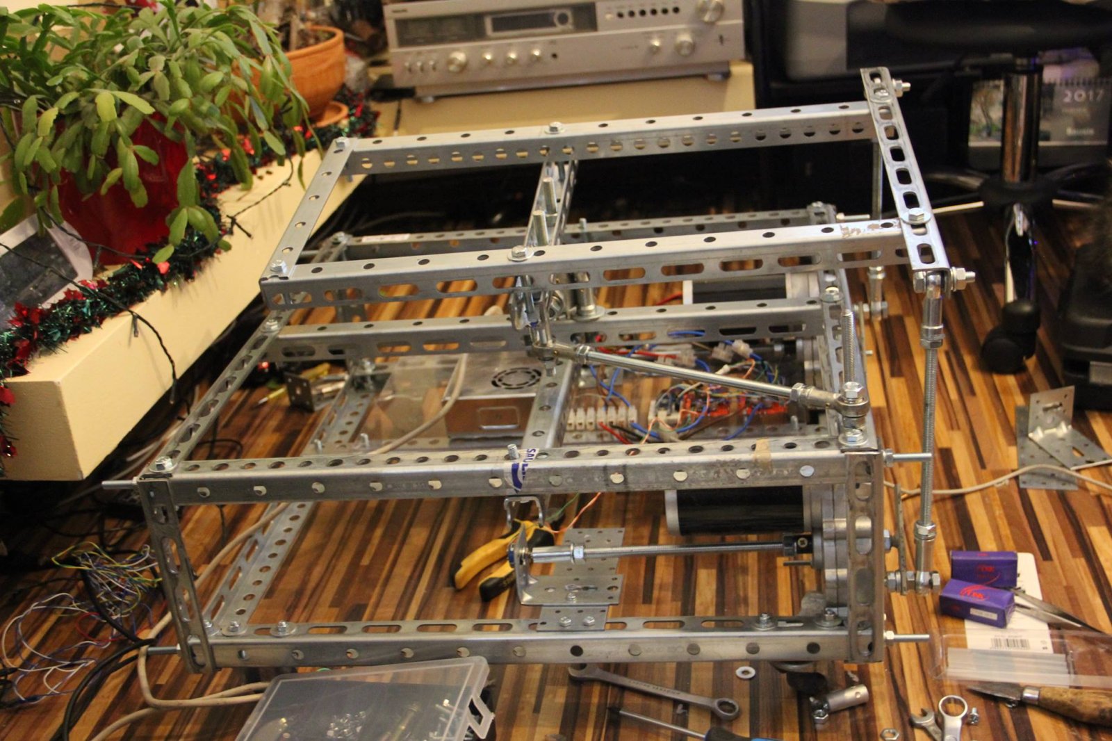

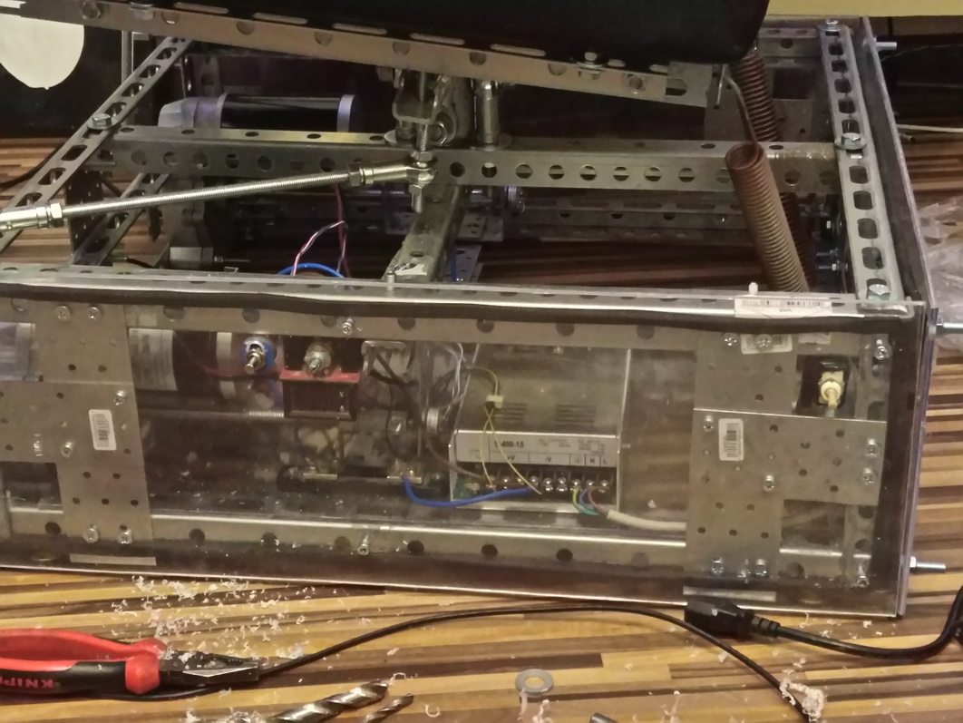

    Hello guys,

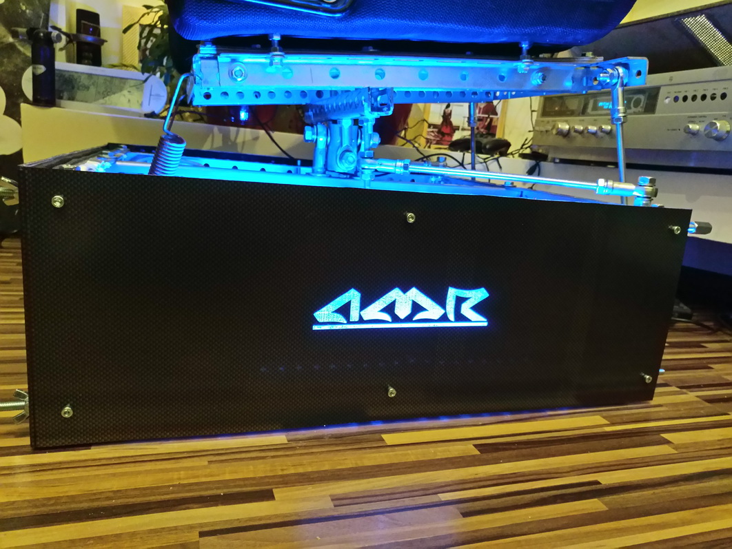

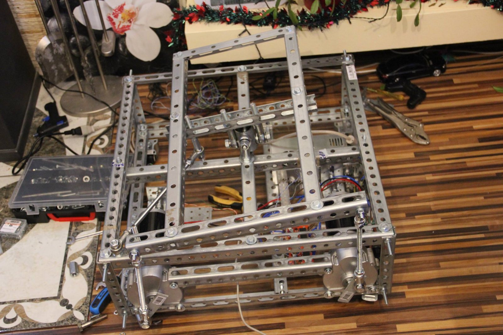

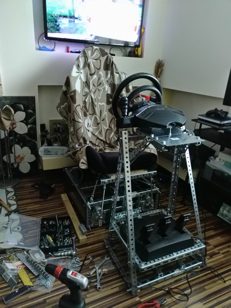

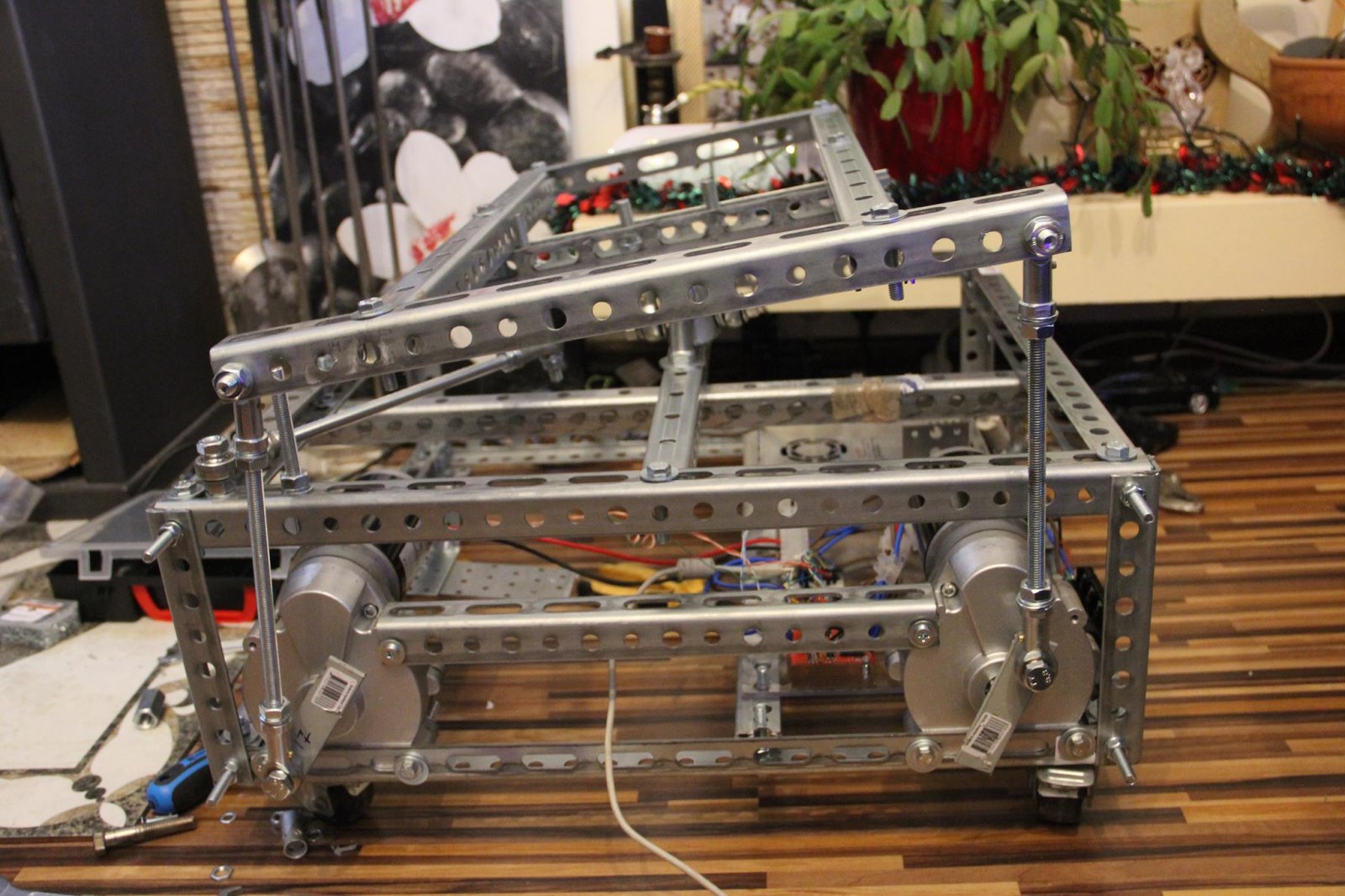

    I would like to introduce my 2 DOF project made without welding only perforated metal and tone of screws :)
    I'm using:
    SMC3 firmware
    Arduino nano
    Monster motor driver eache channel doubled for more power
    12-15V 50A power supply
    Chinese motors 7716MYGZ , 12V 200W with gear box 16,5:1
    Some pictures from beginning to the end :) :
    Frame design
    Seat adjustments
    A bit plastic on side for better image ;)
    At last light goes on yeap !!!
    Front attached
    Firs test :)
    I somebody have any question i'm open to answer . :)

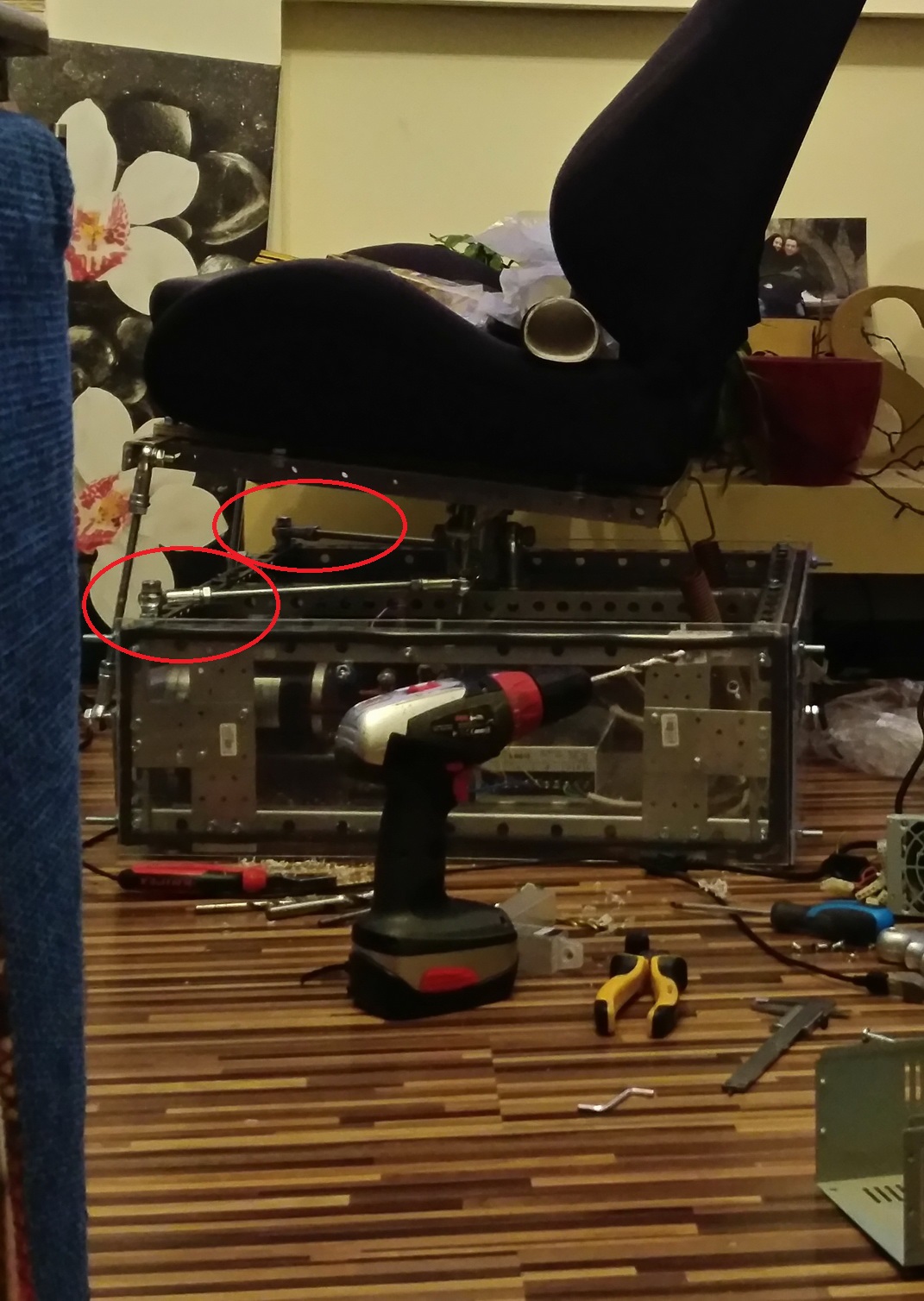

    where you got your motors ?
    how much you payed for them?
    - i have been watching this forum for years and i have never know what is this stuff in the picture (the bar hilighted in my pic) what is that for?
    21,917
    153,113Coins
    +11,117 / 56 / -2
    Panhard style rods prevent torsional twist and are most commonly used when car CV joint are used as a pivot.

    -@noorbeast@ is right, rods are needed to prevent twist when chair is in motion.
    By the way in picture you see only one, but they are two, on other side as well should be one.

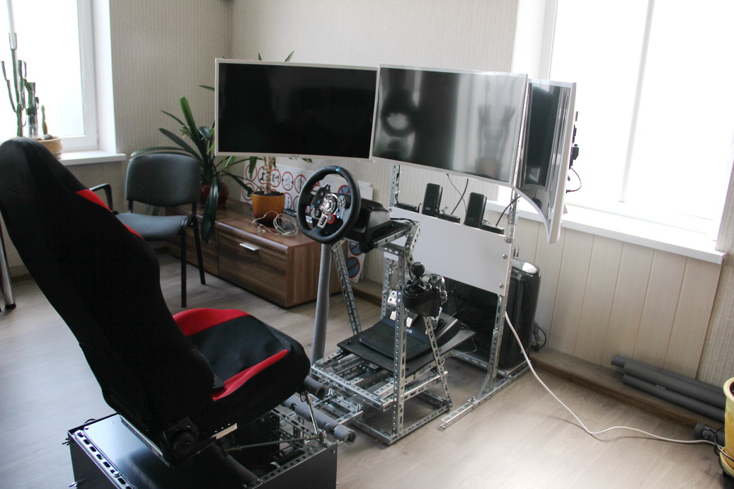

    Could you make other photos of the entire cockpit available?
  7. auryza
    auryza Active Member
    Jun 12, 2013
    109
    Lithuania
    4,337Coins
    +76 / 0 / -0
    2DOF, 3DOF, Arduino
    One more picture with full image:)

    again with the road stuff... is it really necesary? if i dont use it what problems can i have? (you guys said torsion, torsion of what? of the joint?)
    (really nice proyect) :D
    fer
    21,917
    153,113Coins
    +11,117 / 56 / -2
    If you use a traditional universal joint then that will not have lateral twist, but if you are using constant velocity joint then a panhard style rod can be used to prevent lateral twist.

  11. Diego Amaral
    Diego Amaral Member
    May 12, 2015
    29
    Rio de Janeiro
    98Coins
    +9 / 0 / -0
    Do the pedals move?
    liked it!
  12. Arvaira
    Arvaira New Member
    Apr 1, 2017
    Lithuania
    308Coins
    Pedals moves only when you pressing on them :), Just kidding.
    Moving only chair, pedals and wheel base is static.

    Only the mobile seat greatly relieves the engines
  14. RandomCoder
    Feb 19, 2017
    185
    Control Engineer
    UK
    1,674Coins
    +143 / 0 / -0
    I think what you meant to say was that moving the chair position affects the centre of gravity and can add extra strain to the motors. I guess it's ok if you have the motor torque to handle it.
