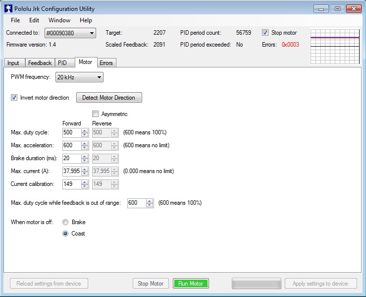

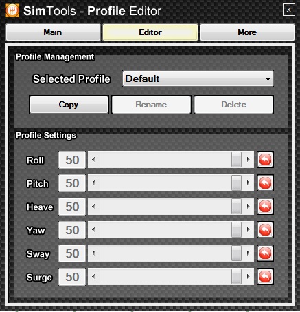

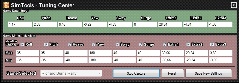

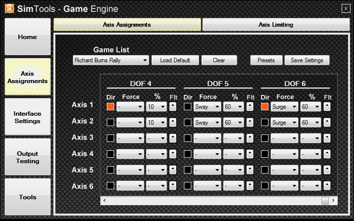

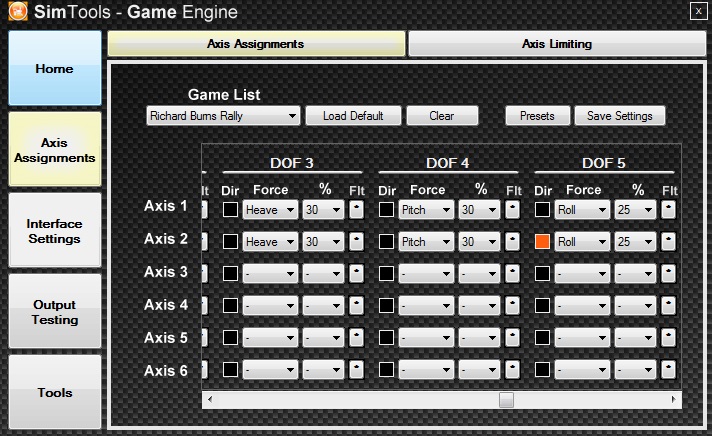

    I´m finishing off my first attempt at a 3DOF (seatmover w traction loss) sim and have a problem with RBR.
    As the title says I don´t get any game data input on the surge axis and therefore no surge motion. All other axis´work perfectly.
    Below some screenshots to show values captured in tuning center and my settings in game engine and game manager profile editor. Main level is at 100%.
    As you can see all other axis´give input but surge is at 0?

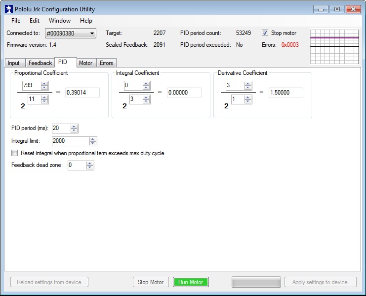

    I´ll also show my motor and PID settings in the JRK configuration utility although I don´t think that´s the culprit here.

    Im no expert with tuning profiles etc but I have motion With RBR all forces work fine, my settings differ from yours by a lot not sure if you can use mine I guess its worth a try the only thing I would leave alone with yours is the Dir options in axis assignment as your motor position might be reversed etc hope it helps

    I've published plugin's update with this bug fixing.

    Im still using v3.0.0.3 and surge works ok for me cheers for the update thou your a star !!
