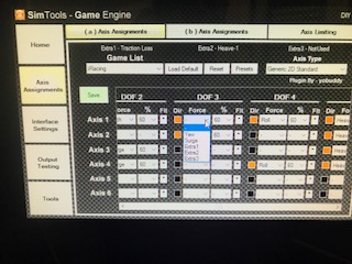

    I have a Prosimu T1000 5 Motion simulator. I'm trying to set Axis 1 to Pitch in the Force drop down in DOF 3 but I'm only getting Yaw, surge extra 1 ,2,3 options. I do see the option for pitch in each of the other Axis 2 - 5. Any ideas on how to correct this

    Can I get a Screen shot buddy?

    sure thing here you go

    sorry it's Axis 2 that I cant get the Pitch dropdown

    It is a lousy photo but my guess would be that it is already allocated on that axis, hence pitch won't show in subsequent drop downs.
    As an aside you should not be using the DIY license with a Prosimu rig, as it is a commercial simulator, you need the Pro SimTools License and I suggest you PM @yobuddy about upgrade arrangements.

    You read the axis from Left to Right.
    So if you have used it already, then it won't be available to use again.
