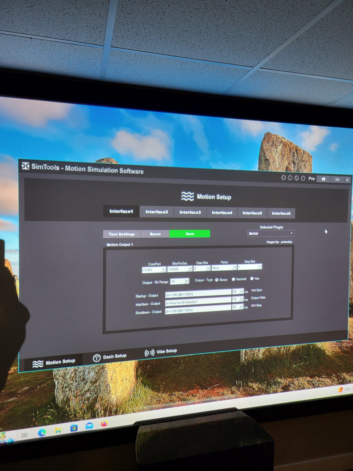

    Hey guys. I recently had the main hardrive of my computer fail. Just trying to get everything working again. I'm able to get motion from SMC3 utility but nothing from simtools 3. Have a look at the picture I attached and let me know what I'm missing. When I press test setting button the rig wakes up and centers but no movement from the sliders

    Try BitsPerSec at 500000
    And Interface settings: [A<Axis1a>][B<Axis2a>]

    It now works with the settings you mentioned. Thank you very much!
