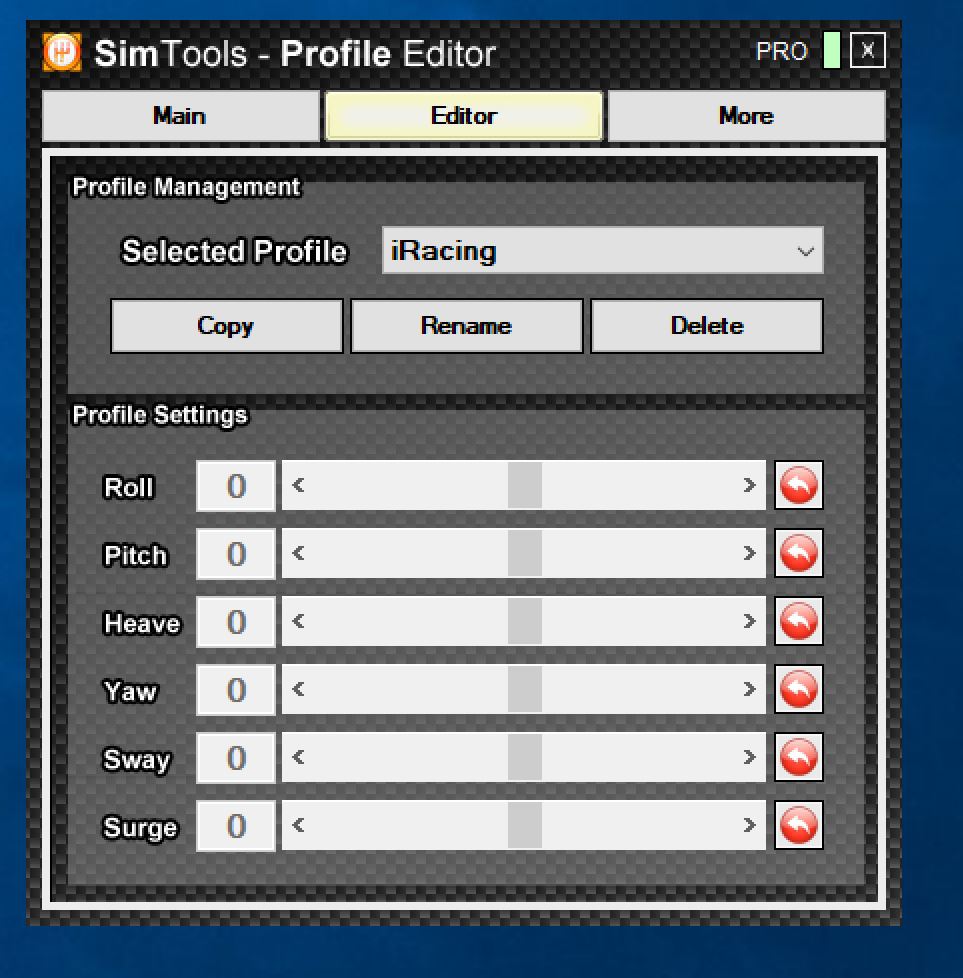

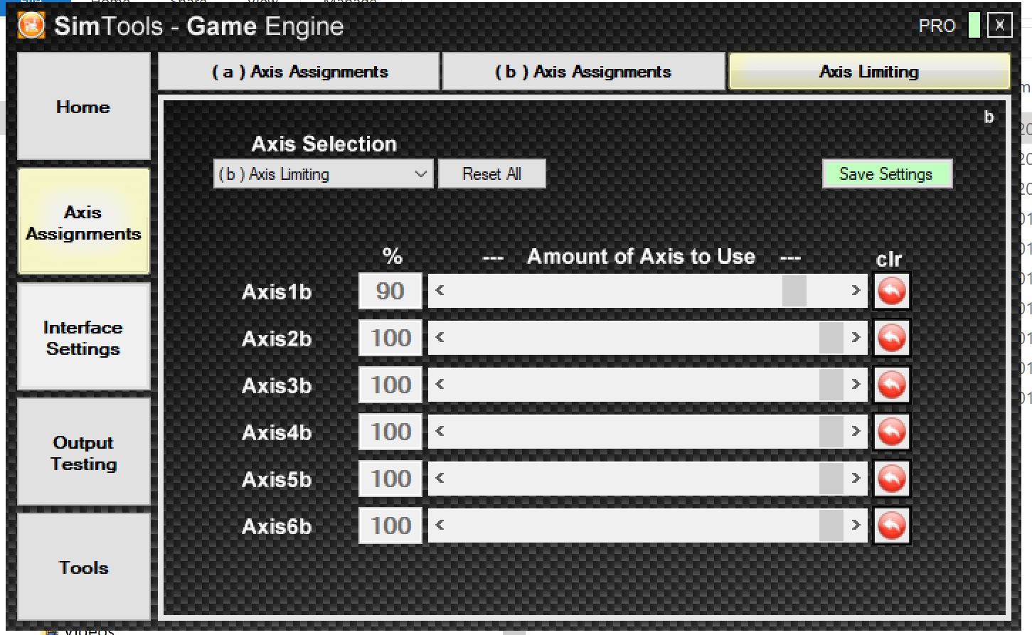

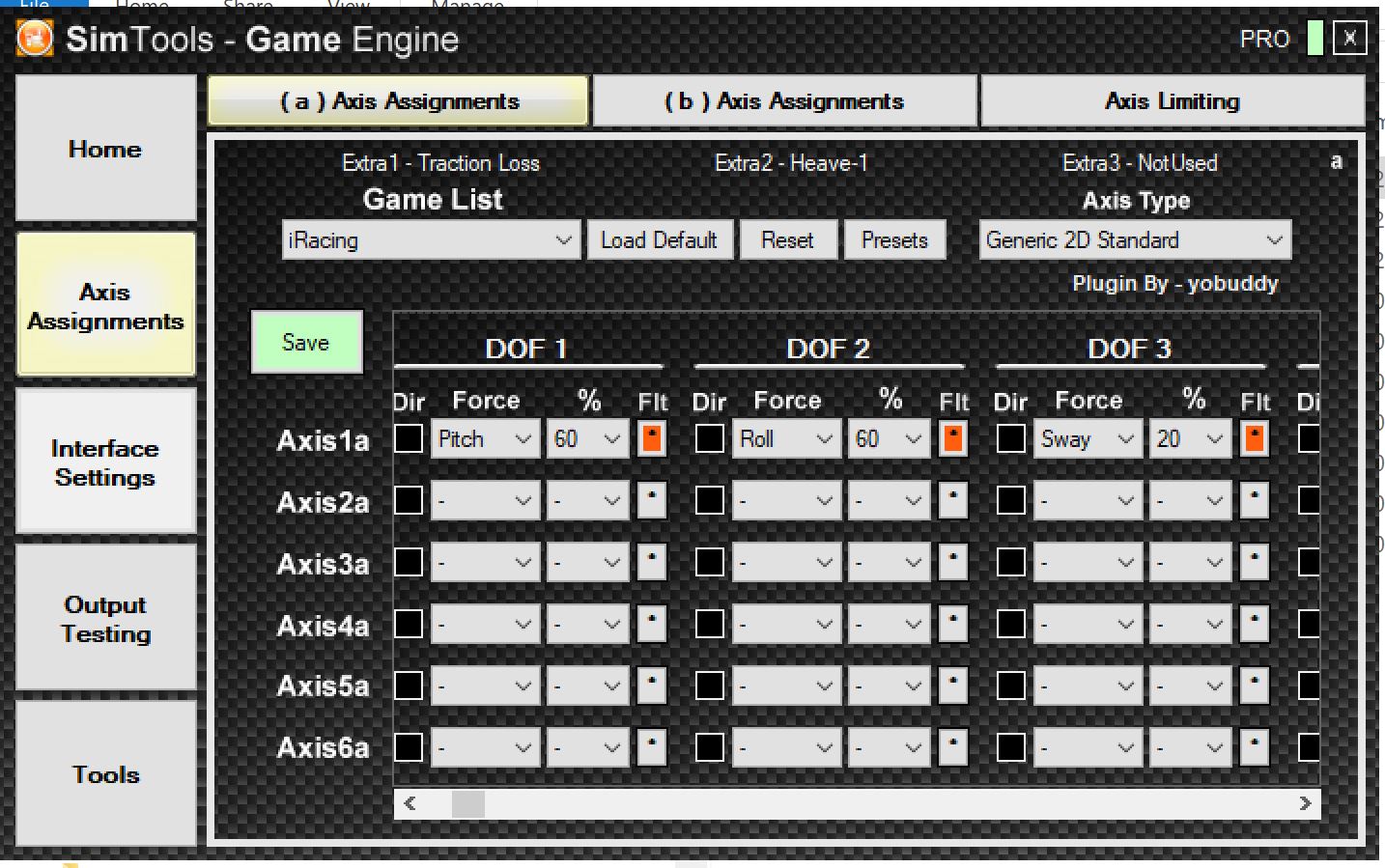

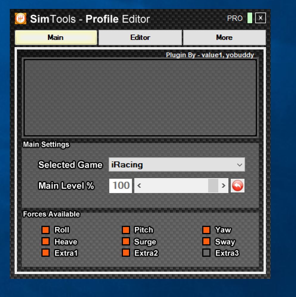

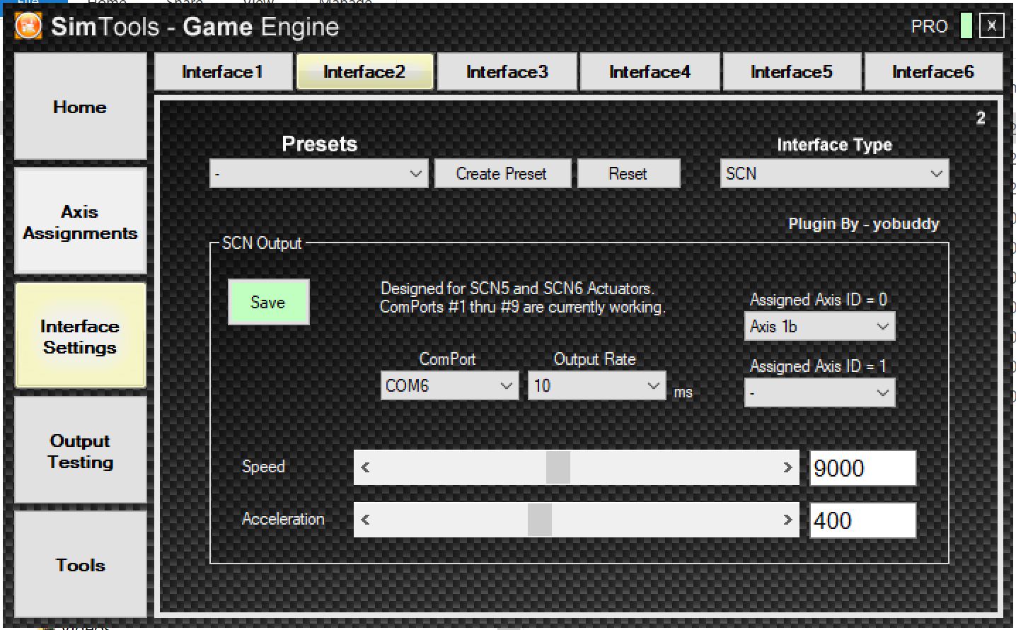

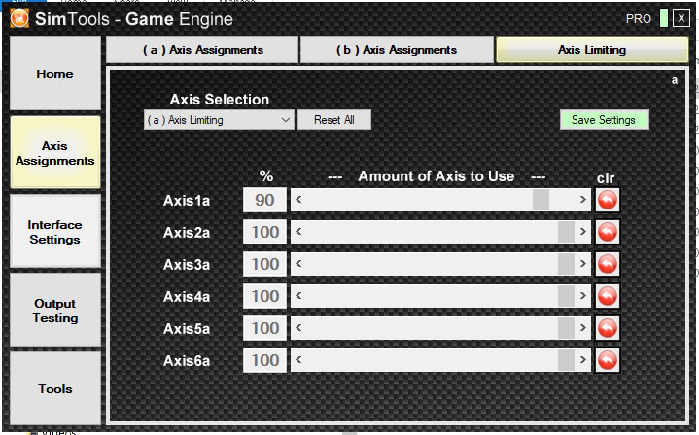

    3. Settings (Relevant ones) I'm attaching screenshots
    4. SimTools Licence type: Pro

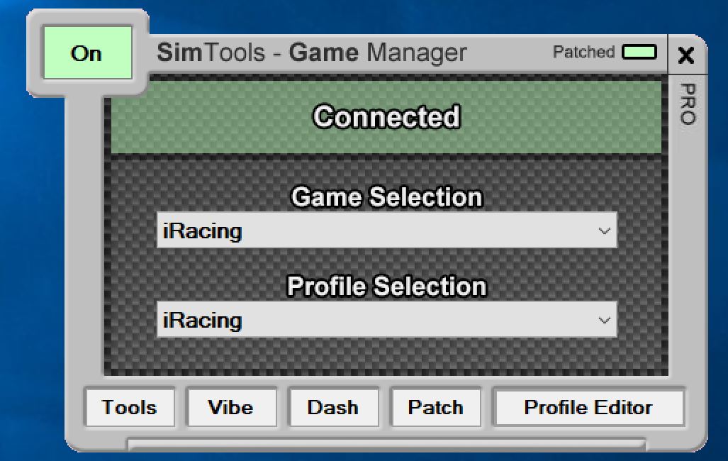

    I'll start at the beginning. I've been using Simtools for around 2 years. Just a couple of issues however no big deal to resolve.

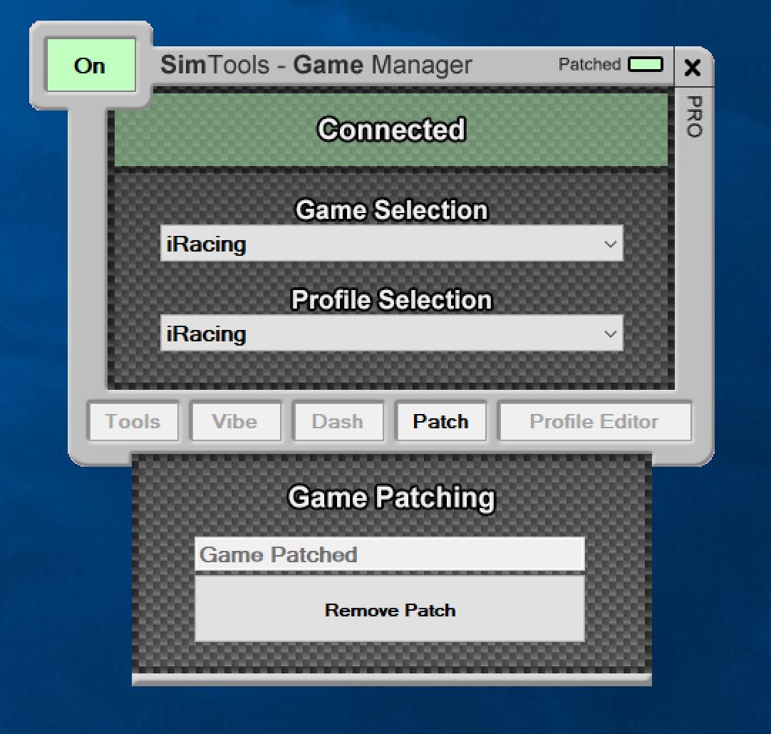

    I built a new computer and added a direct drive Ricmotech wheel setup. iRacing runs, wheel works fine. Sim tools installed and configured. both actuators test and move fine and as expected using the output testing in Game Engine. I've patched iRacing. Game manager show On and Connected green, once iRacing is started the connected area turns blue as it says in the manual. I do not get any motion while in iRacing. I've read the manual and obviously am missing something. I am attaching screenshots of my settings if I don't include something you need to see please let me know.
