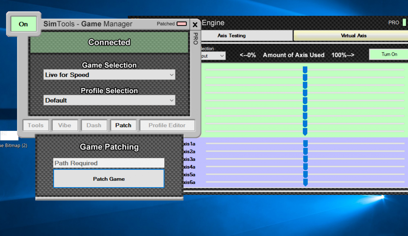

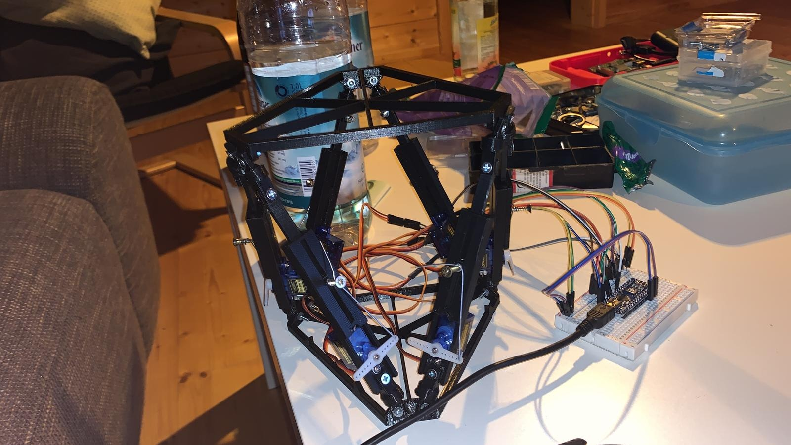

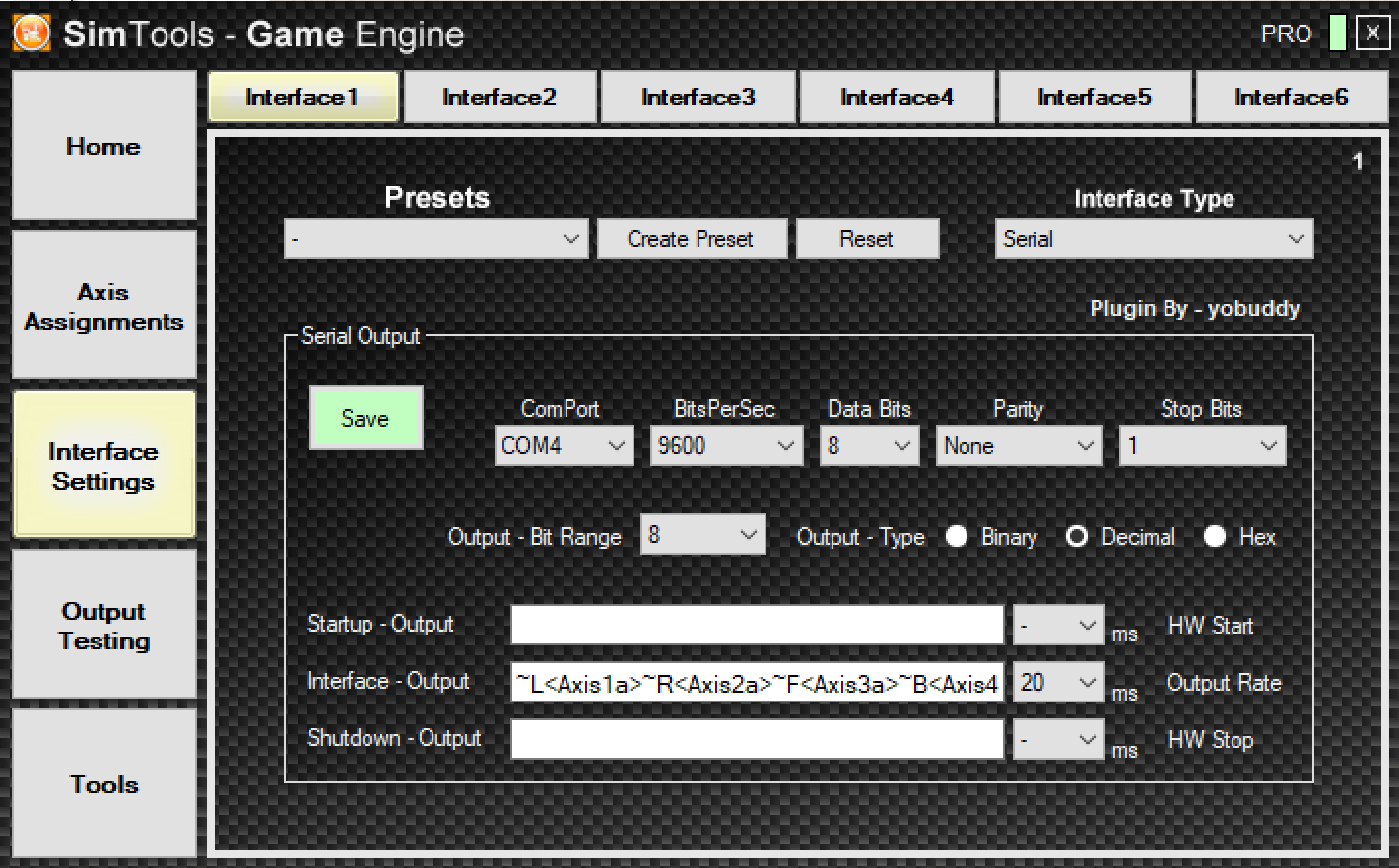

    i have a Problem with my Prototyp 6 Dof Sim.
    Setup:
    Commercial or DIY: DIY
    DOF (Number of axles ): 6
    Actuators (DIY, SCN5 etc.): Servo motor
    Interface (Arduino, SCN, Mega, DIY etc. ): Arduino Nano
    SimTools
    Version Number: 2.3
    Game that i try: Live for Speed, TrackMania Forever
    Settings (Relevant settings) As outlined in post below
    Pic of my Proto:
    at first i tested the Output.
    Every Servo works great. :) happy :D

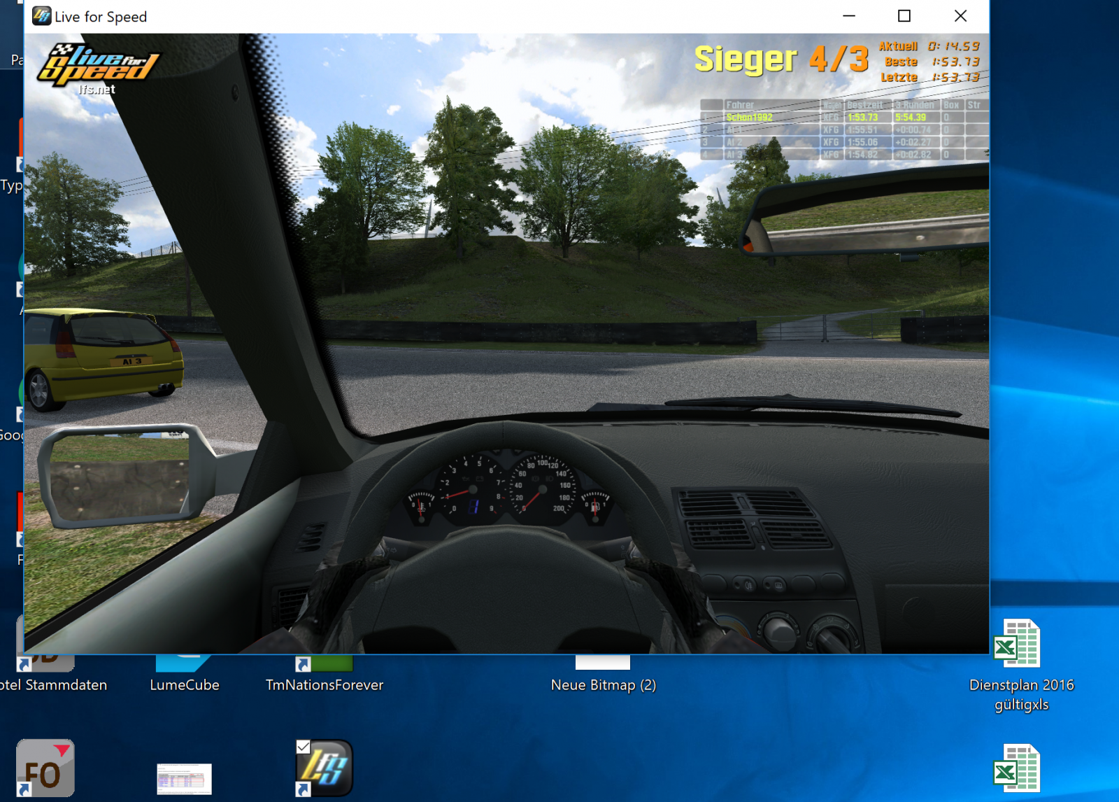

    Next Step: install Live for Speed
    Now the Problem:
    There is no data from the Game.
    Not in the Tuning Center and not at Virtual Axis.
    My settings:
    What can i do?
    I started the Game befor i patched it.
    then Restart the PC.
    then Pachted the game.
    21,514
    150,704Coins
    +11,018 / 55 / -2
    With LFS you have to drive a couple of laps in first person mode, before patching.
    So unpatch LFS, shutdown SimTool, drive a couple of laps, restart SimTools, then repatch LFS.

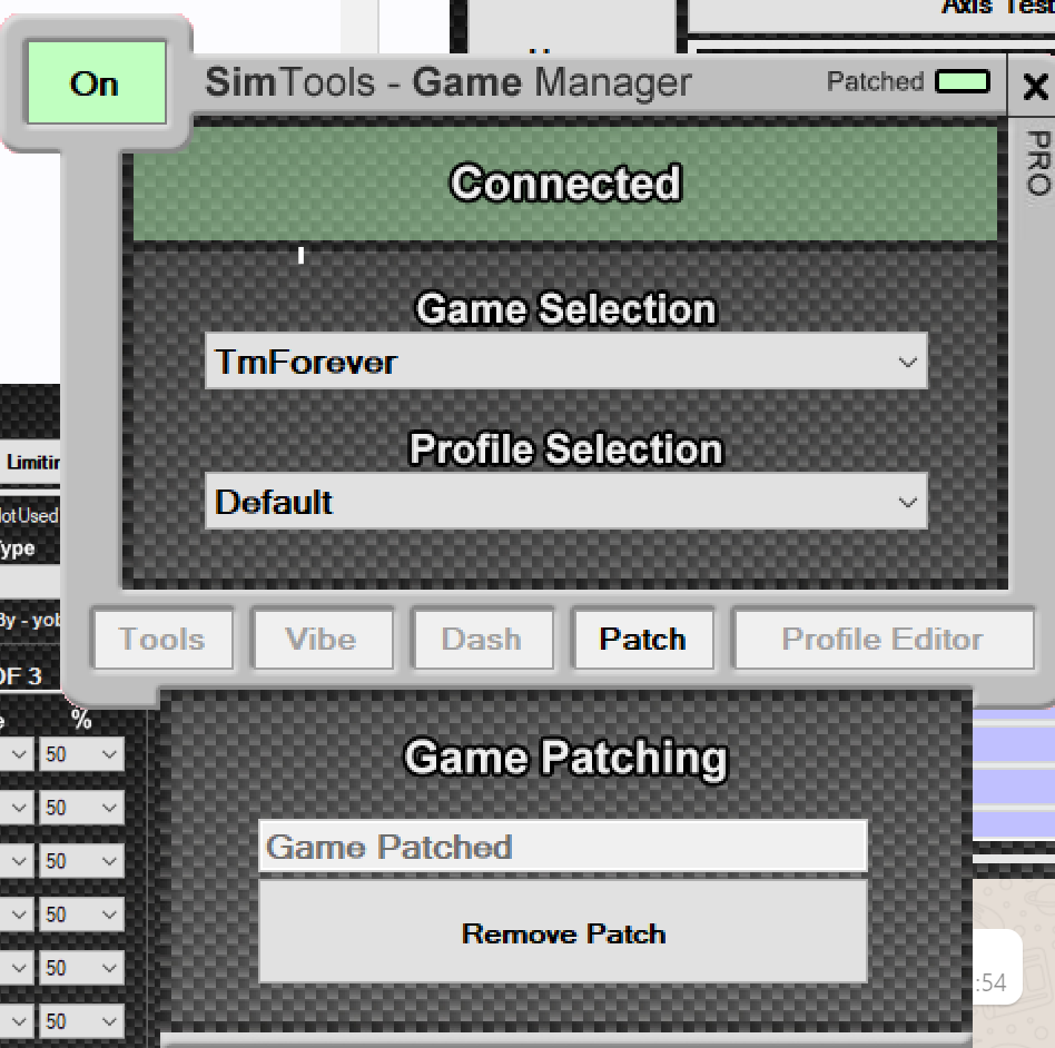

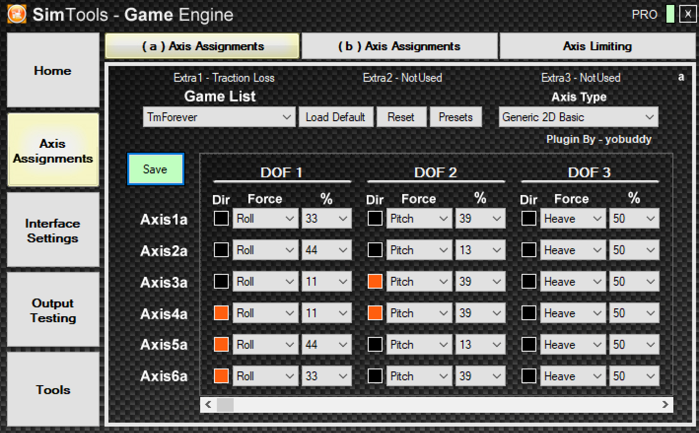

    And why does Trackmania not work?
  4. Jürgen Schon

    patch removed....
    3 Laps in Single Player
    Simtools closed
    now repatch and try
  5. Jürgen Schon
    Jürgen Schon Member
    Dec 6, 2018
    39
    57Coins
    +25 / 0 / -0
    it works with LFS :D :D
    thanks :) thank you very much :D

    There are a number of different TrackMania plugins, so which one do you mean?
  7. Jürgen Schon
    Jürgen Schon Member
    Dec 6, 2018
    39
    57Coins
    +25 / 0 / -0
    21,514
    150,704Coins
    +11,018 / 55 / -2
    That looks to be the correct game version.
    What firewall and antivirus do you use?
