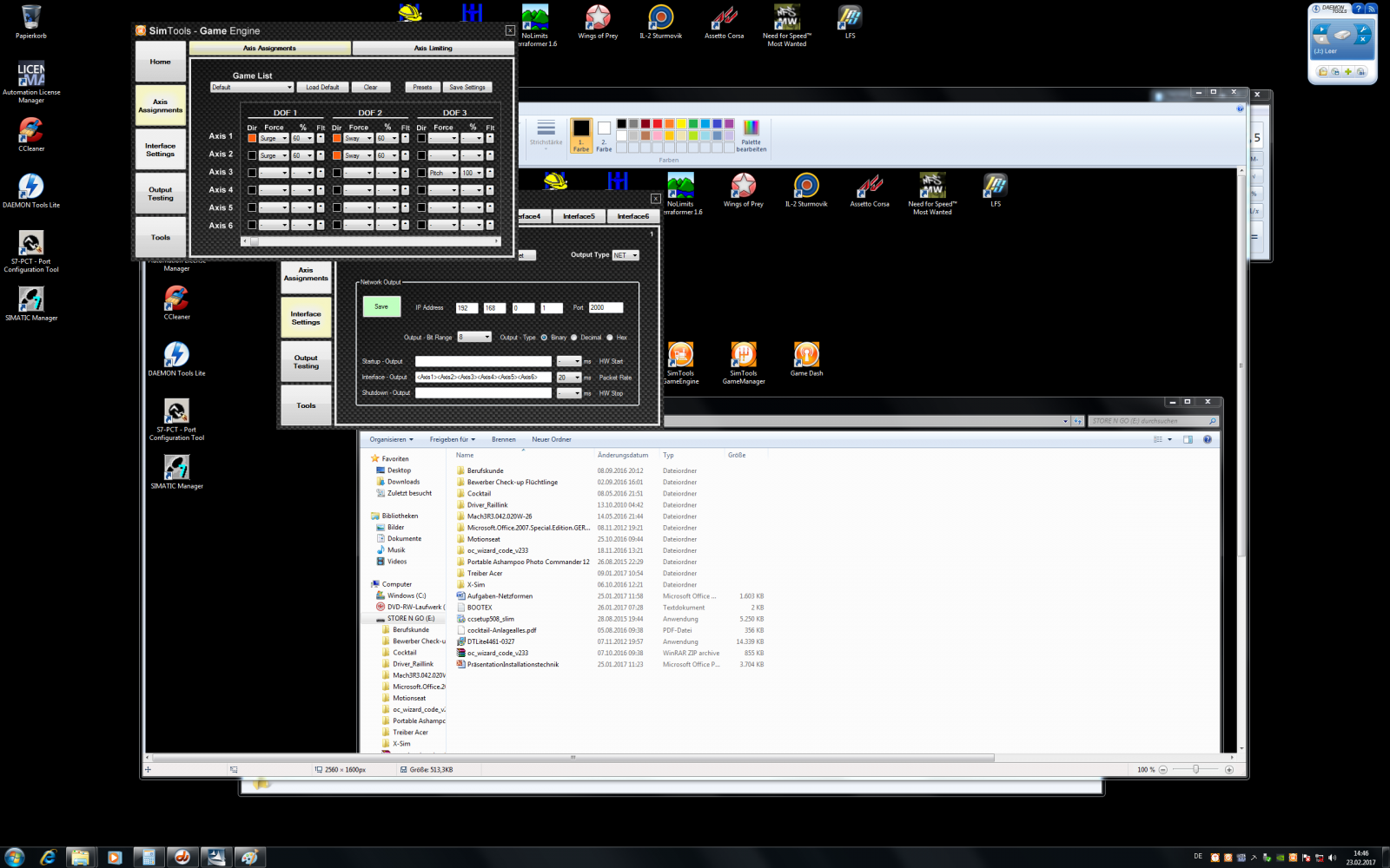

    Hi yobuddy,
    now I know a little bit more. I changed the IP of the ethernetcard and now I´m able to ping to my 314-C. Here is the screenshot from the owner before me. How can I figure it out, where the problem is?

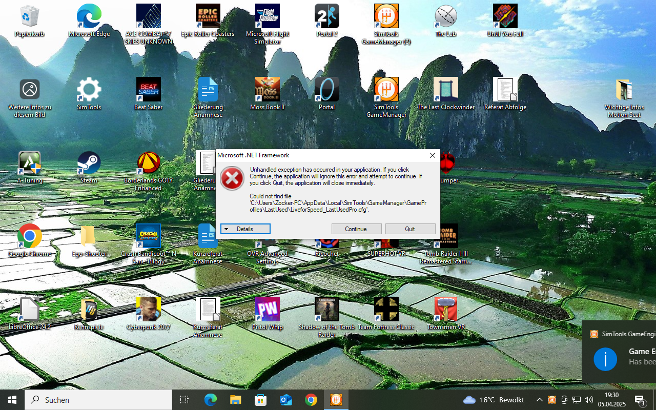

    One thing I forgot to tell: I first installt Simtool 2.1 and now I´m not able to delit it and when I start windows there comes an information. I send it below.

    Sorry buddy, but the pic of your settings is to small not readable.
    But my guess is your interface has a different ip address, and or port, that the one you are supplying.

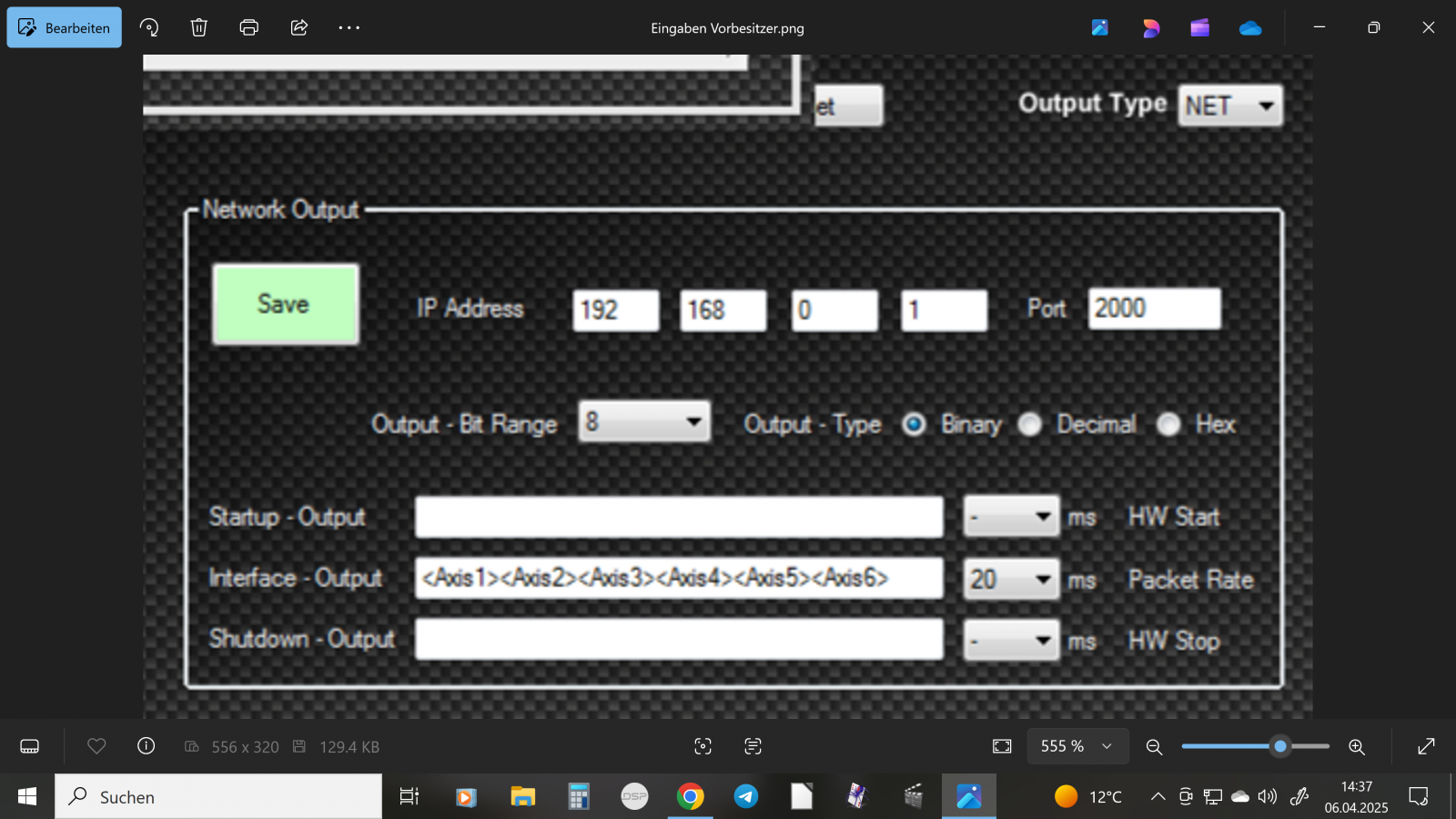

    I didn´t knew, that the pictures can´t be zoomed, hier another try. This IP is the IP I can ping. I have 2 interface cards and deaktivated the one for the internet. So the problem with the wrong interface should be solved, or have I missunderstood you? As I completly reinstalled my windows, the problem with 2 different softwareversions is solved. What else can I check?

    Please try <Axis1a><Axis2a><Axis3a><Axis4a><Axis5a><Axis6a> for interface output.

    Thanks a lot yobuddy - the problem is solved. As I didn´t refresh the page, I just saw it now.
