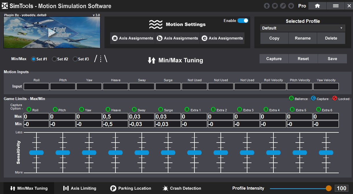

    Good morning
    Help!!!! I have bought a compaq R from NJmotion and I am trying to configure it for FS2020 but it is impossible.
    I can't get it right and I'm already going crazy.
    Does anyone have this platform to send me the parameters???
    I'm desperate :-(((

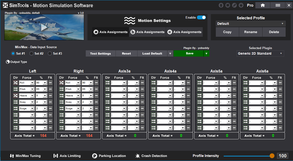

    Have you sought help from the manufacturer?
    What version of SimTools are you using and can you please post pictures of all of your settings?

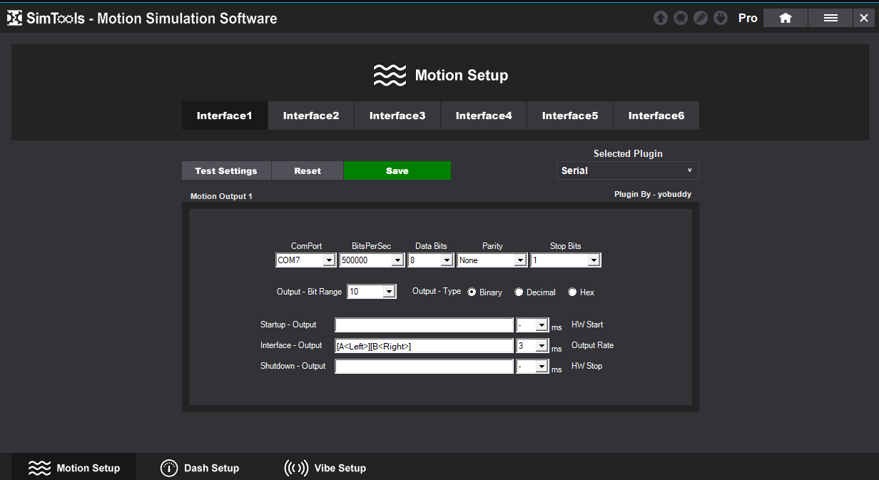

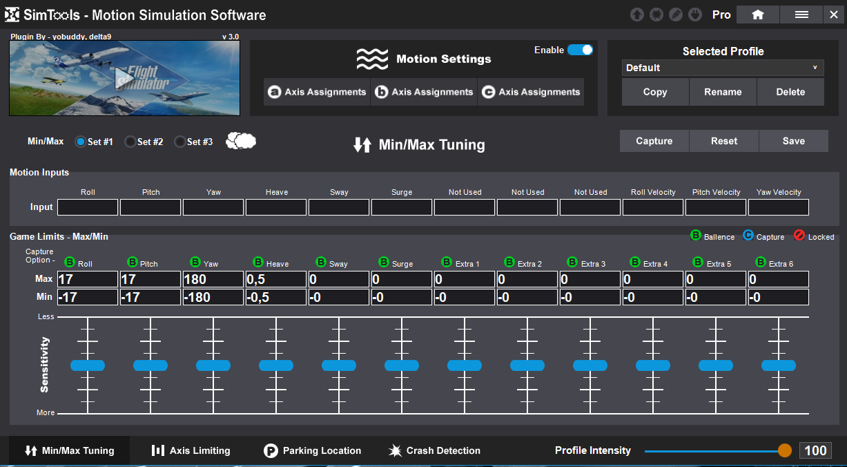

    What information have you got from the manufacture?
    Does Output Testing work as expected?
    Does the Input row on the Max/Mins have values when the game is running?
    I don't own your rig but the Output Rate in the interface settings looks low.
    Max/Min settings look way too low for a flight sim, set them at 100, do a flight and Capture then Save the Max/Mins, then tweak them from there.
