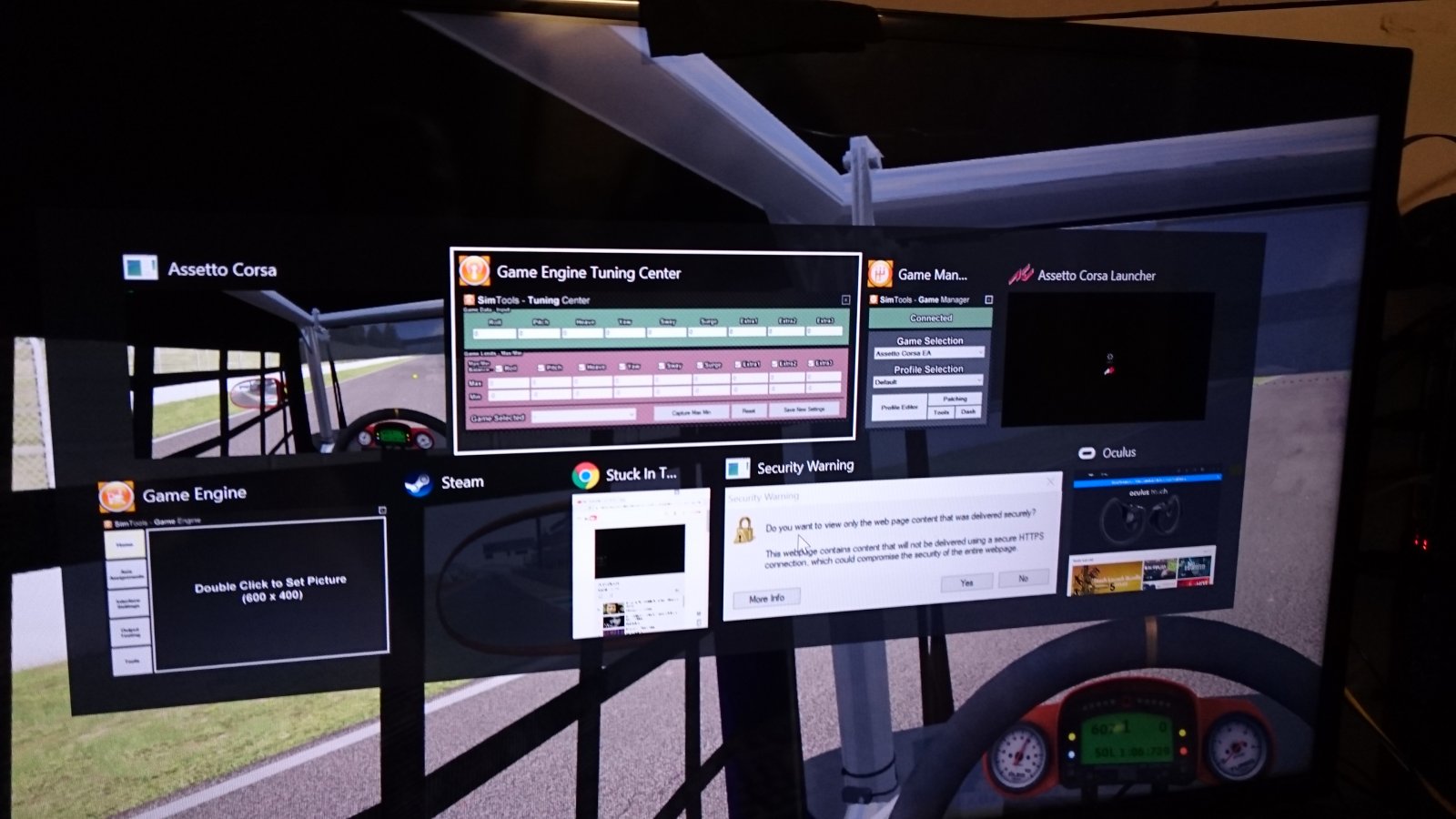

    hi all been using my rig now for over 12 months without major problems but recently I altered some files in my config video file for my rift and messed it all up, since then I have lost all my motion on my rig so here what I have done so far without any luck
    reinstalled acs
    deleted files and repatched
    reinstalled simtools
    reinstalled acs on drive c
    don't know what else I can do its always worked perfectly
    windows and simtools are installed on drive C and steam and games on drive F
    all games work perfectly apart from acs

    I really don't understand why you would be fiddling with the config file, nor why that would affect your motion settings. Is it the CV1 that you have?

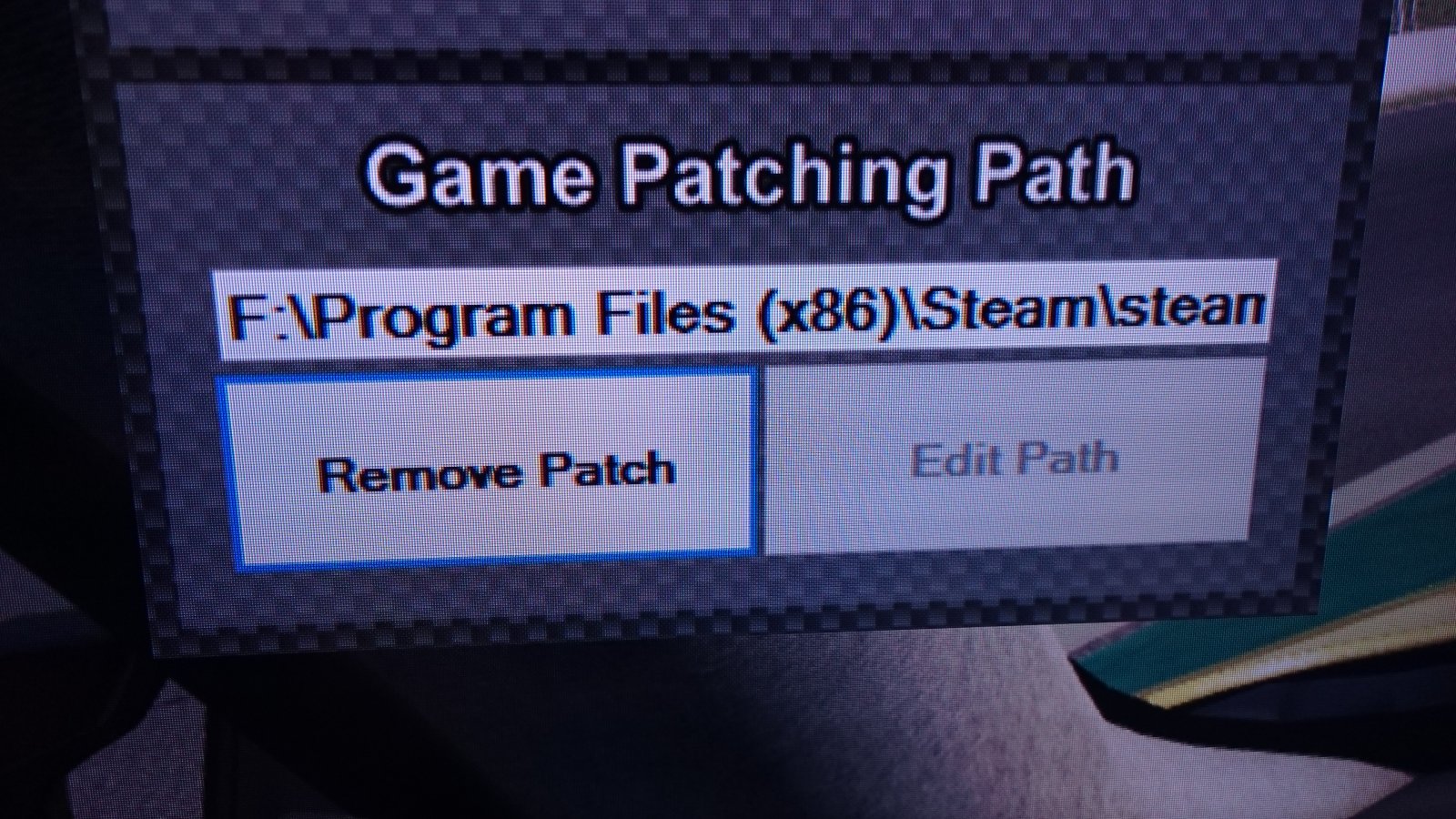

    What path are you patching to?
    Does Game Manager turn blue and say Connected?

    Turns green says connected but not blue
    Tuning centre dont move at all copy patch to steam common assetto corsa trying to get pics

    You can just close the security warning.
    Try un-patching Assetto Corsa, close SimTools, restart SimTools as Admin and re-patch.
    What are your Interface Settings and Axis Assignments?
    And can you please show a readable shot of the Tuning Center values.

    Try renaming the Assetto Corsa folder under your documents folder then do an integrity cache check under Steam so that it'll download it again.

    ok guys all working i did integrity cache and turned off force 32 bit in options and now it works lol thanks again
