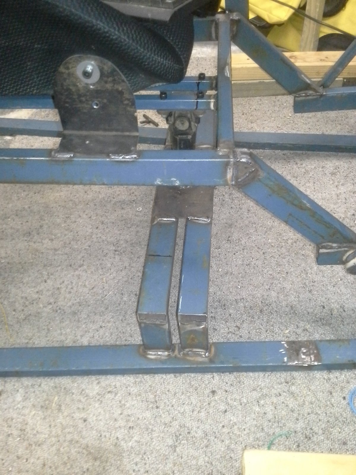

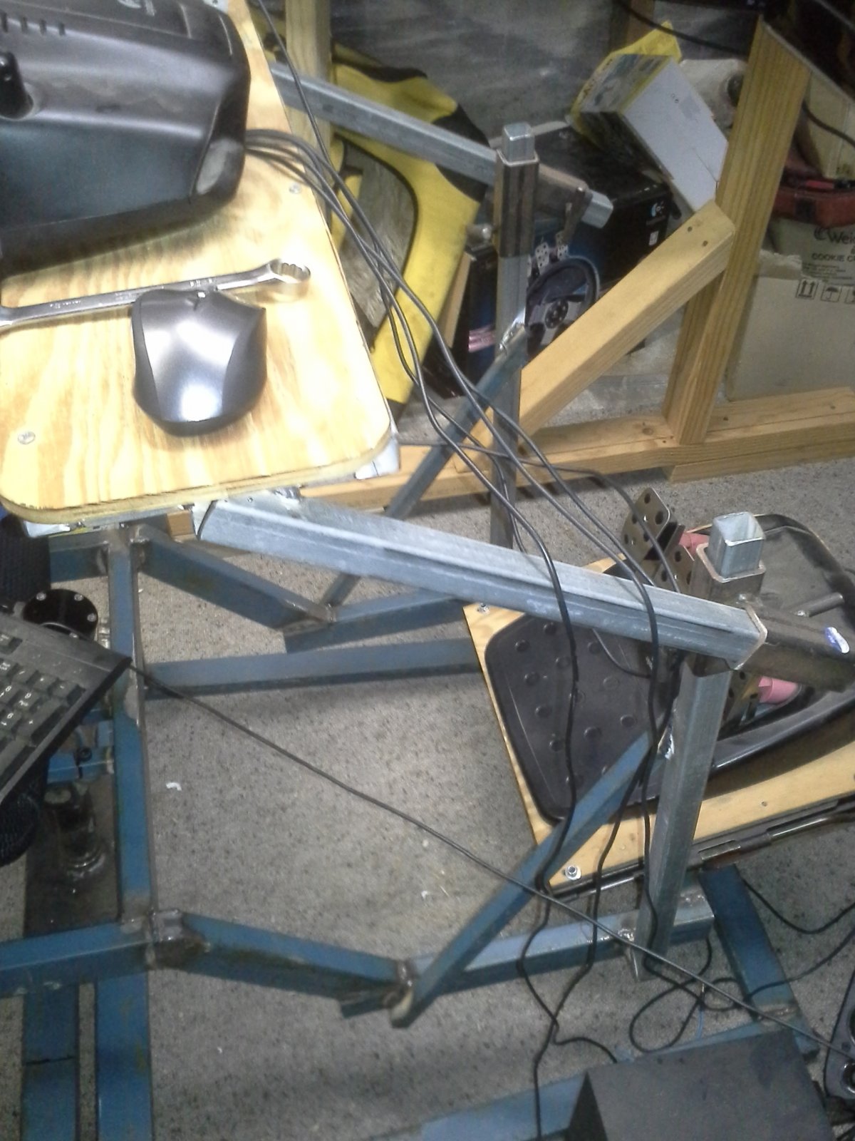

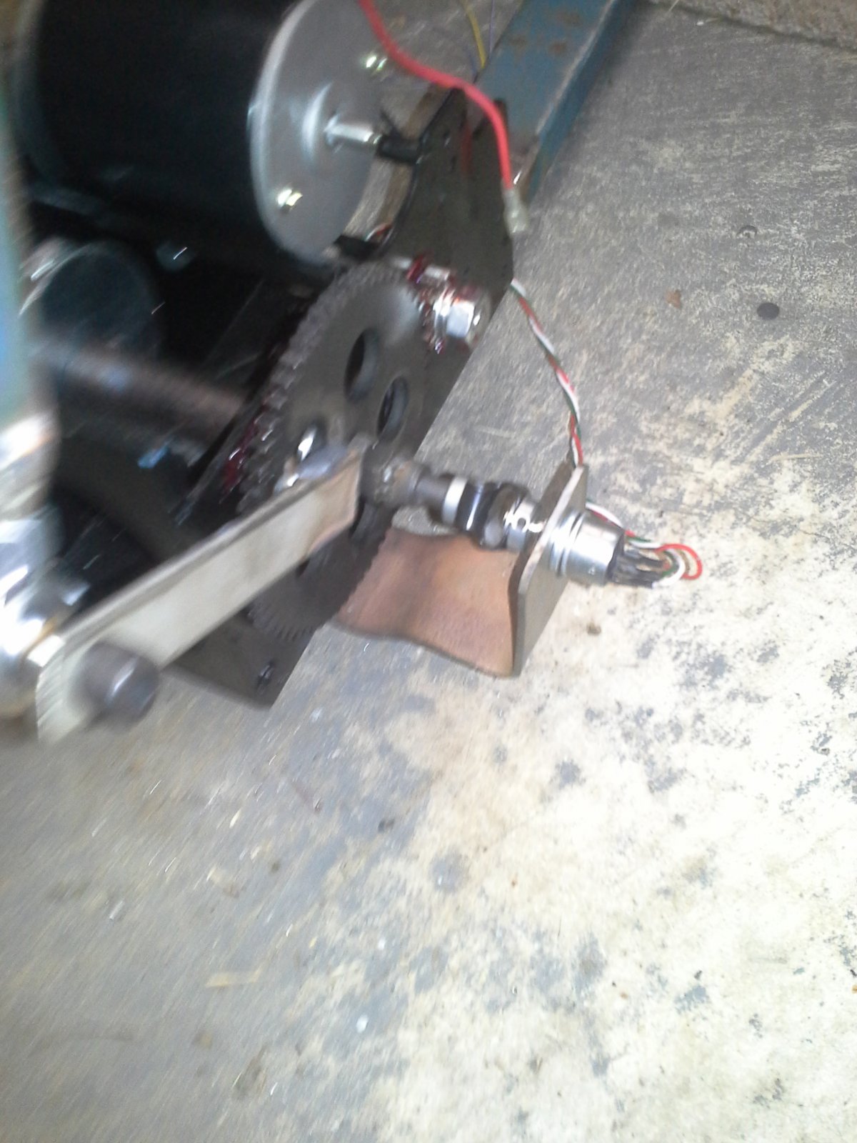

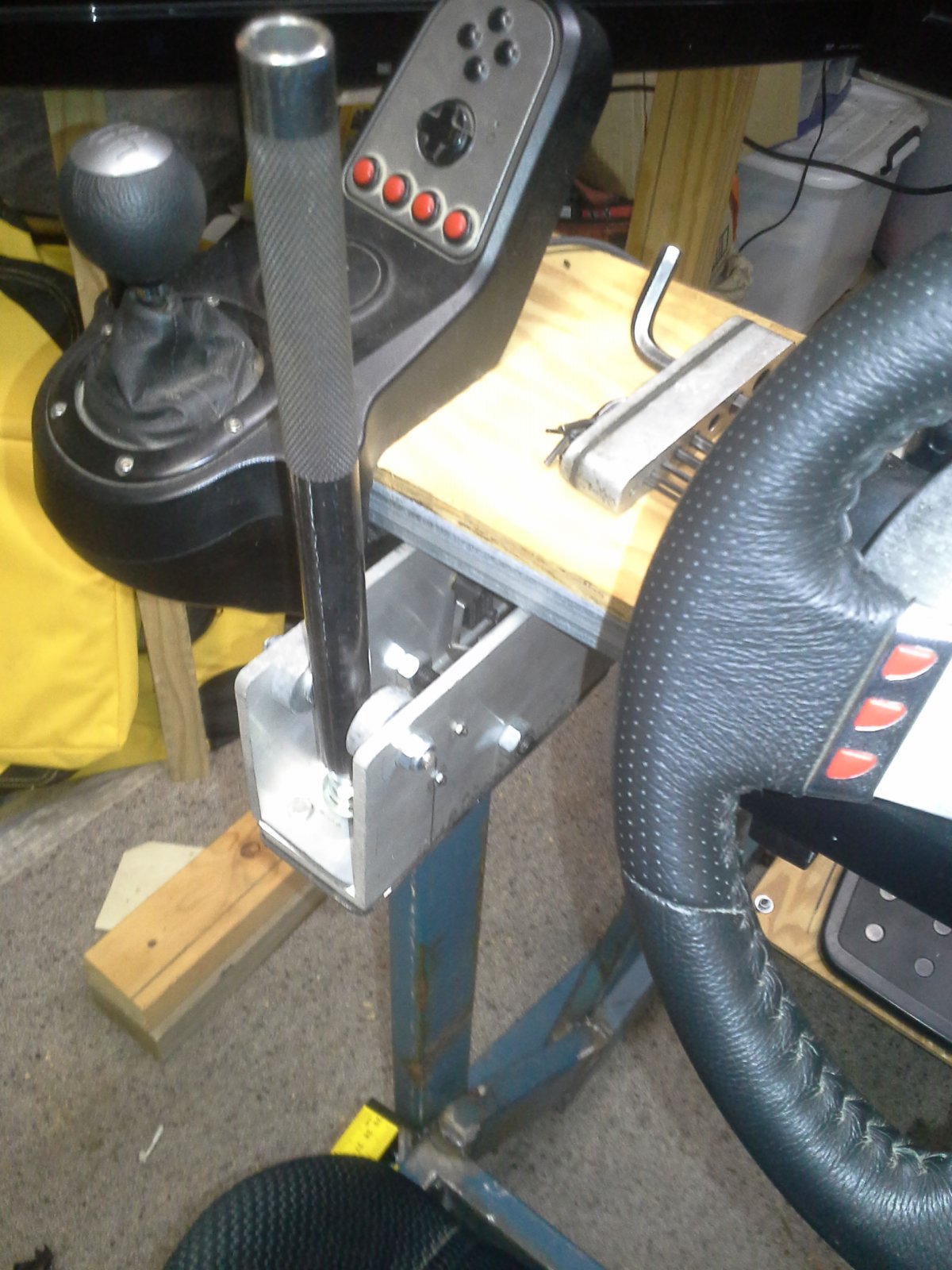

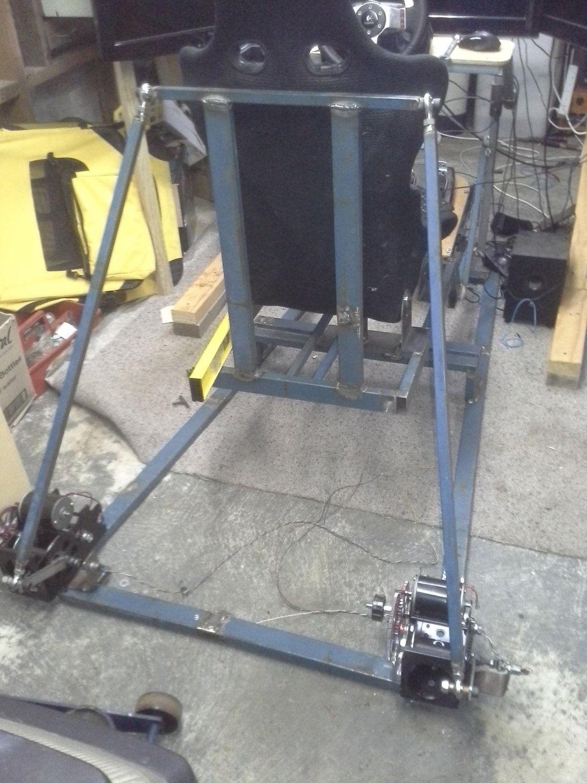

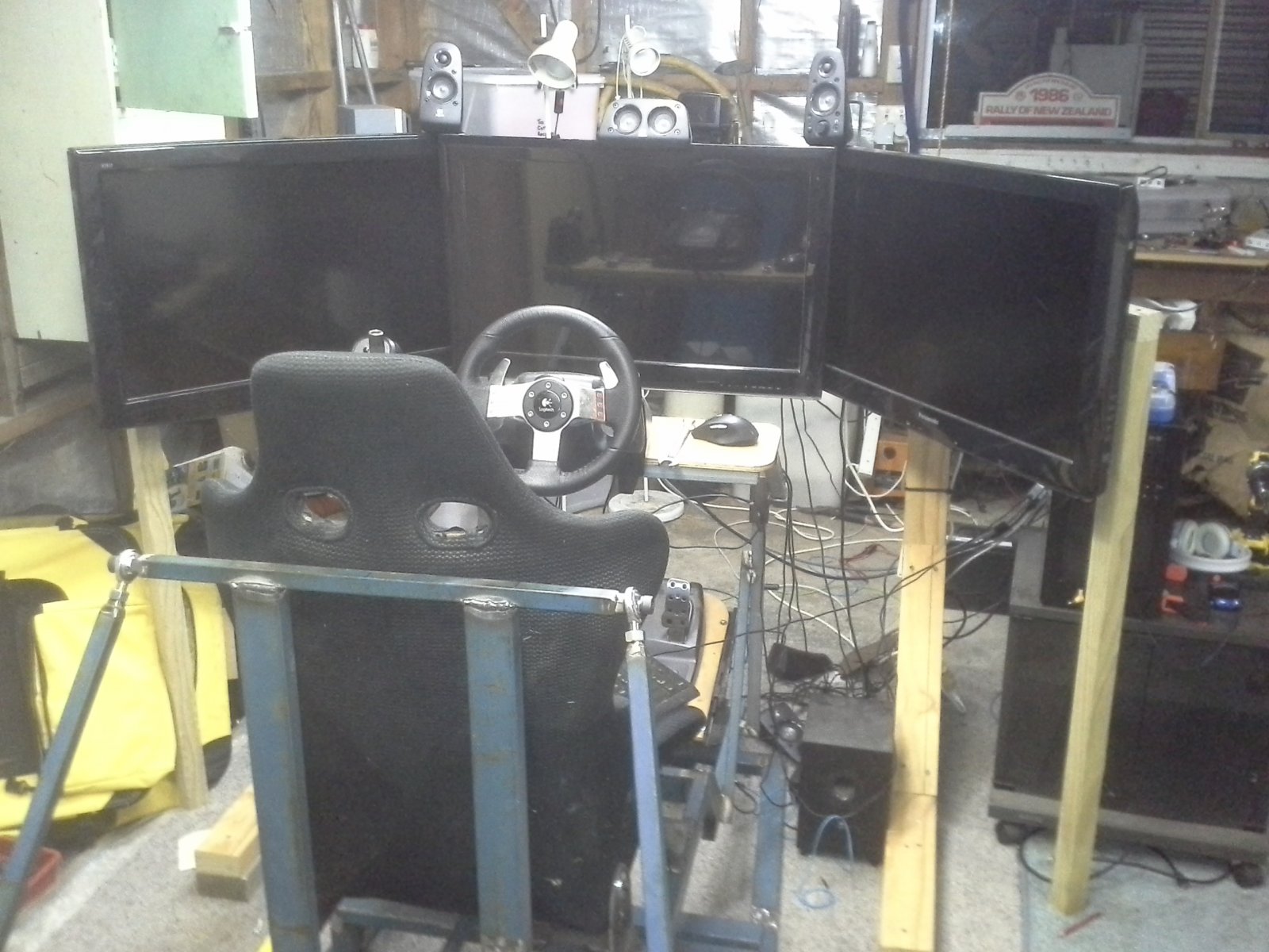

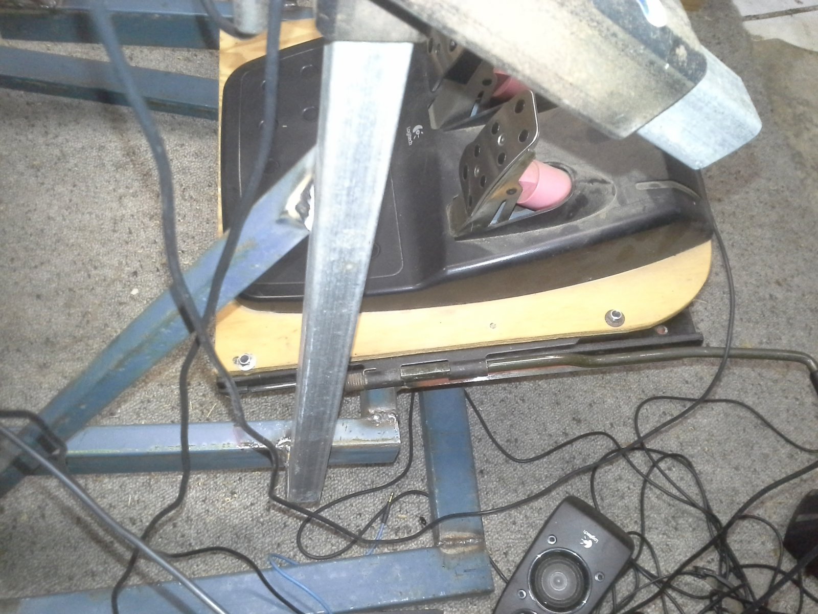

    well after nearly 2 years buying and building I am getting closer to finishing my rig I have added some pictures of my build so far the frame is not finished properly I have change from using moto monster drivers as they were clones and after a lot of faulty units I am using ibt2 which works ok on the bench test I am using rufus software to run my tests also not doing traction loss just yet

    april 2017 was last post since then have changed the complete rig to wantabe & silentchillie linear actuators making a 6dof I had to much backlash with those winch motors so I converted the motors for the linear with a 2-1 ratio on the pullies motor has plenty of torque but not enough rpm hence the ratio will post later the set up am now currently trying to make the whole thing move bloody wires every where using 1 battery & led power supplies I see silentchillie has a new project looks like I jumped the gun and made these linear actuators to soon when you look at his new build never mind get this up and running and if is ok then MkII could go in there direction
