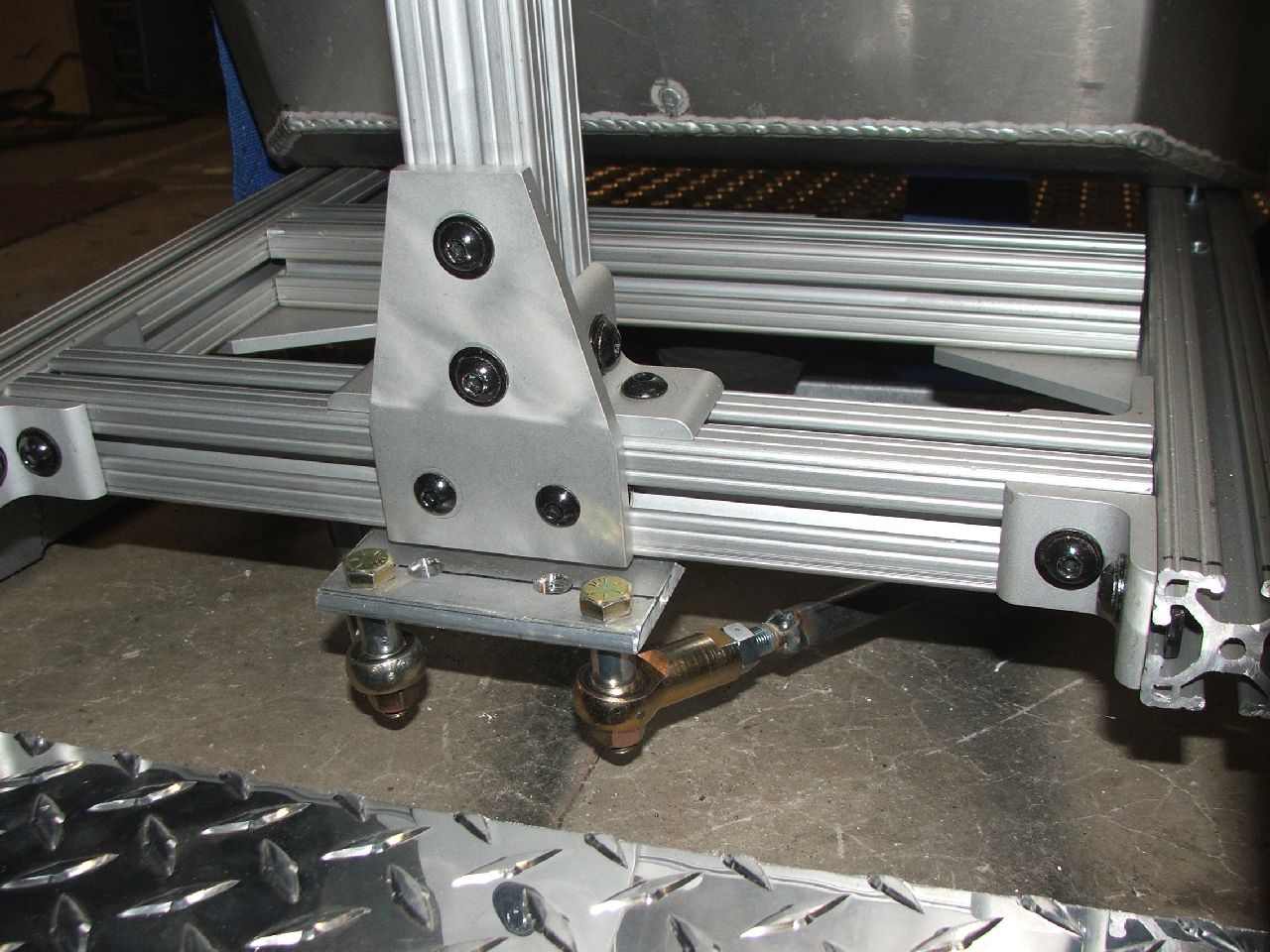

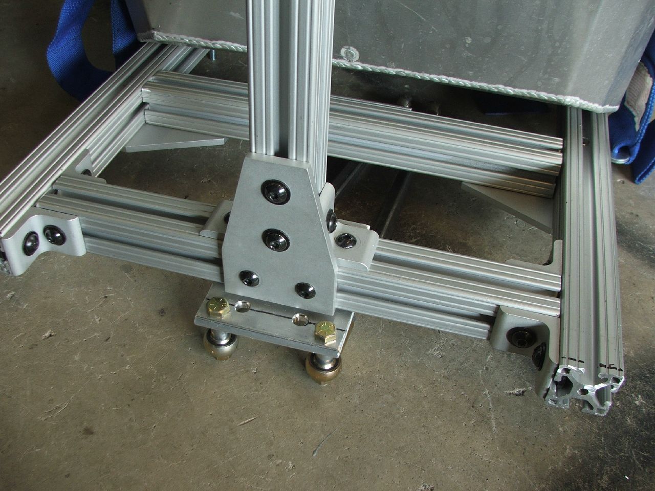

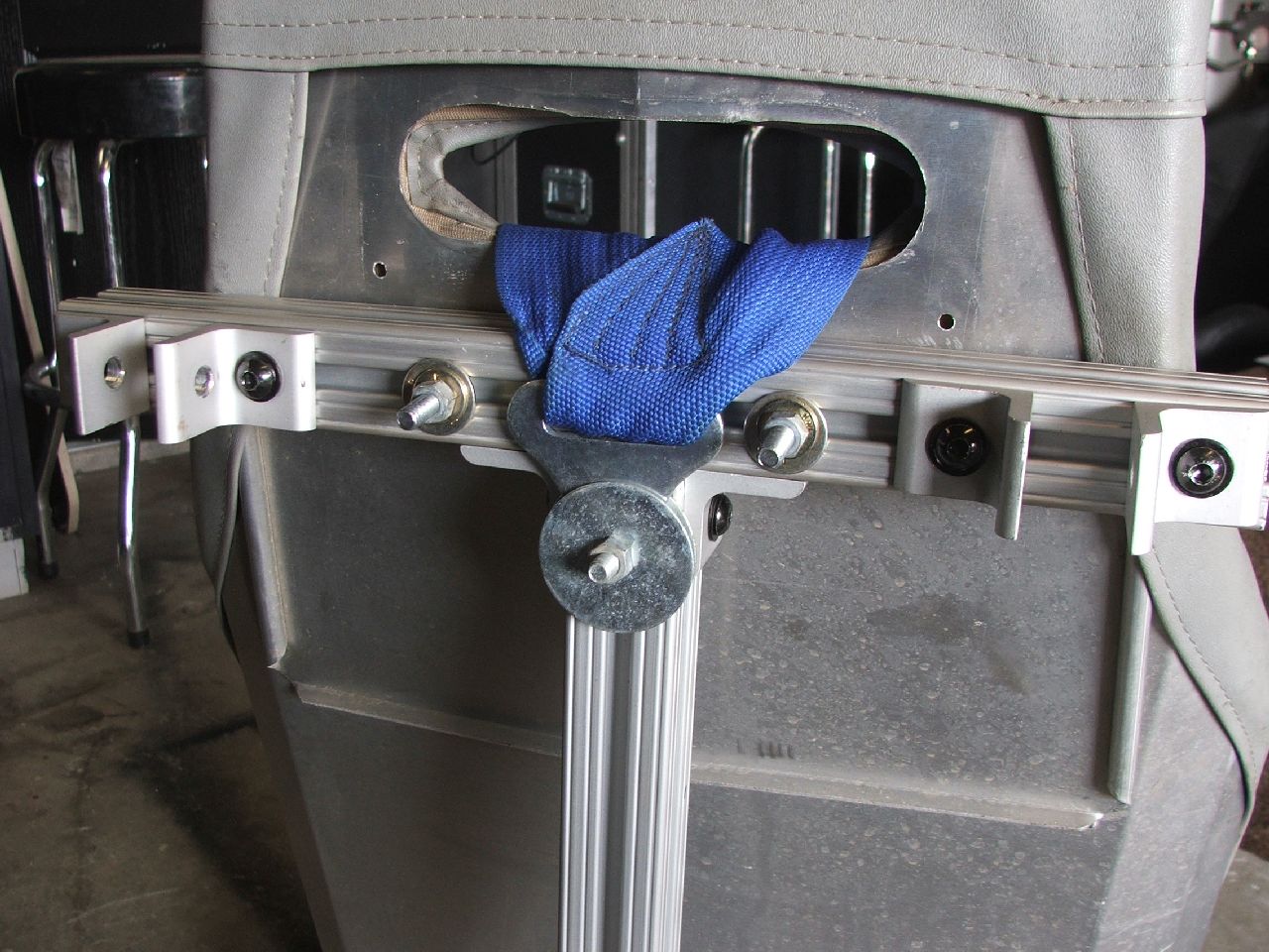

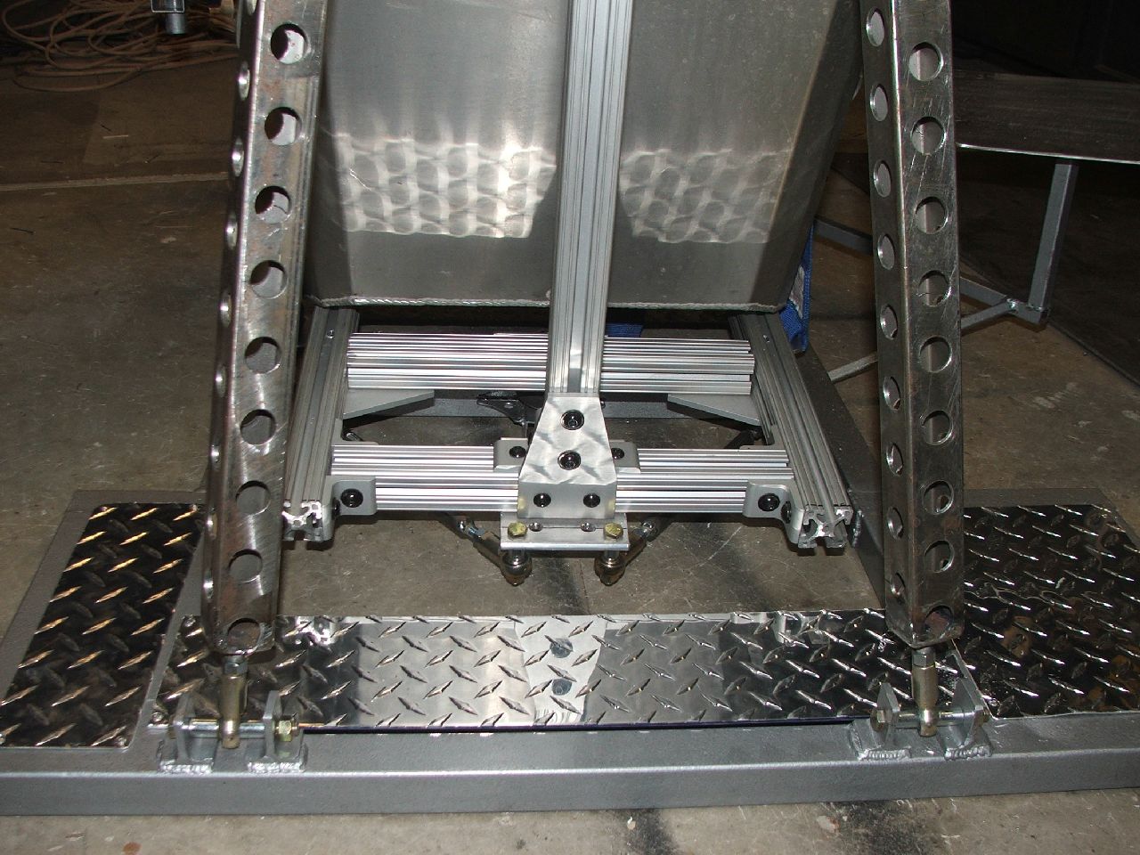

    :? Hey guys,I was wondering!, would it be a bad idea to actually bolt or mount the upper aluminum bar that mounts the actuators to the upper part of your seat to the seat??I would think that you would not want any sloppy movement of any kind. Just the dampners movement? I ask because I have not seen anyones sim buildt like that.I have an all aluminum stock car seat that I used in a Late Model stock car that I want to use (very lite!!) Maybe Iam just not seeing it and Iam sure if you dont theres a good reason why and would be greatful if someone could explain it to me? I will be building my sim as a cross between (bvillersjr) and (Mr Burns). I thank you guys very much!! Parts are ordered to get started!! I will I know ask a ton of guestions so please bare with me. Thanks circletrack15

    If your seat is strong enough then you can build some mounts that connect it directly. I mauy do this once I have decided on permanent actuator angles. Once you drill the holes, you can't un-drill them ;D
    If you wind up wanting to change the width of the top side actuator bar, you wouldn't be able to do it without drilling additional holes into your seat. That is unless you make some kind of adjustable mounting bracket. I simply thread in various spacer/ extensions that I made to my top and bottom bars as I experiment with various angles.
    You will likely need to do the same experimentation. The 150mm actuators have alot of travel and therefore can move more of your body mass beyond the centering point where your rubber mount or u-joint is supporting the majority of your weight. Without perfect balance andactuator angles, this is too much for the actuators to handle.

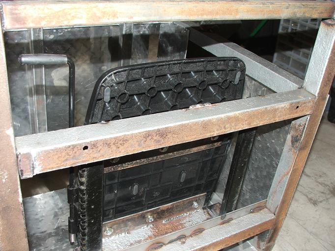

    Cool!! My Late Model seat is all aluminum and is flat in the back so I can drill to my hearts content!! will only lighten the load! and not take any strength away!!So I should get the 150mm then???

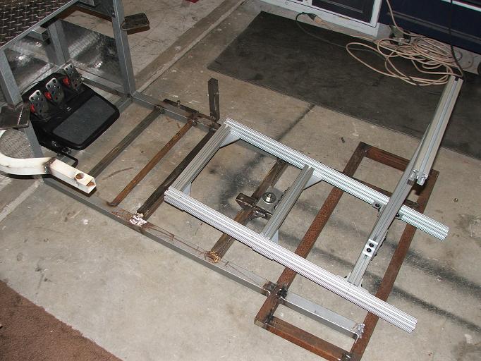

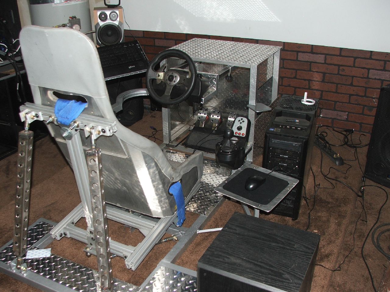

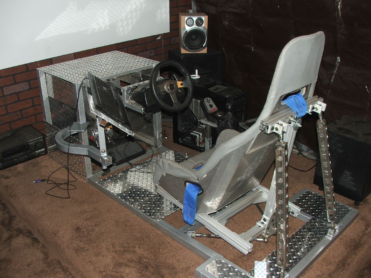

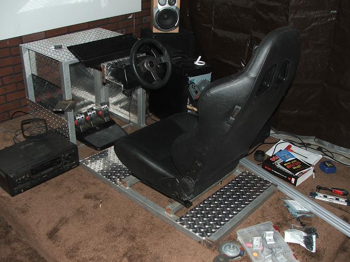

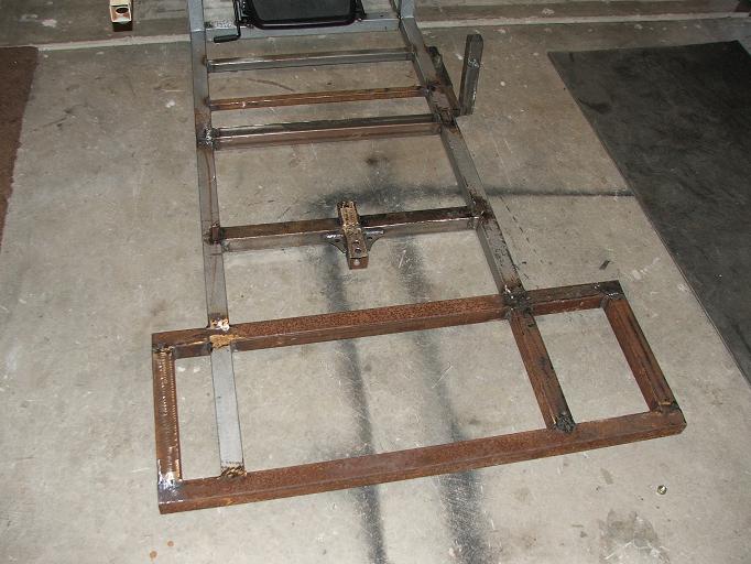

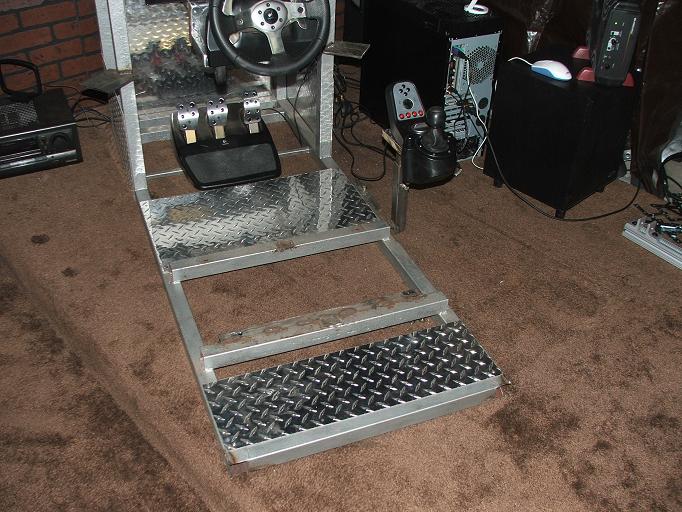

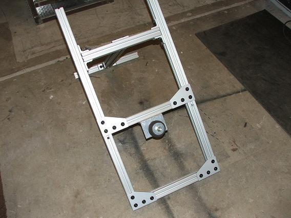

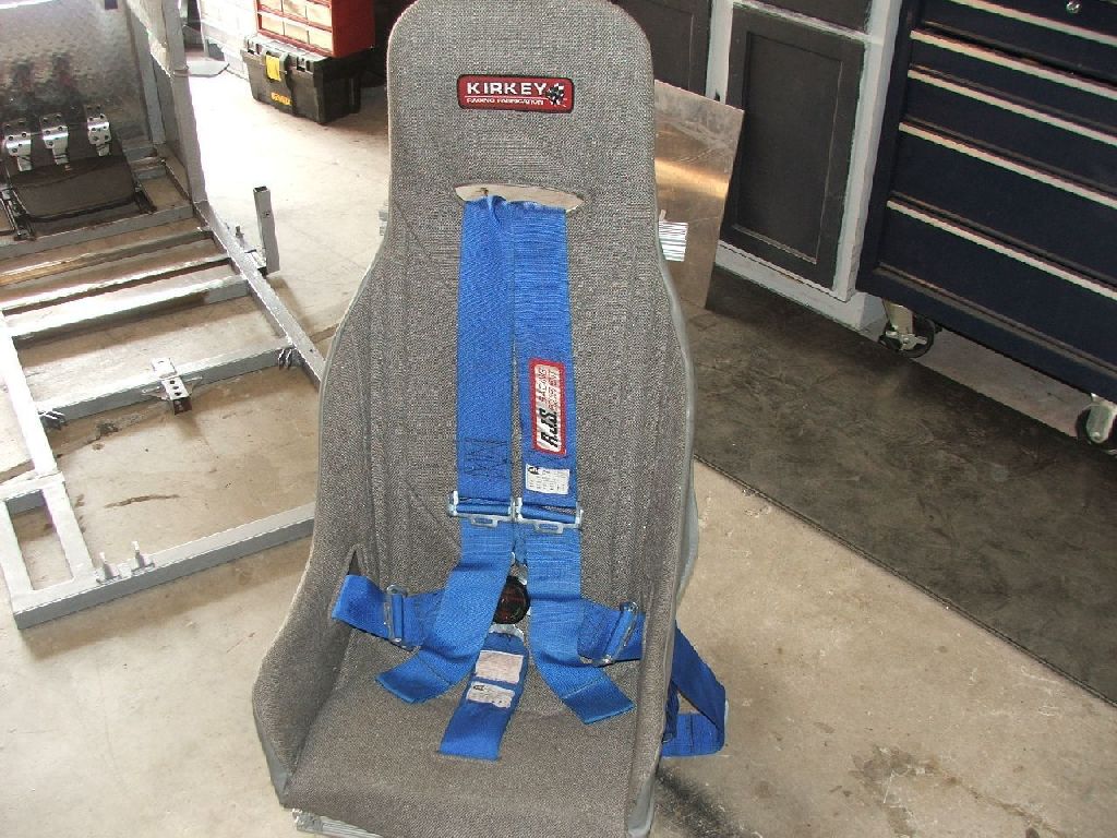

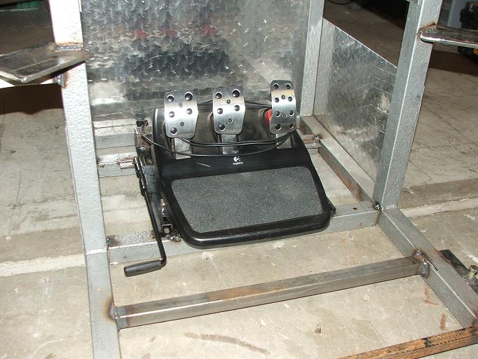

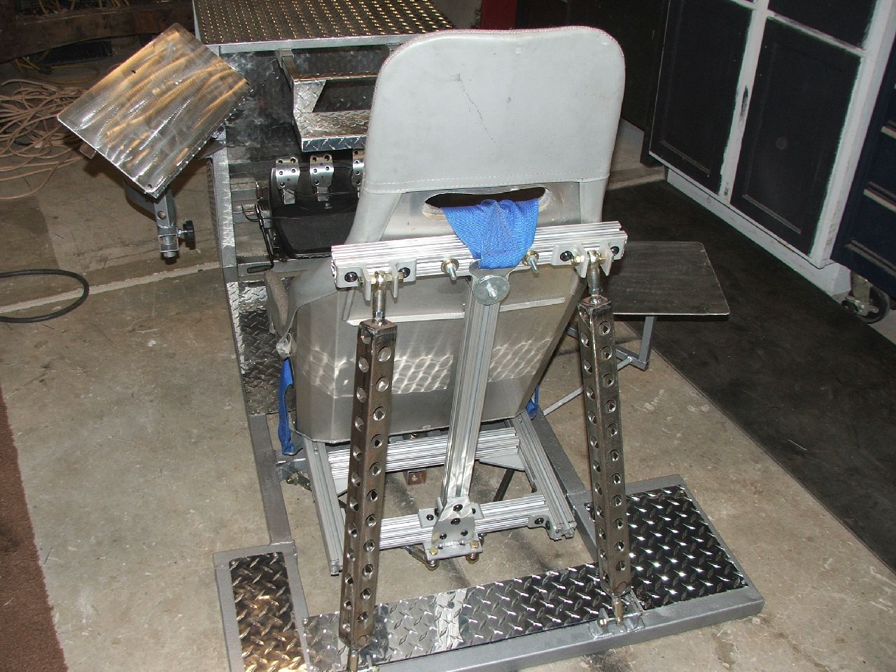

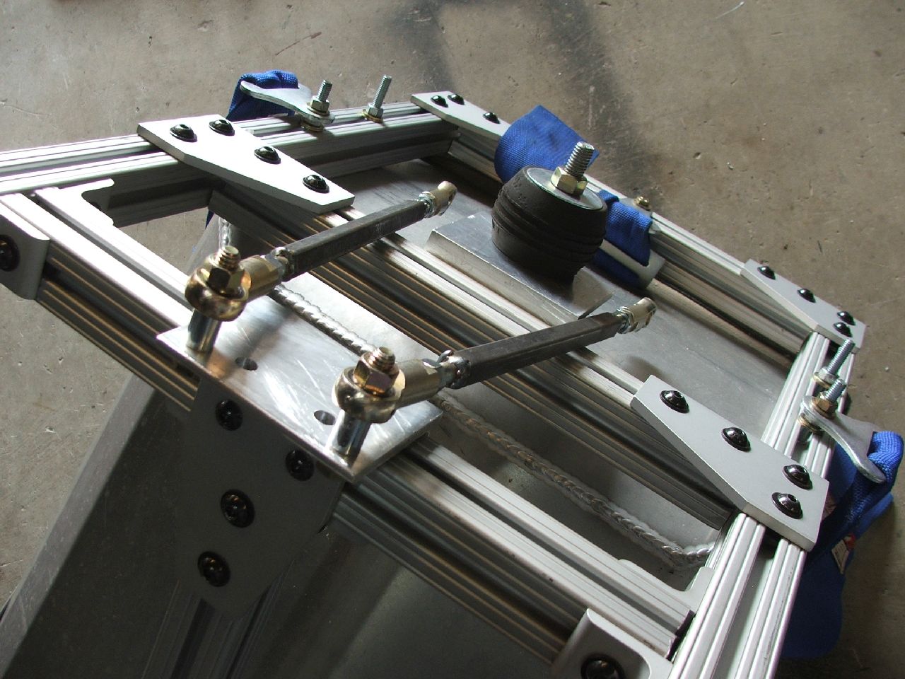

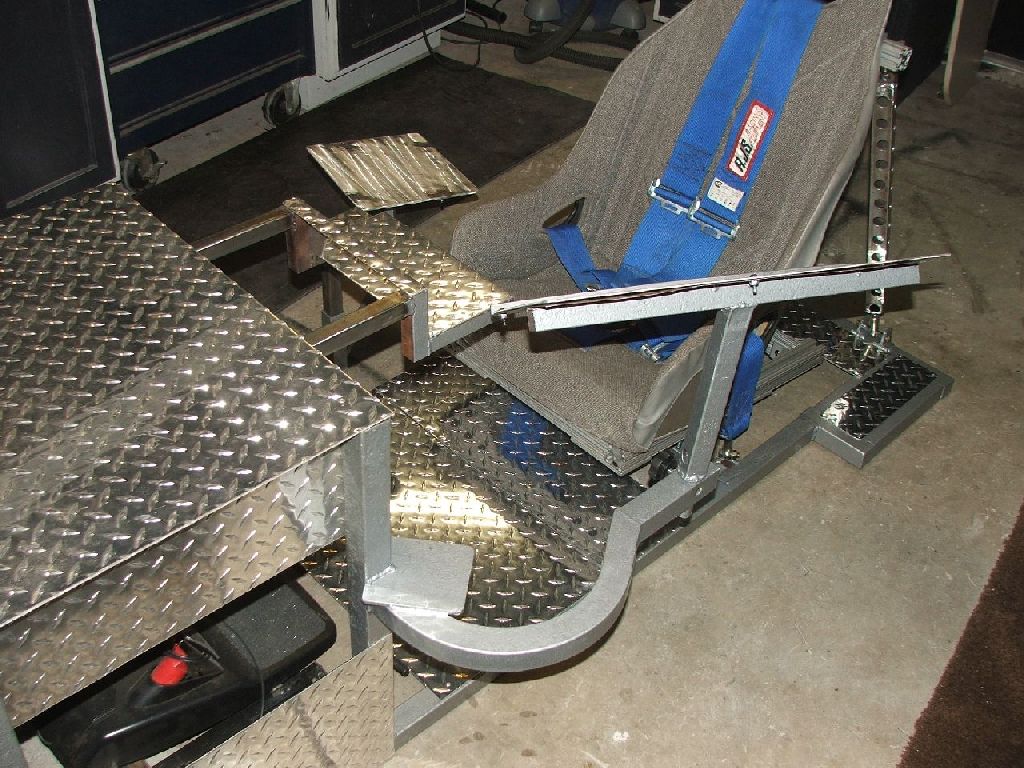

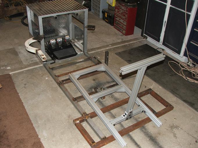

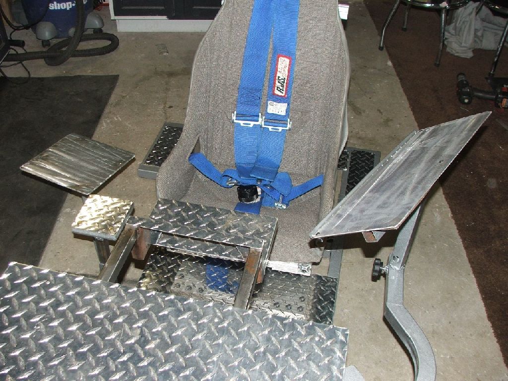

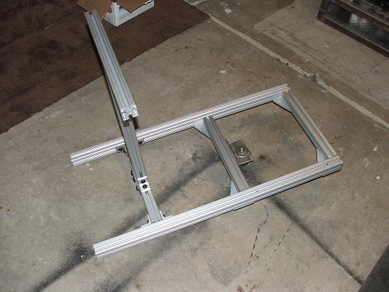

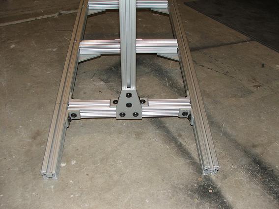

    Hey guys!! well here is alittle update to where I am now. I have cut my sim racer apart and started adding onto it for its transformation to being a real sim racer. I bought the 1.5 15S aluminum extrusion with brackets,screws ect. and am really pleased with how strong and cool looking this stuff is but was not expecting it to weigh as mush as it does. If any of you guys have any welding experience IMHO I would recommend building your base frame out of light weight 1.5 metal sqaure tubing. It is actually lighter than the aluminum and does not cost near as much. Iam very close to getting my scn5 actuators and need just a few more parts and will be able to get this baby going.

    ;D Don't forget stronger. The steel frame would be lighter, stronger and cheaper. If you can weld, it's arguably easier to assemble as well.
    In any case, that's a fine looking sim you got going though. Please keep us updated. :thbup:
