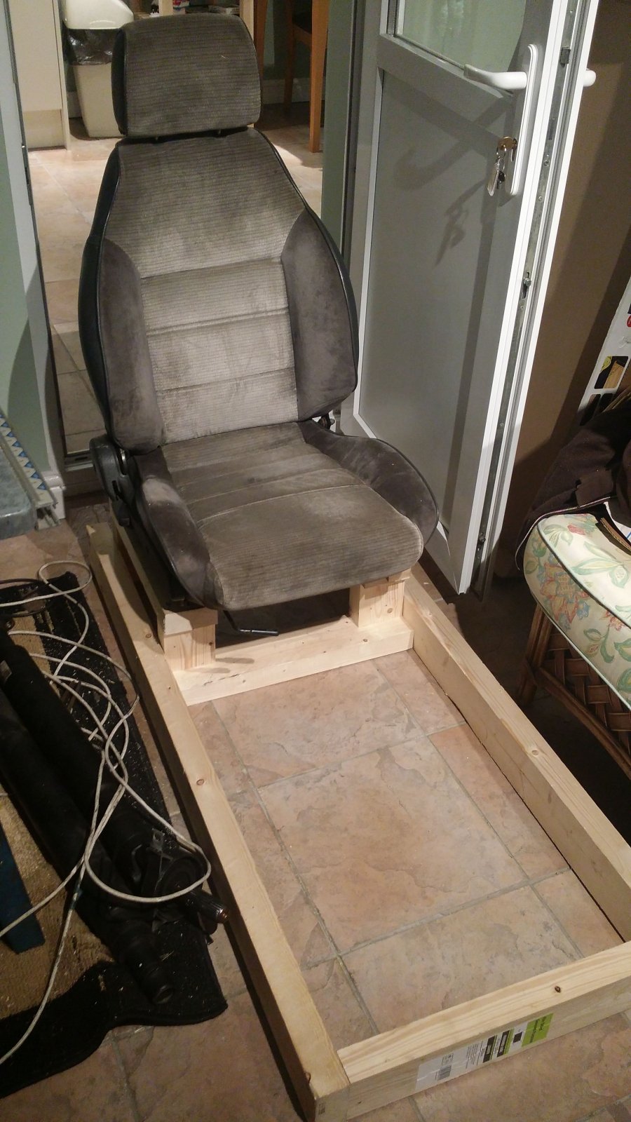

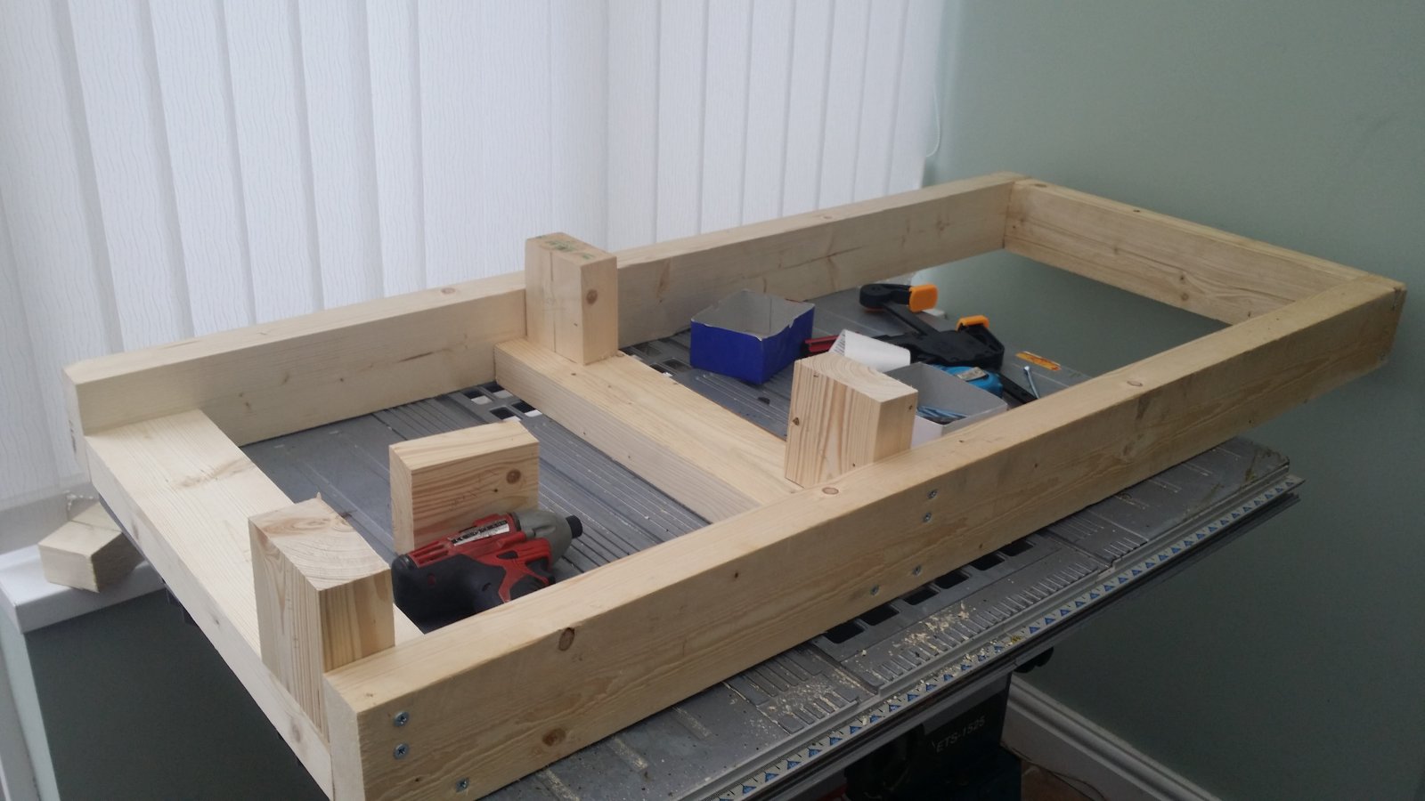

    Started building the race frame, for now it is being built out of wood and for the seat I will be using one of my old rx7 seats for now, terrible build picture time :

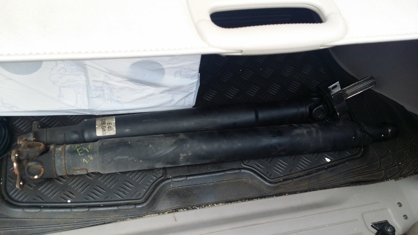

    Not done much yet and still waiting on motors, order second MM and power supply, picked up a propshaft locally for a tenner.
    So far the seat is now mounted to the frame meaning the only main thing to do is to sort the steering wheel mount

    What did you use for your pivot point?

    End of a prop shaft (universal joint)

    Guessing that would be the case, anywhere/thing in particular to get?

    I went to a prop shaft company local to me and asked for the universal joint end with about 400mm of pipe still attached charged me £20 I was more than happy as the nearest car breakers a lot further away and saved me time :thumbs
