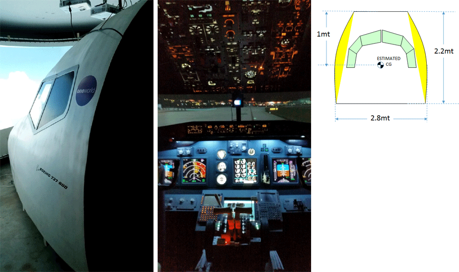

    I have built a 737 flight simulator on a play wood platform including the cockpit shell. This is a 2.8mt wide by 2.2mt long. It is difficult to calculate the actual weight, but it would be about 250-300Kg. including the two pilots. This is a home-made, hobby, non-commercial simulator (limited budget).
    I would like to add some motion to give the sim a bit more immersion, but due to some space constrains, I could have 2/3 DOF with about 10◦ for the roll and pitch movements.
    Searching for alternatives I found a few providers that I could be use but they are focus on commercial settings with a forbidden cost to my hobby budget (they asking thousands of dollars).
    I wander if you could provide some advice in term which is better, use motors or actuators, which software and hardware interface I would require to connect to MS FSX + Prosim737 Software suite.
    Any advice would be very much appreciated.

    Which way is the cockpit oriented with respect to the 2.8mt wide by 2.2mt dimensions, can you please draw some sort of sketch or add some photos as some sort of reference.
  16. J. M.
    J. M. New Member
    Jun 1, 2016
    7
    Melbourne, Australia
    85Coins
    I have attached some details about the cockpit. The CG details are an estimation.
    J.M.
  17. noorbeast
    21,522
    150,752Coins
    +11,019 / 55 / -2
    You will need to find the actual COG.
    For 3DOF I would suggest 2 motors at the rear and one at the front, equidistant from the actual COG, which may mean the front motor is slightly further forward than the end of the nose.
    Being set up as a 2 seater the load and COG will vary. So you should ensure you have enough motor capacity to compensate.
    You could consider simplification, a pivoted 2DOF for the fuselage and simulated heave for just the seats, combining harness tensioning with G-seat or heave movement like @Pit and I use. Just a thought.

    Fantastic piece of static aeroplane! One thing is coming into my mind, the space which remains to the ceiling...

    I have 300-400mm to play with on top of the sim, leaving enough space for the overhead projectors.
    That one of the reasons I want to have no more than 10 degrees for pitch and roll (with heave included if possible).
    I am still searching for the type of motors I could use.
