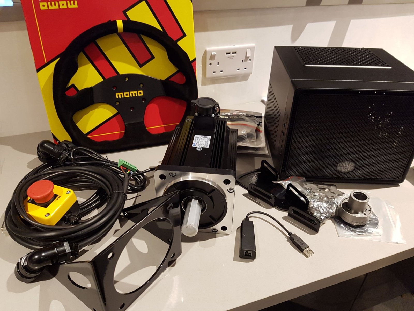

    So excited.
    i have just ordered a simucube and 30nm MiGE 130ST-M15015 10000 ppr encoder with Iono pro HC 25 so should be here buy wednesday.
    also ordered a momo mod 30 wheel.
    i haven't got a button box or paddles yet so will hve to use my shifter.
    I shall report if anyone is interested.
    I was going down the Leo Bodnar route which was extortionate, but after some info from @Nick Moxley i have sorted this.
    I cant wait. hopefully the rig can take it

    @stevemontuno let me know what you think of it mate.
    i may have an issue on my rig with weight however. i didnt realise i bought a large Mige and not a small. the bloody thing weighs 14.4kg without the wheel. i think my t500rs only weighs about 5kg. I need to lose a stone and half for my rig to perform the same, thats if it doesn't shake to pieces.
    The other problem i have is, i have ordered a pedal adapter from ricmotech and its not here yet and my pedals are not compatible im led to believe. I might try and butcher an RJ45 cable if i can find a wiring diagram and buy a connector so i can plug straight into the simucube until it arrives.

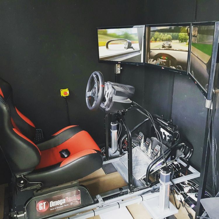

    You got a full frame mover, right? It will also change your COG badly

    @Blame73 I have a full frame mover but not like most with the cv joint. Mine is based on 5 actuators. 1 does traction loss and the other 4 are in each corner capable of 100kg each lift so shouldnt be too bad. i more worried about it shaking apart lol.

    need to sort the wiring out. i will make a new righ when i get the chance but have no time at the moment.

    and so it begins. i forgot to get the bolts to mount to the rig though so will have to raid the garage and hopefully find some.

    Whats the funky lookin Rj45 To USB looking connector for ?
  20. crammy
    Feb 23, 2016
    563
    Fabrication
    essex
    4,633Coins
    +326 / 2 / -0
    SCN6, 4DOF
