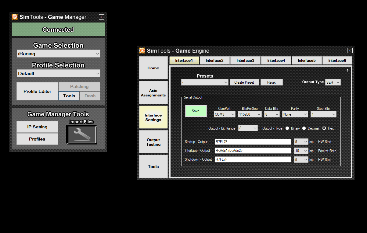

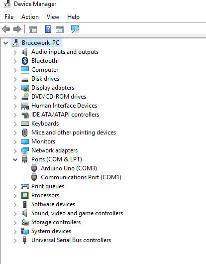

    OK Guys need some help, I have built a test rig, all works fine when sending commands through the Arduino software. I am trying to get the iracing to work in Sim tools. I think i have everything correct but i get no response when in iracing???
    I have the game patched and it says connected. I have set up the interface 1 settings to com 3 the same as my Arduino and all other settings. What am i missing?????

    These are my settings?

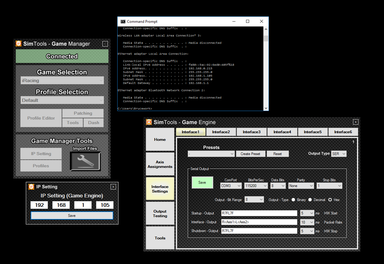

    I have set the IP to my PC's Ip address of 192.168.1.105 i have checked the 4123 port and allowed it through my firewall.

    Update in output testing everything works fine, when i go to Virtual Axis and drive in Iracing there is no movement of the sliders so no game data is coming thorough??

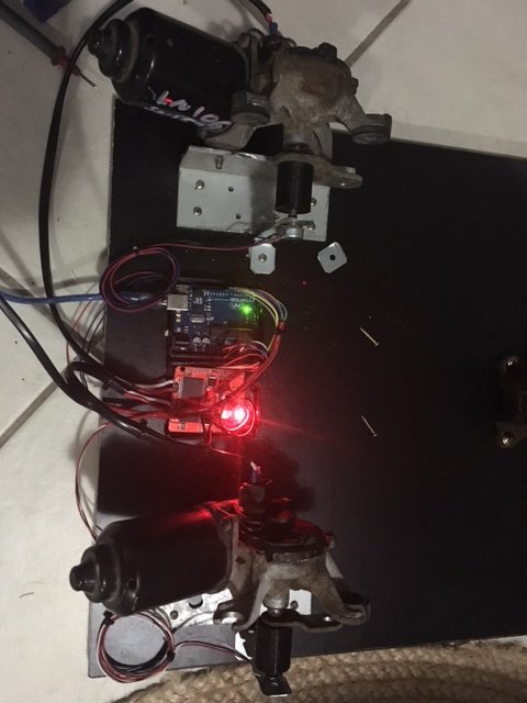

    The test rig is just using 2 wiper motors, and the code is from Racingmat 2DOF code

    I am just testing with cheap motors at this stage to see if i can get it working before making the real rig and spending money on the proper motors

    I patched it using the sim tools plugin updater?? is that not correct maybe that is the problem as i did not know the patch path for iracing
    I have tried many axis assignments.
    It is green and says connected

    All sorted, you are exactly right. The game was not patched correctly. All working fine thanks for your help...
