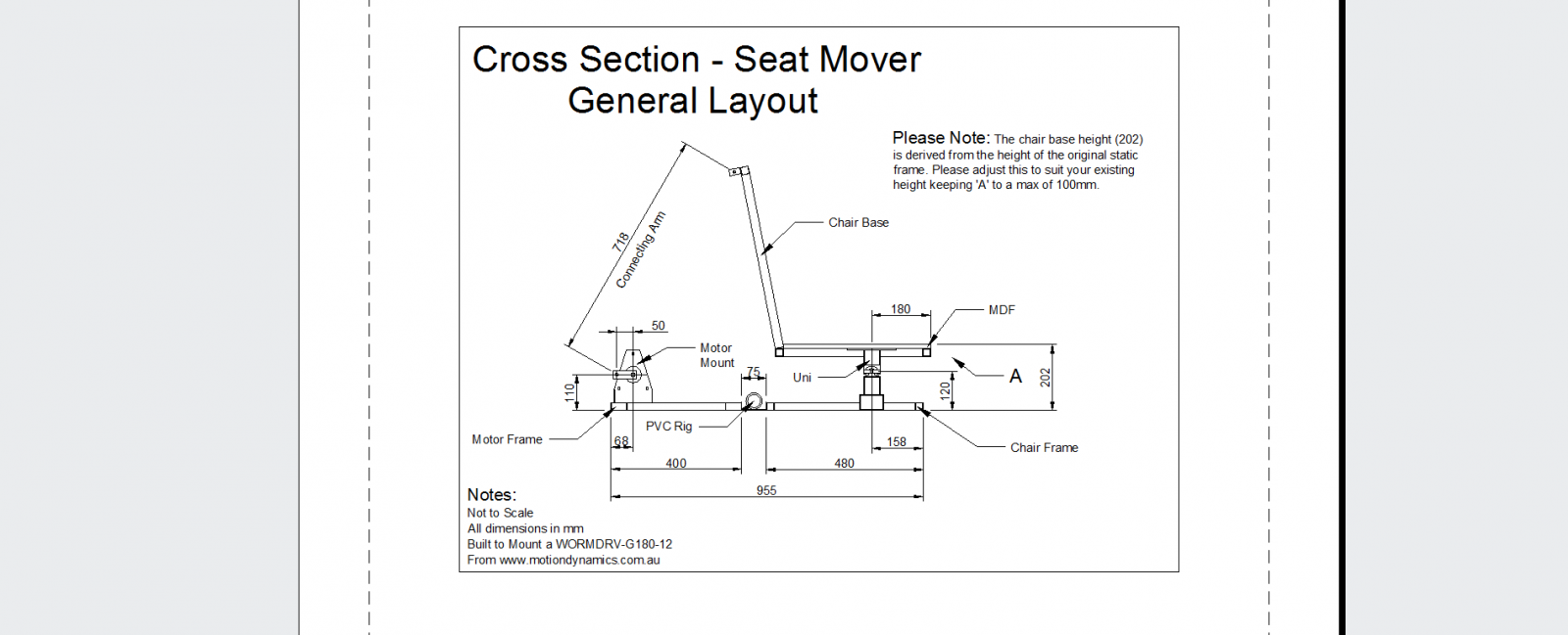

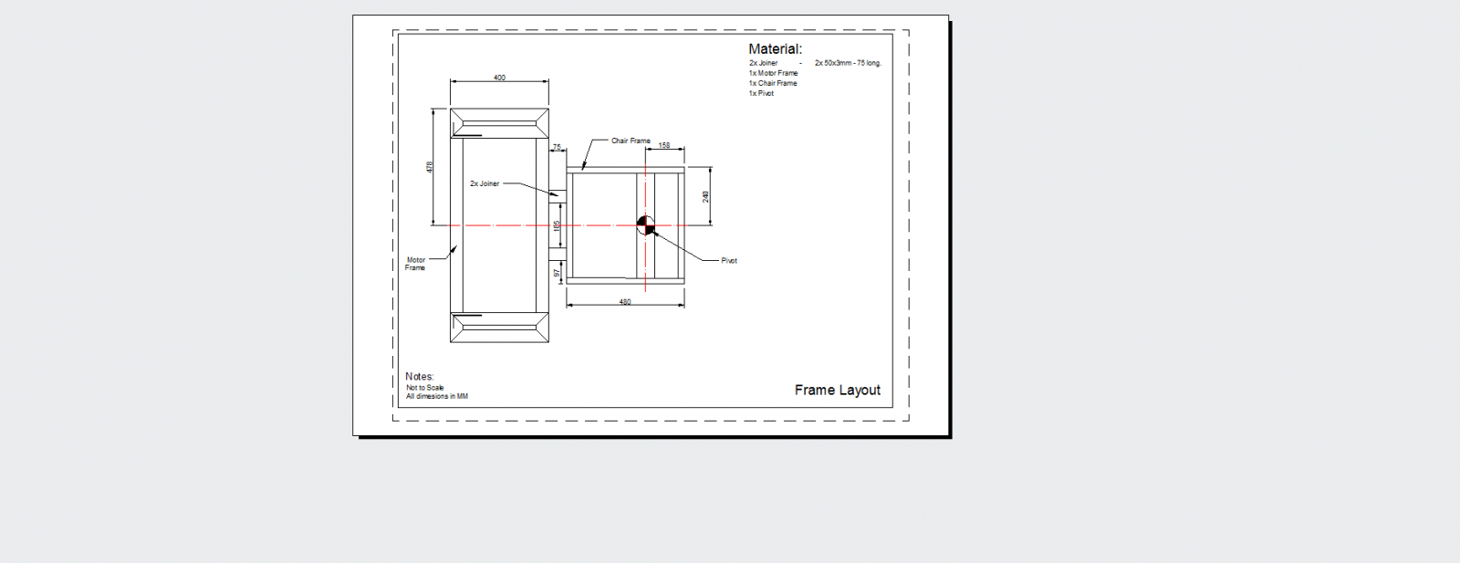

    Nice choice in controller, not sure on motor choice and power choice, I use a simular unit myself and so do a few others to the first choice, good motor. The power supplies not sure as I have only run the Jrk12v12 (http://www.pololu.com/product/1393)
    to 13.8v makes abig difference in their speed and torque. Must check on the pololu site and see they have overvoltage protection up to 41v, doesnt mean they can handle 41v or output 41v, so please check on the makers site.
    Motors I and few use :http://www.motiondynamics.com.au/worm-drive-motor-12v-24v-200w-180-rpm-20nm-torque.html
    Edit: Just check looks like 16v is there recommended limits. Should be fine.
    Another note to remember is to have a little or big heatsink on the main chip, and use a decent fans as running them at these voltages and amps require excellent cooling in order to drive theses motors hard and fast.
    So whats the rig style will you build in, myself I would recommend a seatmover, nice easy quick construction and can be modifed at a later date to a full 2dof unit.
    Seat mover as an example.

    The problem with having all moving is the weight transfer while a change of motion happens, can be done, but because of the charactristic of the resulting movement the motor may not have the same speed as if used solely as a seat mover.
    One suggestion is to design a simple seat mover letting you be free to place any size monitors and wheels, pedals controllers or keyboards , etc on the sim.
    See what happens in an all in one sim, you keep adding to them forgetting about weight and having it balanced perfectly on both axis (front-back and left - right), because if its not the side where the weight shifts too will cause all sorts of woes.
    To overcome this took me 4 sims and alot of head scratching to get a final product that I was happy with.
    A seat mover can be a good starting point to learn Simtools and sim building as in what you have build can be modified and you can test and set it up as you go. Like adding a foot well to the chair support and wheels support, etc , mean while its still drivable and can be done bit by bit. The idea of my above sketches was to give an option for people who were either still suspect of SimTools or did not want to give up there beloved static sim. It took me about an hour to fabricate and another hour to wire and setup the Jrks within 1/2hr was running Dirt3 in SimTools. And all for an outlay of $800 - 900, producing some radical motion, effortlessly. The plan is to finish them when I get a chance to write it all up as a base for newbies to start with and get their hand dirty and enter into the wondrous world of sim building.
    If going for a full 2dof , be careful to get it all balanced right , not too much angle, for race 10 deg is plenty, building a seatmover style shows you that. Step forward in small steps but really you could be enjoying motion very quickly and be on your way to modding to the rig you dream of.

    thank you, I will take both of your advise and start with the seat mover design you have attached above. I'm going to make the unit out of aluminum tubing to help keep the weight down. I own a machine shop here in the US and can get it pretty cheap.
