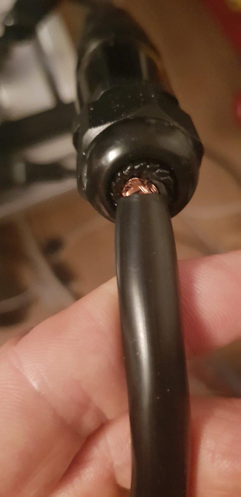

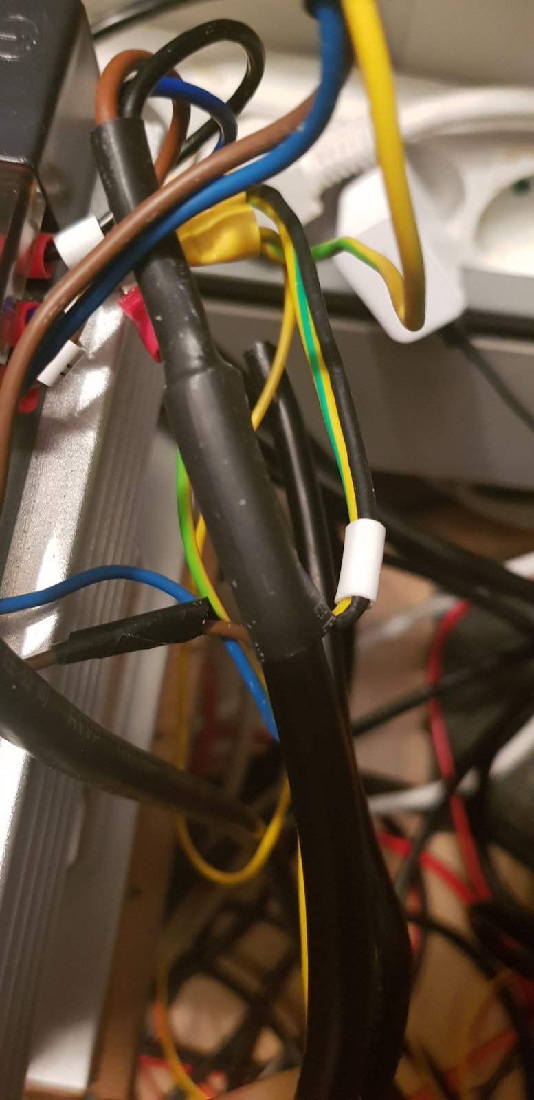

    Dear, Both the motor cable and the motor can be shielded, and the price needs to be increased by 10usd / pcs
    and the delivery time is relatively long, which takes about 15 days
    https://www.aliexpress.com/item/32867802944.html?spm=a2g0s.9042311.0.0.36504c4d9YRq80
    At driver and cable on motor side of the connector

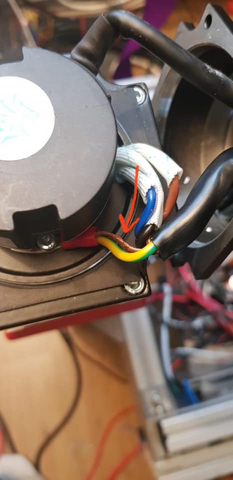

    NOTE!
    Turns out all my EMI issues had one large source. Thank to the help of a guy in the SFX owners group on facebook we figured out the cable shielding was connected both to the motor and the driver causing a ground/earth loop. Once i removed the offending wire everything instantly became 95% better.
    Make sure there is no leftover that can touch the housing.
    Lesson is, always double check the factory shielding. I would not have a clue if it wasnt for the help though

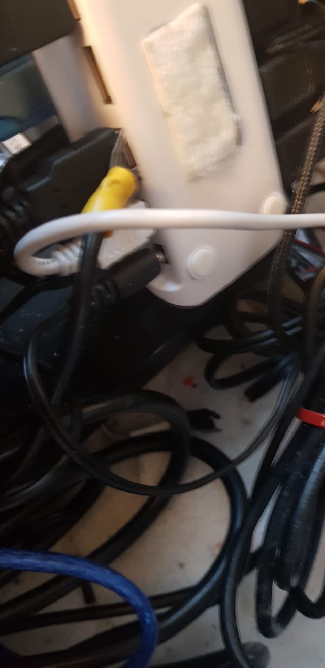

    The last thing i needed to do as i had some minor dropouts and button presses was to connect a ground from the driver to the P1X racing rig alu frame (only frame and it goes crazy) and then a wire from the frame to the usb like this. Make sure you got as much contact as possible at the hub. This grounded all my USB's and i can run the cables very close to the motor with no issues.

    I noticed when i used noise from RPM (low rpm) on Pt mover that my Pimax 5k+ image was shaking double vision like crazy from EMI so i pulled another wire from the frame to the USB in the same manner as before and that solved it. Its on its own powered hub so i haven't tested when its connected directly to the computer or if grounding the entire computer to the frame of the rig will work but i think it will be about the same. Im unsure how isolated the motherboard is from the PSU and the grounded wall socket there.
