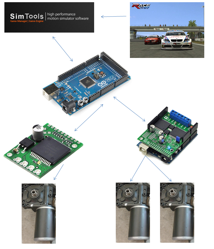

    Since the JRK`s are too expensive for my 3DOF drift mod, I've been looking around for an alternative. After some search and advice from Robbie (Thanks mate), I opted for an Arduino Mega with a Pololu Dual Motor shield plus a single shield.
    Dual shield: http://www.pololu.com/catalog/product/2502
    Single shield: http://www.pololu.com/catalog/product/1451
    Like that way: Schema.PNG
    I'll keep the updates here a bit short because I do not want to write everything twice. :sos:
    If bigger jumps happen, I'll also post it here.
    Here i will update shortly: http://simracing-austria.blogspot.co.at/p/3dof.html
    I hope you can understand that.
    seeya ...

    Yep, understand no worries.
    Good idea about using ard and bridges to reduce cost.
    Go hard buddy! 8)

  5. RacingMat
    2,233
    21,068Coins
    +2,092 / 21 / -2
    Hi Dahfl!
    That's a good start:
    - 2 Motomonster are enough for 3 DOF
    - yes, you need 3 pots
    What kind of 3 DOF do you intent to built?
    Have a look on my tutorial ;-)
