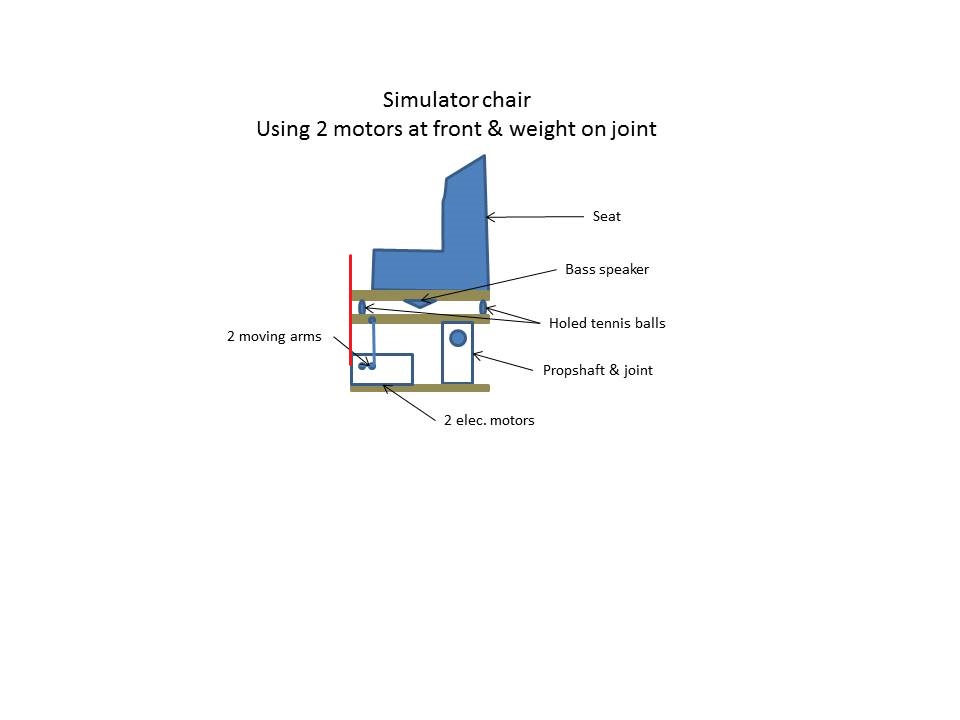

  6. Kass55
    Kass55 Member
    Aug 19, 2015
    70
    PC support
    UK
    315Coins
    +16 / 0 / -0
    Thanks, following advice, I have ordered to JRKs for ease of setup.

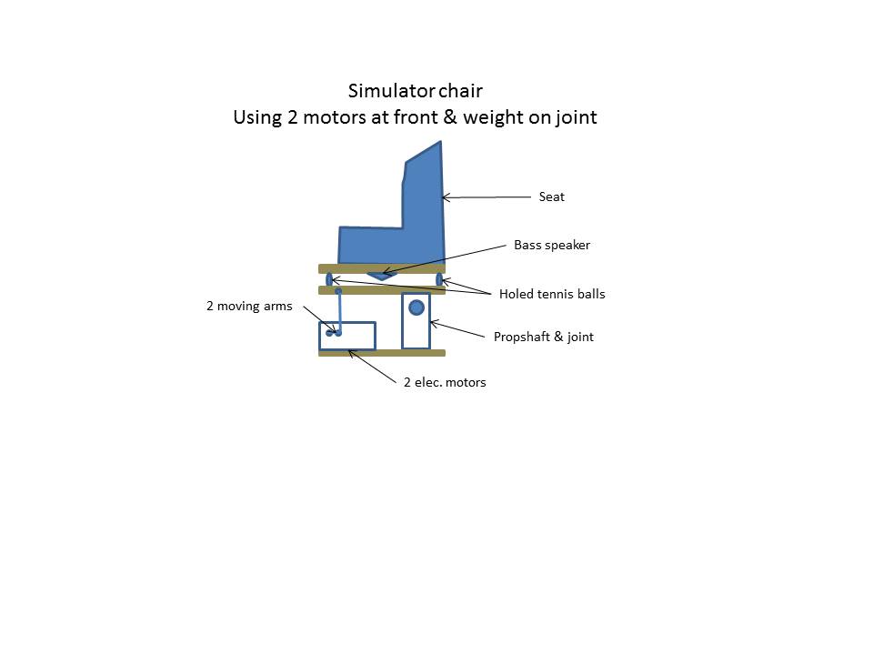

    I have also decided to build another 2DOF seat first, before going to 3 or 4. Start off at walking pace at lower budget.
    So single pivot to start with, while getting going.
    I attach my design drawing below, Seat movement only.
    I placed motors at the front because I have limited space behind me (small bedroom).
    Tennis balls are to create less direct rubber like feel, similar to tyre feel.
    Bass speaker is to create engine vibrations in the seat, may replace with kicker depending on how well it works.
    Tip: I use 2 fans attached via USB to blow air over hands & lower face. I think this works well, giving more feel of speed/moving.

    Not sure how the tennis ball idea will go given the forces our sims generate, but there is nothing wrong with experimenting.
    In a compact design you need to maximise the leverage by having the motor as far forward as it can be and the connecting rod mounting to the seat frame at least swab height or higher, so it is above the center of gravity, see the red line in the picture.
    You also need to ensure the seat is balanced properly: http://www.xsimulator.net/community/faq/find-the-center-of-gravity-to-balance-a-motion-simulator.55/

    Please take a video when you carry out tests with a test pilot on it :). IMO I think tennis balls would allow the chair to oscillate under a riders load and likely fail over time :eek:. Maybe better to try suitably rated shock mounts:think.
  9. bsft
    @Kass55 , I ve done what you are looking to do
    http://www.xsimulator.net/community/threads/desk-racer-2dof.5326/
    May I suggest forget the tennis balls, once you get a good profile, you feel like you are in a car racing.
    The tennis balls could absorb some of the finer vibrations, you said this "Tennis balls are to create less direct rubber like feel, similar to tire feel."
    My question to you would be, have you actually been in a proper competition vehicle? Because Ive spent time behind the wheel and as a passenger and they usually are as hard as hell in suspension, You cannot feel any tire suspension.

    Thanks Noorbeast, I'll mount motors & rods as suggested.
    I have driven real race cars, the suspension needs to be firm & controlled but still needs to move / give a bit.
    I think bump stops or old BL mini damping cones are too heavy duty for my weight.
    Shocks and springs to expensive and too little room.
    I was thinking tennis balls or similar because they are cheap and I double / triple up as needed.
    I'm simulating a car rather then a train on rails. I will feedback / video once I get it going.
    I want a little give, without flopping about, to dampen bumps a bit but not completely.
    I planning engine vibrations will come from the bass speaker directly mounted to the seat, but haven't tested this either yet.

    I just thought of something @Kass55 , generally in game, the motion and action of the car is reflected in the motion of the seat. I was playing AC last night and driving an old Audi , and it was a boat to drive, very sloshy and very little heave motion, then I played a more modern car, and the difference was night and day. Much more response and nastiness in motion.
  12. Nick Moxley
    17,056Coins
    +2,506 / 30 / -2
    I also Do not suggest the "tennis ball" idea. All you'll be doing is working the motor's harder than they need to be.
