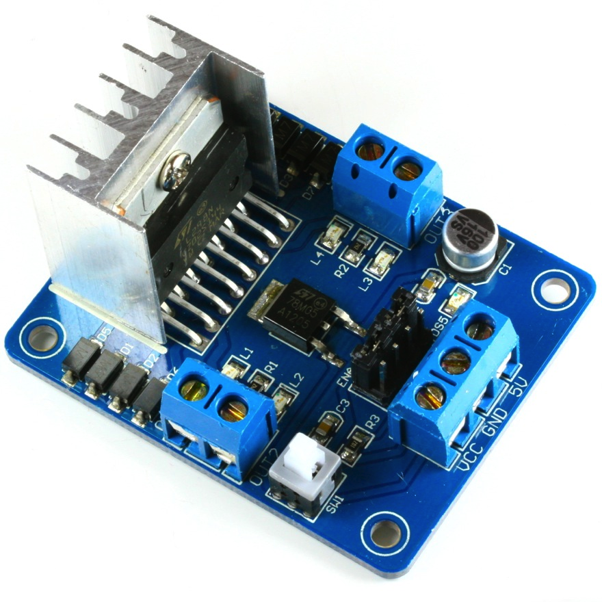

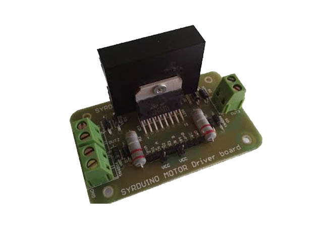

    HI guys
    I found on the net circuit Is used as the "controlling L293"
    Can be linked with Arduino
    The twin-engine control up 36v 2 A
    Motor driver L298
    Can be used instead of The other circuits
    http://arabtronics.net/products/SYRDUINO-Motor-shield-.html

    Hi!
    2Amp : it's really too weak... :(
    try to look for VNH2 or VNH3...
    Tell us what kind of simulator you want to build
  4. bsft
    there are more powerful motors drivers than the JRK. But if you need to use more than 40 amps peak current atg 14v to move your sim, then I suspect you are trying to overcome a bad design by using too much power and much larger motors.

    Firstly, you have to understand the theory and working of a simulator. Trial and Error will take you no where. Even if this card you posted here is suitable, its going to be difficult to find a 36volt DC power supply and and a motor capable of running at rated current of 2 amps at 36Volts. Every part is connected to each other and choosing one is based on others. You have to look for cards with continuous current rating of at least 12 amps.

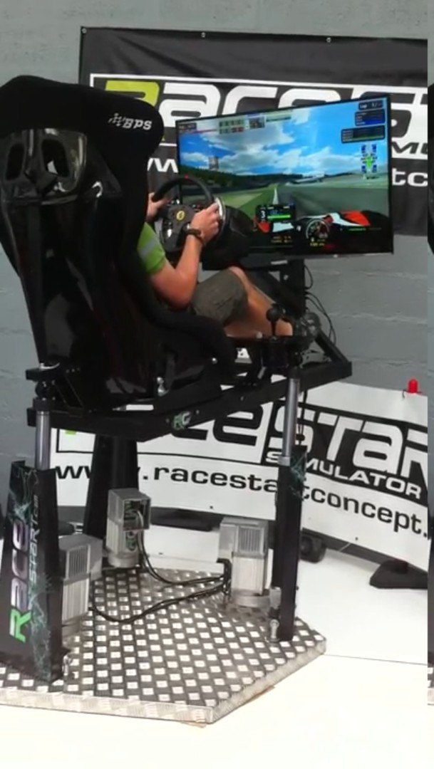

  9. bsft
    @moon310 to build a DIY like the one you have pictured is possible, but allow for plenty of cost.
    I think @BlazinH has done a similar project with BIG 12v motors around the 750 watt mark. So that h-bridge will not do it.

  12. RacingMat
    2,234
    20,894Coins
    +2,084 / 21 / -2
    It's good, we enjoyed the ride with my friend on the picture! but yes, it's expensive: it costs 20 000€
