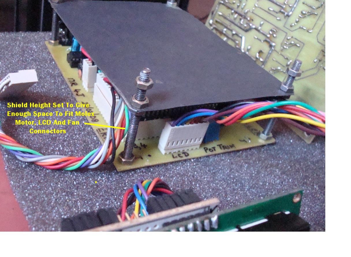

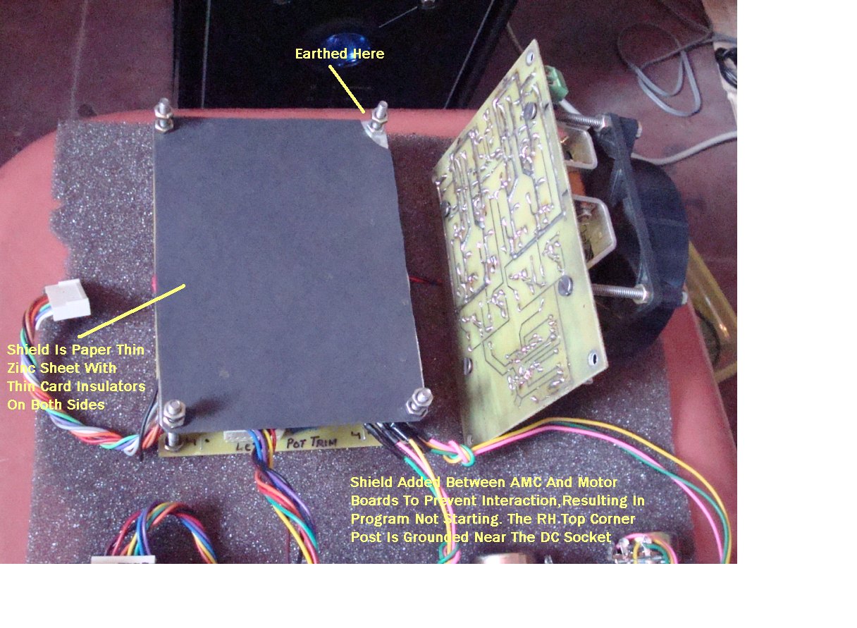

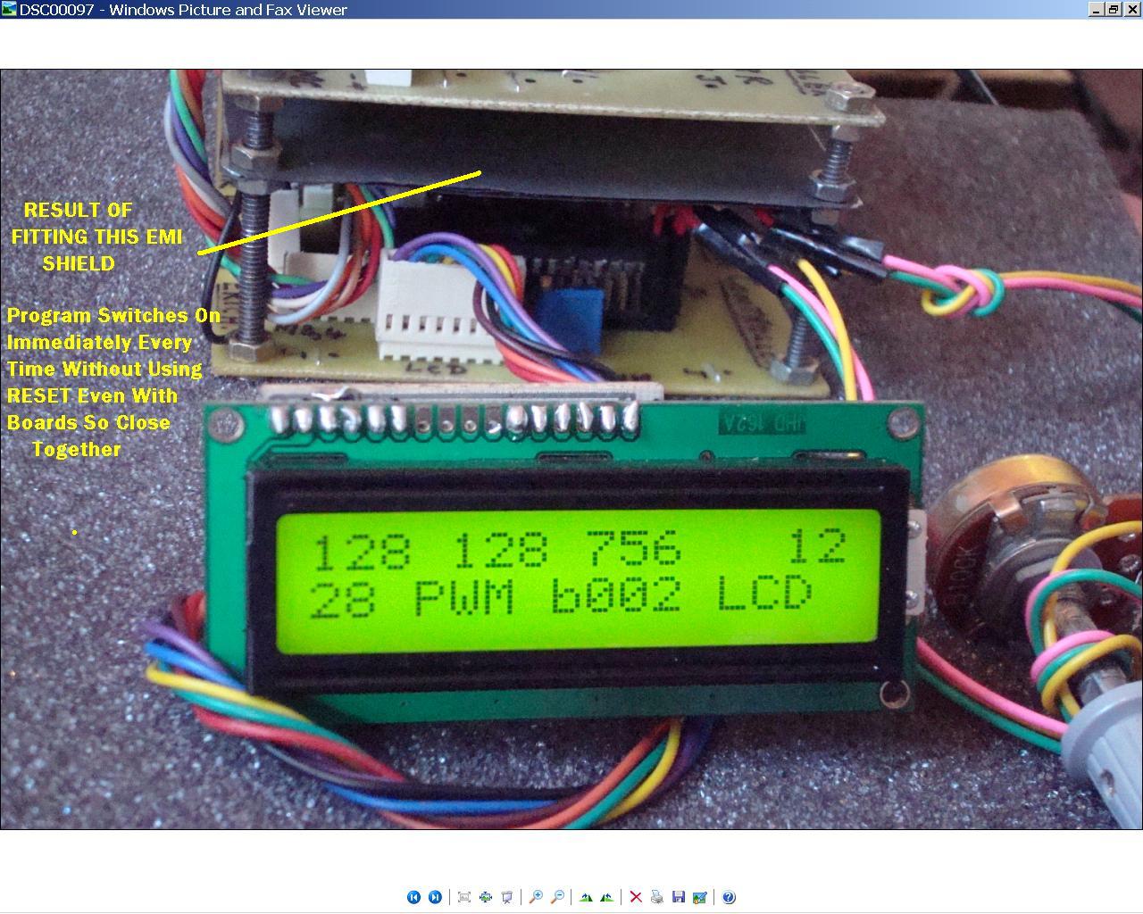

  7. tronicgr
    tronicgr
    Its better to build each to separate board as there is a chance that you will experience EMI noise that cames from the switching of the mosfets.
    Here is some photos from Erich's project that had to use shield between the two boards to get the AMC started properly.
    :brows:
    Regards, Thanos
