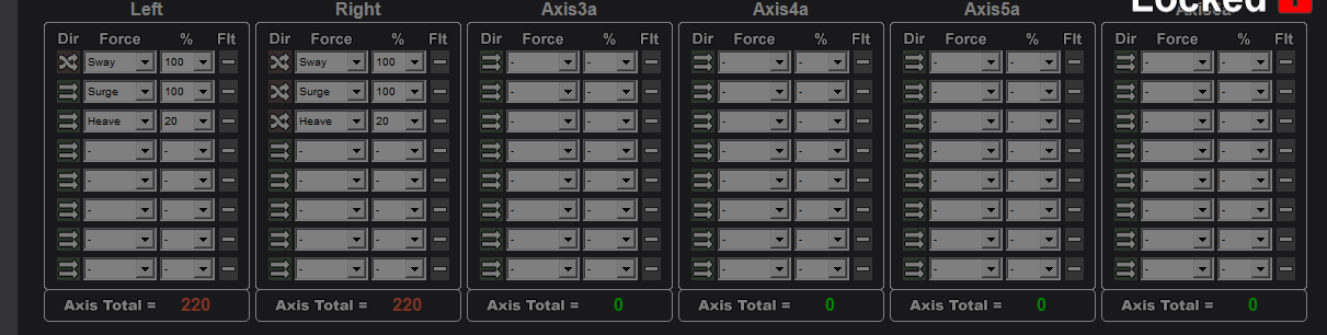

    Here are my settings. Is it what you want to see ?

    As an aside, your total axis allocation is very high: https://xsimulator.net/community/faq/axis-assignment-percentage-totals.120/

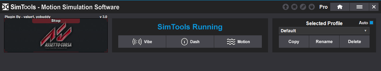

    Thank you so much for your help guys. It seems to work now. I just had to select the Default profile to make my Motion R move. I guess it was the thing to do.

    It seems to work. Apparently, I have to select Default in the Selected Profile.

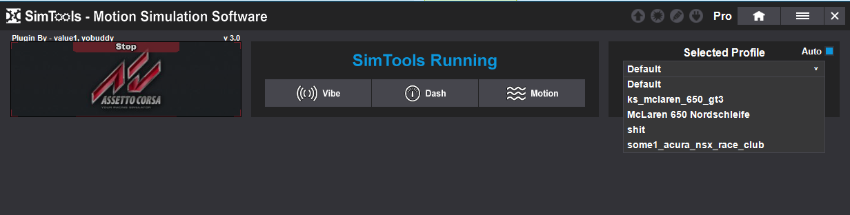

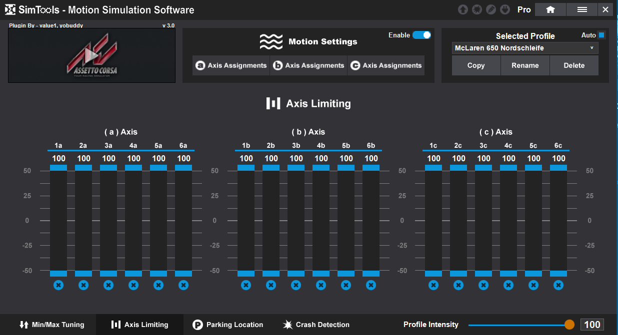

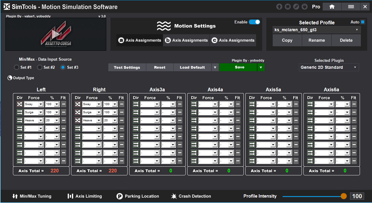

    actually, I play Assetto Corsa with Content Manager. In fact, the seat moves only when I select Default Profile. It doesn't moves when I select a profile that I have saved. Here are different captures of my settings in Simtools. Are the values in Picture 3 correct ? What values to set in picture 4 ?

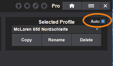

    My guess is the default profile is the only profile with axis assignments?
    Please uncheck Auto Profiling, and then select the Default profile, and you should be golden.
