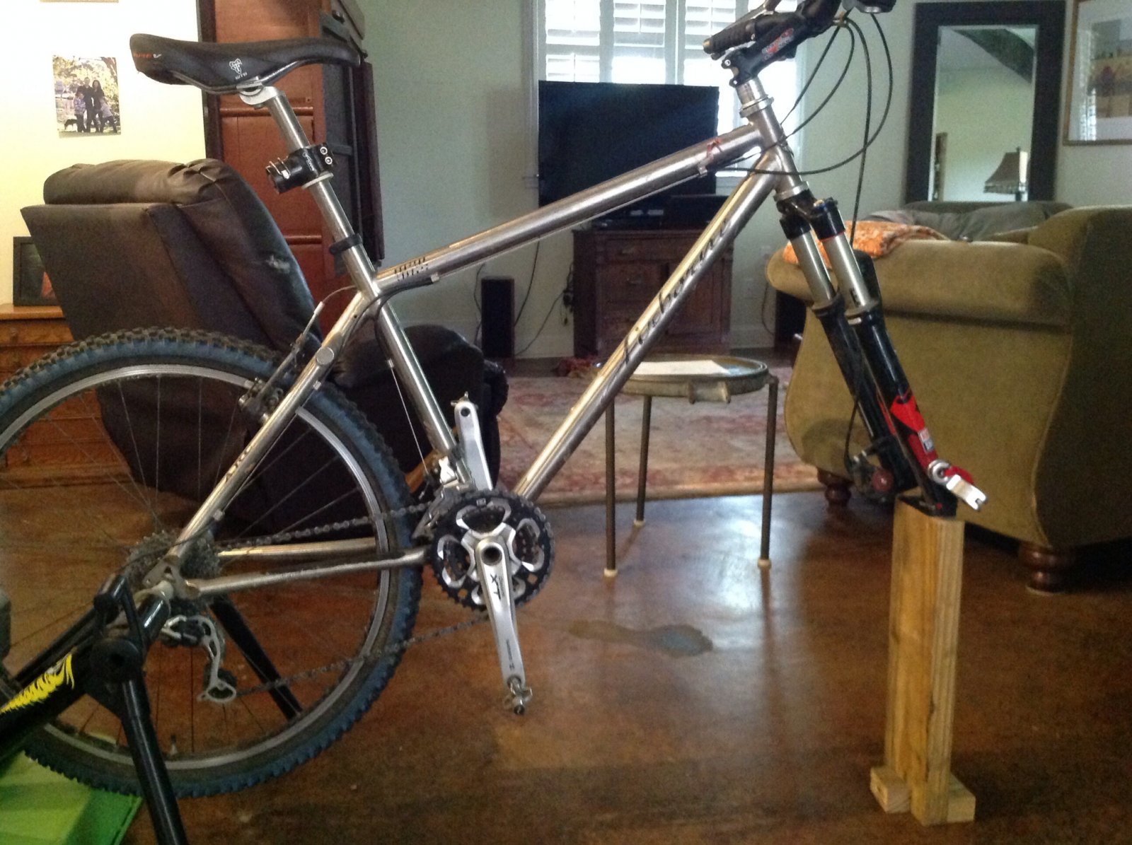

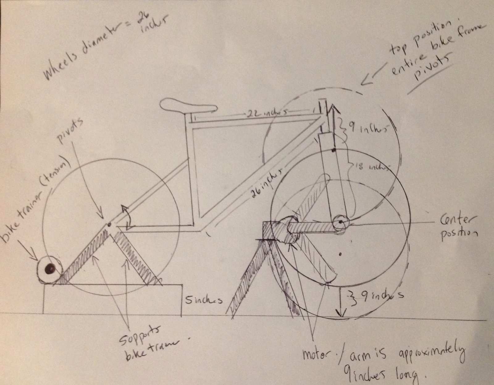

    Here's a very rough sketch, I hope it gives you all a bit of an idea what I am thinking. I will try to explain as it may be difficult to understand my notes.
    So on the sketch is a bike, the back of the bike sits on a platform bases about 5 inches off the floor. That base has a cycleops bike trainer attached to it. (The triangle are the steel supports). After rethinking this, I do not think I need either the cvjoint, full platform or motors on the rear. Instead I think I will have another support platform in the front where the two motors sit on - either side. There will probably be some flat steel rectangular rods that fix the front platform to the rear base.
    There is no wheel on the front, instead it connects directly to the motor arms on either side with a traditional style wheel lock (probably longer than normal to fit through the front shock and motor arms. The bike sits in regular riding position 9 inches off the ground, then the motor arm can rotate either up 9 inches or down 9 inches. The whole bike frame will pivot off the center of the back wheel, where the trainer is attached.
    Some things I am worried about would be stress on the motor arms with the weight sitting on it like this. Any thoughts or ideas? Thanks!

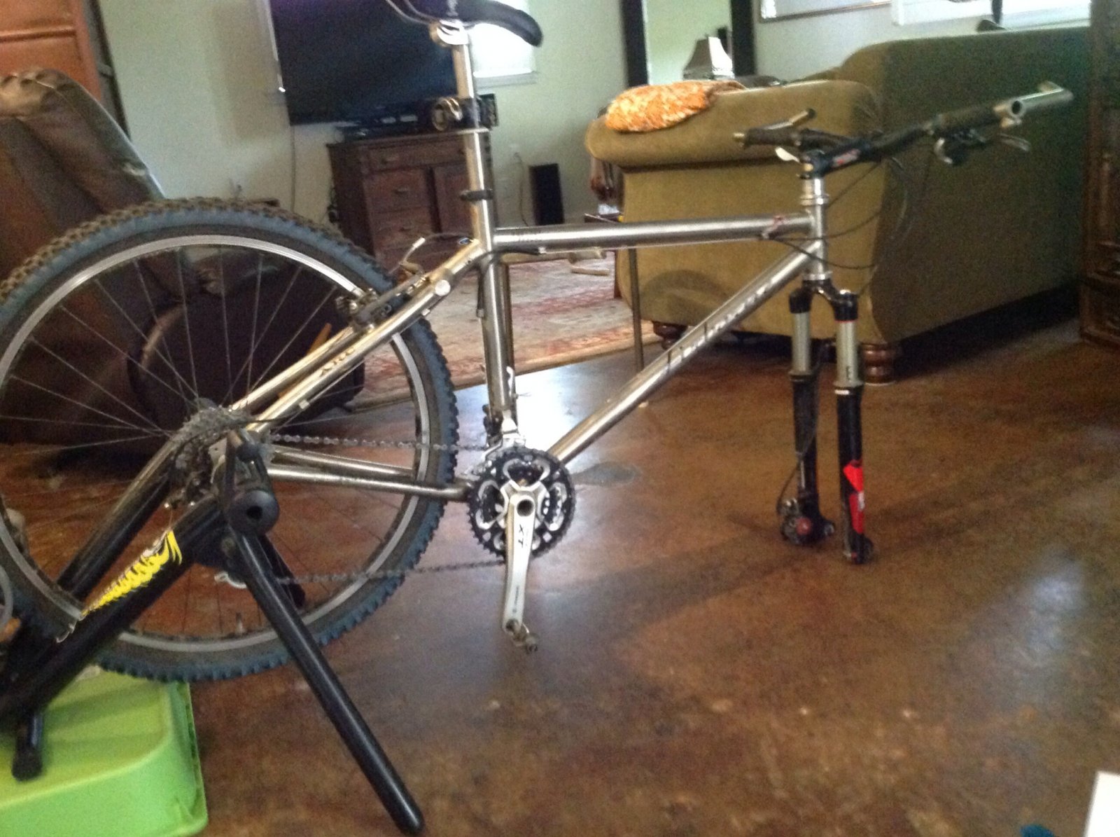

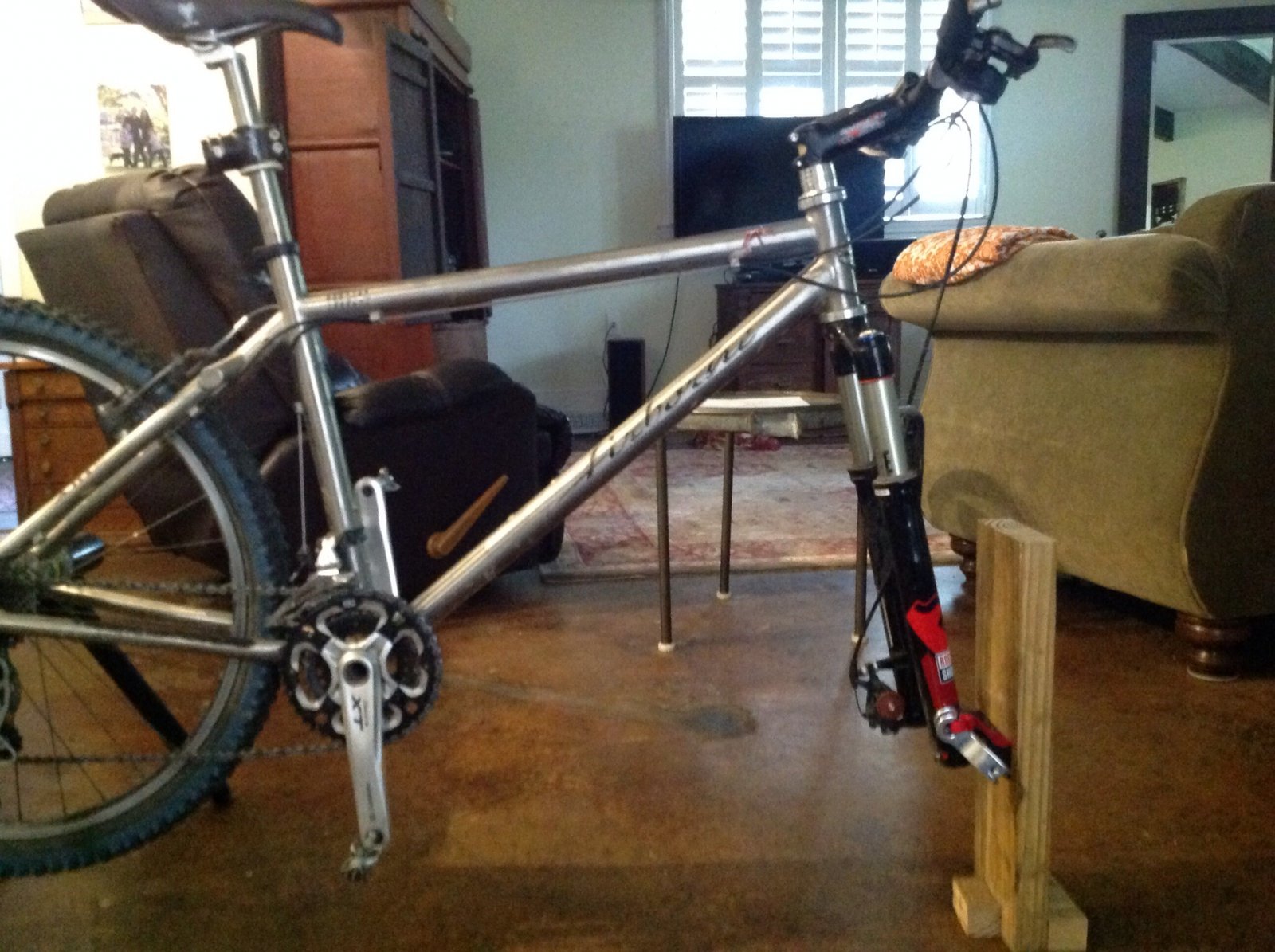

    Here is an idea what the bike would like in downhill height, neutral height and top/climb position. image.jpg image.jpg image.jpg
    Obviously I'm just toying around with the design at this stage.

    To get that sort of travel up and down you will need an actuator or 2, and I suspect you will have to build one. The BFF design does about 400mm total travel and uses a motor like you described, but I am not sure how well they would do on pure lift. If the frame was on a centre pivot to help hold the weight , they might do it.
    But the motors on their own will not.
    Also, simulation is a mind trick more than actual throw, although some will disagree. Its about what you see on screen in relation to the movement. For flight, yes a good amount on throw, for car race, a short amount.

    With your idea of design I would look into a gimbal system as your weight above the cg will increase the torque needed to move such a system. Basically thinking a bike in side a joy rider frame. Basically you will be able to balance the system so that sitting in centre and keeping dead still it should balance resulting in no weight on the motors and then all the motors have to do it move and hold it off centre and the design will help the sim self right itself back to centre.
    Pros - not as strong motors (actuators needed)
    - self balancing, and built right can be made adjustable for different size riders.
    Cons - a bit of a big in size build
    - may be a little awkward to get into. Value1 shows a better design for a joyrider style.
    Just an idea.
