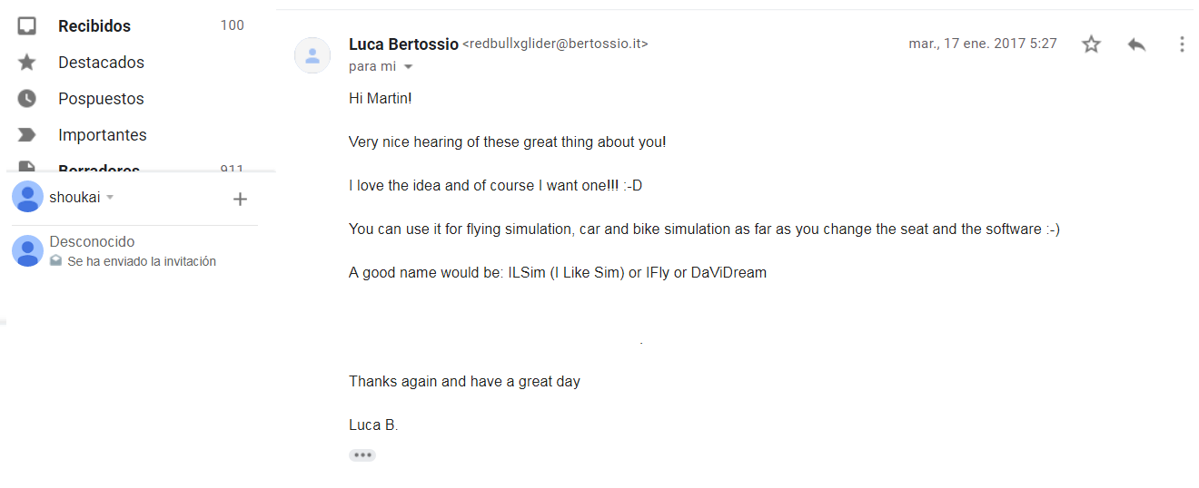

    Hello, everyone. I just remembered I once wrote to famous aerobatic glider world champion Luca Bertossio to share with him about my simulator platform and I thought I'd share with you what his comments were about this project. (see below) Best Regards

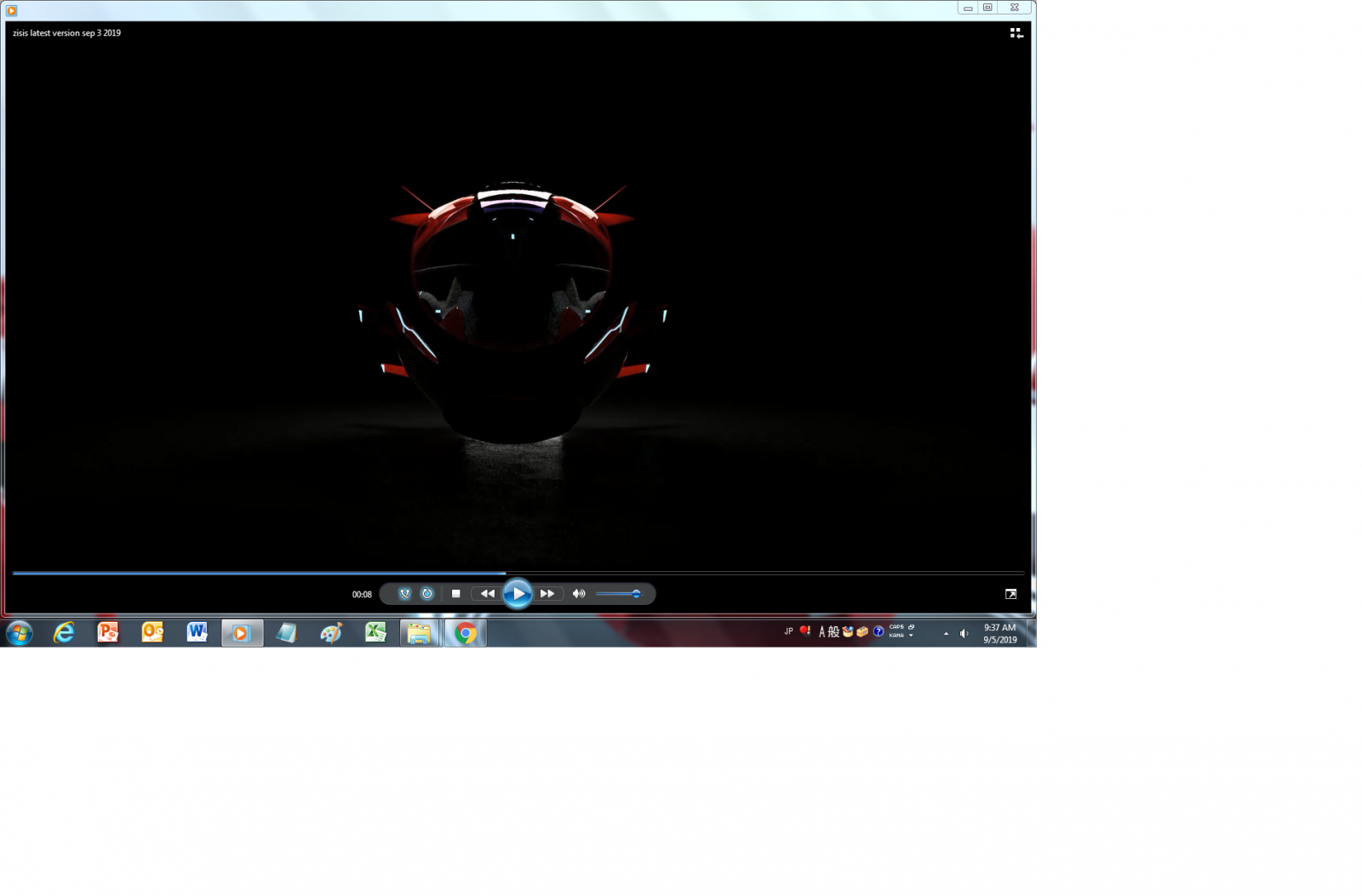

    Hello, Pilots! We have decided to Lunch a Pre-Kickstarter Campaign Promo. Here's the Link in case you are curious. Regards.

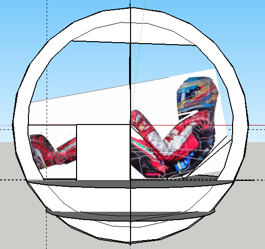

    What do you guys think about this position for the pilot, as far as comfort and center of gravity and other related aspects? Please, let me know your thoughts. Regards
