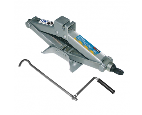

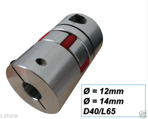

    Hey guys,
    The upcoming days I will try to add a 12V or 24V motor (both running on 12V) to a scissors jack:
    A flexible shaft coupling 12/14mm, 8NM

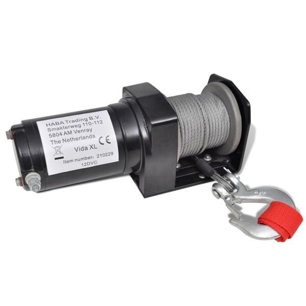

    a 12V winch w/o planetary gear:
    all the rest as usual, Arduino, VNH2SP30 or VNH5019 etc.

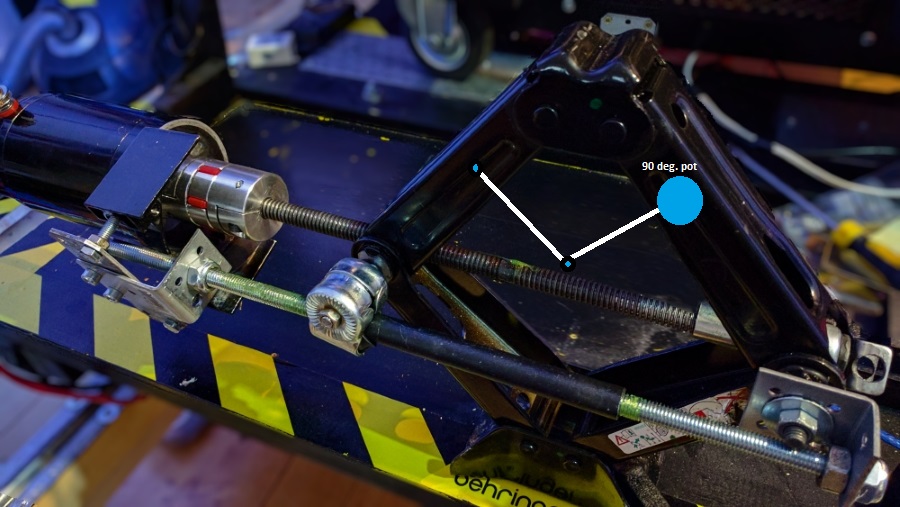

  6. Pit
    3,013
    30,416Coins
    +3,088 / 31 / -0
    First approach, still very early prototype and my second attempt. First I tried to add the coupler at the other end of the threaded rod, but due to the very bad welding of the Chinese scissors I had to tinker a new design. Tomorrow I will try to add the potentiometer. PS: I'm using a winch motor.

  7. speedy
    speedy Well-Known Member
    Feb 1, 2012
    1,193
    Alexandria , Egypt
    7,917Coins
    +1,285 / 10 / -0
    IMHO this is the best place ... to measure the angle :cheers .
  8. Pit
    3,013
    30,416Coins
    +3,088 / 31 / -0
    Thanks, eventually I will use a slide potentiometer.
  9. RandomCoder
    Feb 19, 2017
    185
    Control Engineer
    UK
    1,674Coins
    +142 / 0 / -0
    Or a string potentiometer would fit in nice there.... http://www.unimeasure.com/std-a.htm
    I've just done a quick search for "String potentiometer" across the forum and didn't find anyone advising against this type of measurement? If the spring tension is sufficient then it should give good results. But I agree if you can get a linear slide pot in there it would probably be better.
  10. Daguru
    Sep 4, 2013
    719
    Kitchen installer
    Wales uk
    453Coins
    +632 / 1 / -0
    Motion platform
    Hi @Pit could you replace the threaded bar in the jack with the ball screw type thread found in the diy linear actuator would be faster and smoother ?
  11. Pit
    3,013
    30,416Coins
    +3,088 / 31 / -0
    It's only for testing purpose, if I would build one for professional use I would use high industrial standard parts. But thanks for your suggestion anyway :)
  12. Pit
    3,013
    30,416Coins
    +3,088 / 31 / -0
    That's completely new to me. Slide potis are cheap and effective, unfortunately my 10 cm slide pot is not covering the full range. But almost...video tomorrow or after tomorrow.
  13. speedy
    Feb 1, 2012
    1,193
    Alexandria , Egypt
    7,917Coins
    +1,285 / 10 / -0
    I guess you can use those 10 cm with the linear up/down motion ... not with the lead screw .

  15. Pit
    3,013
    30,416Coins
    +3,088 / 31 / -0
    it works, but.........not really well. The scissors jack is just bs, weak, twisted, worthless junk. Though as far you can determine the concept of my (poor) design does it's job, pretty fast and very powerful.
  16. SeatTime
    28,370Coins
    +2,844 / 38 / -0
    Nice proof of concept, but just like EBay actuators, they just fall apart. Look forward to see were you go with this - maybe a DIY properly made ballscrew version :think.
  17. Pit
    3,013
    30,416Coins
    +3,088 / 31 / -0
    Agree, I'm tinkering with it :), just looking for the parts where to get.
