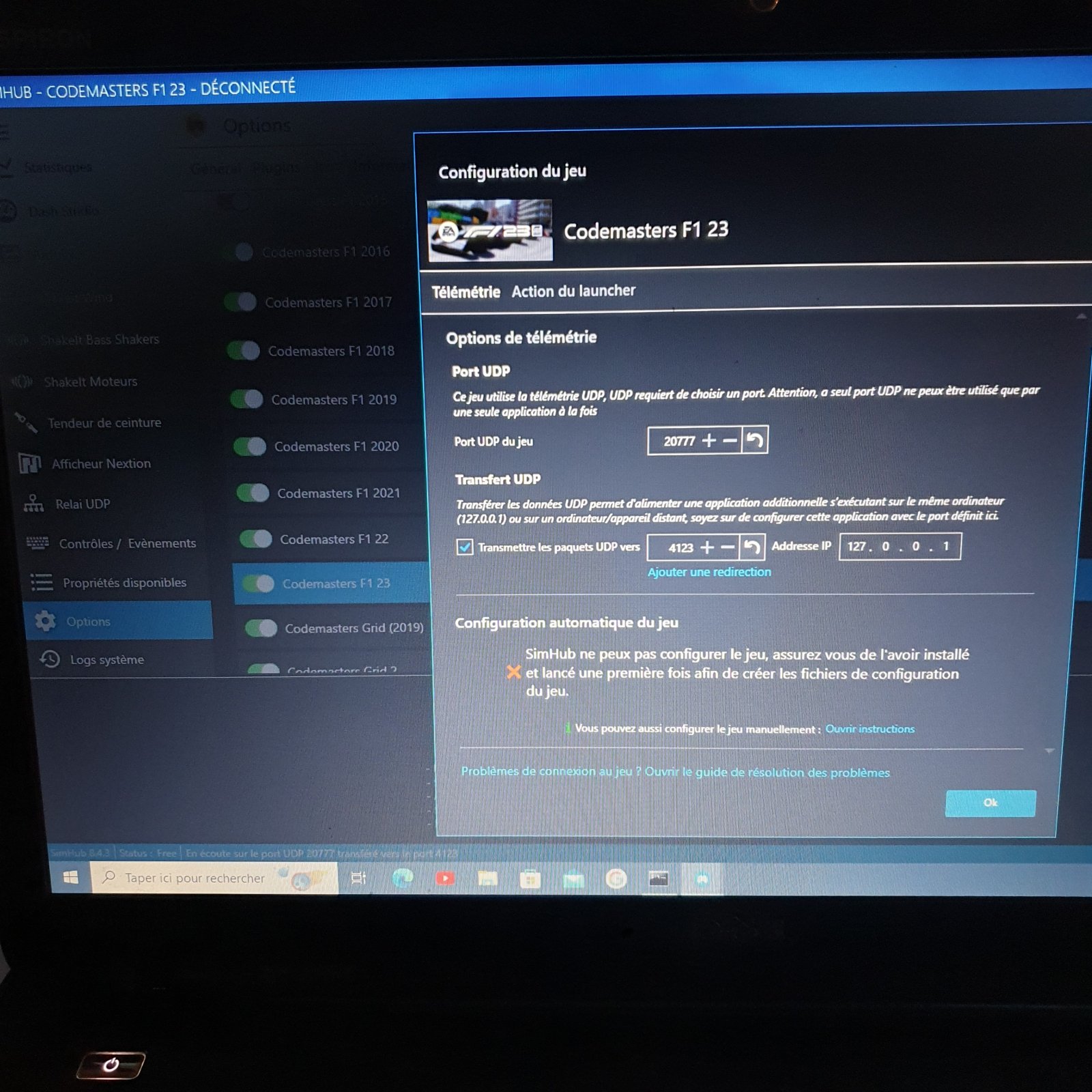

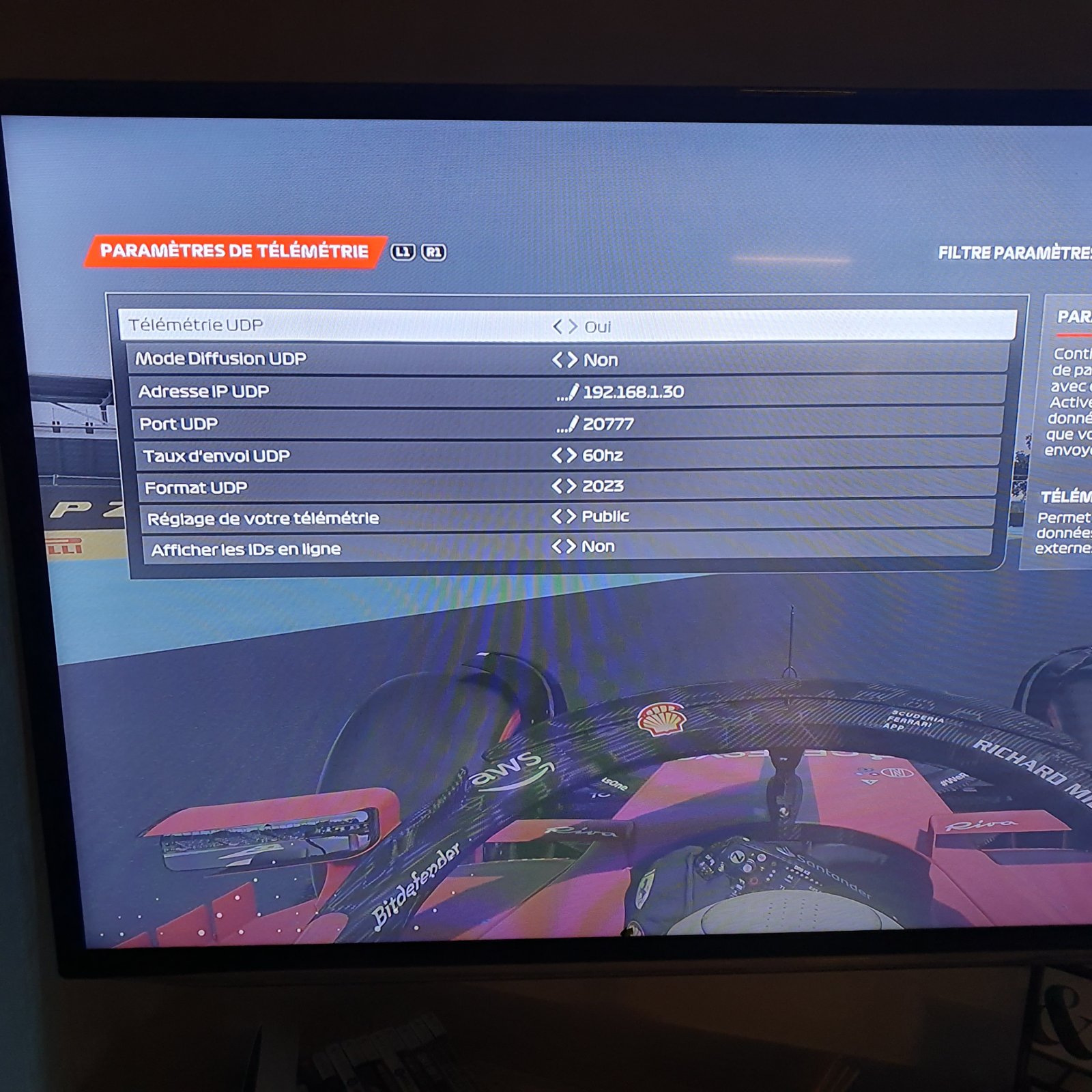

    hello, I have just created my 4dof simulator, I started testing with my PS5 console and the F1 23 game (it will be the same with a PS4). Here are the parameters that I adjusted in the telemetry menu of the game (you must enter the IP address of the computer where simtool and simhub will be installed) yes I use simhub to serve as a gateway to send the data to Simtools.

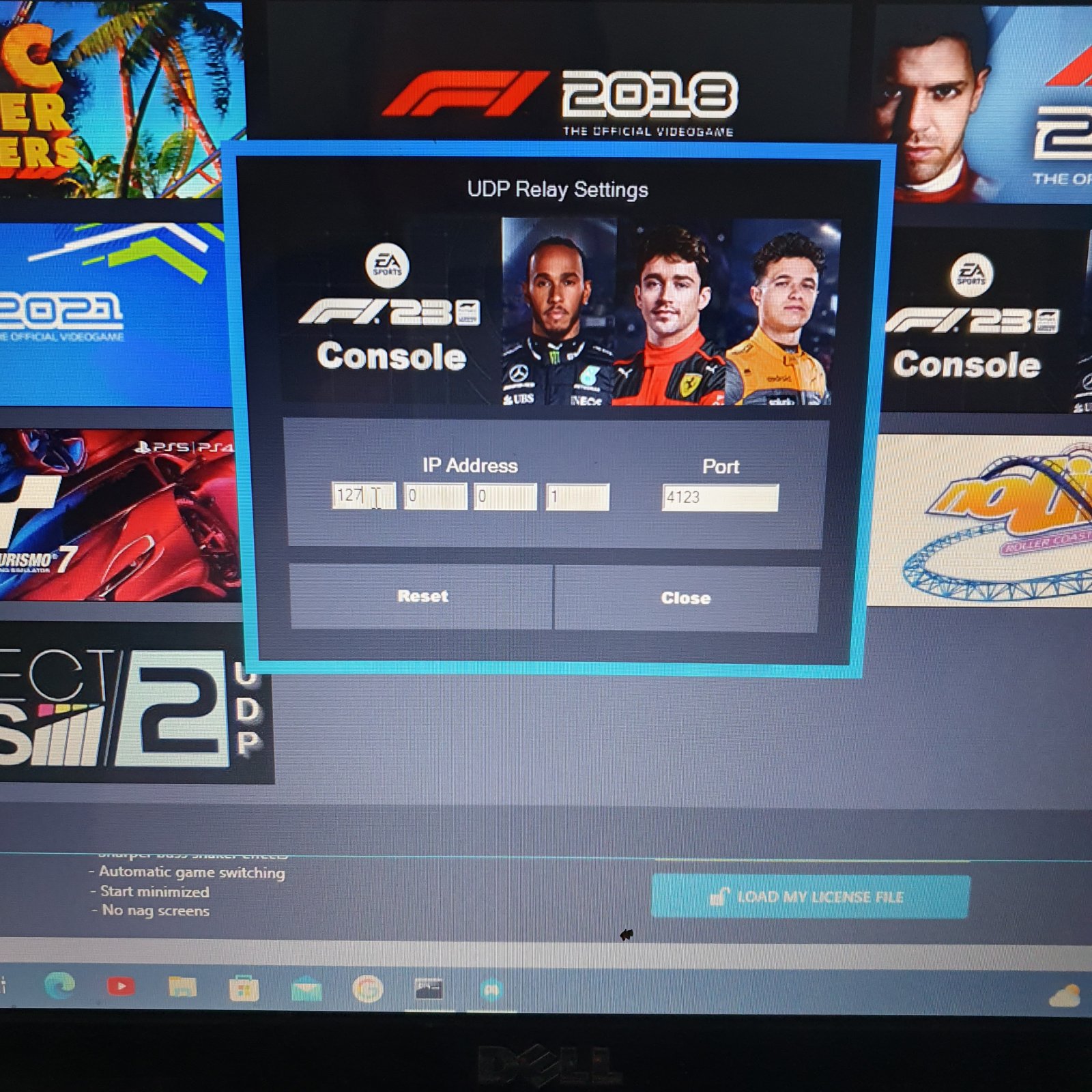

    I am using simtool V3 and I set the address IP (see photo)
