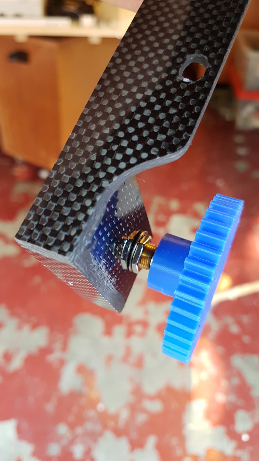

    I also use gears. my gears are roughly 4:1 on my pgsaw motors (63:16 tooth) so +/- 40 degrees from centre point gives me roughly 300 degrees of pot travel. I do this so the smc3 receives the full 1024 points of resolution from the pot. I may be wrong but surely if I directly mounted those pots on my motors wouldn't the smc3 only see 256 points of resolution from the pot as im only using +/- 40 degrees of motor travel. When the smc3 outputs the 8bit pwm signal to the motor drivers wouldn't that pwm only have 63 points of resolution instead of the 256 that I get with the gears. maybe noorbeast could explain this better but if I can ditch the gears on my motors it would make for a more compact motor setup for me anyway

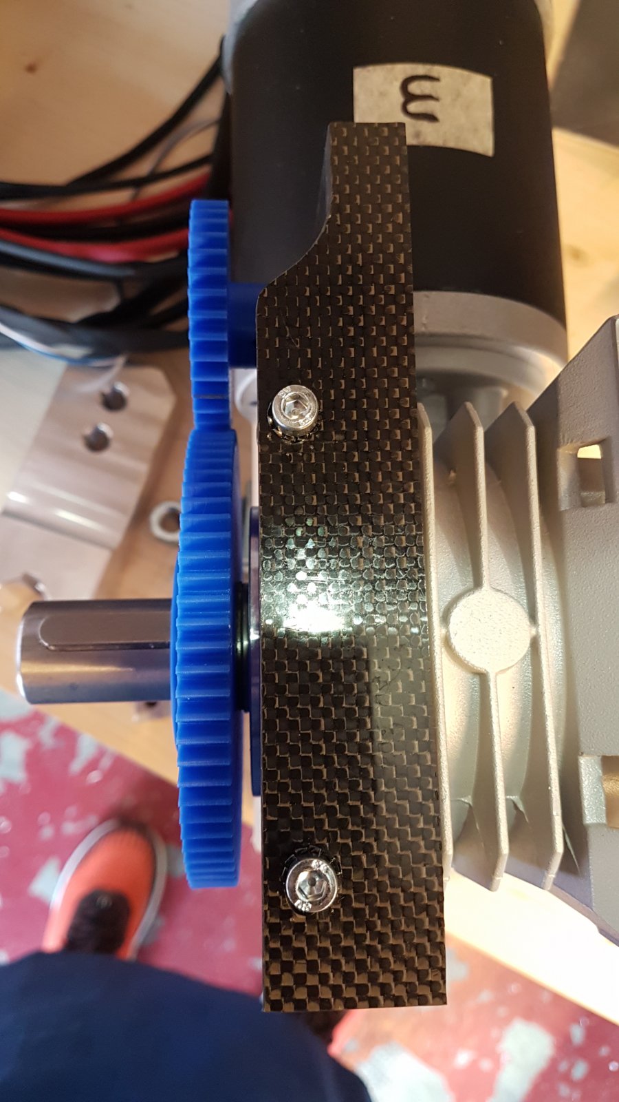

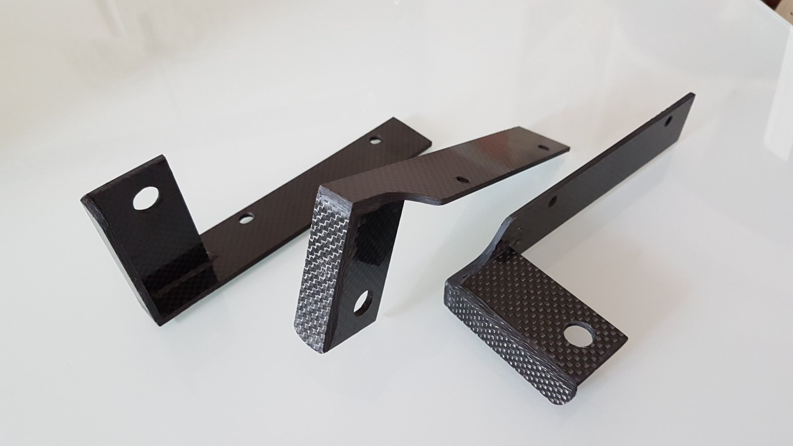

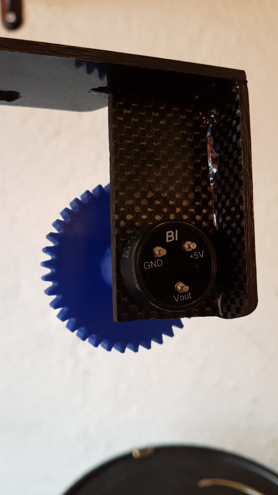

    I had a remnant of a 3mm carbon plate and I thought I'd create the potentiometer mounts.
    Here is the result.

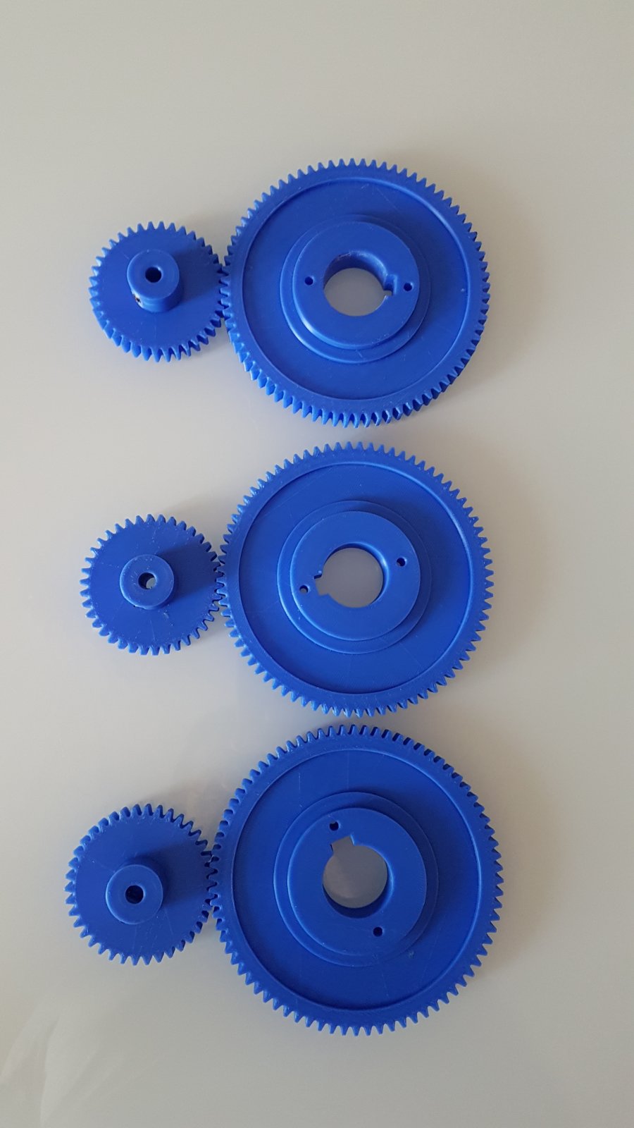

    I already have a prototype of the gears that will arrive in a few days.
    The prototype of the gears helped me to size the support, which was not easy to create.

    Hello Yellofella,
    my gears will have a 2: 1 ratio.
    76 tooth engine gear, potentiometer gear 38 teeth.
    I would like to use an angle on the engine of about +/- 75 degrees, tot 150 degrees.
    With a 2: 1 ratio I will have a potentiometer that covers me 300 degrees.
    150 degrees are many, they usually use 120 degrees (I like movement a lot), why do you use only +/- 40 degrees?

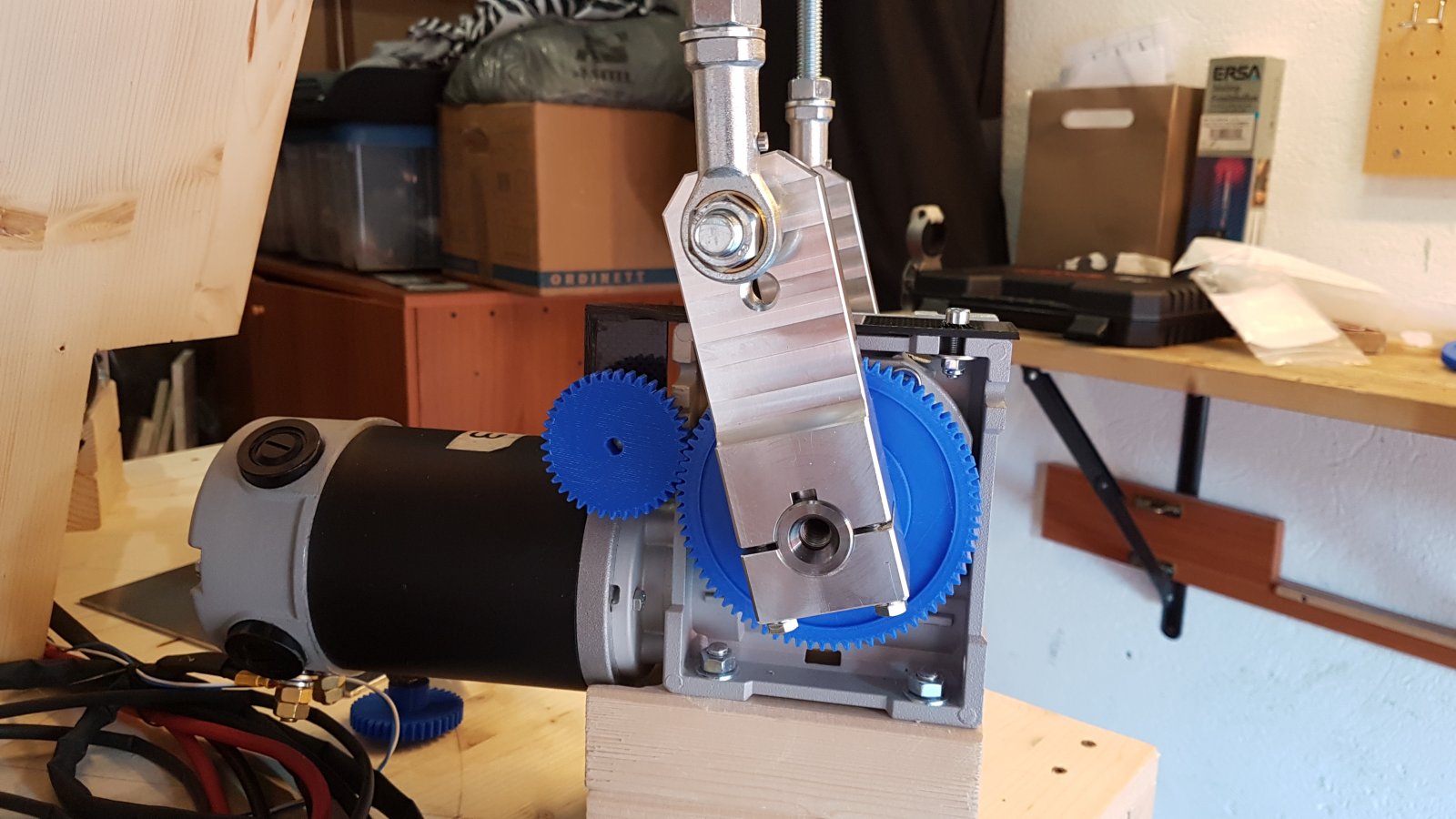

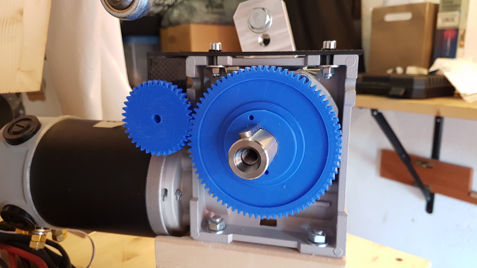

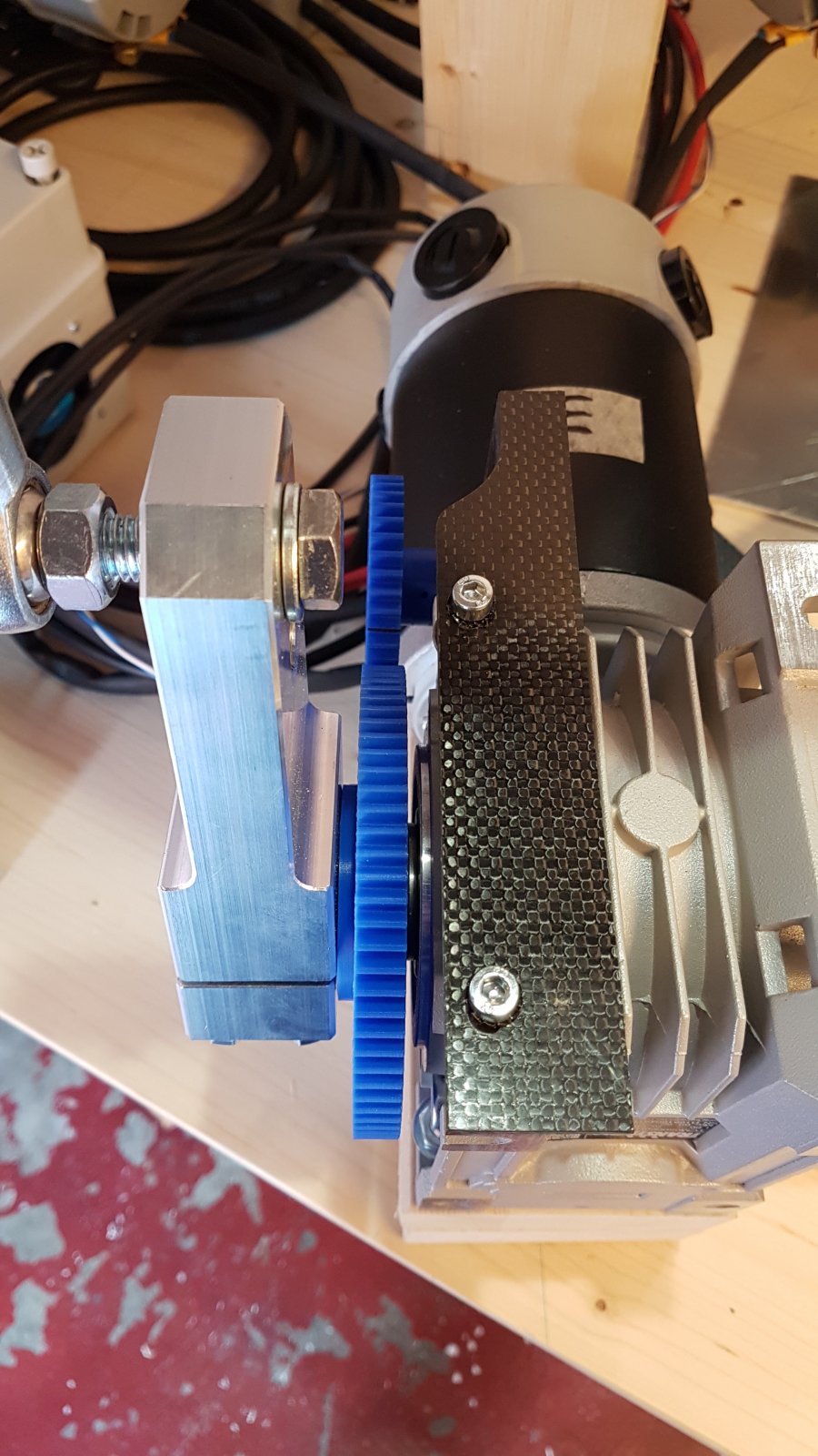

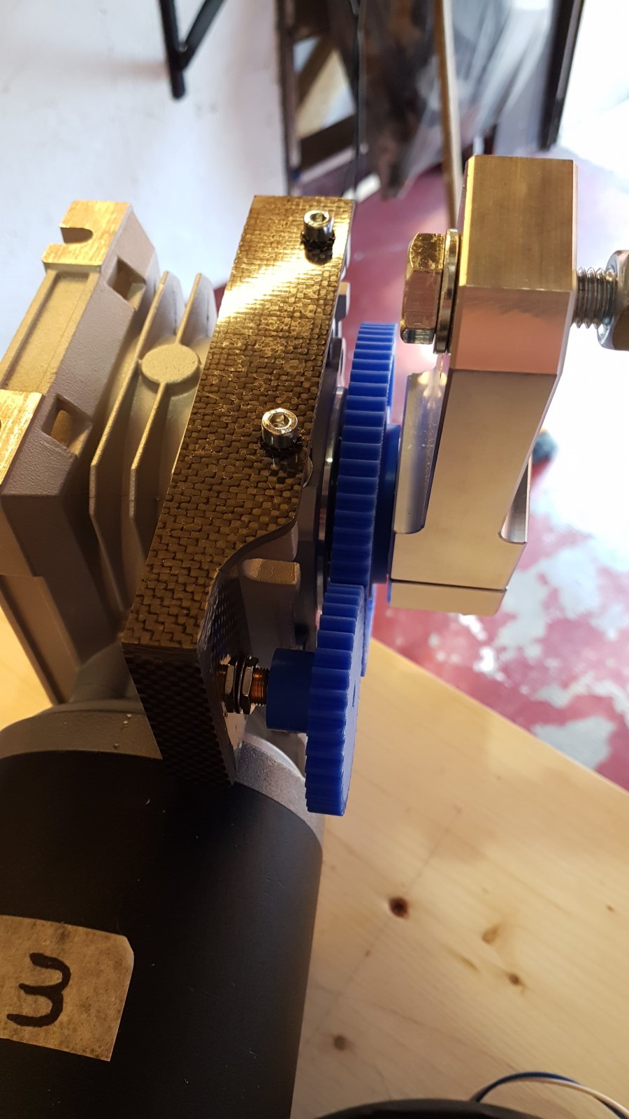

    The gears have arrived.
    Potentiometer support gear assembly
    Motor gear assembly plus potentiometer gear
    Alignment.
    I think it was a great job.

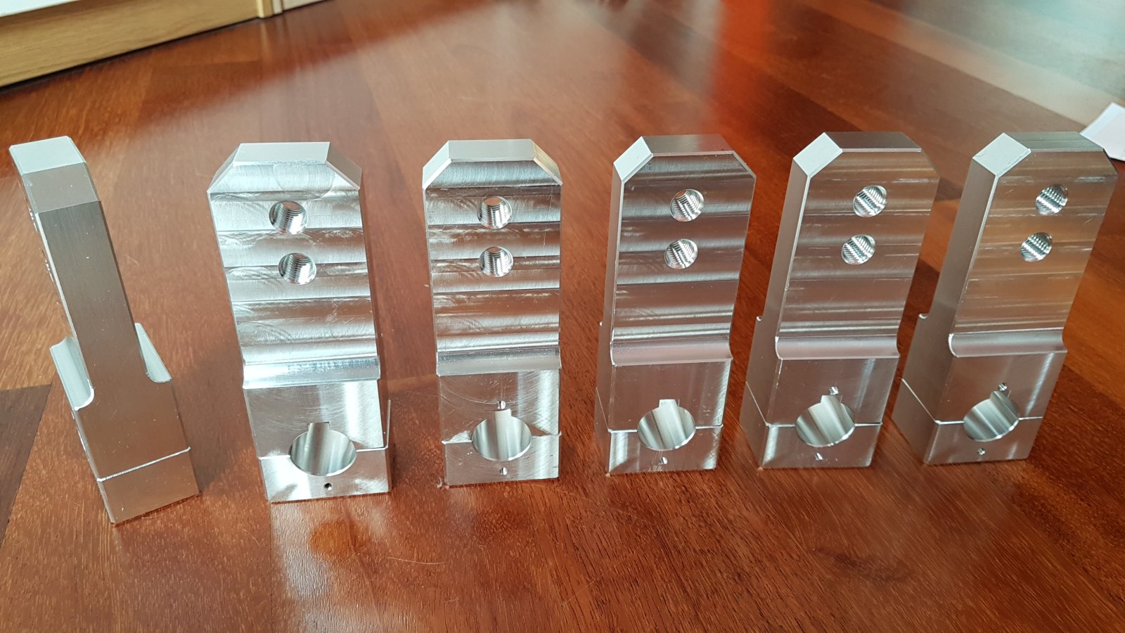

    Looking good mate. I really like the milled aluminium leavers and the carbon fibre pot mounts are a nice touch as well. Looks like a good sturdy motor setup with very little backlash on the pot gears so should work great with a well written motor profile. Are you considering mounting the motors on a aluminium profile or welded steal base at some point?
    Keep up the great work

    Thanks Yellofella,
    It seems simple, but for me it was challenging to size the supports of the potentiometers in relation to the size of the gears .... I remember that I am not an engineer and I do not use softwere for drawing ..... only paper and pencil ... .

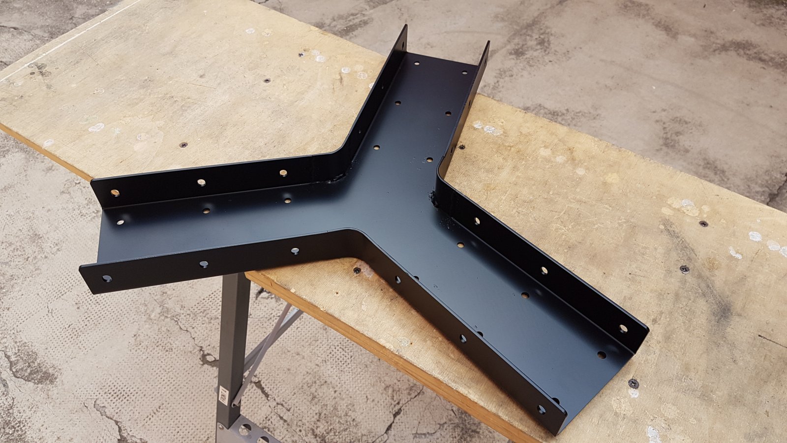

    Hi Sean,
    the base measures 90 cm x 90 cm.
    The distance of the motors on the center axis forms an equilateral triangle of 60cmx60cmx60cm

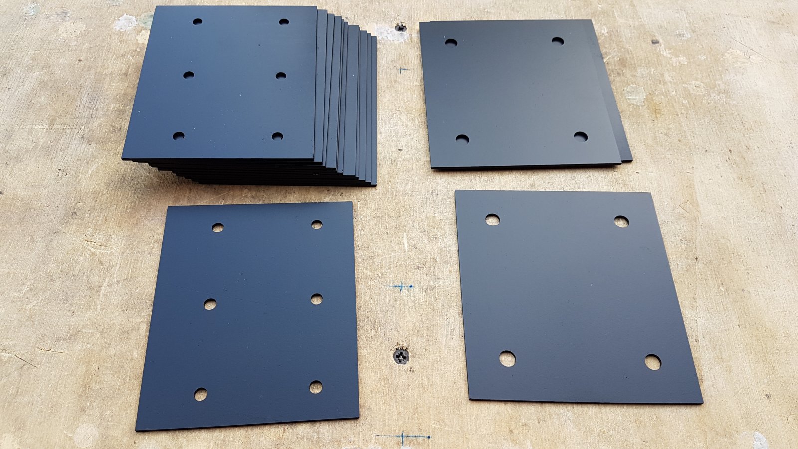

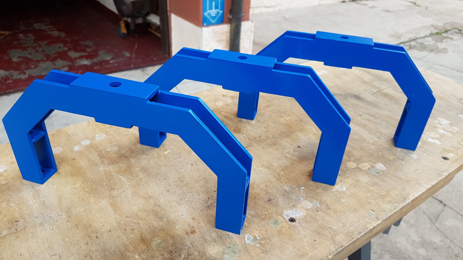

    Ready some parts for definitive basis.

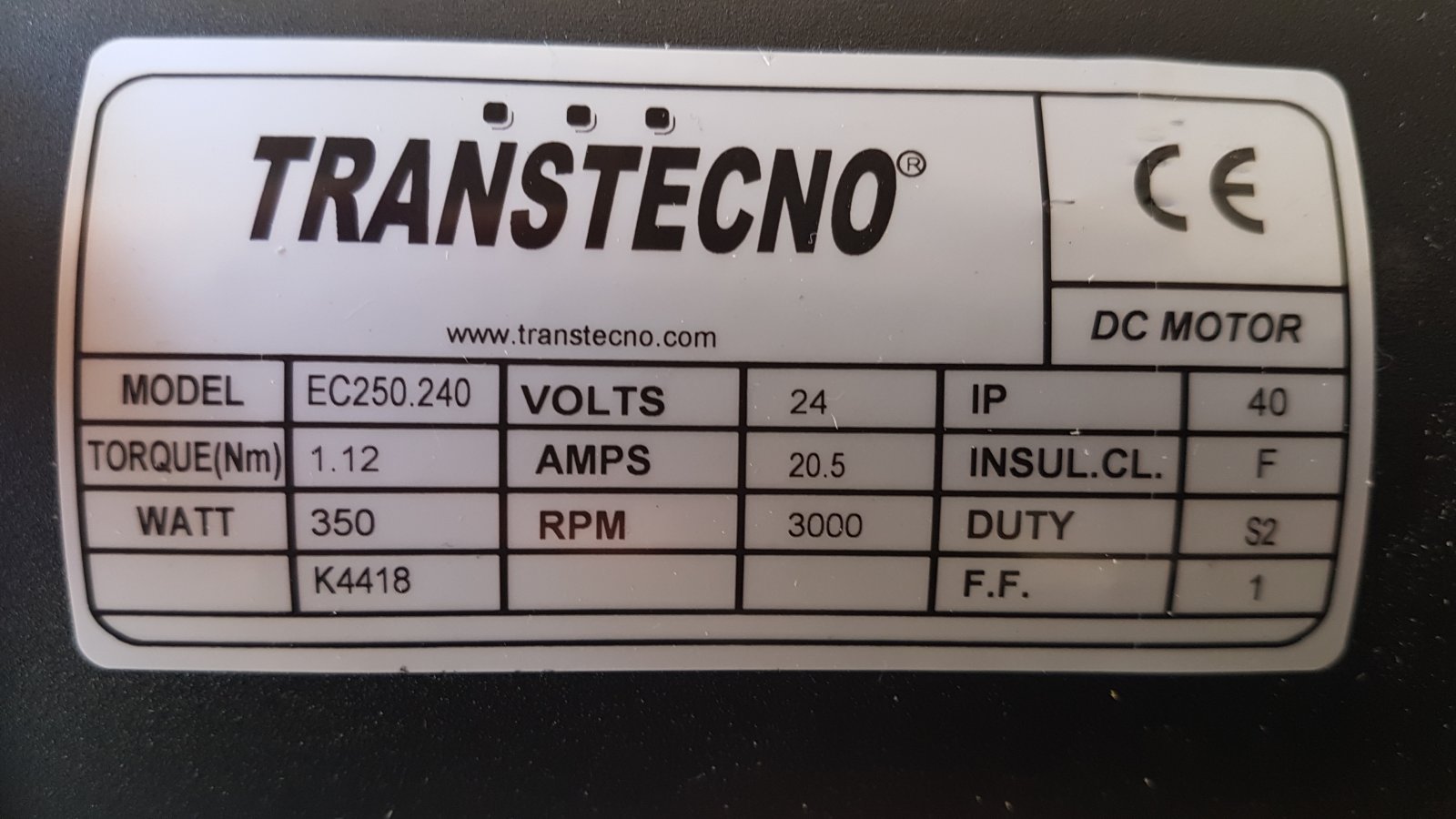

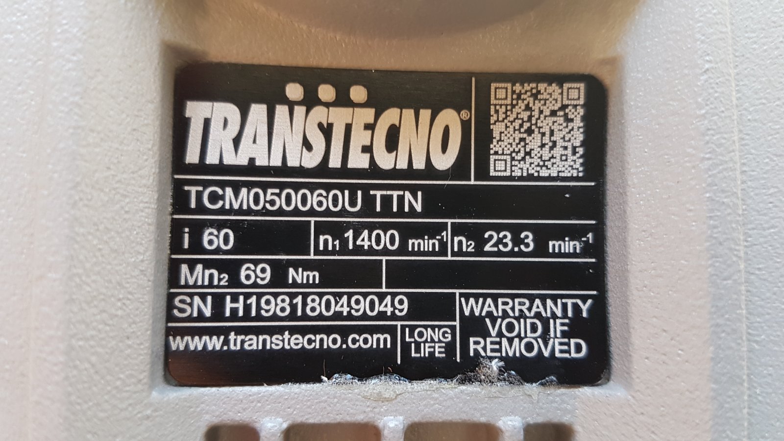

    Great looking sim - in the distant future I'd like to build something similar. What gearboxes are you using? What is the output torque and RPM?
  20. Milani Fabio
    Milani Fabio Active Member
    Feb 21, 2019
    105
    Italia
    716Coins
    +74 / 2 / -0
    My motor:
