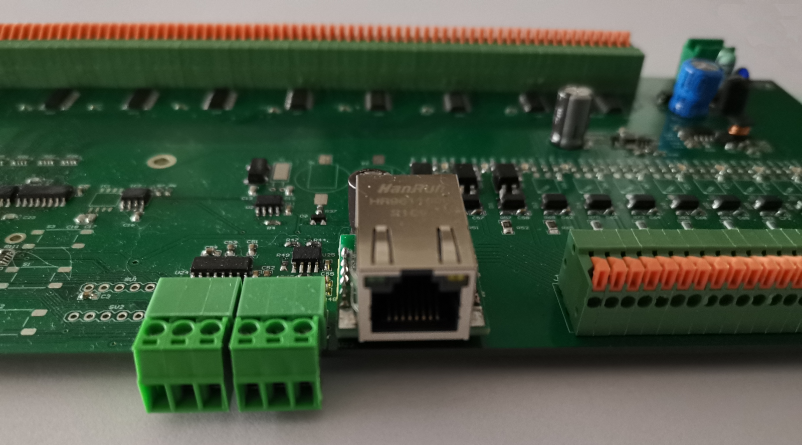

    Hi everyone,
    I'm a simulation enthusiast and I'm building a controller board for motion platforms on my own.
    Characteristics:
    Power supply +12/24V.
    High-performance 32bit MCU 120Mhz.
    Capability to handle up to 12 actuators (pulse/dir), up to 12 inputs, and up to 16 digital outputs (open collector).
    Two serials (one RS232 and one RS485) and one Ethernet port.
    Possibility to expand the functionality with exp. boards.
    Those who are interested can contact me in PVT even because the electronic shortage

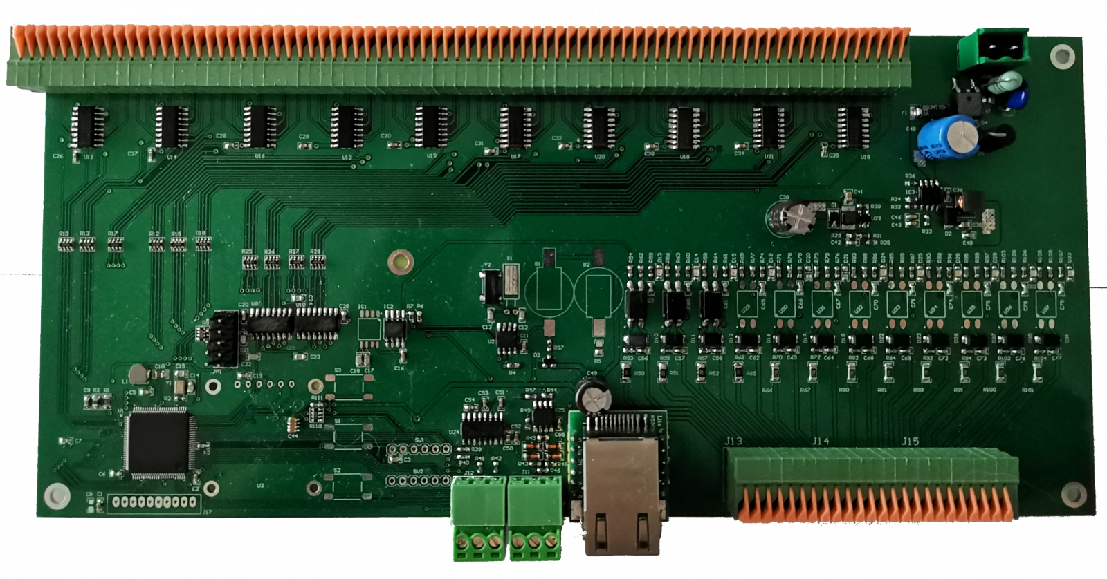

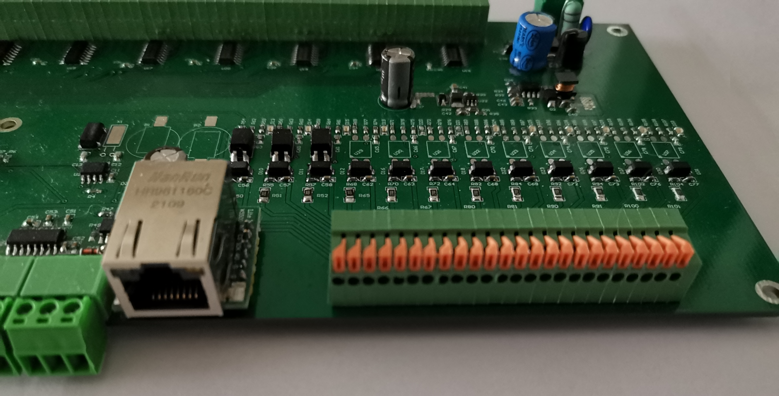

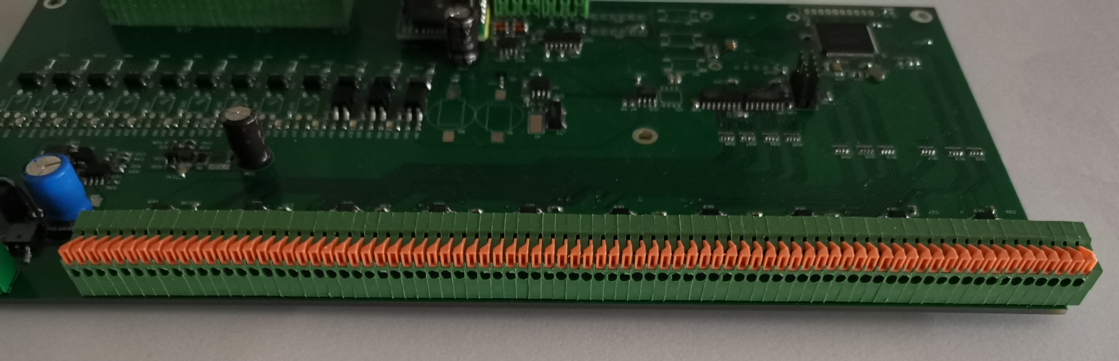

    These are some pictures of my controller. For those are interested

    Your controller board looks interesting! Pls. can you give us some more information, especially how to wire things, what motors/motor driver can be connected, which functions does the controller have? Can it comminicate with Simtools or the "mover interface" from @pmvcda,....

    These are some specs of the board but, if you have some suggestions, they are welcome.
    Motion Card 1.0 Specifications:
    - Power supply +12/24 Vdc.
    - Up to 24 differential output.
    - Up to 12 optoisolated inputs 12/24V.
    - Emergency function capabilities.
    - Fast 100 Mb ethernet port.
    - 1 RS485 port
    - 1 RS232 port
    - OLED display
    - Support FlyPT mover
    - Support DIR/PULSE motor drive
    Motion Card 1.0 Features:
    - Serial or Ethernet interface
    - Very low latency <1 msec - 500 Khz max pulse rate
    - Software endstop
    - Spike filters
    - Parameter modification from PC software (coming soon)
    - auto home calibration (with endstop)

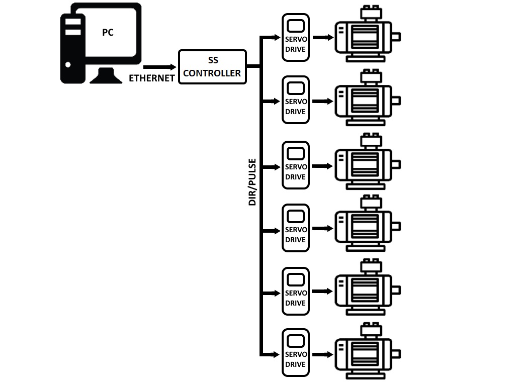

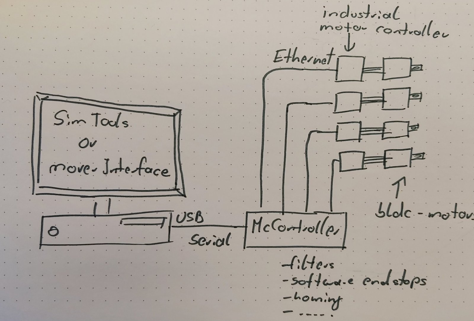

    I am still not sure, whether I understood your controller correctly. So here I made a sketch how I understand the function and use of your controller:
    If you make it possible to connect a PC with SimTools or mover-interface running to an industrial motor controller, then I think you will open a new chapter in DIY-simbuilding!
    My wishlist:
    - usable also for software-noobs like me. So no need to study programming
    - support for different optional interfaces/protocols for industrial motor-controllers
    - Good and easy user interface
    - good manual
    - not tooooo expensive:grin

    I have thought that the board-to-driver ethernet connection is not an easy and flexible solution like DIR/PULSE or the analog (the board has also analog signals +-10V capabilities with an opportunity expansion board that will come soon).
    There is also a latency problem on protocols like the Modbus or similar (tested yet without good results).
    Answering your welcome advice:
    No programming skill need, the parameters are not much and will be available a graphics interface soon for the setup
    Will be available the customization input protocol in order to accept industrial systems inputs even though is not easy, need time to collect and implement all protocol where possible but is projected to use the board for industrial purpose
    This is on progress developing
    - good manual
    The goal is that the UI will be so intuitive that the manual should be a quick help in the software itself
    This is the first target of our job, We would like to stay under the 150$ better closest to 100$

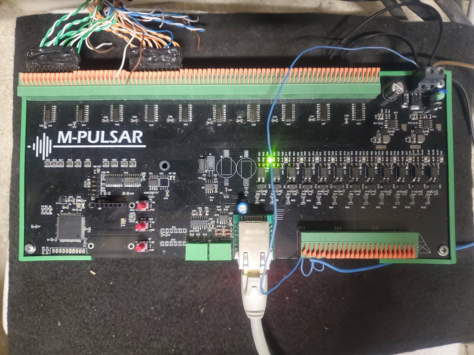

    The last and definitive board's hardware. Now hard working on the firmware. The member
    "Marco Annunziata"
    are cooperating with us testing, giving feedbacks and suggestions. At the moment the basic firmware release seems working fine

    Controller board working demonstration
