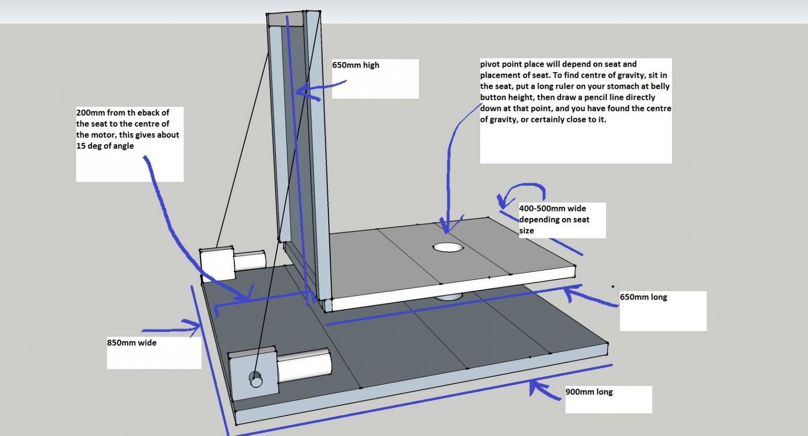

    Hi guys, im new on here and im just about to start my 1st build of a 2DOF motion sim. Just a quick question, are there any specific wiper motors that are best for the job?

    Hello Nath!
    You have first to determine what kind of simulator you intent to build: flight sim or race sim? or more tricky both!
    2DOF: so we dont speak about traction loss, heave effects.
    The actuator choice comes after this ;-)
  3. bsft
    As Mat has said, do you have a design in mind, that will affect the choice of motor.
    Wipers, generally a large passenger car will do, but earth isolate the wipers
    Or use these bigger motors, which are faster and stronger http://www.motiondynamics.com.au/worm-drive-motor-12v-24v-200w-180-rpm-20nm-torque.html , already earth isolated, or source a similar motor via ebay, maybe this one http://www.ebay.ca/itm/GEAR-MOTOR-1...ILLCRAB-POT-PULLFEED-150160-rpm-/370915744975
    And the Pololu JRK is the easiest to set up, granted they cost a bit more though than Ard and hbridge.
    http://www.pololu.com/product/1393/
    Cheers, David.

    Hi guys, im looking at a racing sim. Mainly for playing rFactor. After looking at the prices of the SCN5 Actuators, I quickly decided that the wiper motor route would be the way to go. I have seen a few guides and videos on youtube and they look very good for a fraction of the cost.

  12. bsft
  13. bsft
    Have a dig through the threads and ask questions, there are a lot of good builds out there.
  14. bsft
    does this help?

    Thanks, I think The rig itself should be simple enough, especially with all these project plans to follow. The electronic side is the part im worried about mostly. Looking at what iv seen and been able to find, the Arduino Uno R3 along with a Monster Moto Shield and as for a Arduino code, im thinking the code that Historiker mentioned by Rufus Dufus

    If I went with the Monster Moto Shield, Im now looking at a pair of new Worm Drive Motors, does anyone have any Motors in mind from the UK. I dont mind spending a bit on the right motors. as I see the motors being the most important part.
  17. bsft
    look up motion dynamics in the UK, they have their own 12v 200 watt big worm gear motors.
    The ard and hbridge setup is not that complicated, but if you are concerned, look into the JRK then, Yes it cost more, but a bit simpler and easier to set up.
