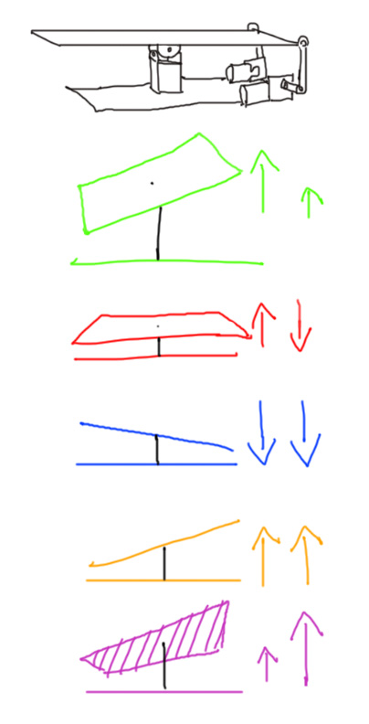

    Phil here, looking to start a new motion platform build and want to make sure I'm understanding the core concepts correctly thus far.
    I think 2dof will suit my purposes, as if I'm not mistaken I can get pitch and roll simultaneously with 2dof, I've attached a crude mock-up of the initial plan showing a combination of motor directions and resulting platform angle, if folks could let me know if this is off in some way that'd be great.
    Are mounting holes the only reason some motors come in left and right versions? For the motors I'm looking at, I don't see any mounting holes so I'll have to make brackets I would think.
    Components
    2x - 12 Volt Gear Motor, 150 RPM, 25/1, 180 W, 30-40 NM
    2x - Linear 10k Pot
    1x - Monster Motor Controller Shield
    1x - Arduino
    As I understand it, not counting additional software the arduino reads the pots for motor position and then sends a PWM signal to the moto shield for each motor, the PWM determines the speed of the rotation and duration of the PWM signal determines the amount of rotation, since the rig should only use a quarter or so of the motor's rotation how does one avoid over torquing and destroying the pots? Also, any leads on an appropriate power supply easily available in Canada, as well as safety features I could build in, that'd be great!

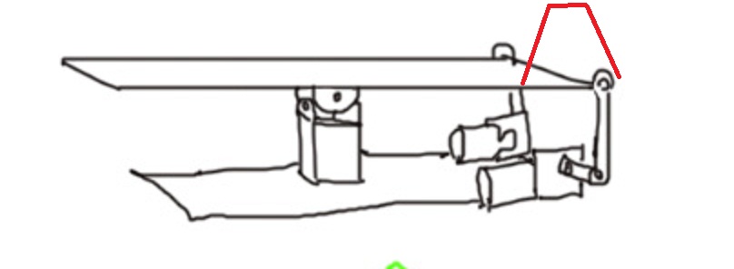

    Sorry but your motor position is in the worst case scenario , your motors will have to work too hard to gain any real fluid or sim comparable motion. specially with 25:1 boxes, it doesn't work. People have tried this and it fails badly , again Sorry.
  14. bsft
    @substatica , I agree with Rob, your kid and your weight are two massive differences.
    If you develop a code that gently rocks the kid, then yes, but DO NOT put a race track through it or even a roller coaster.
    Also, design is bad, after 14 designs, depending on how much overall weigh you plan to put on it, you will have to move the motors to connect a lot higher, like a foot motor mount or shoulder mount at rear.
    You could use 50:1 or higher boxes and use like a taller desk racer mount on the side, but again, platform design needed.
    People have done this sort of design over and over and they eventually had to rebuild and or re-design. Even me.
    I have pictured a foot motor mount, where obviously your feet would sit, so make the motor connections are higher than your toes.
    This keeps the design compact and will perform better.

    So you're both saying I need the arm mounts on the platform to be higher? This build will not be for me, just the kid, I may re-purpose the setup later for a chair. I also asked the motor seller if they could send me 50:1's which they also offer instead of the 25:1's I won the auction for.

    @substatica , if its for your child, then yes 25:1 and the current frame design will be fine.
    Its just later if you plan to convert it for yourself, then you may need to look at frame re-design and different gearboxes.
  18. noorbeast
    21,724
    152,057Coins
    +11,063 / 56 / -2
    It would help greatly if the connection mount is about seat swab height. This is my compact sim and it is now running 60:1 gearboxes, as 25:1 were not up to the task: http://www.xsimulator.net/community/threads/dx-racer-compact-simulator.5866/page-7#post-67552
