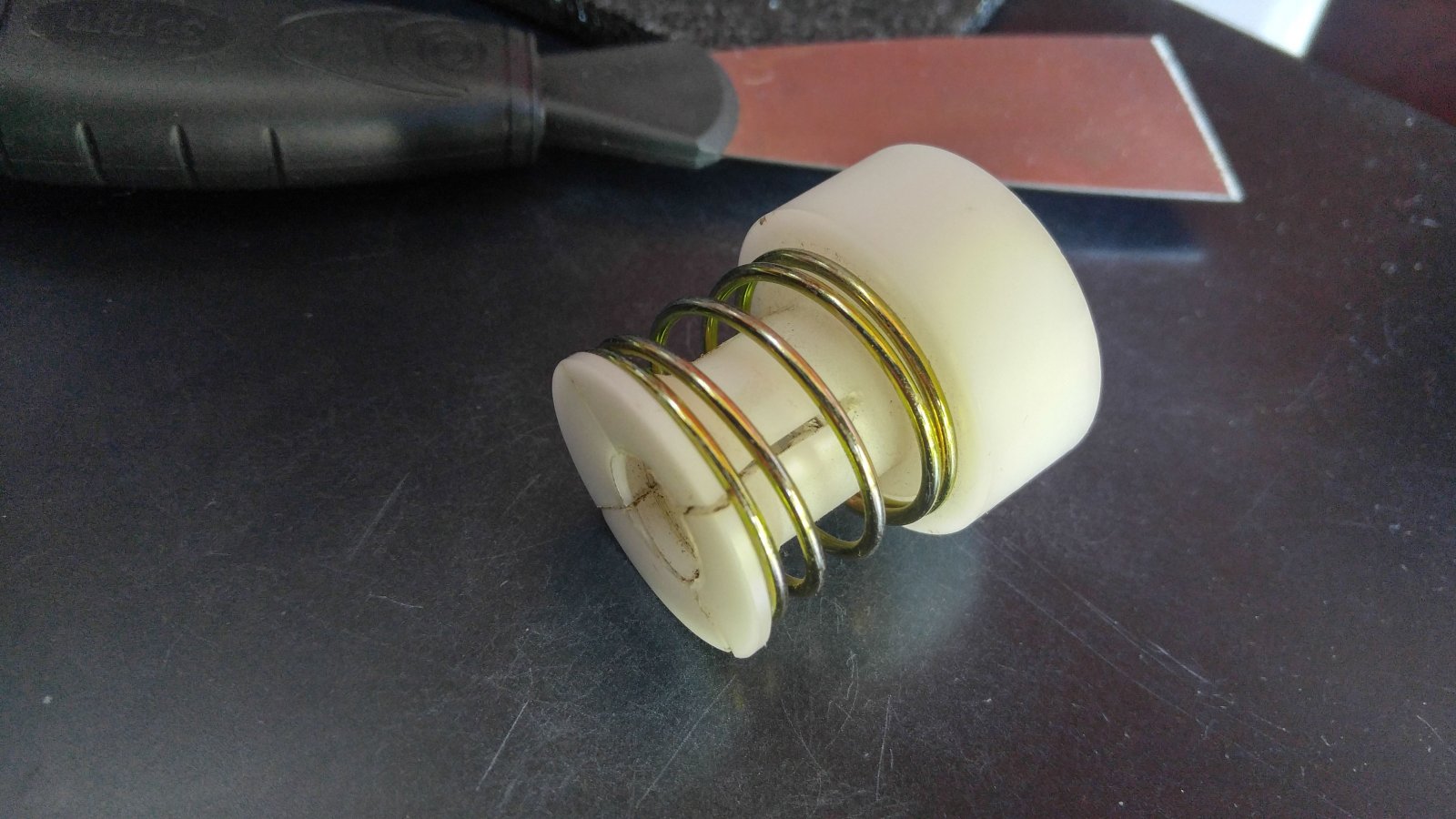

    I got this custom antibacklash Delrin nut and 120cm of trapezoidal screw about a year ago, I never used it because of the difference in efficiency against the ballnut that I already had in order at that time, but I think I will try it some day.
    @Pit please if you get a quote from Igus, share with us.

    Guys good news, igus was making contact with me, they will have a look at my rig or I will pick one of my "powertrains" and will visit them, we will see.
