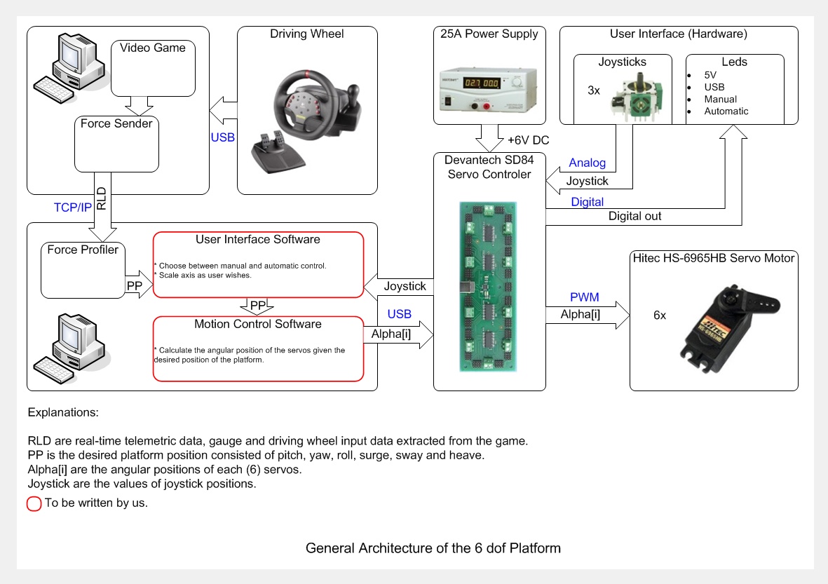

    For a better understanding of the project, here is the general architecture of the 6 dof platform (subject to changes):
  9. egoexpress
    egoexpress Active Member
    Dec 13, 2006
    3,839
    Germany - Frankfurt/M
    422Coins
    +10 / 1 / -0
    looks right. Though the Force-Sender is able to send real telemetric data, gauge and joystic input data to the Force-Profiler as well, and not just ForceFeedback data only.

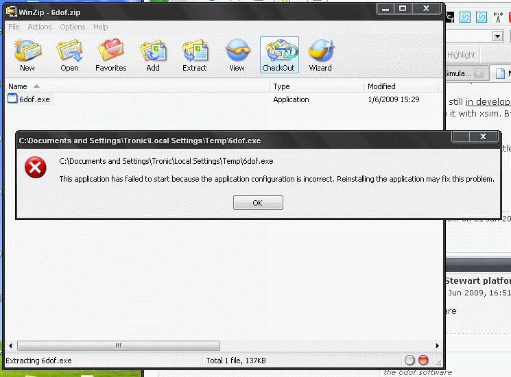

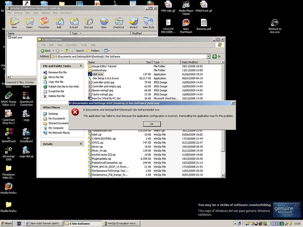

    i cannot open the software. Error message occurs: Diese Anwendung konnte nicht gestarted werden, weil die Anwenungskonfiguration nocht korrekt ist Are there some dll´s needed?
    I use Win xp 32 bit.
    Copyright 2007
    of the application?
    regards
    René
  15. tronicgr
    tronicgr
    Same thing occurs to me:
    I have already VB6 libraries on my computer and I supppose that's the reason I get different error message from RaceRay...
    Can you make a proper installation package for your 6DOF program?
    Regards, Thanos

  17. Robin
    Robin New Member
    May 8, 2009
    44
    51Coins
    Hi guys, thank you for telling me this. I hadn't hit the release option of my compiler (Visual Studio C++ 2008) ha ha ha! Now I get an unresolved link error because of the libraries I used to make the 3d drawings. I'll fix this asap.
    See ya
    Robin
