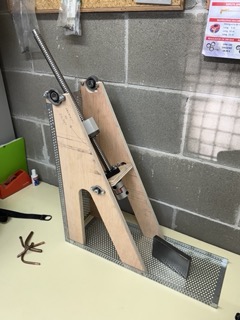

    Hello to everyone. I'm here again to share my "new" 3DOF motion rig mostly for flight sims. My last thread was the switch from a 2DOF to a 3DOF with heave with 3 motors in star setup, here the link: https://www.xsimulator.net/community/threads/from-2-dof-to-3-dof-flight-sim-motion-rig.18430/
    That rig worked fine but the worm gears have a lot of backlash so the small and subtle movements from the telemetry was not transmited to the chair platform because of mostly two things:
    1. The mentioned backlash intrinsic to those wormgears.
    2. The lack of efficiency intrinsic to those wormgears.
    Both of that problems casued lot of energy consumption (and waste of that) and the cogging that let me out of the VR immersion speccially when landing a plane.

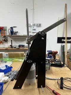

    Because of that (and because I can't stay still) I started to find a solution. Between them was the install of gasprings/dumpers but it doesn't work as expected. Searching in this forum I discovered the SFU gearbox upgrade from DOF Reality and after explore the design of that GB from pictures I started to design my own GB.
    One problem I readed that GB have is the stepping/juddering issue that DOF Reality urges to resolve with a planetary GB (so another layer of complexity, problems and cost). I didnt know if that problem will afect to me because my motors (the same as the previous model) are really powerfull but I didnt want to spend time building something with the fear that it will not work. So the my thougts were use more of the ballscrew instead a planetary GB. In base of my calculations/obersvations the DOF Reallity SFU GB uses around 70 - 80 mm of the ballscrew so if I install a ballscrew longer and I use around 300mm It will multiply the force by almost 4 and the motor will work at more rpm (so more torque).
    After some blueprints and prototypes printed in 3D I decided to build this model:
    First prototype
    Almost final model.

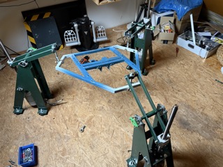

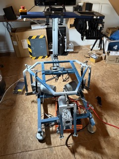

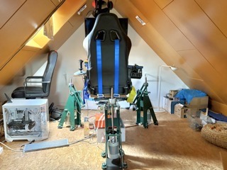

    After some touch-ups and reinforcements I builded the final model and started to install them on their emplacement. Here the after and before:
    Before
    After
    After the first tests the result were promising. Now the motors work very very cool and develop a lot of force. After my calculations for this gearbox the motors are working at more or less the 33% of their capacity and it really noticeable after two hours working non stop the motors are still cold (in the previous rig the motors warmed up to a very high temperature relatively fast). And for me the most important is that I can fell all the subtle movements/forces of the plane (specially when I'm gliding to land. Even if you are parked in the middle of the sea with a seaplane you can fell the sea waves and feel as if you are adrift. And I love it how it works now, smooth as silk.
    As a mention if the rig is used for simracing the gearboxes are a little bit slow but strong enough as mentioned above but the problem with this design is the long (double) arm with a 5mm platten. Sometimes a violent roll movement can twist a little the rear arm and it needs to be carefull with the "violence" and/or use a 10mm platten instead.
    Yes, the footprint isn't compact anymore but I don't care, it was never going to be portable si its ok.

    Are the three struts guided laterally in any way? It looks very wobbly.
  4. Josh_Possa
    Josh_Possa Active Member
    Jan 25, 2021
    130
    Catalunya
    579Coins
    +37 / 0 / -0
    2DOF, 3DOF, DC motor, Motion platform
    No, they are'nt ant yes, thats a problem I noticed too and is the cause of the torsion I mentioned in the original post. With slow movements it is not so much noticeable but the faster are the movements the problem magnifyes.
    My next step is how to solve that problem. One option is make shorter arms that will be traduced by less heave lengitude (or height depends of the POV) and overall less range of movements but I think it will be enough too. Other option is install a kind of telescopic pillar with a joint to guide vertically the chair platform.
    I'll investigate the best option and I'm listen to your suggestions.
    Thanks!
