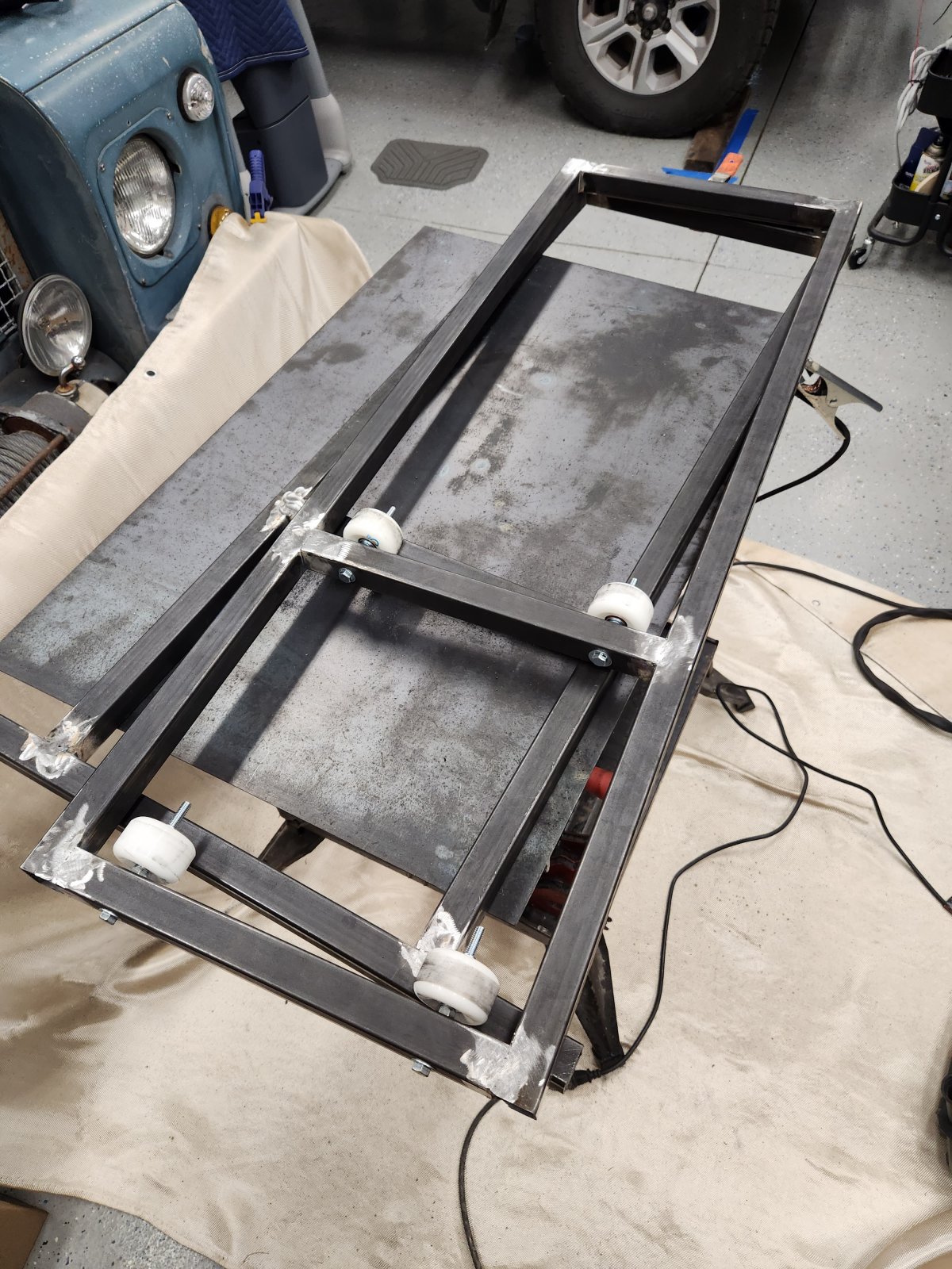

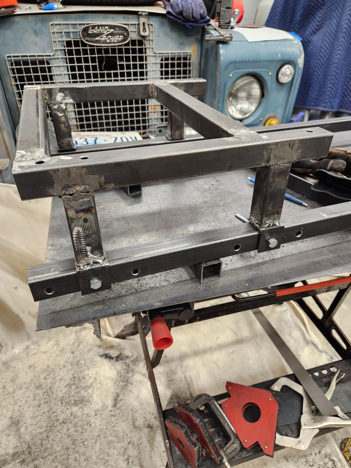

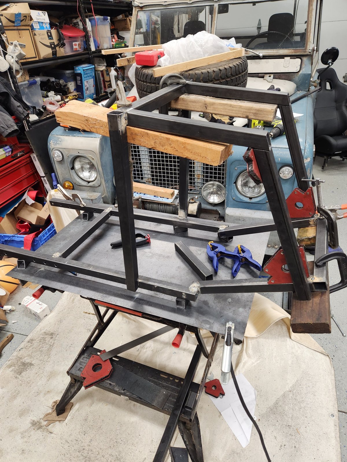

    Following along with @Halloween2go s new built I'm trying to copy his and adding a few things to make it work for my environment. Today was a productive day and I've gotten the bottom and middle frame mostly done. Still needing some parts here and there though, but since its a winter project I'm not much in a hurry. 20221015_180709.jpg 20221015_183054.jpg
    I will need mine to be mobile so it will be on caster and if possible also work for some flight sim stuff.
    I'm not a great welder yet, but I'm pretty good at grinding so that comes in handy.

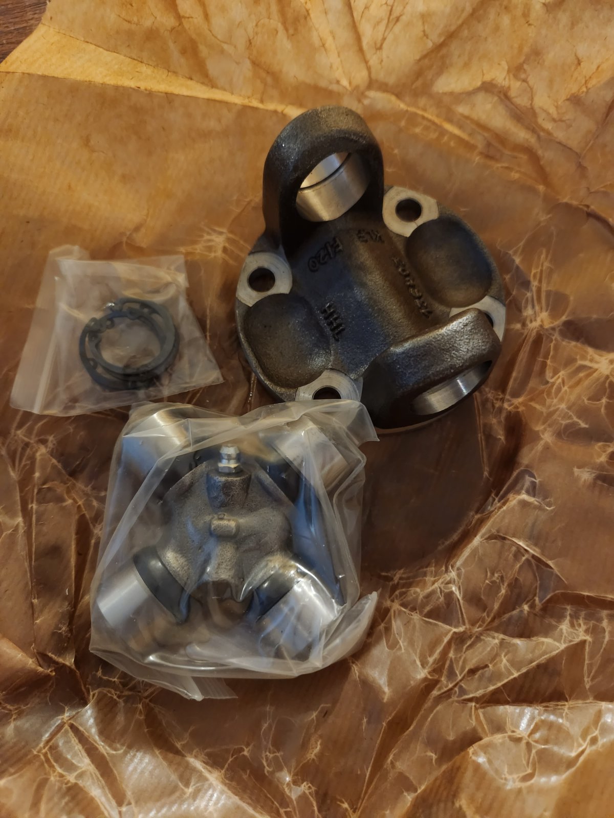

    The boltable u-joint is a good idea. I don't want to mess with going to a junk yard, I can built my own double flanged u-joint for not much money using some parts. Less time as well than driving out.
    Basically going to take 2 of these with 2 u-joints. With shipping I'll be in under 50 USD. The GBP is so favorable these days and often companies there ship faster to the US than you'd buy it from a US vendor.

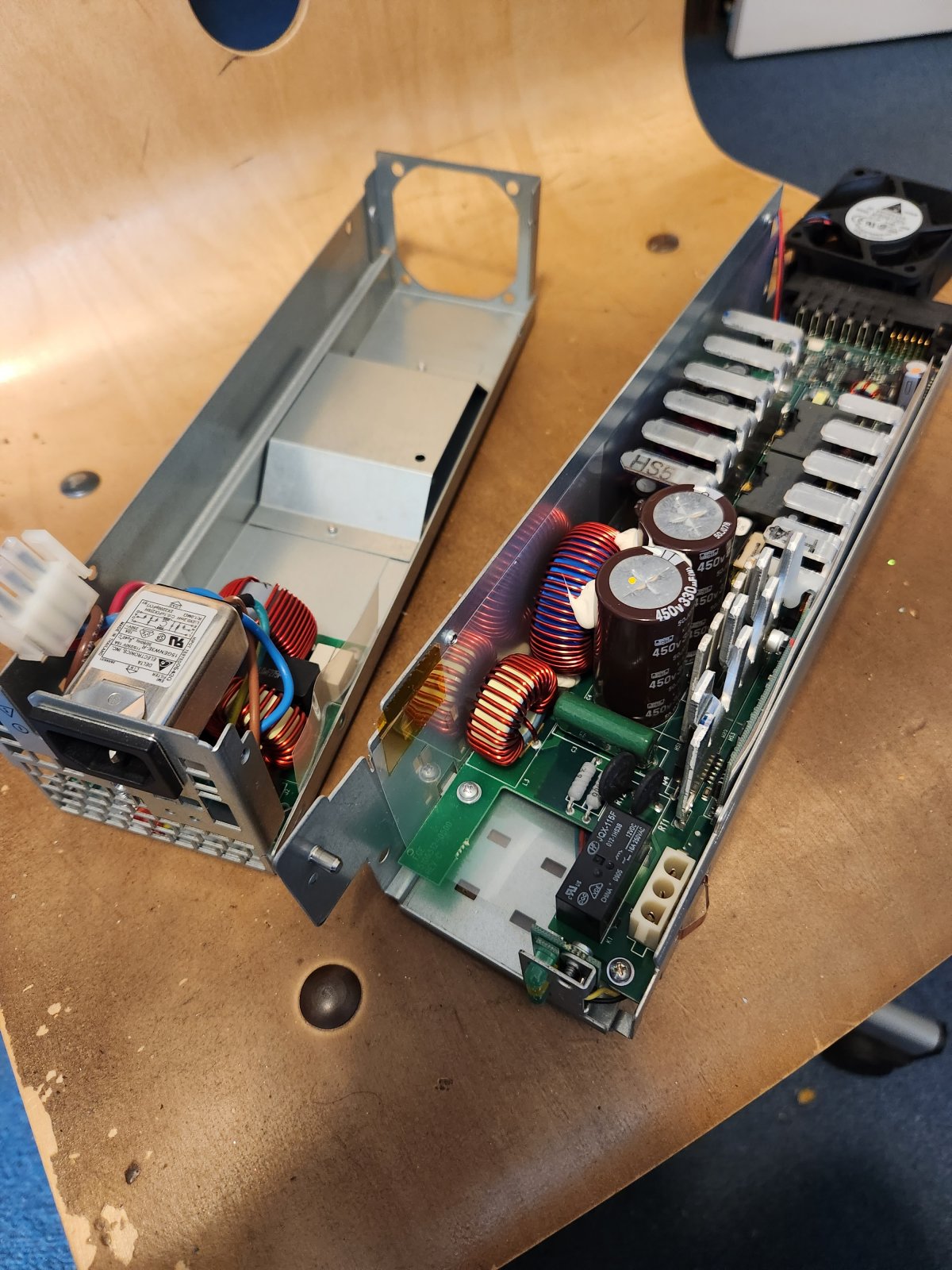

    I am also starting with the controller box. I have a few older server power supplies laying around and they should be able to provide adequate power to everything. I have started to dismantle them and they should just be able to fit nicely into this enclosure together with the rest of the electronics.

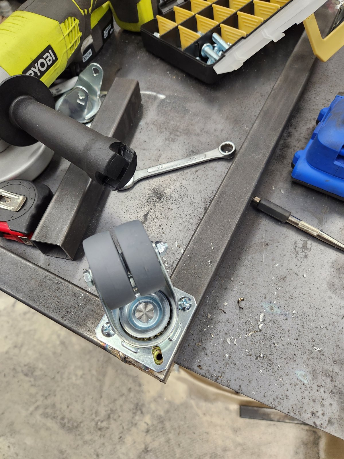

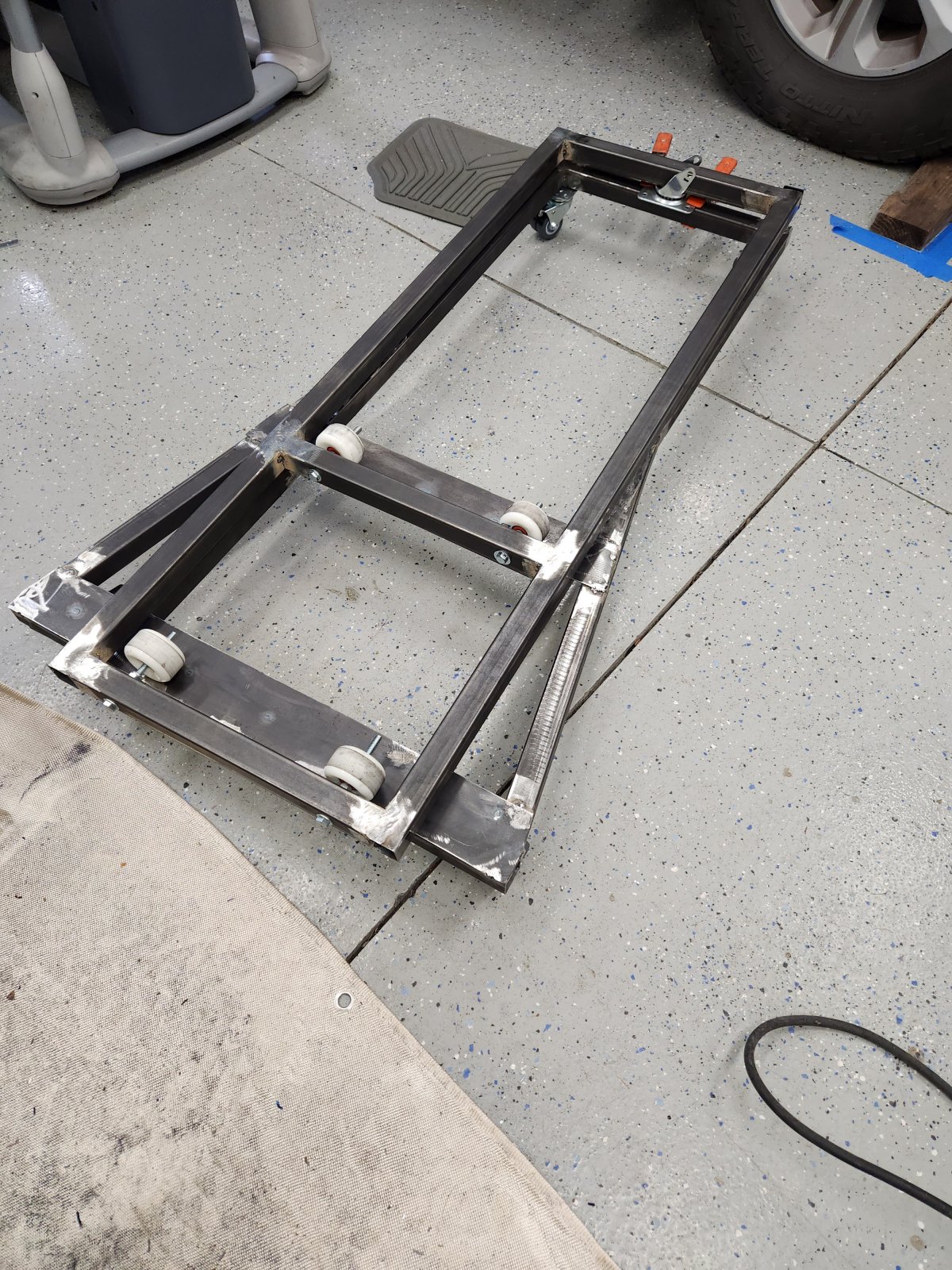

    Either this is going to be brilliant or it will suck horribly. I am going to need to move my simulator around in my shop to make room occasionally for other projects so fixed ain't going to cut it. I hope these wheels will do the trick (they can be locked into place). The pivot hinge I got for the front is too tall so needing to source another one to fix that. Waiting for the seat to come in on Tuesday so that I can start figuring out seating layout and more. Not a bad day of progress.

    2DOF, JRK
    I used wheels like that on mine but the shaking and movement was off putting when using the sim so i removed them. But if thats what you need to do I guess you just put up with it. Nice work!

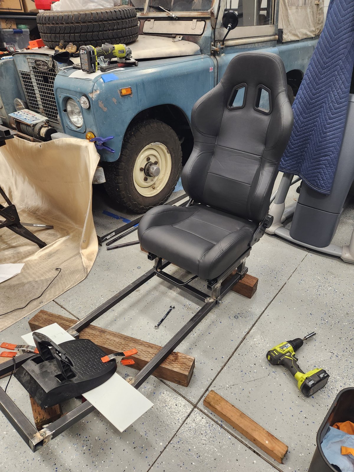

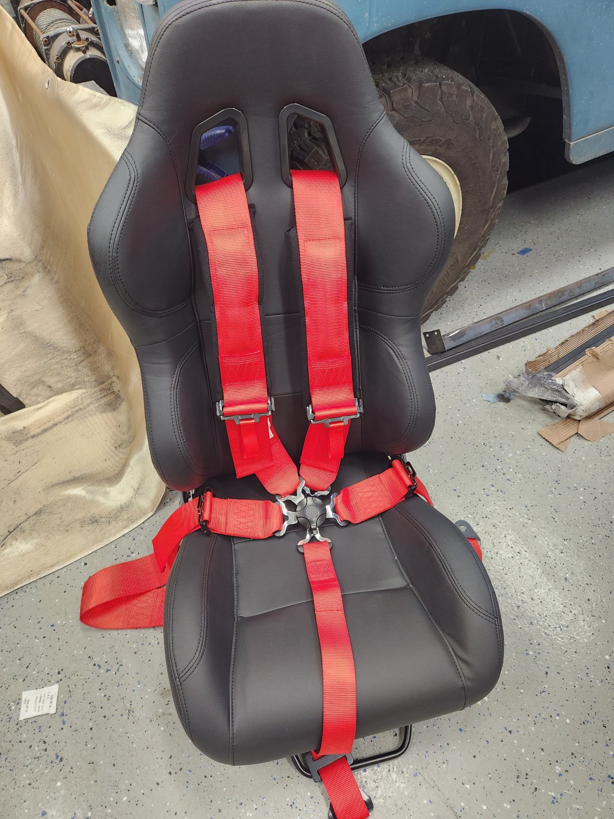

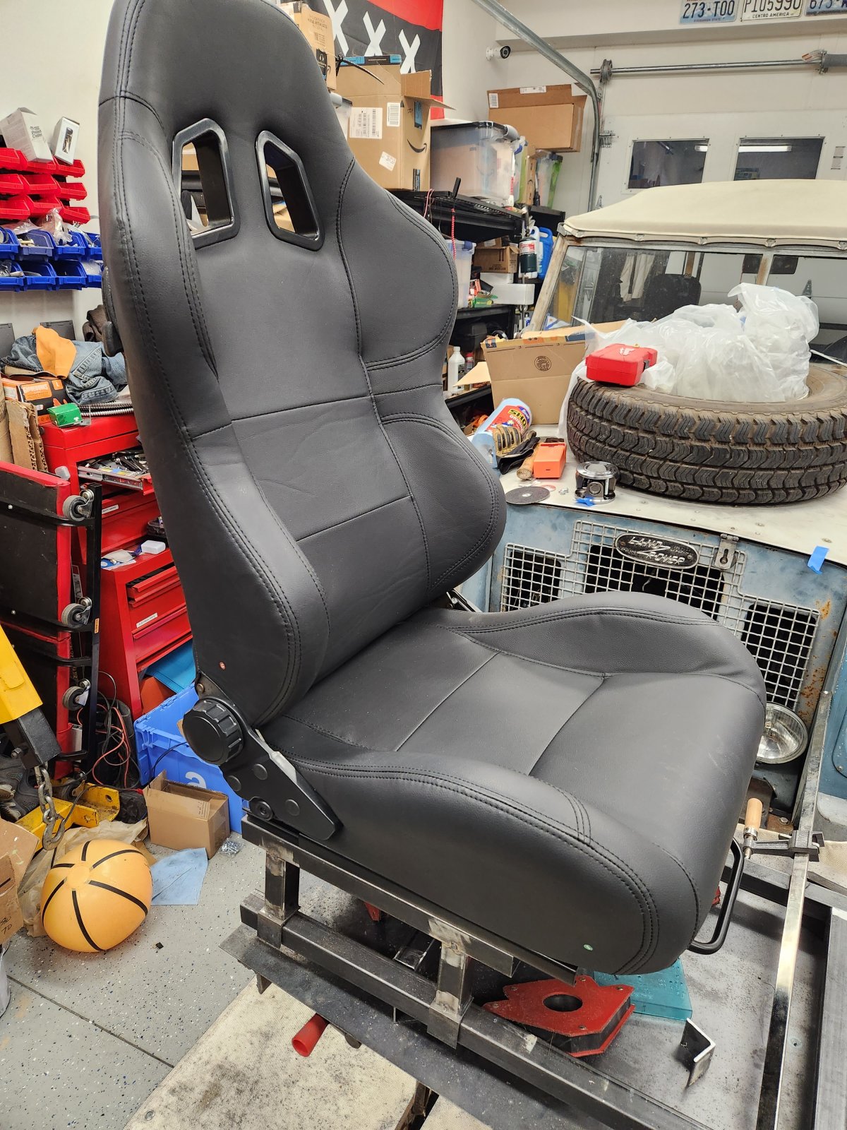

    Seat and the parts for the u-joint arrived today. Since the seat frame will be balanced (and I'm not a heavy person), I picked a little bit more comfortable seat over the lowest weight possible. Mocked it up a bit with the seat belts in my shop over lunch. I considered time + gas to drive to a nearby junk yard to find a driveshaft and it was easier, faster and cheaper for me to just buy 2 u-joints + yokes from the UK to the US west coast. Besides that they give me some spare parts for the blue Land Rover in the background if I ever need them. This weekend will be figuring out seating position / ergonomics before building the overall seat frame.

    That seat sure does look confortable... nice work

    Thanks. It is super comfortable bit still gives great support. I am mostly going to race vintage GT so a hard-core seat just wasn't on my wish list. It's a little heavier but I am not a heavy guy so it all evens out.

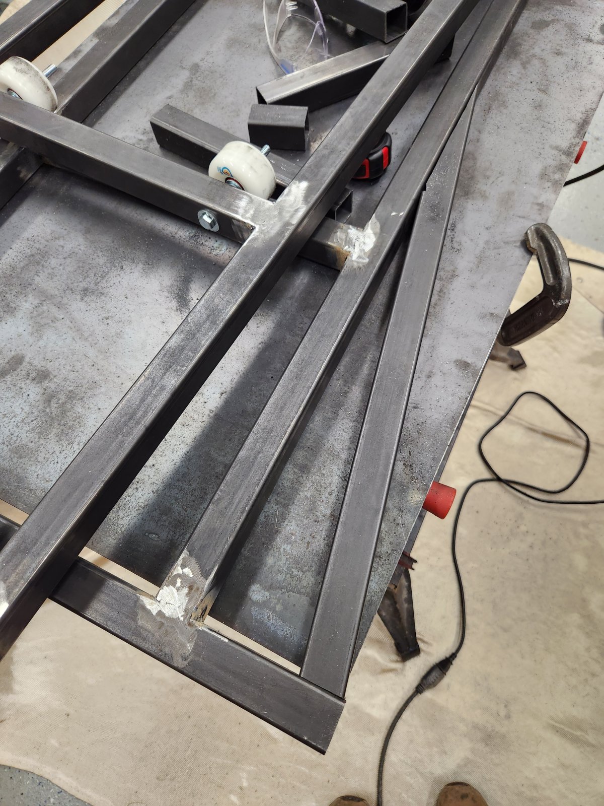

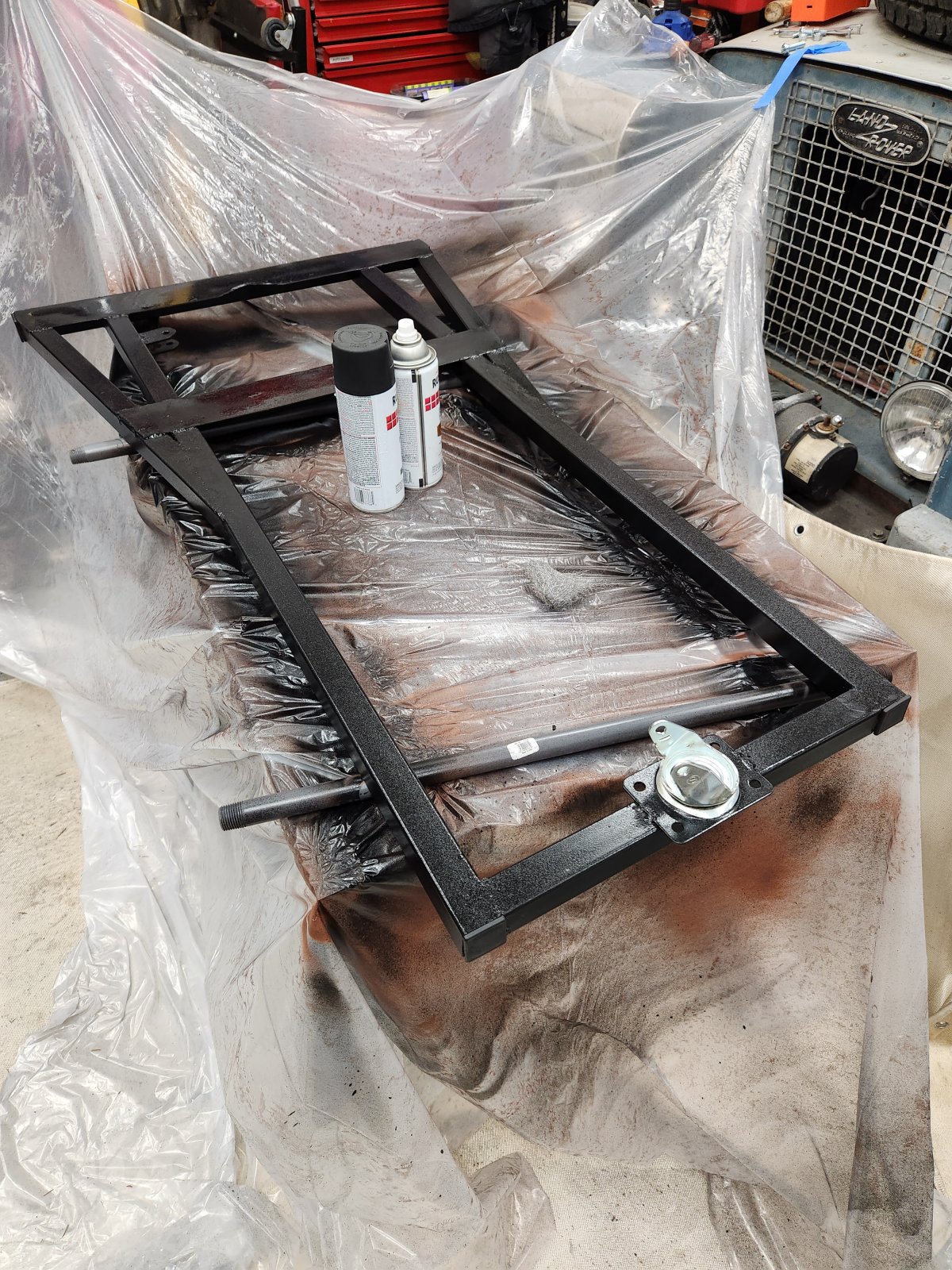

    On the other plus side, I got the bottom frame done and painted. Maybe I will regret it but I wanted to protect it during the colder and wet season and using some bedliner to also hide some minor imperfecions. I am making a few tweaks vs @Halloween2go 's build but that's what this is all about. He is a good inspiration.

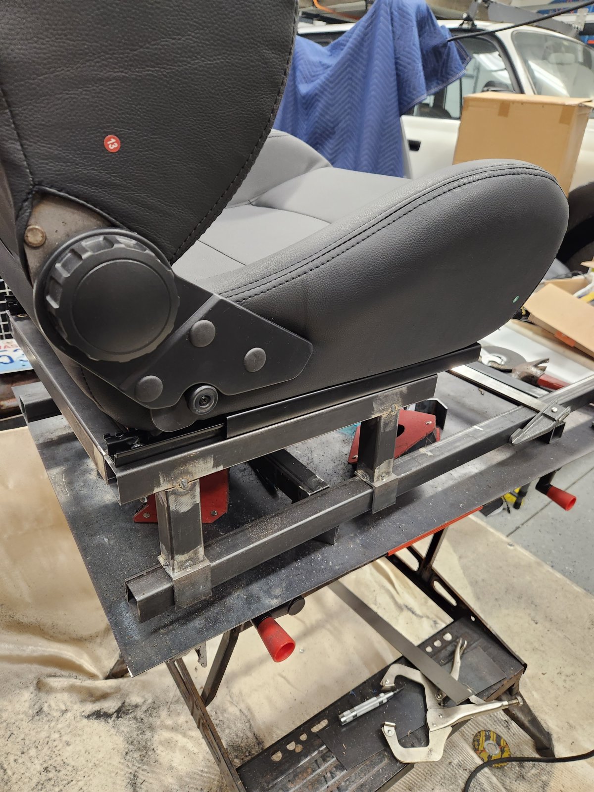

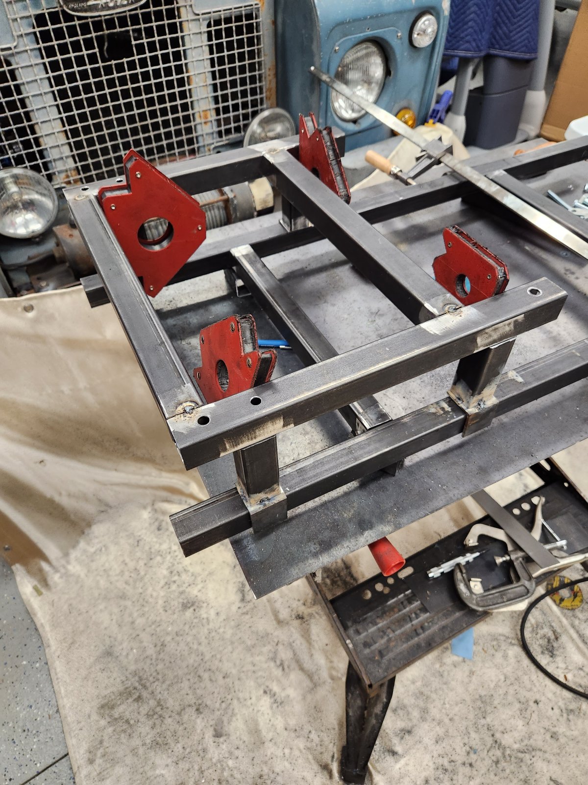

    Made more progress today. Fabricated the seat frame and welded it all together. The frame will be removable from the cockpit frame for portability. With some luck I can spend a few more hours tomorrow sorting out the rest of the cockpit frame. 20221112_165032.jpg 20221112_165027.jpg 20221112_161858.jpg

    Drilled out the mounting holes with a few to be able to move the seat for balance. This seat can be manually adjusted but it still gives a few options moving forward.
    Didn't get as far as I wished on the cockpit part though.
    I know the welds look shitty at the moment but once everything is fully mocked up I will work on cleaning them up more.

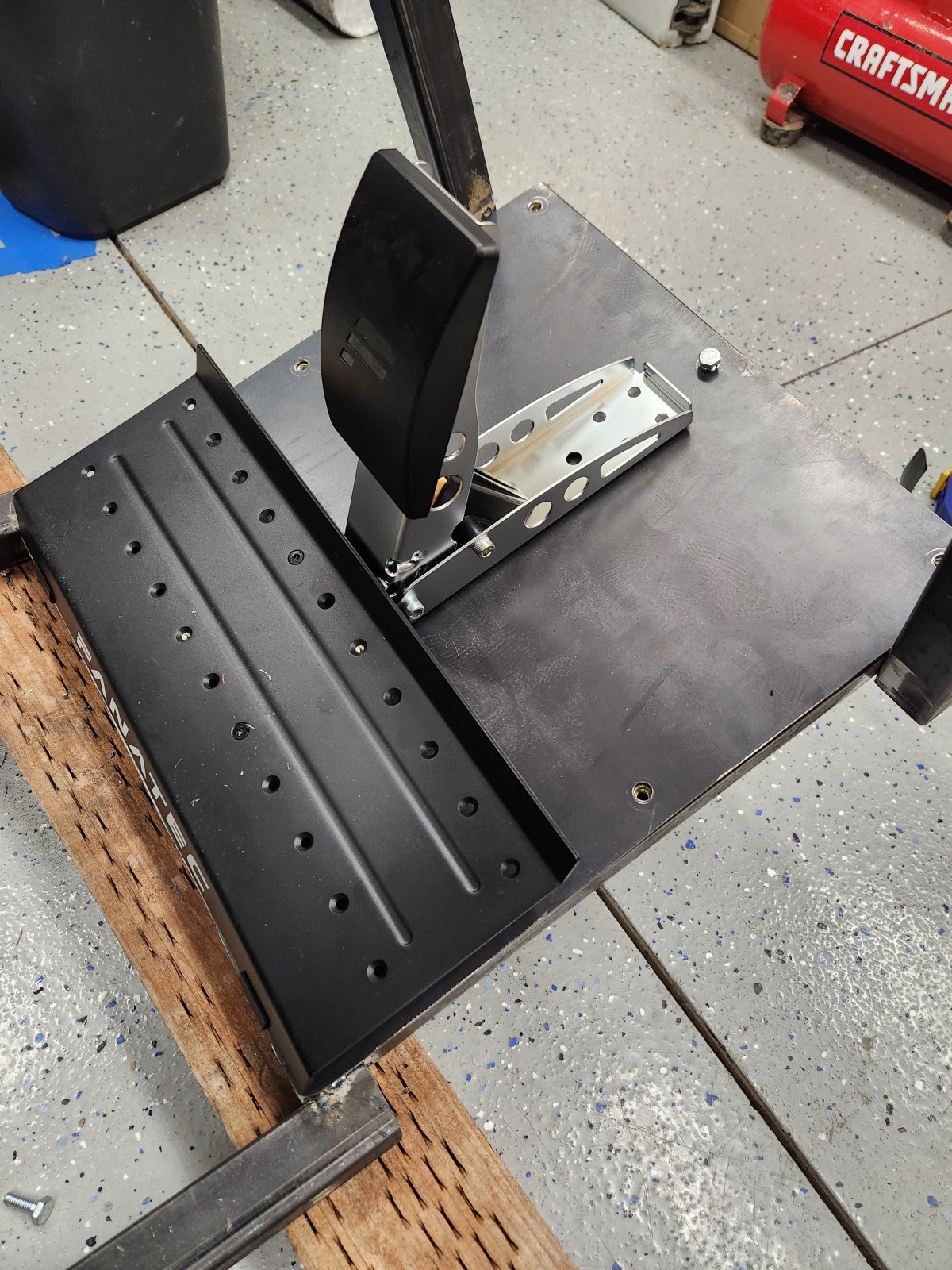

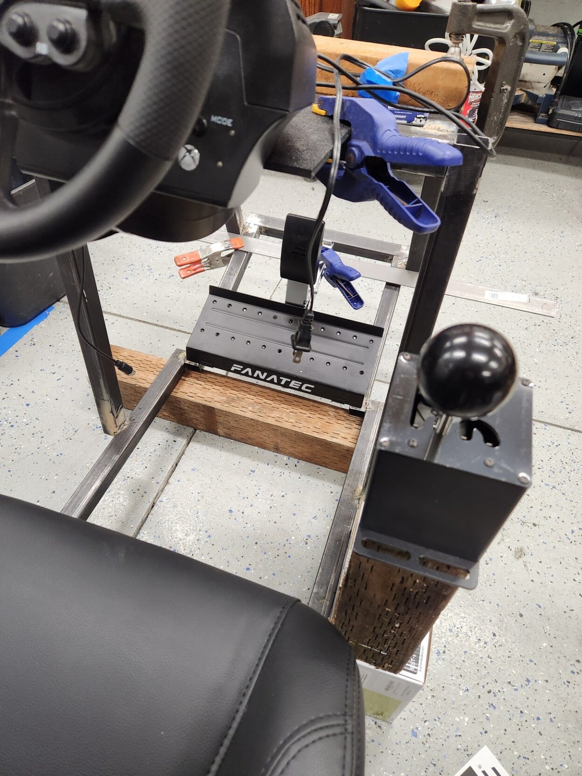

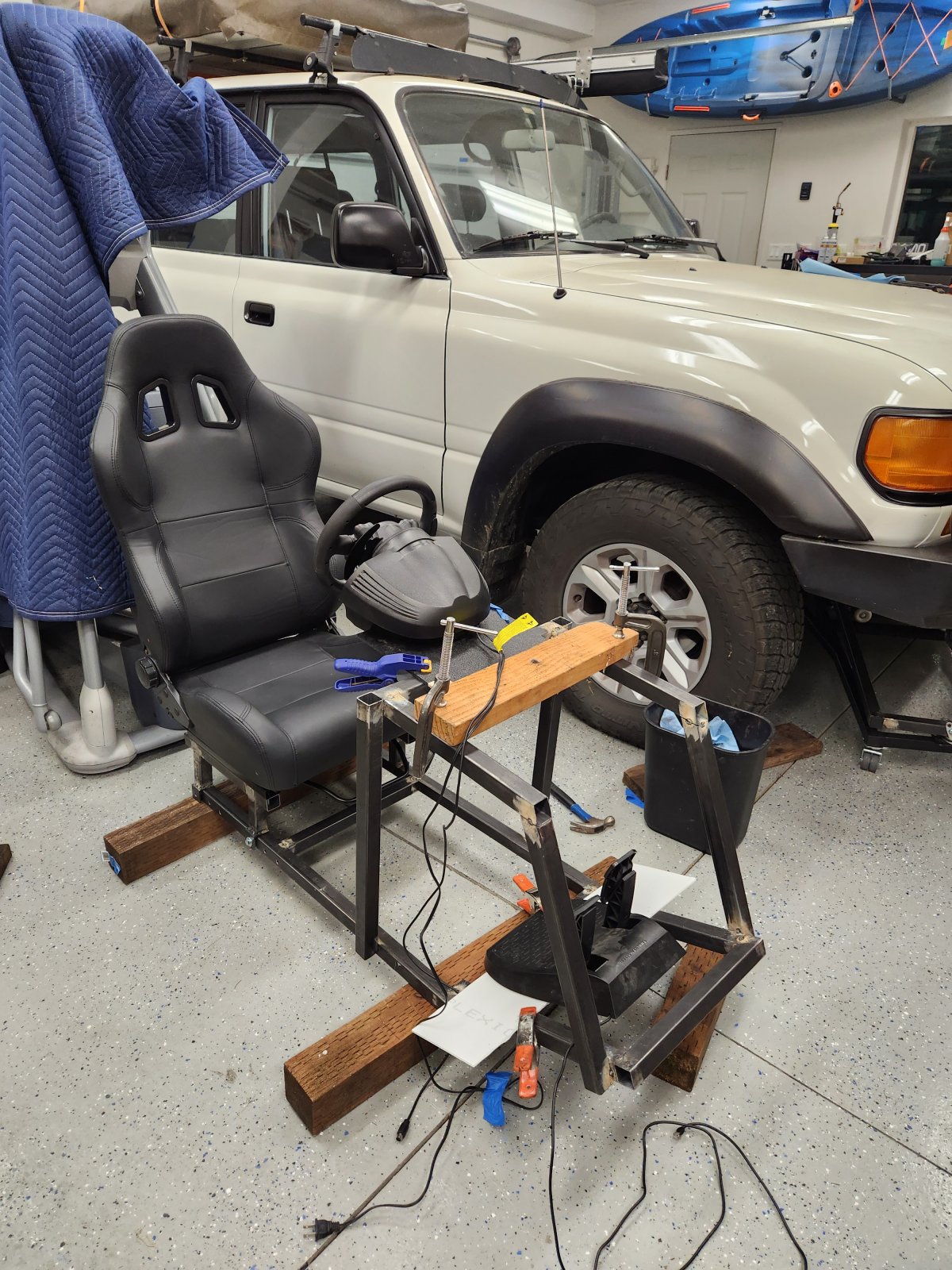

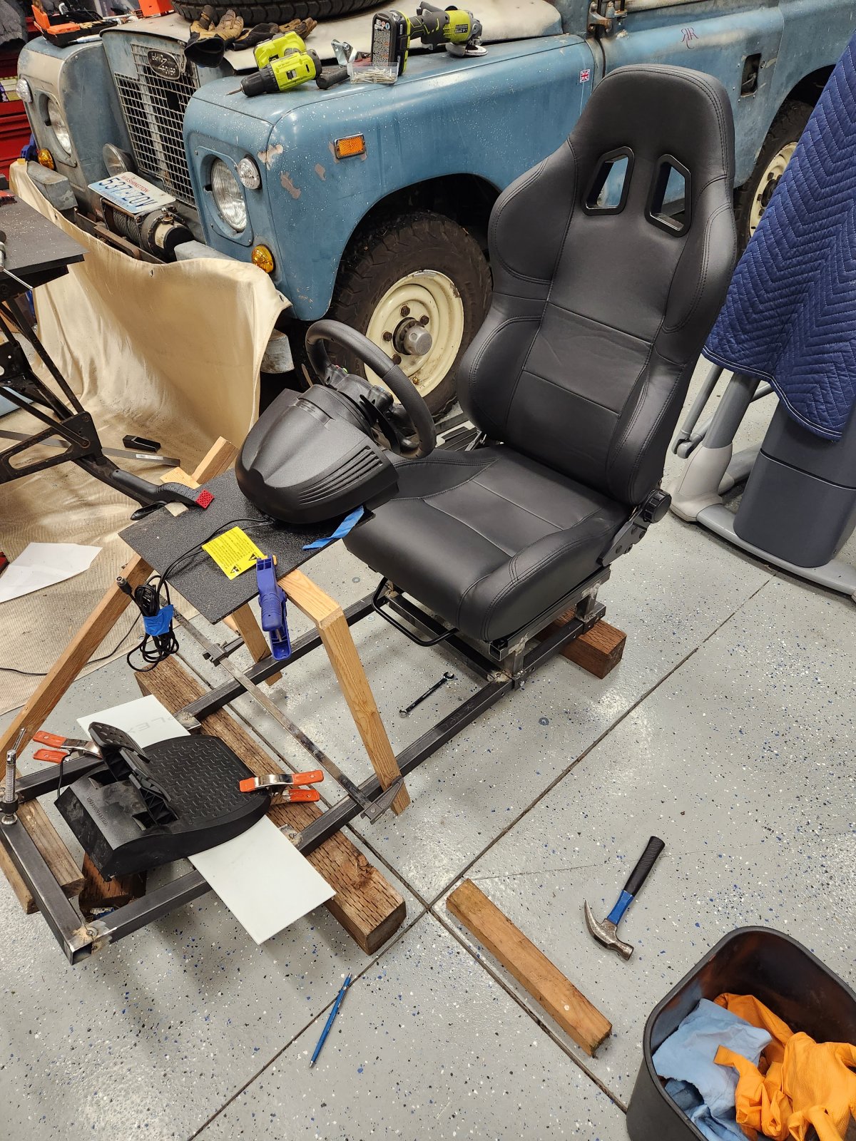

    Progress today. Had no meetings in the afternoon so mocked up the pedal section. Tested it out with the seat on it and it's pretty much perfect. I can slide the seat on its sliders so easily to adjust to a comfortable spot. My christmas present came early as well in a Fanatec pedal set which will replace the old trustmaster ones.
    Maybe I will get close to finalizing the cockpit this weekend.

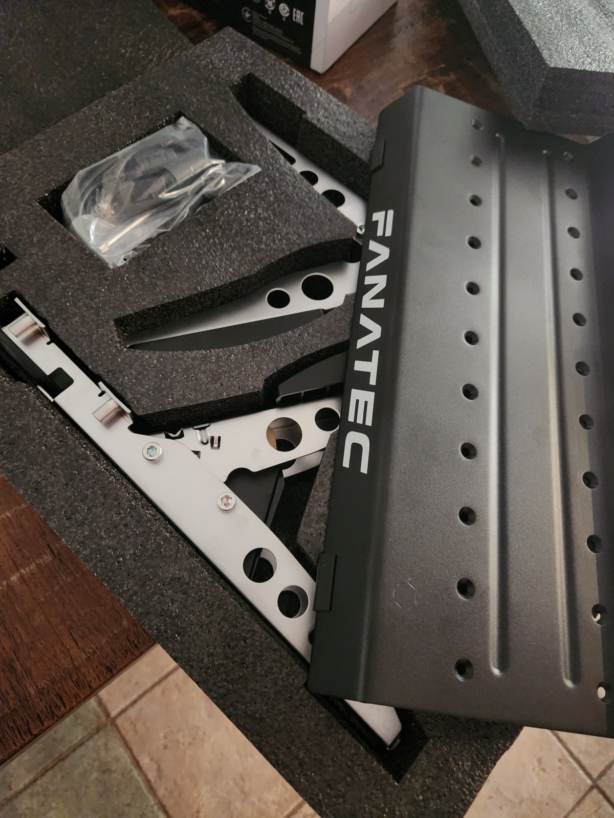

    Tack welded it all in place and refitted everything for fit and layout. It's darn near perfect. Next up is getting the balance point sorted which means putting the proper Fanatec pedals on for weight.
    Once the additional steel comes in I will fab an additional angle brace on the long uprise and the u joint mount. Lots of fun progress as it's starting to become visible.

    56bfc90efc9af597.jpg Mocked up the layout of the gearshift and real pedals I am gonna use. Still fits. The balance still checks out. I also found a spot for the thing in my shop when I am not using it. Will need to get rid of a 50 ton press but I am not using it anyways. The pedal mounting plate also will do its job with the fanatec pedals fitting perfectly.

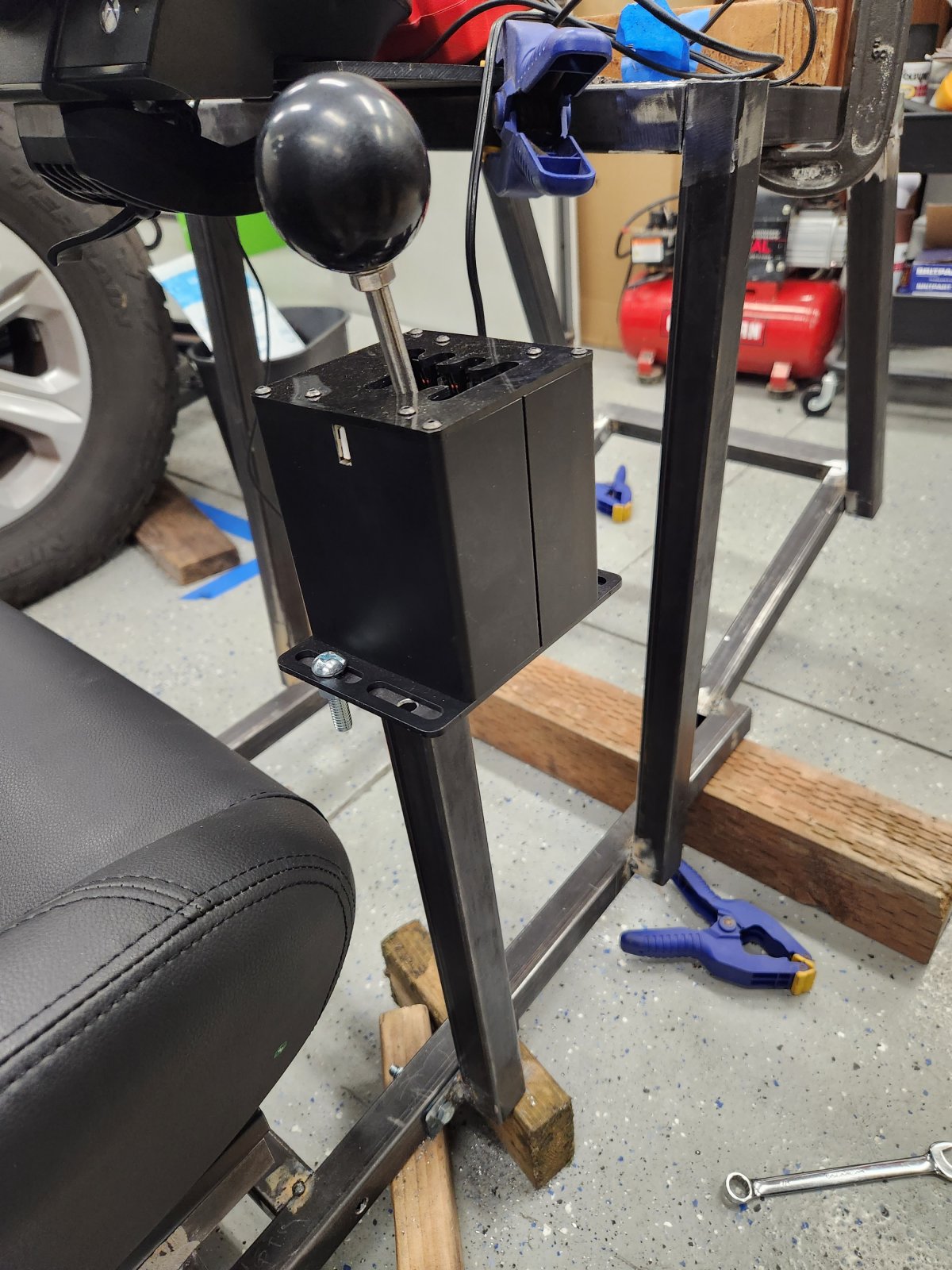

  20. donottellmywife
    donottellmywife Member Gold Contributor
    Sep 30, 2022
    69
    Something something tech related
    98065
    444Coins
    +61 / 0 / -0
    These 50 dollar ebay shifters are actually really nice and solid. Needed to fab up a mount but it's perfect. Worth the money.
    The pedal mou t plate for the fanatec pedals also fits like a glove.
